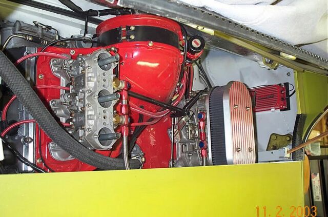

Couldn't you just cheat and install nitrous? BTW, according to Car & Driver, the '73 2.0 was an 8.6 second car.
(IMG:http://www.914world.com/pix/image1jjjj.jpg)
