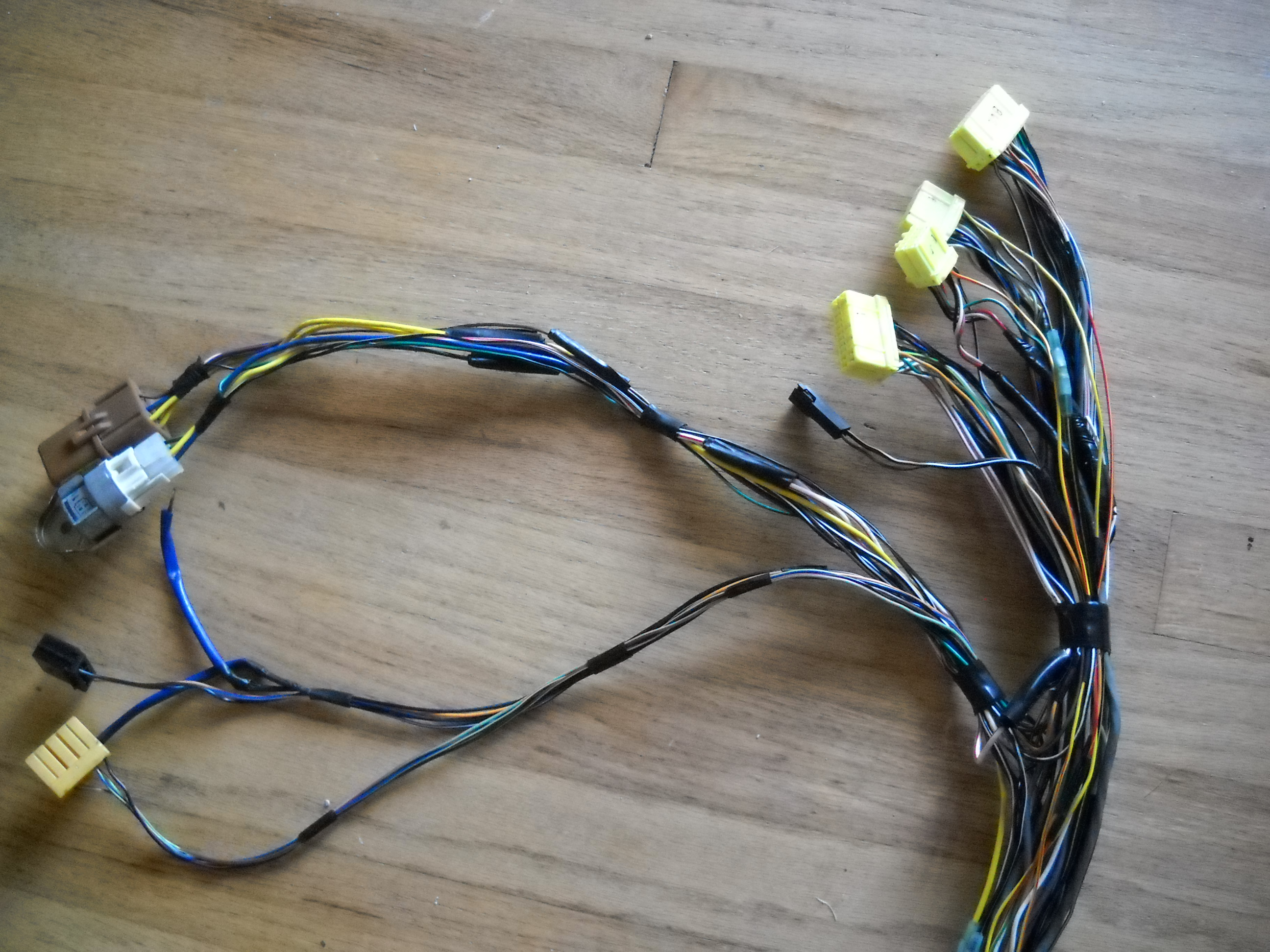

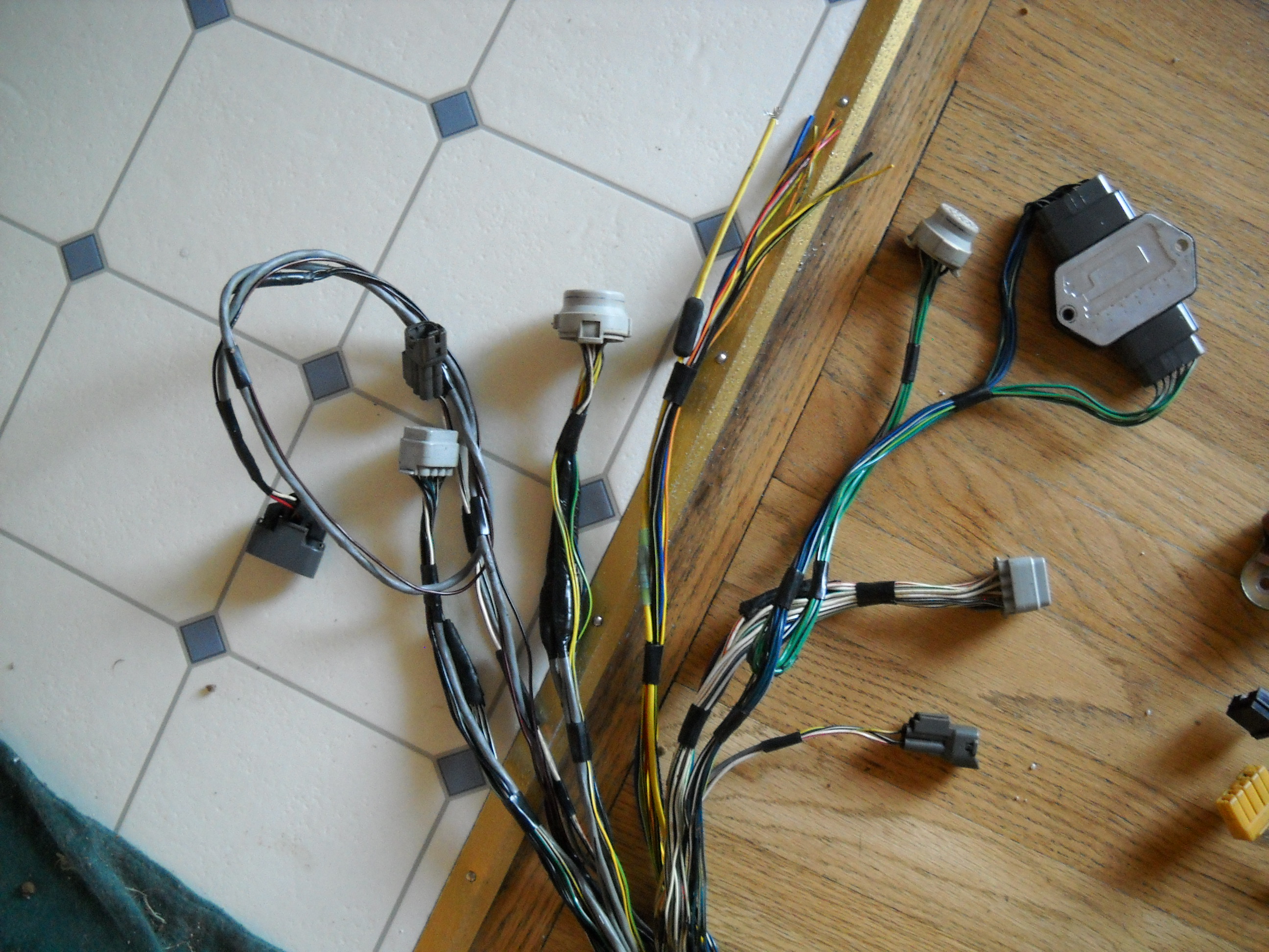

jcl
a914622
post Aug 7 2013, 07:19 AM
Post #121
Posts: 316
Joined: 12-August 10
From: northwest
Member No.: 12,048
Some of the conections at the ecu are spliced just to shorten. It is pretty straight forward. keep the diode, subarus wont run with out it. (can be pulled for a start kill).
out put wires are:
big yellow= battery +
blue = fuel pump +
blk/wht = ign+
blk/yellow = starter crank
red/yellow = check engine
yellow small= tack signal
yel/red = vss/speed sensor
ornge = back up power/ bat+
yel/black,yel/grn= ecu power out(fans)
I left the pics huge so you can click and zoom in. hope this helps.
