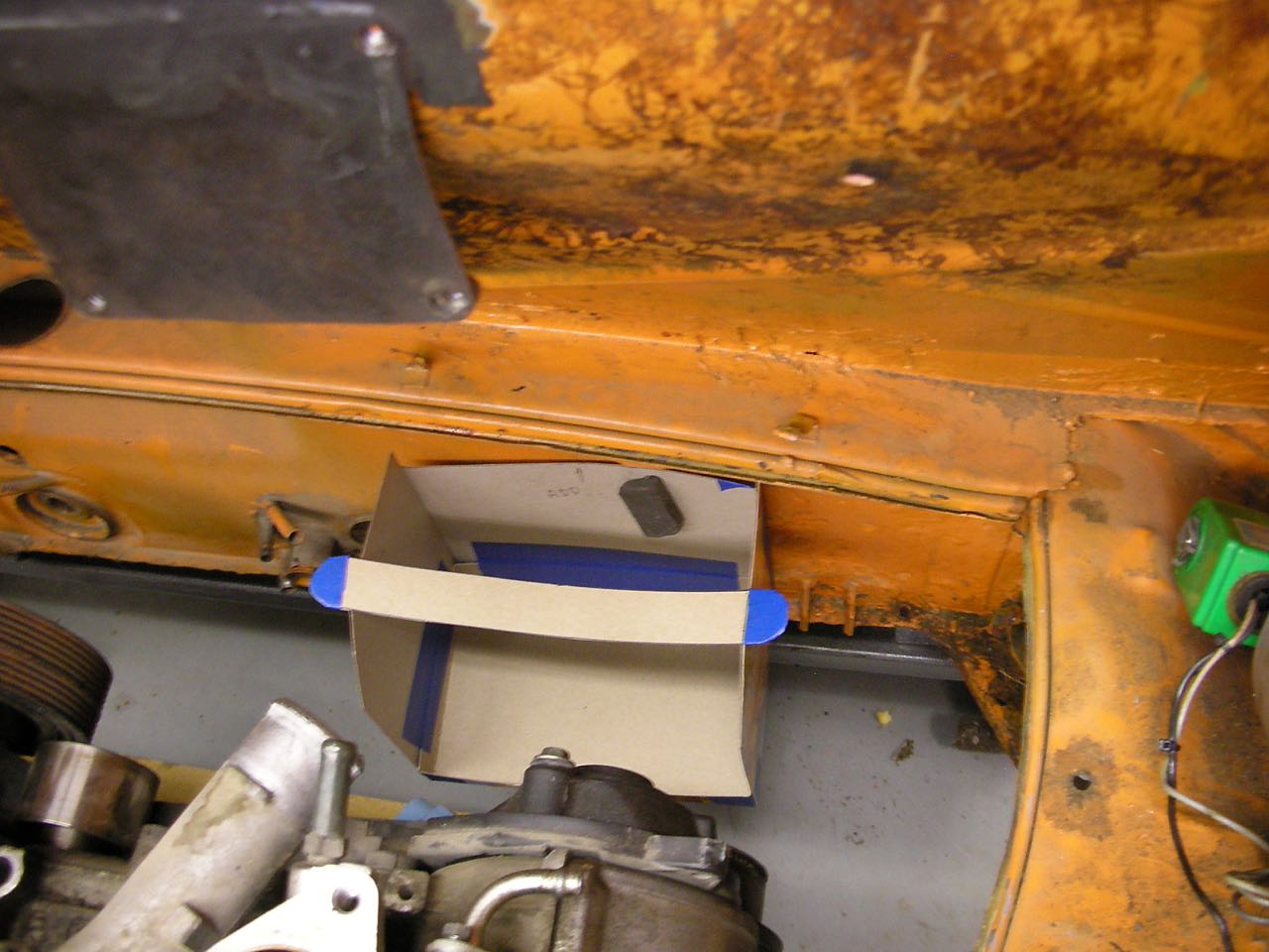

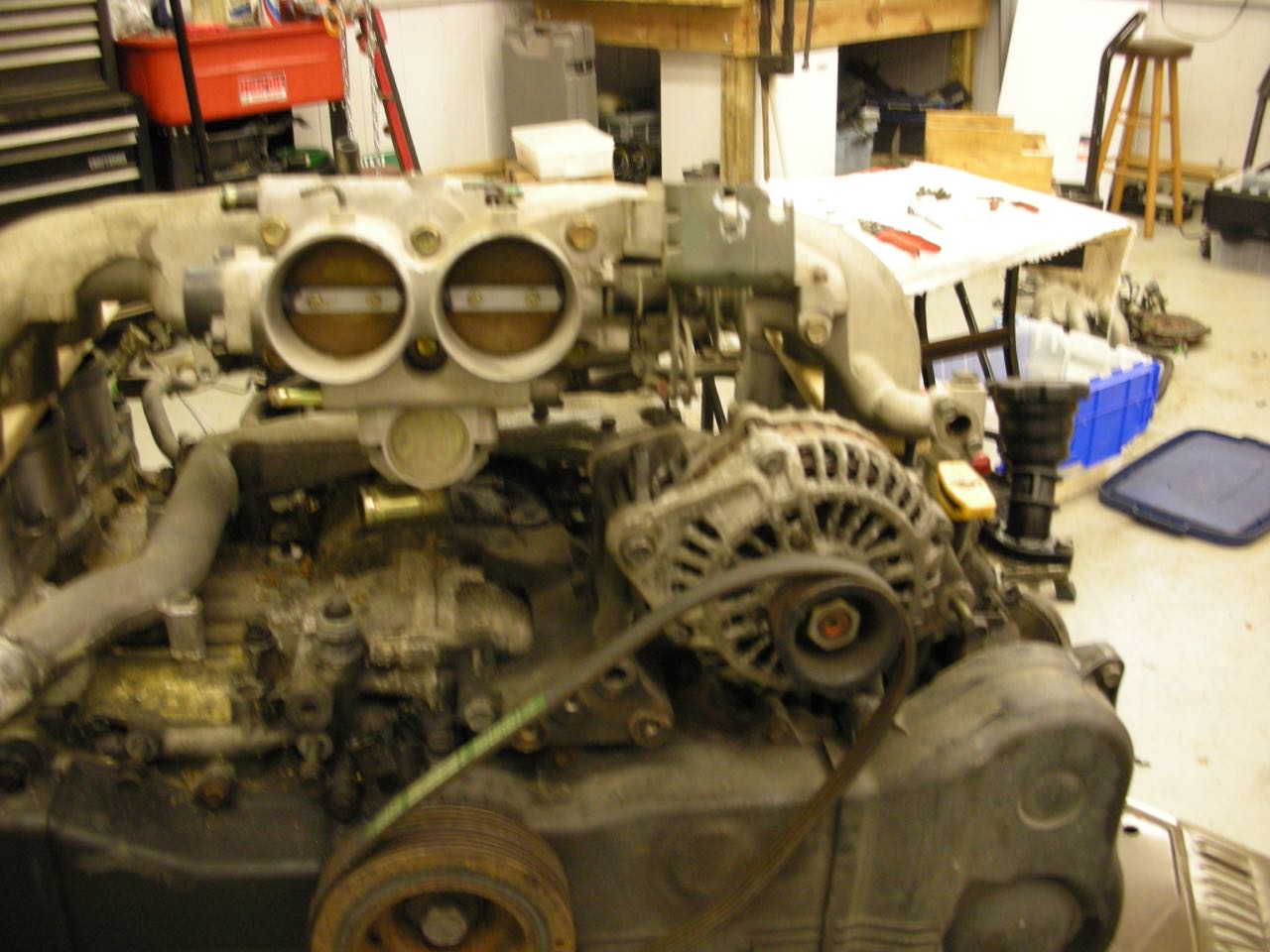

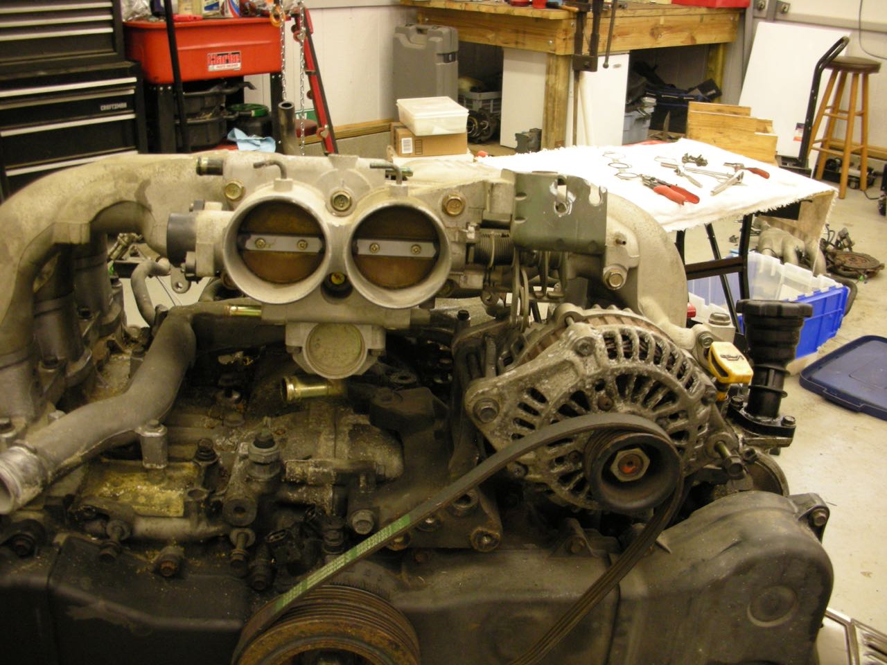

Okay I did a little experiment today with the flipped manifold. It will work, sort of (IMG:style_emoticons/default/screwy.gif)
You will need to raise the intake up 3.75 inches, if you leave the alternator in its stockfish position. And yes it still clears the engine lid with out a rain tray. Now for the but!!
I took the PVC vent piece off the TB, made it that much easier to fit stuff up. That thing is huge!!!!
Now if you use the stock snorkel, you run into an issue. It needs to move back 1.5 inches rearward. It would just clear the firewall, but you might like to add a dent just to give you a little extra space. And you will have to clearance the latch brake for the engine lid. But no more cutting in the rear trunk, except for the slave cylinder banjo fitting.
Heres the pictures!

Here it is with out the snorkel, might still be able to make it work!

Wouldn't it be easier to relocate the alternator? Need that A/C compressor? I think SmallCar or someone even sells a new bracket to do that. You might want to check, if nothing else than to see how they do it.

I have one with the flipped stock alternator if you don't want/need A/C.
Ditch cruise control also and you don't need to raise the manifolds at all. If you want cruise, then you will need 3/4" blocks. Might not be a bad idea anyway. Get some heat transfer out of the all aluminum heat mass.
With out blocks cruise control piece hits alternator, use smaller alternator, or.....
Much better (IMG:style_emoticons/default/aktion035.gif) Sorry for the blurriness of the picture, I have Sir Andyitist! And I don't have a picture of that setup in the car. I did it and it does work with out a single cut.
Last night I started to think about where to get the air and where to put the filter. GT Engine lid, and mount the filter box in front of the engine in the recess in the fire wall. Could make it a huge panel filter. Big question is will it draw enough air. (IMG:style_emoticons/default/idea.gif)

If you want A/C and alternator, why not just put the alternator over where the Power Steering pump was? Will require a bracket, might require a smaller alternator. But that should work also. If I had Photoshop skills, I would move it over for you.
Wish I had photo shops skills, my CAD skills are limited to Network wiring diagrams. So thy are of limited help right now also. I'm old school, tape measure, pen knife, and cardboard. Make a template, and build. Like this battery box, I liberated the idea off another build. Nice and low, passenger side, between the axles. And plenty of room there.
