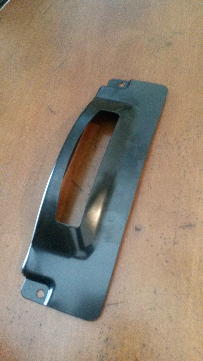

Another small thing...when we buy these 5MT transmissions they may or may not come with the clutch/flywheel area cover plate. Mine didn't and I hated the huge gap and exposed flywheel. Always assumed there was a cover of some kind but my only experience with a Subaru engine was an automatic.
Finally took a few minutes to find this:
Part number is 30216, followed by sub numbers for different years. Mine for the 2006 was 30216AA0020. E-bay, $17.XX

How funny, I was just looking for one as well. I will check eBay.

Me too! Thx a bunch, Chris. (IMG:style_emoticons/default/piratenanner.gif) That was bugging the (IMG:style_emoticons/default/stromberg.gif) out of me and I thought I would have to make something. That will keep the road debris out of the TO bearing.

Sure guys. I'll install it in the next day or two and confirm that it bolts up OK...can't imagine why it wouldn't... (IMG:style_emoticons/default/idea.gif)
