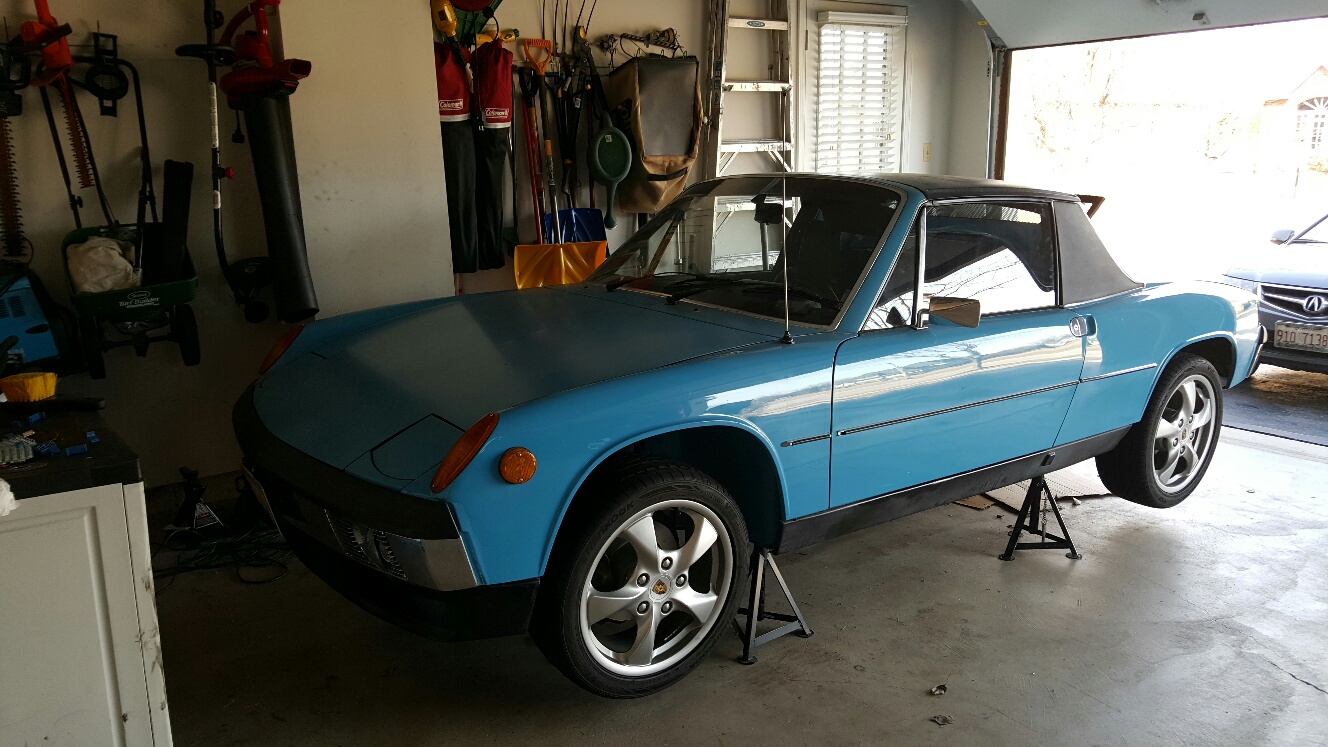

Hey look, I did a little work!
The beast is off the ground:

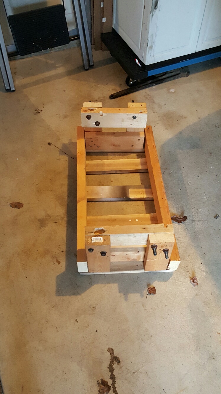

Made this primitive engine holder thing (took longer than you think!):

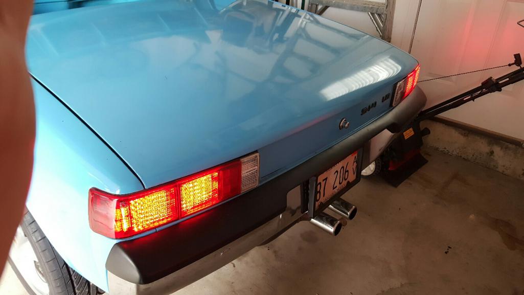

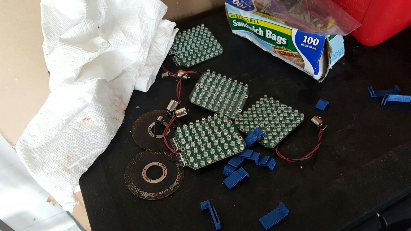

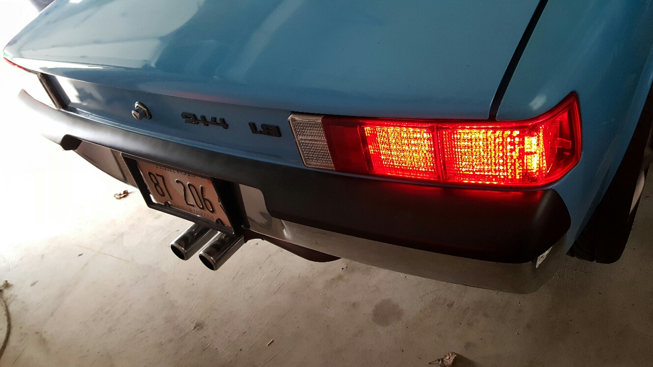

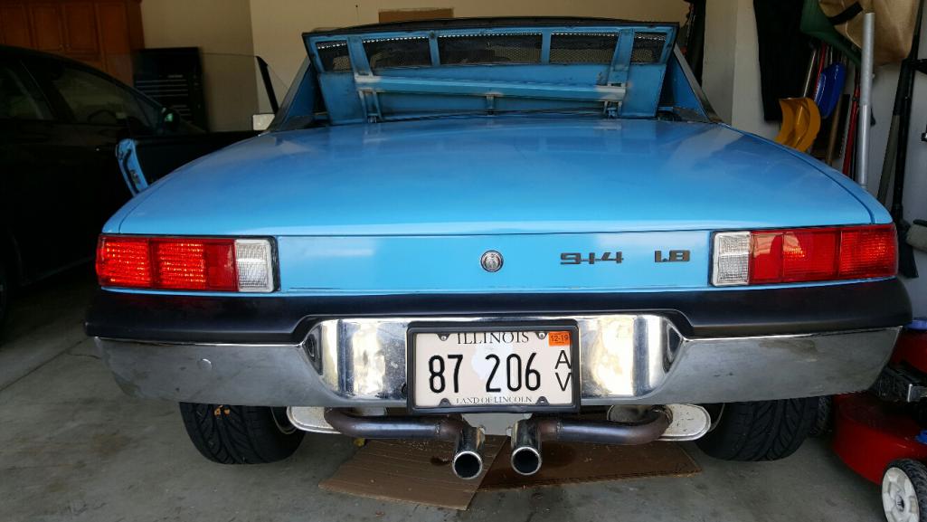

Finally finished my LED tail light conversion
Pile of stuff:
Hard to describe how much better the light is.
Can't really capture it well on camera:
The LED (left side) is not only brighter but clearer. It catches the eye better. The right side old school lighting is barely detectable.
Here's the end result:
Nice work Jerry (Spoke) (IMG:style_emoticons/default/beerchug.gif) .

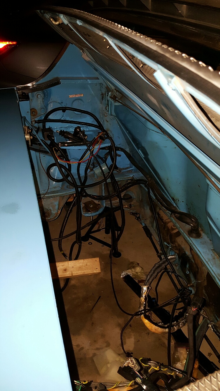

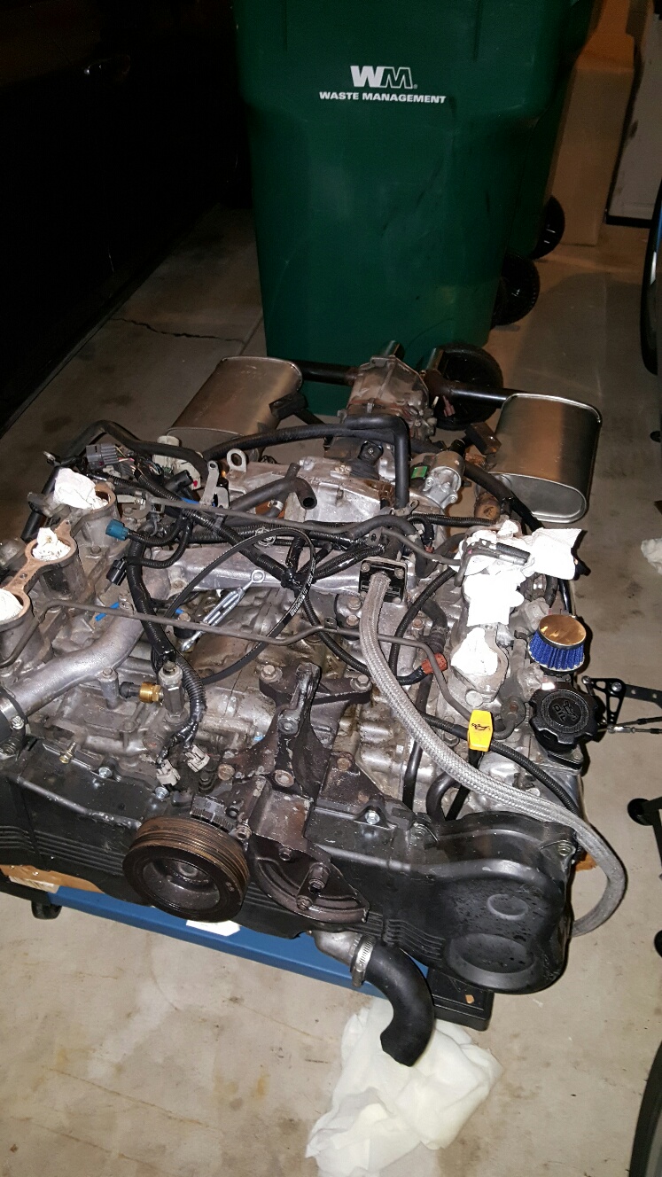

Well I finally got the engine out. There she sits.
That's a lot of work. Still need to clean up the mess. I'll be working on it this week.
Lesson #1 - NEVER EVER do anything "for now". I have a list of stuff I wish I did all the way the first time but wanted to get the car running and driving quickly. It's a long list.
Look at that hole. Always makes you think "hey, what else could I shove in there?" Starting to get an itch for an LS engine...but we'll stick with this one for now.

(IMG:style_emoticons/default/agree.gif) LS and a boxster transaxle share looks tempting, but then like you, I'll stick with what I go for now.

LOL very funny Kent (IMG:style_emoticons/default/biggrin.gif) . Yes I will definitely pick up the pics thing. Confession...I feel pretty dumb that I did not put a coolant drain valve in...and made a pretty big f&*(&*(ing mess draining the coolant. No other way to put it. One of the many things I should have done correctly the first time (IMG:style_emoticons/default/headbang.gif) . No matter how many times I thought it was dry, more kept coming when I leaned the car this way or that way. So because we have small dogs it was like a haz mat spill every time more than a few drops hit the garage floor. Clean, scrub, wipe floor, rattle the hoses again, etc.
So Kent and Mike, I need to reseal the oil pump, flip the manifold (not as easy as it sounds as George mentioned), check all the sensors, clean the engine and trans a little better, tidy up the wiring.
