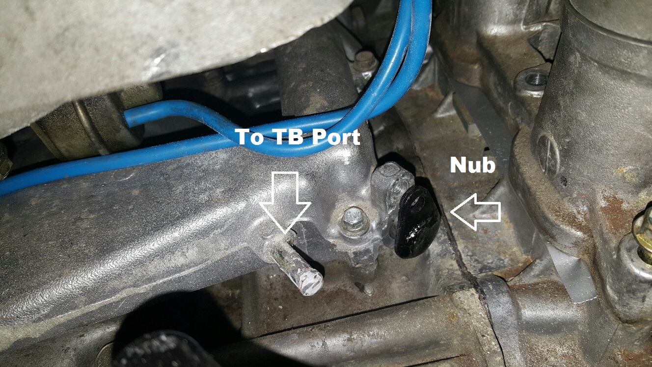

Here's a few updates...fuel injectors checked out fine and will be back tomorrow.

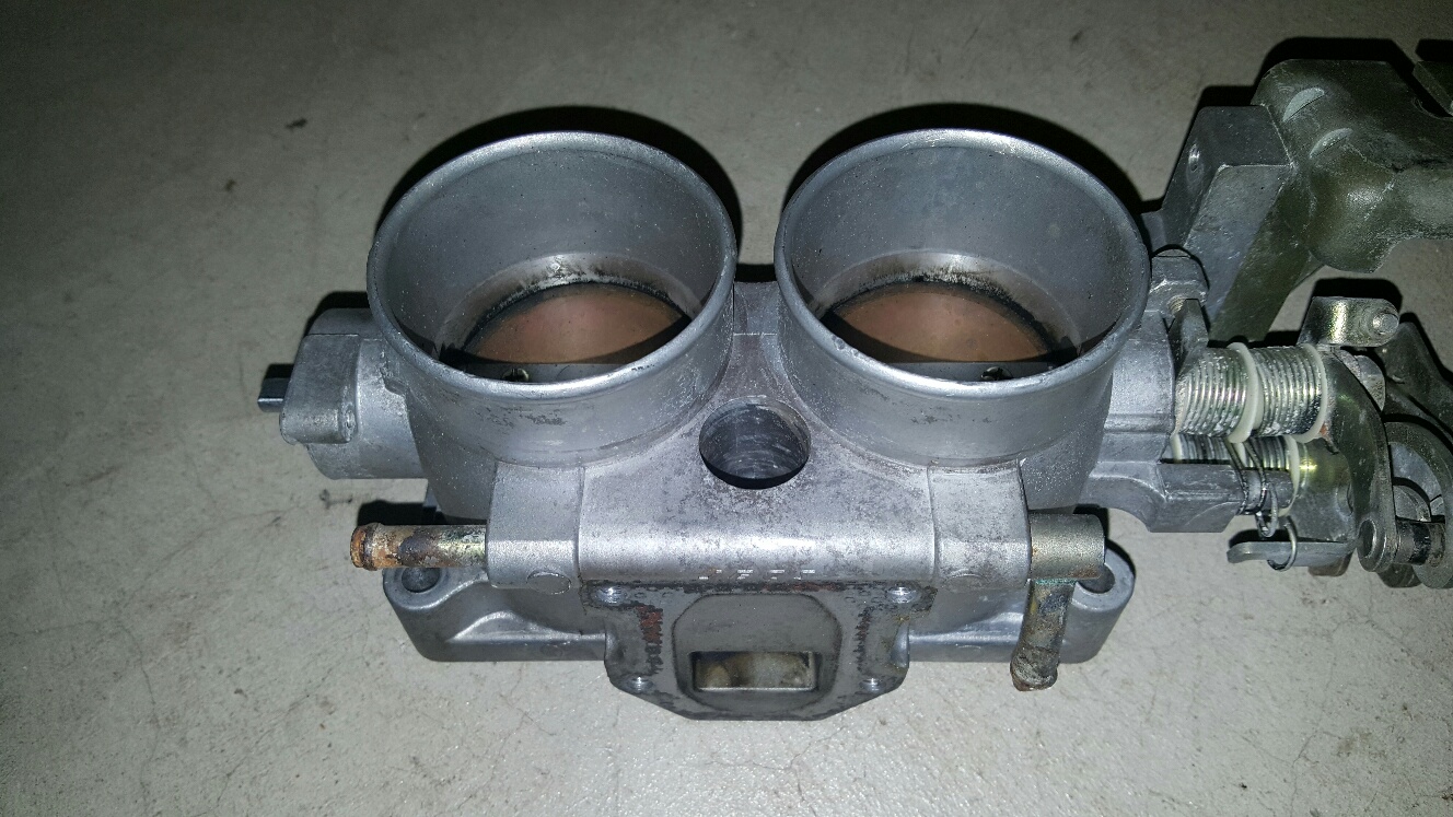

Some modifications I did to simplify things:

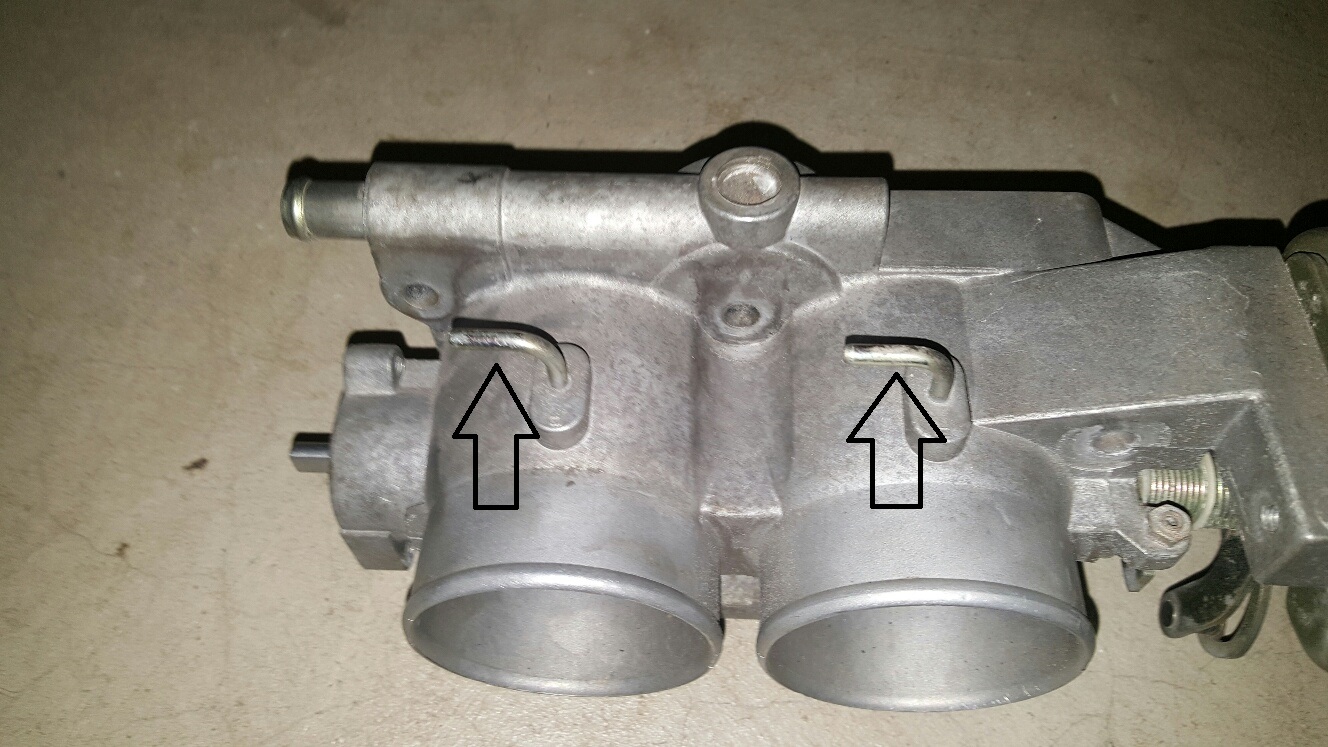

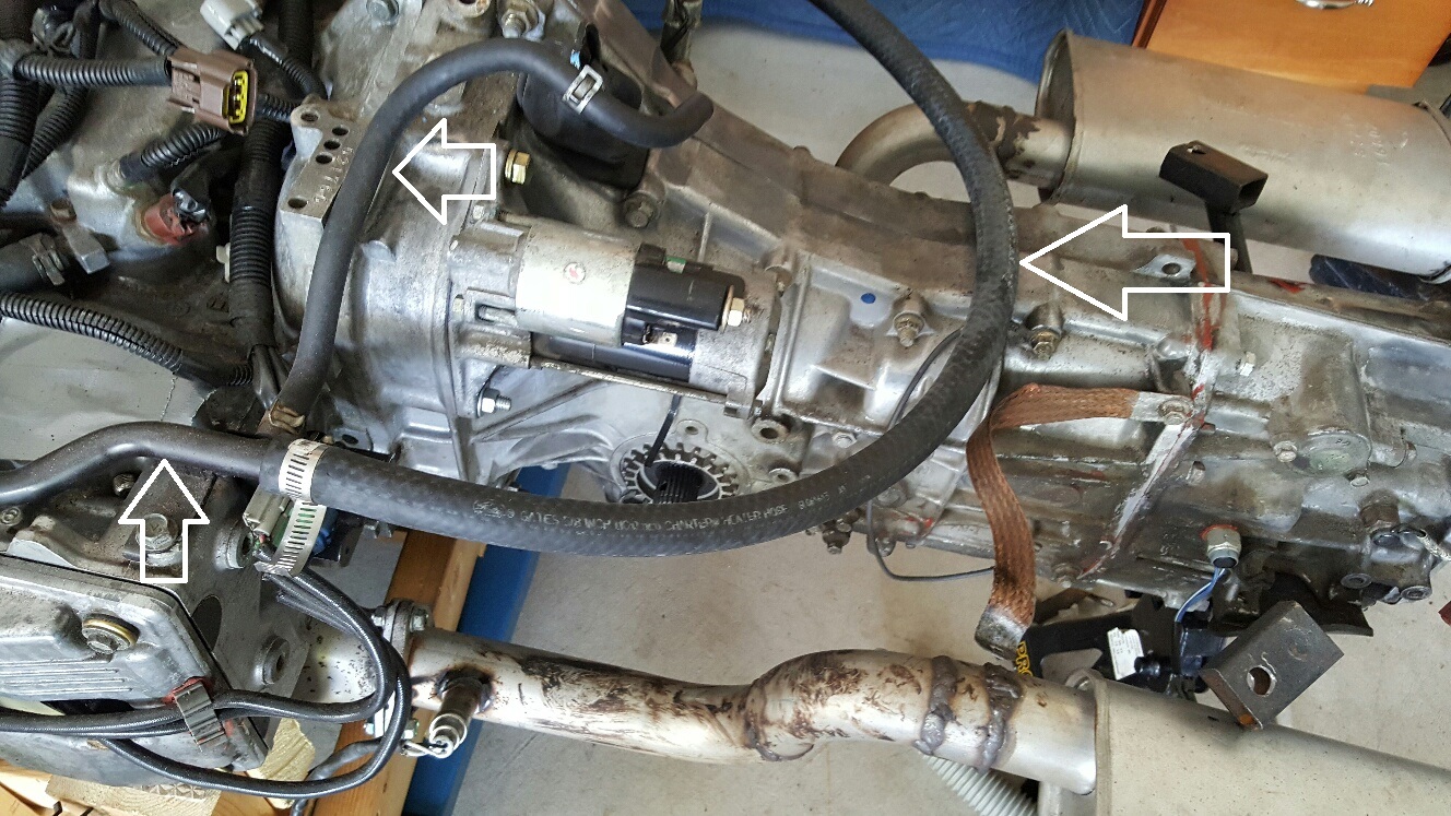

First I eliminated some coolant lines. There is a set of lines that run to the heater core on the SVX which I ran a loop of 5/8 " hose as a temp solution initially but realized I just don't need it. If/when I install a heater I'll pipe it from up front rather than running lines all the way up from the engine. I also eliminated the smaller lines that pass through the throttle body. These heat up the throttle body to help the engine run better out of the gate when it's cold, but I don't think it's necessary since I won't be driving my car during the winter and I'm flipping the intake anyway. MANY SVX guys disconnect and do a pass-through on this line because they don't like the fact that it keeps the throttle body hot all the time. They also claim small hp gains (IMG:style_emoticons/default/rolleyes.gif) . It's just cleaner for me. You can see the lines arrowed here, plus there is another one coming out of the silver crossover pipe on the other side.
The one on the driver's side runs all the way down to the water pump so it really freed up some space when I took it out. I don't have a good picture of the one connected to the crossover pipe on the passenger side, but here it is cut down to the nub.
This is where it gets a little JB Weld crazy...I filled the "nub"with a special JB Marine Weld that has the properties of JB Weld but also can be submerged in water/mildly corrosive liquids indefinitely. It's hard as a rock now and about an inch thick. Not going anywhere. I also filled the smaller port that connected to the throttle body. (The nub is not fully installed yet. I have to paint some stuff.)

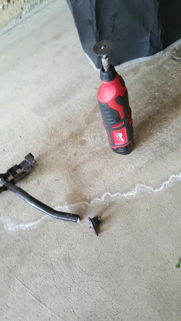

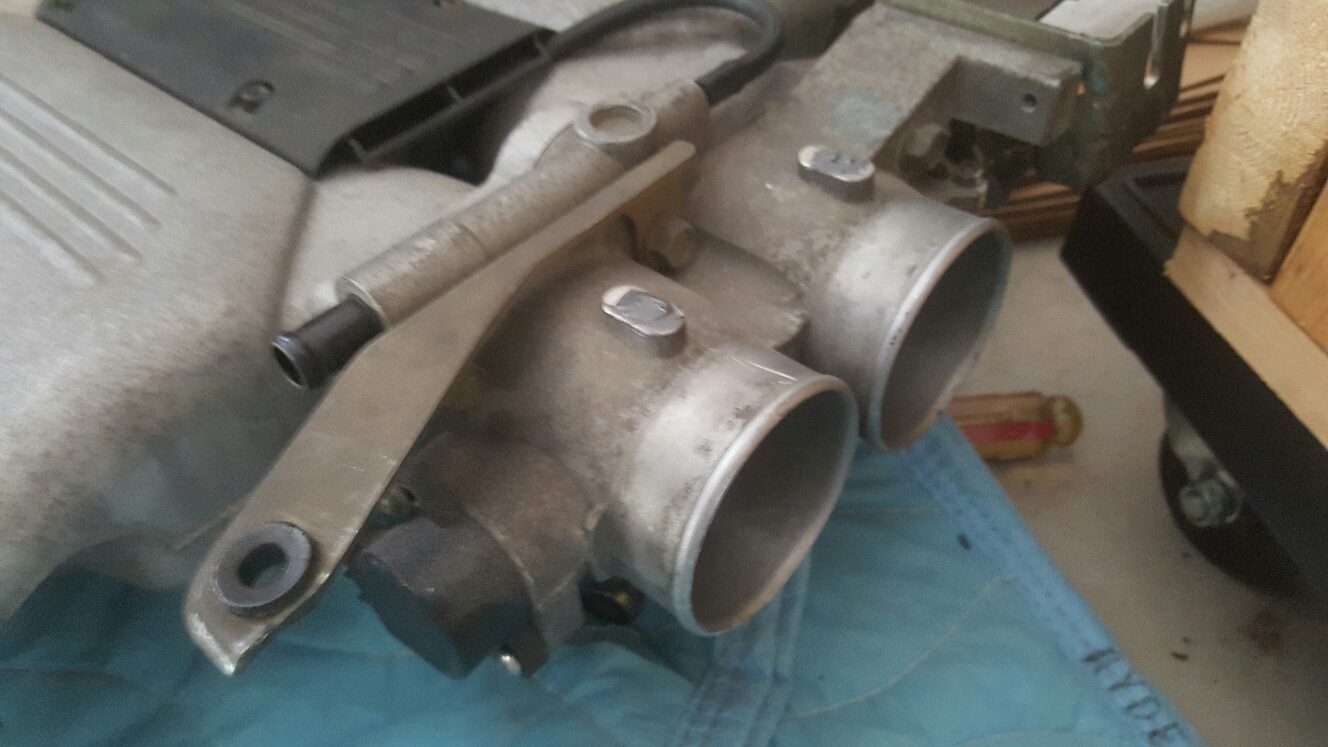

But did I stop there? Nooooo....I have eliminated my EGR system, but never cut these suckers off...they are in the way.

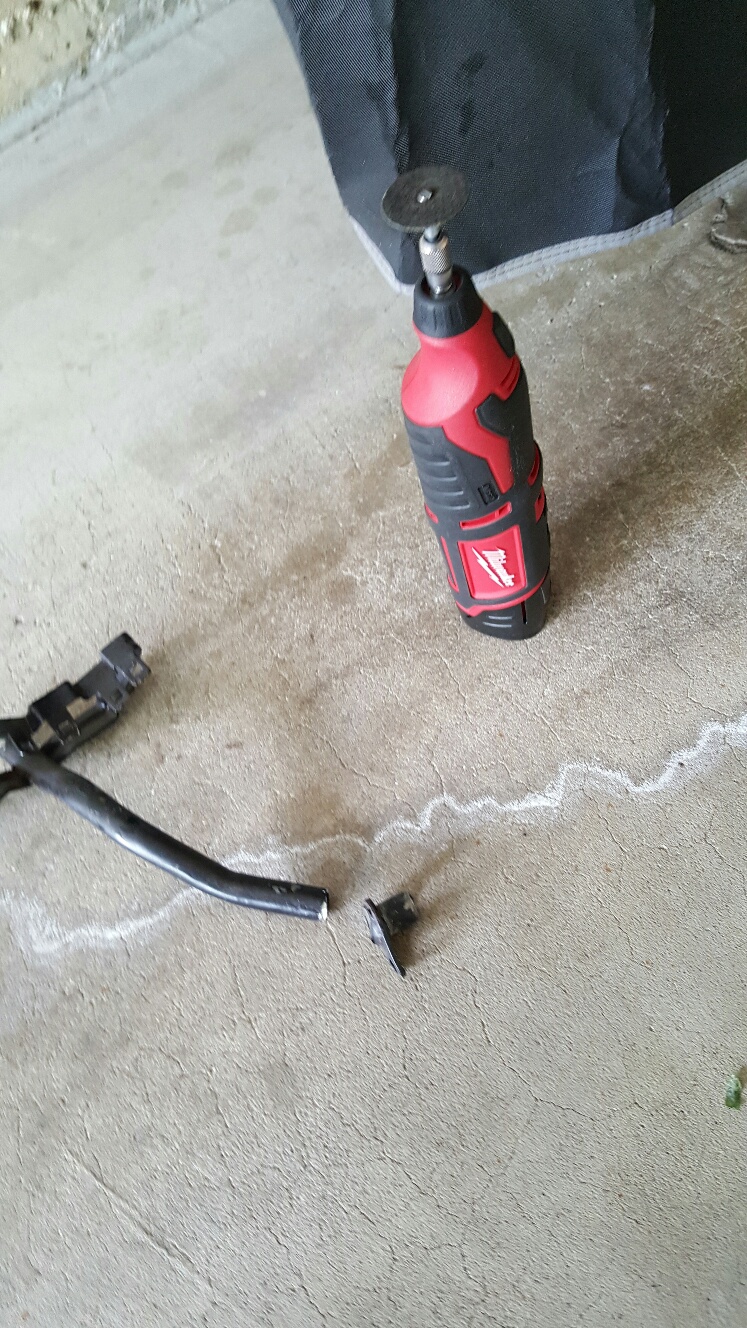

So...I cut them off, taped the underside and...you guessed it...JB Weld!!! If you do this make sure to leave little extra on top and grind it off later. It will settle a bit as it dries over several hours or a day. Then shine a flashlight through to make sure you filled it completely. The holes at the TB underside are VERY small.
Glop on top:
30 seconds with the sandpaper dremel attachment

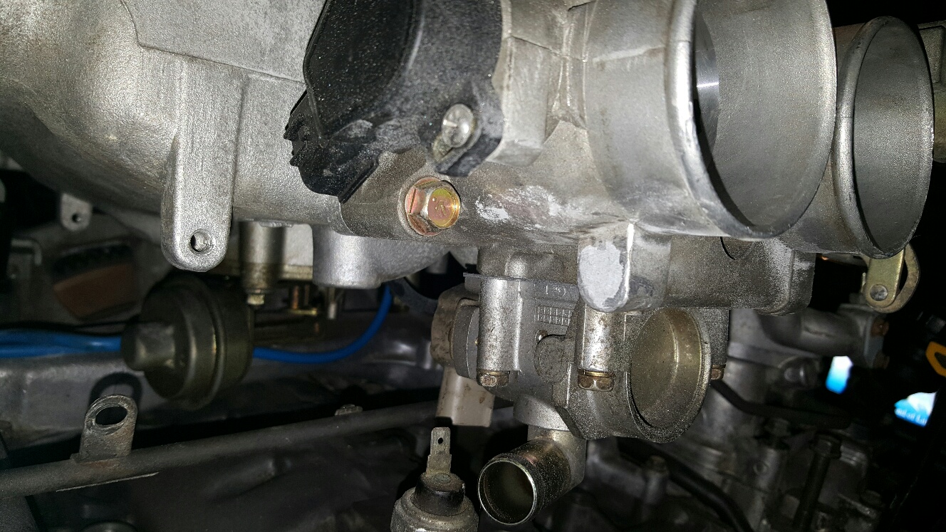

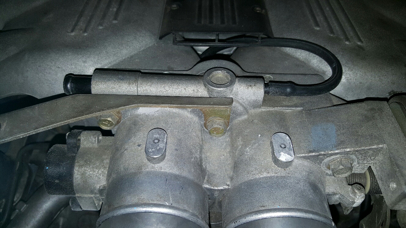

And since I eliminated the throttle body coolant line...why not cut these off and save some room since the manifold flip jams a bunch of stuff together?
Now what could I stuff in the empty hole... (IMG:style_emoticons/default/idea.gif) ...is there some kind of JB Weld putty? YES.
Next I have to slightly reposition my intake valve so I can complete the manifold flip, install the injectors, and get this thing ready to reinstall. I think the alternator positioning is going to cause me problems. We'll see.

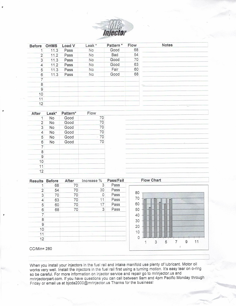

Got the injectors back! They look brand new. I'll leave them in the bag until I reinstall them on the rails. If yours haven't been cleaned in a while...take a look at this:
Not terrible, but all it takes is one not flowing well and you have a problem. I had two in the weak category. Should see a difference for sure. Bet the other set is worse since most of the pintle caps broke off in my hand. $17.50 each. Not bad at all.
***EDIT***: Hey BTW I read on the subaru-SVX site that Mr Injector will take the injectors off of the rail for you. I don't think he charges for it. You just send the whole thing. It was an old thread so you might want to confirm.
