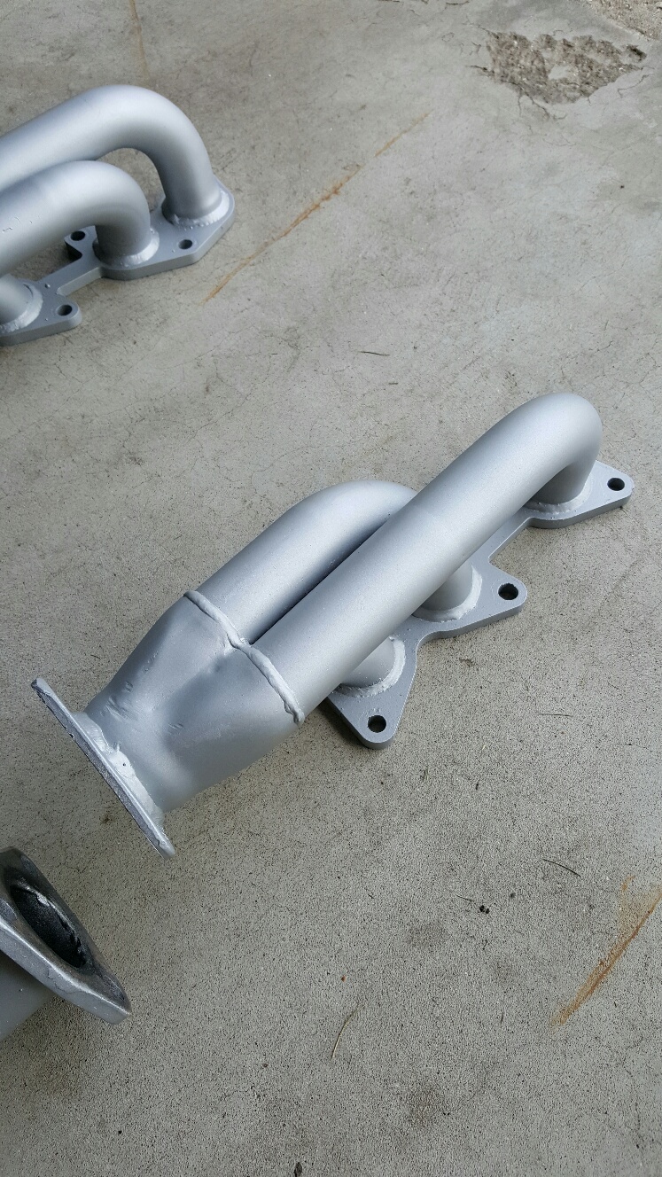

Yes I got my headers from Bob who got them from Outfront. They are very compact.
BTW I painted them up real nice.
Before:
After:

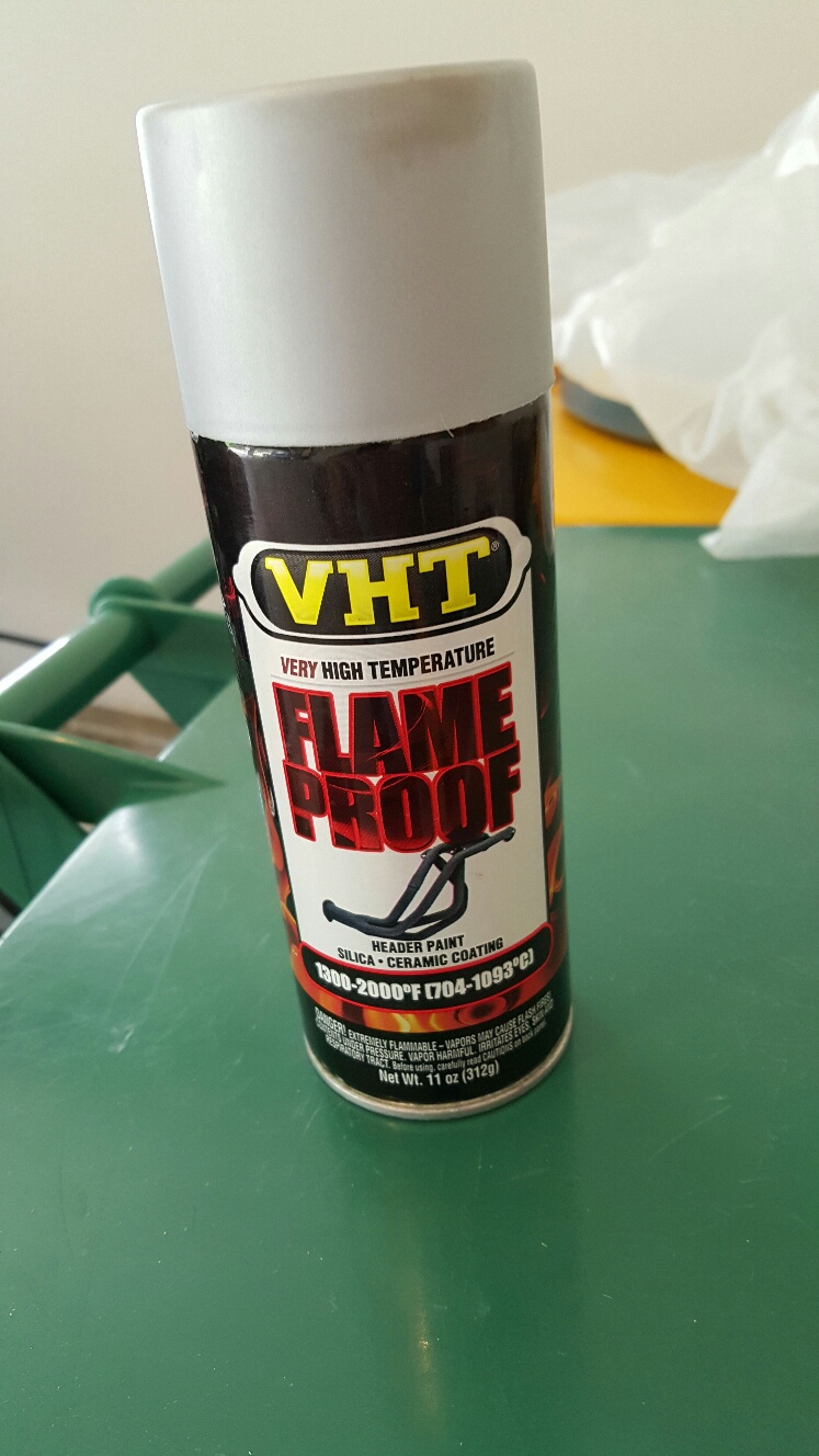

This ceramic paint is really good:
Stinks and smokes a little while it's curing for a couple minutes, then it's on there for good. Was pretty sure the wires were melting until I figured out where it was coming from. Then it stopped and no smell at all since.
