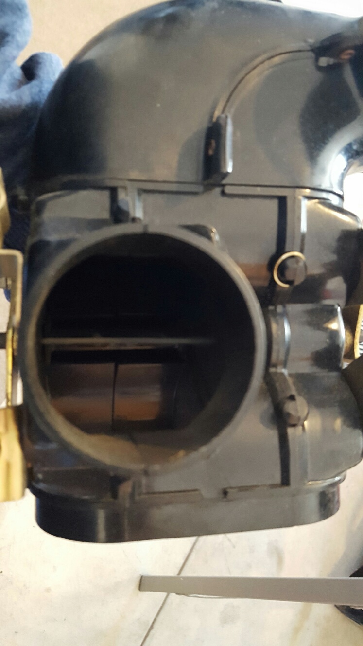

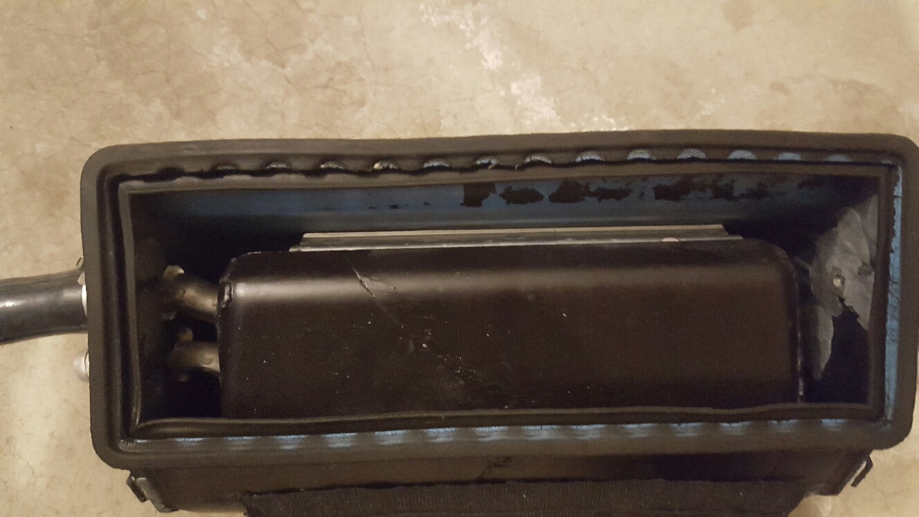

Update...working on the "heater core in the fresh air box". First I had to take the wiper assembly out to lube it and change the rubber mounting bushings. Dang that thing is not fun to reinstall!

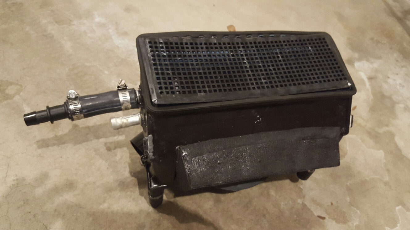

Here is the modified airbox.
FYI the STOCK mid-90's mustang heater core is a little too thick to fit inside the fresh air box. I had to modify mine a bit. I'd go for the thinner aftermarket one if you're going to do this.
I'll have a bleeder valve on the higher line and a Rabbit open/close valve on the lower intake line.

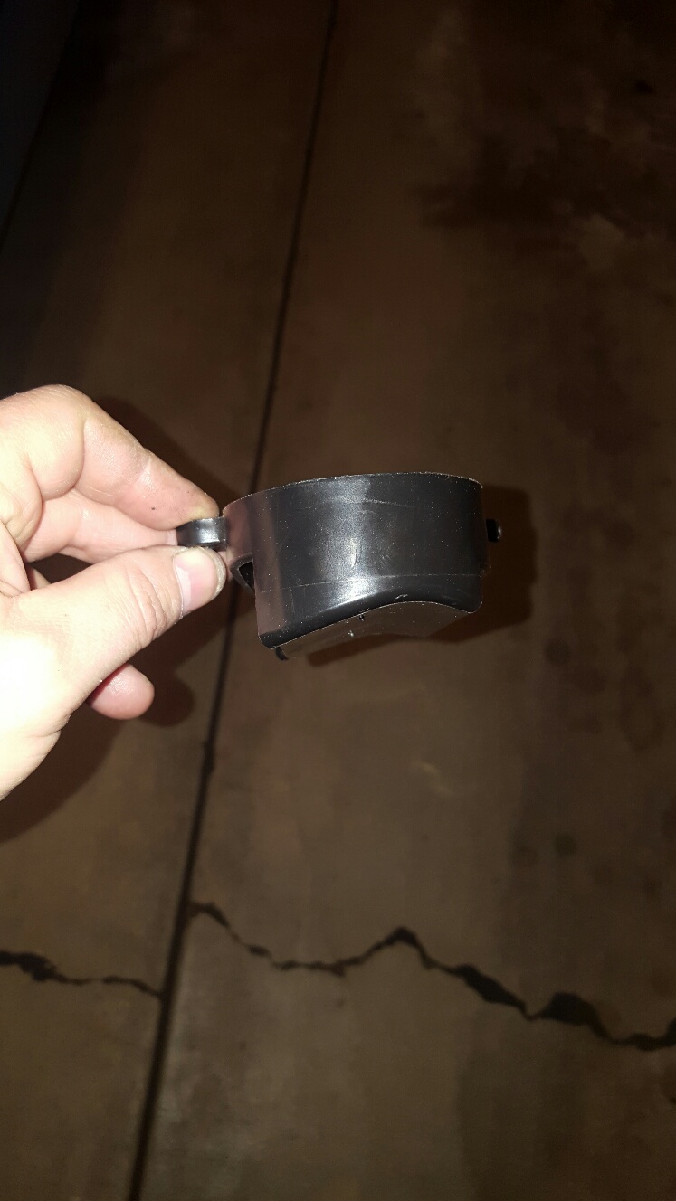

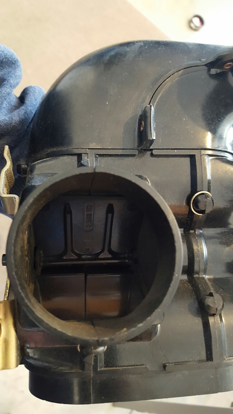

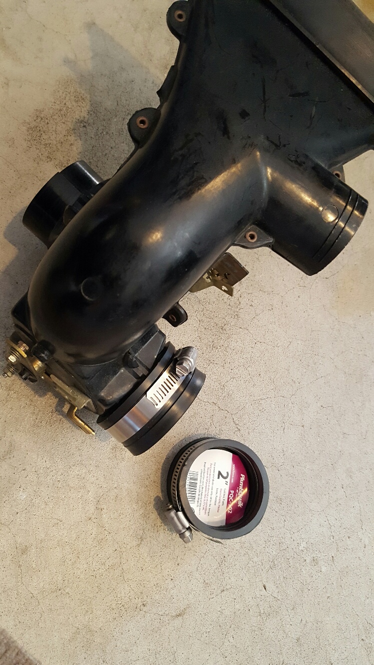

So if you do this you will be eliminating the tube that comes up from the passenger compartment and connects to the heat/fresh air distribution system up front through this:
You can seal them up with these 2" rubber plugs from the plumbing aisle at Home Depot:

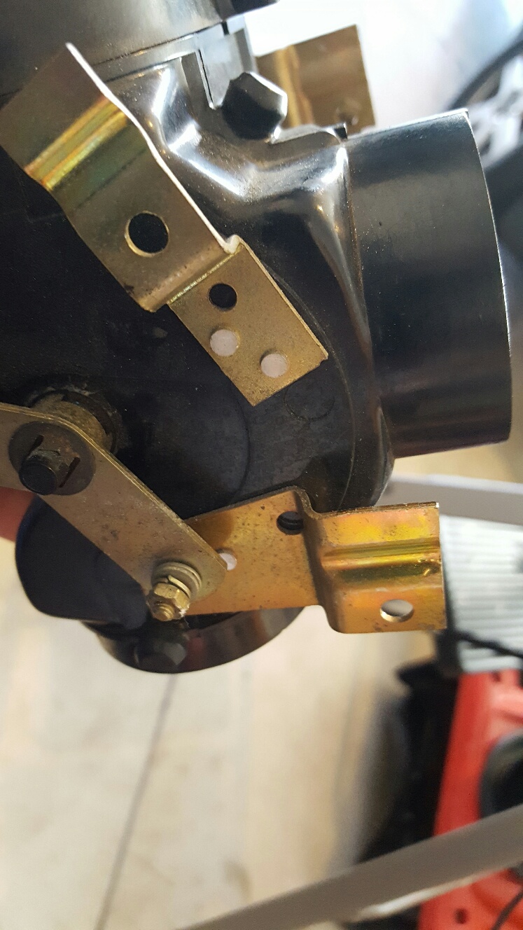

You also want to lock the flapper in the up position to keep any heat/fresh air from escaping or coming out the wrong area.
Permanently lock this
Now...couple of quick questions...

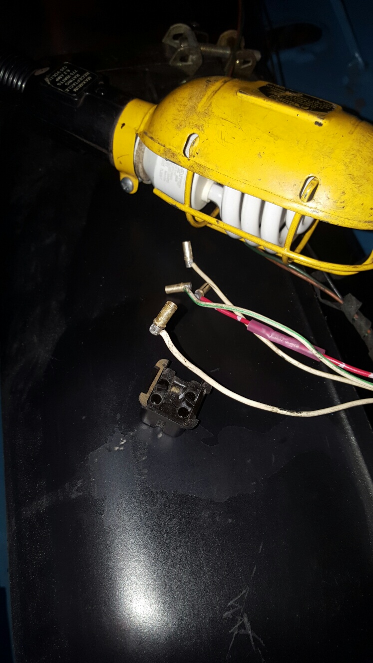

Does anyone know how the wires that connect to the fresh air box go back in to the connector they go in?
Could someone look at their 914 and see which way their lower heater outlets under the dash are pointed? Does the wider opening point towards the middle of the car or towards the door?

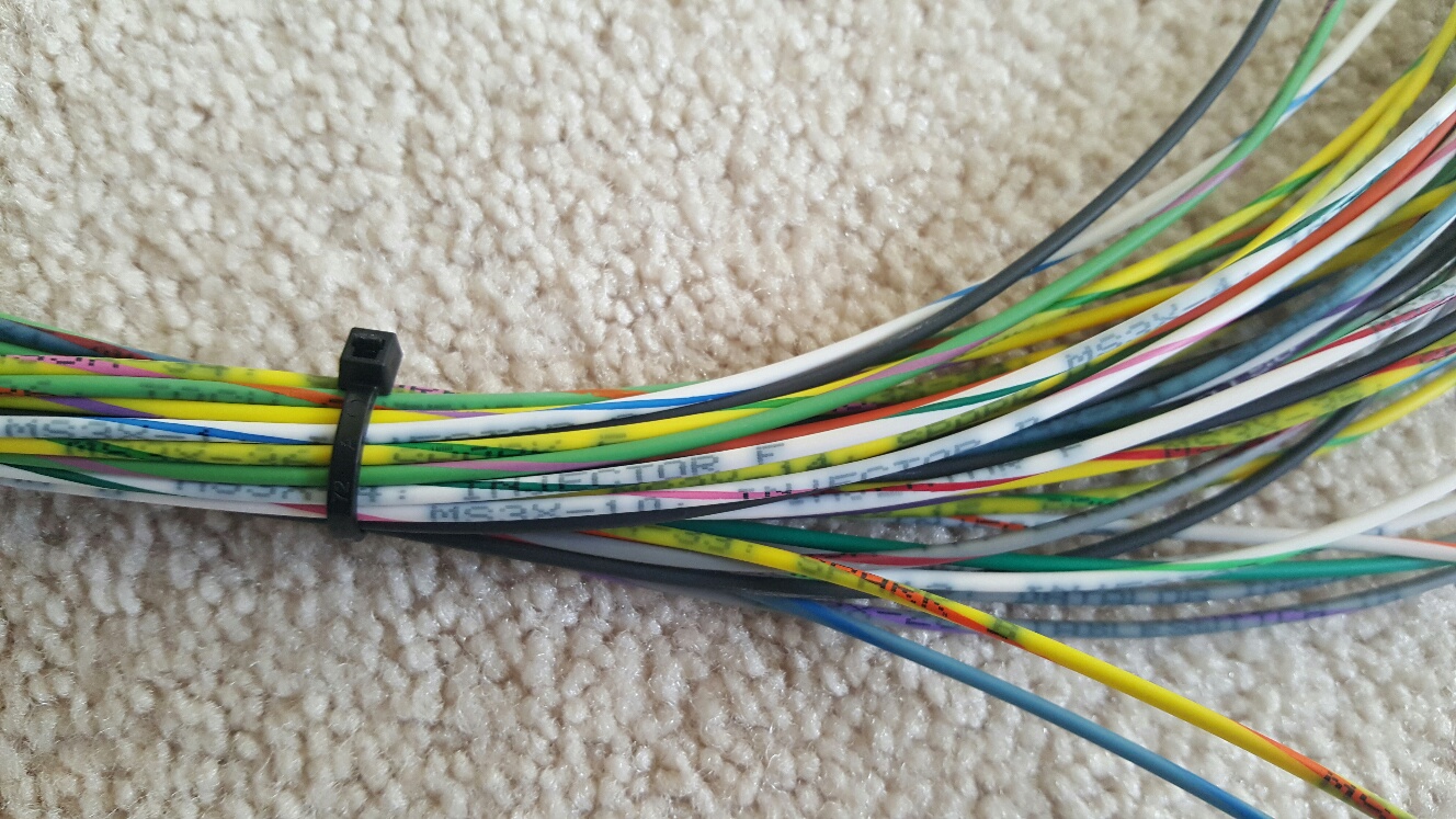

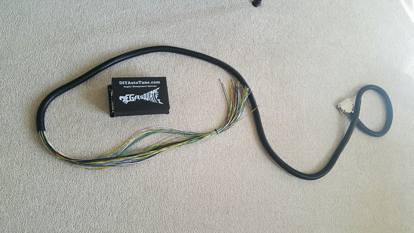

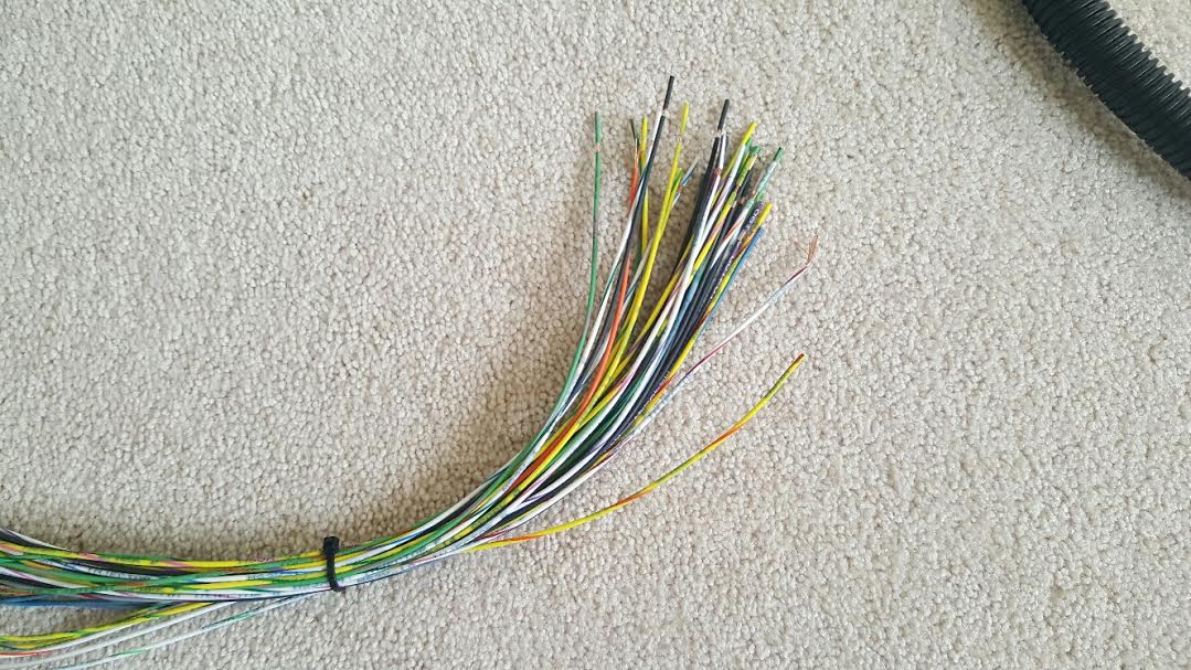

I just keep looking at this thing...the simplicity...why did I wait so long?
Every wire is imprinted with the function.
The EG33 ECU itself has 76 wires. There are also ~4 more that connect to other things. This harness has 36 wires, many of which won't even be used.

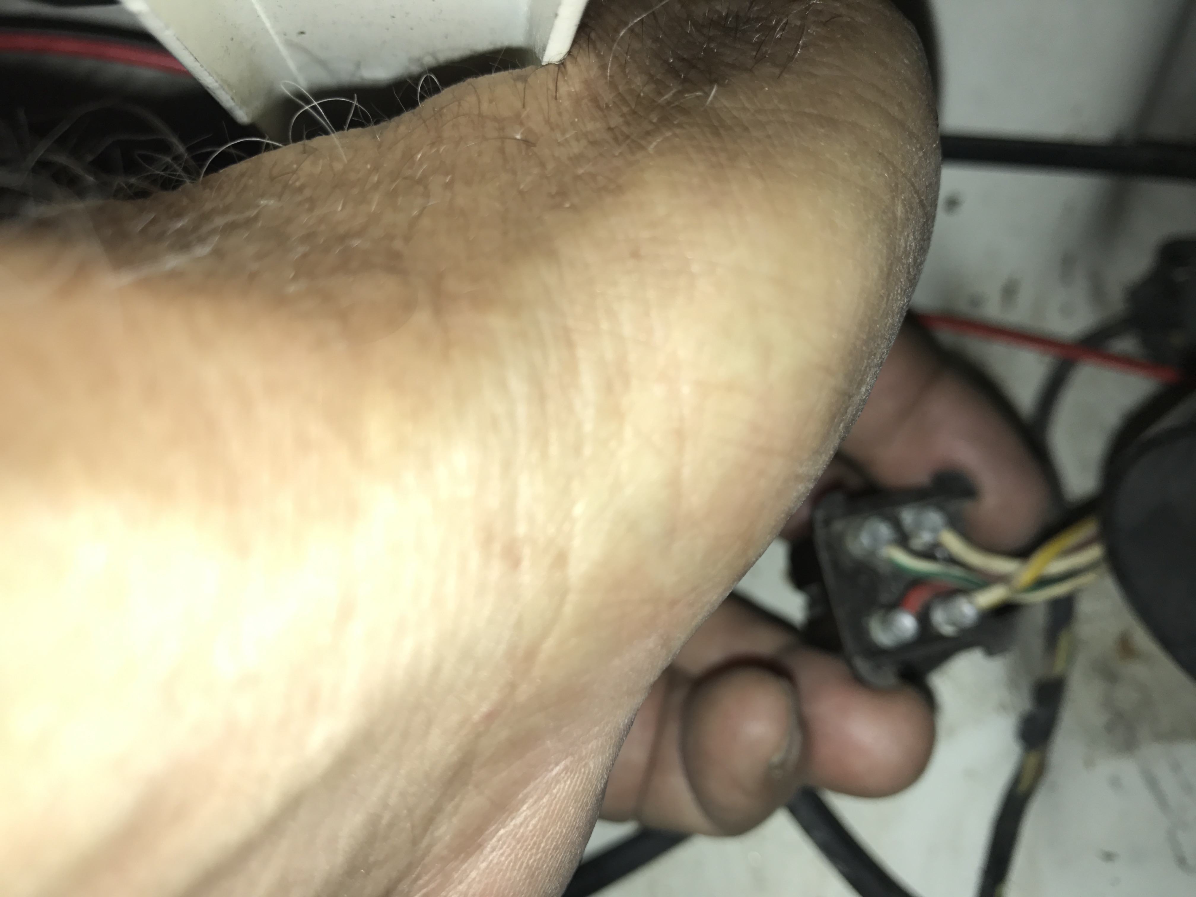

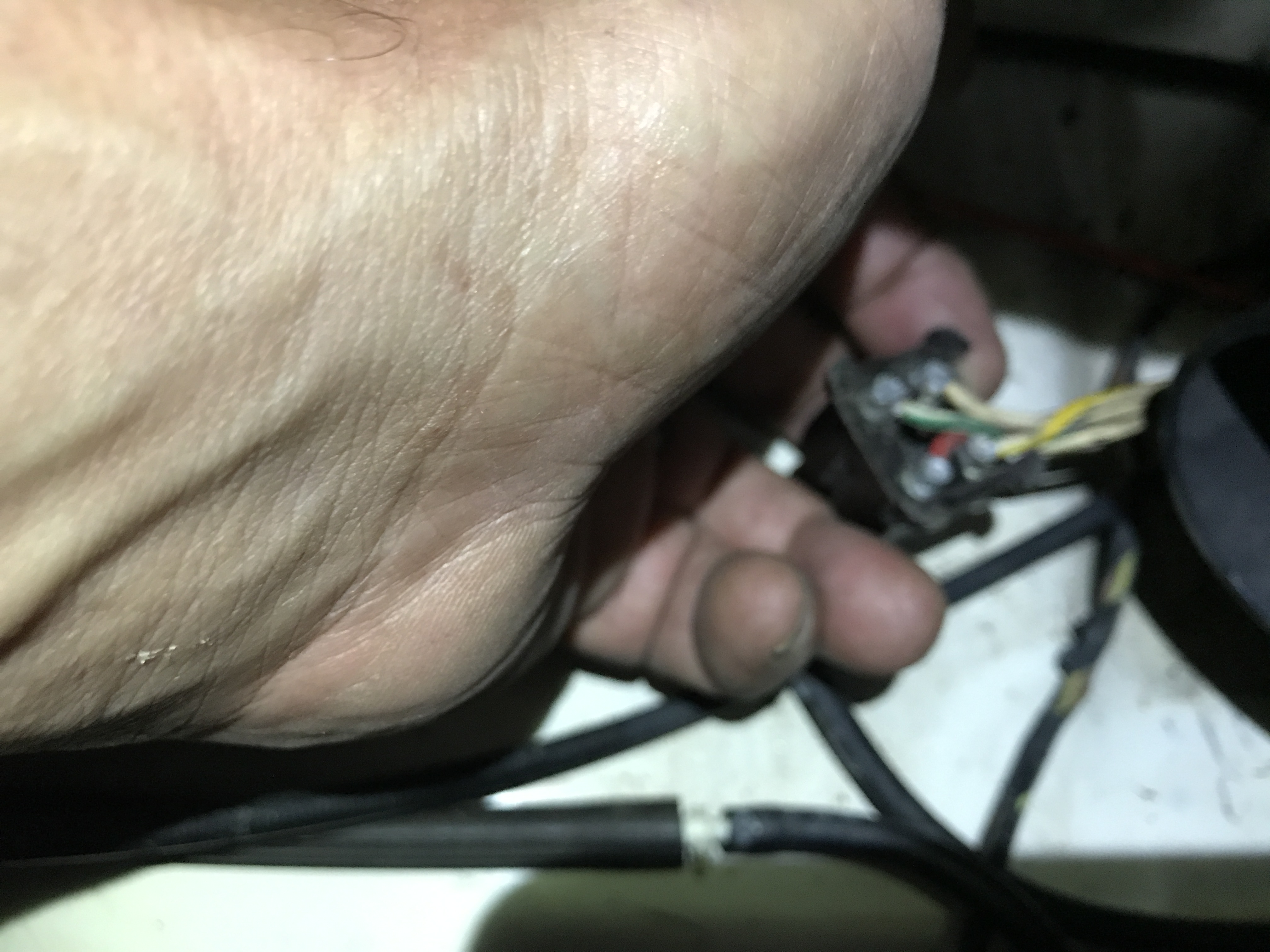

BTW also could someone PLEASE look at the plug that is connected to his/her fresh air fan up front and tell me which wire goes in which slot here? It's the 4 connector power source for the fan. Thanks!

I can check my 76 when I get home. Pm me so I don't forget! (IMG:style_emoticons/default/lol-2.gif)

Hard to get to. Even after I removed the expansion chamber from the gas tank. Looks like I used Andy's camera. (IMG:style_emoticons/default/av-943.gif)

Perfect! Thank you Kent! Now I can test my heater. Have to finish the timing belt job on my wife's Volvo then I'm 100% finishing the 914 refresh.

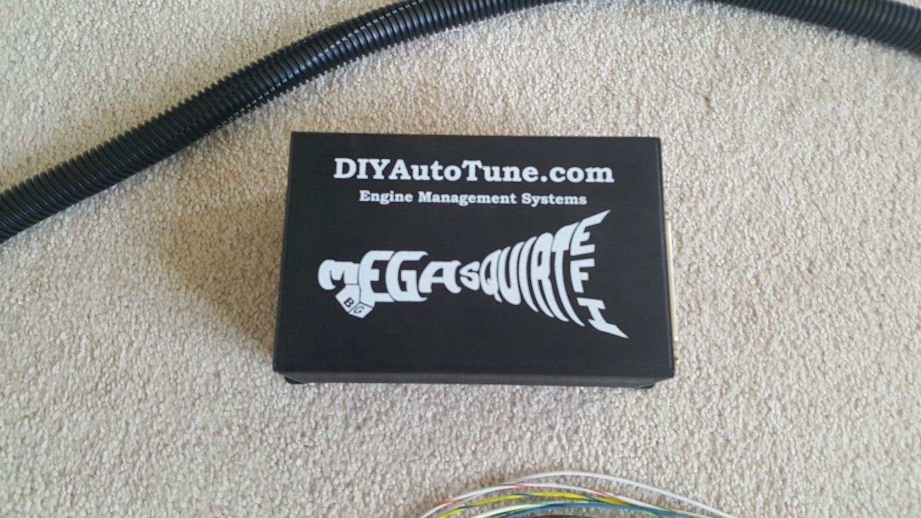

what does that Mega squirt box do,..enhance the ECU or replace it..??? TIA Frank

Totally replaces it. Also eliminates many of the unneeded stuff like the EGR, complicated fuel pump/fuel delivery system, etc.

Very cool! So is there a MegaSquirt map already available for the EG33? What are you doing with that old harness? (IMG:style_emoticons/default/biggrin.gif) (IMG:style_emoticons/default/idea.gif)

There are maps on the msextra site. I have a crap-ton of wiring I can give you when I'm done. I'll also have an extra ECU I can pass on.
