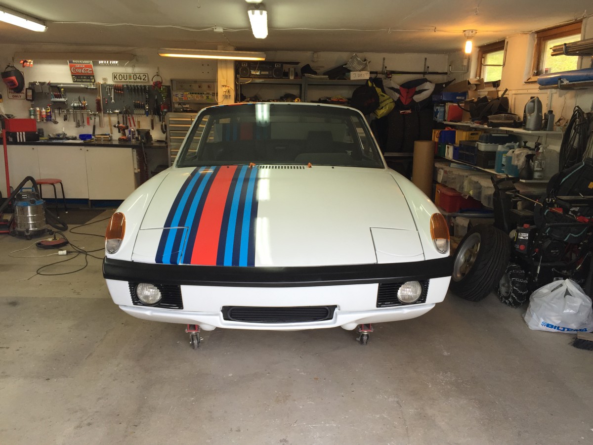

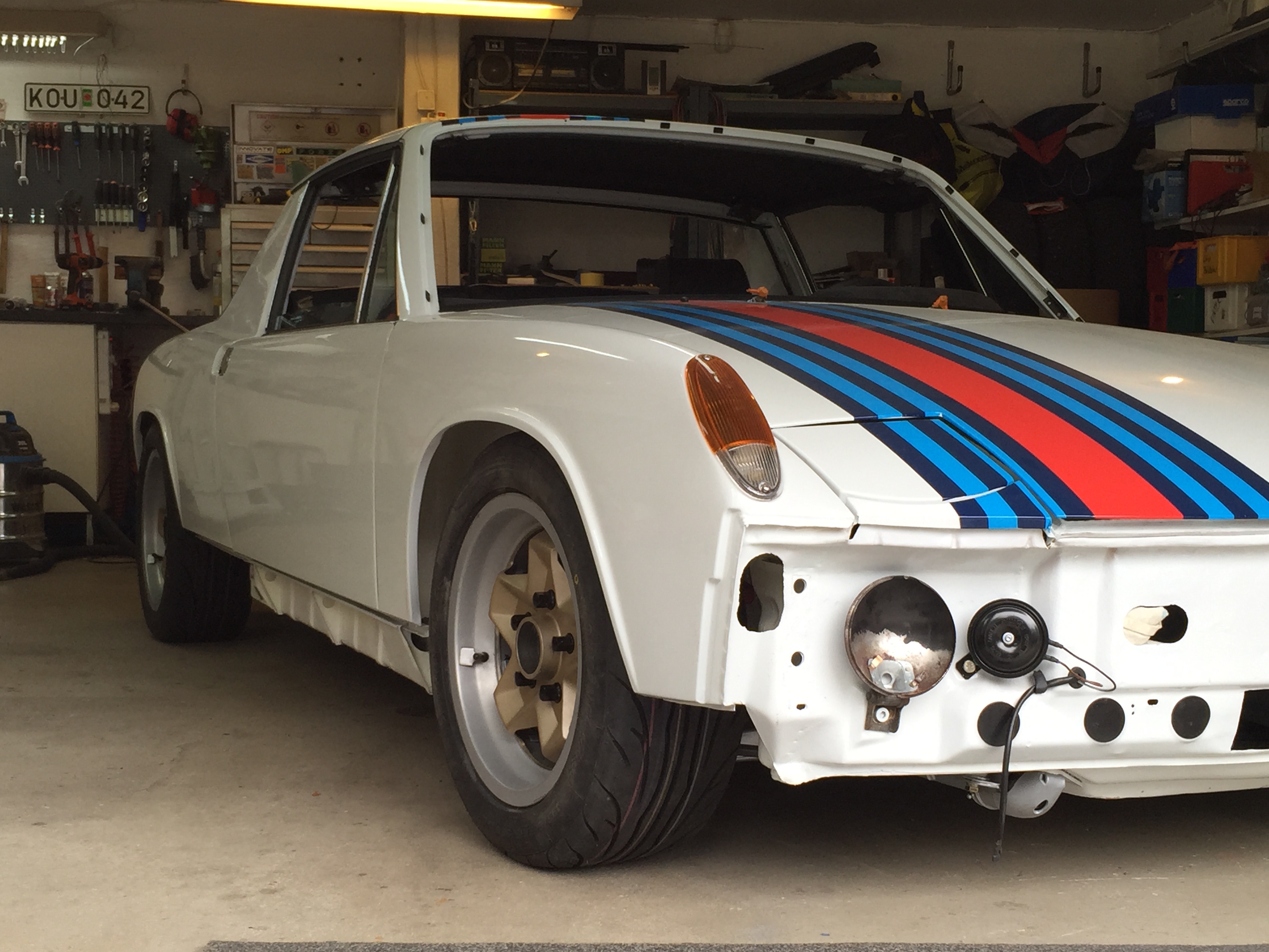

(IMG:http://www.914world.com/bbs2/uploads_offsite/matsgarage.com-15176-1439067917.1.jpg)
Today I pretty much finished up running the lines for the oilcooler and got to see the front end assembled for the first time. The bottom valance is kinda screwed up from being patched a few times but it'll do for now. Eventually I'll get a replacement one.

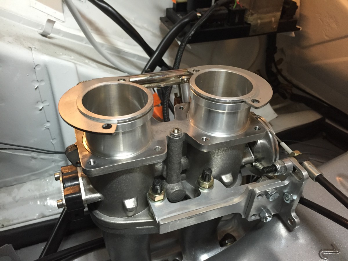

(IMG:http://www.914world.com/bbs2/uploads_offsite/matsgarage.com-15176-1439067918.2.jpg)
I also got some adapters for the ITB's, they'll let me use any IDF style air filter.

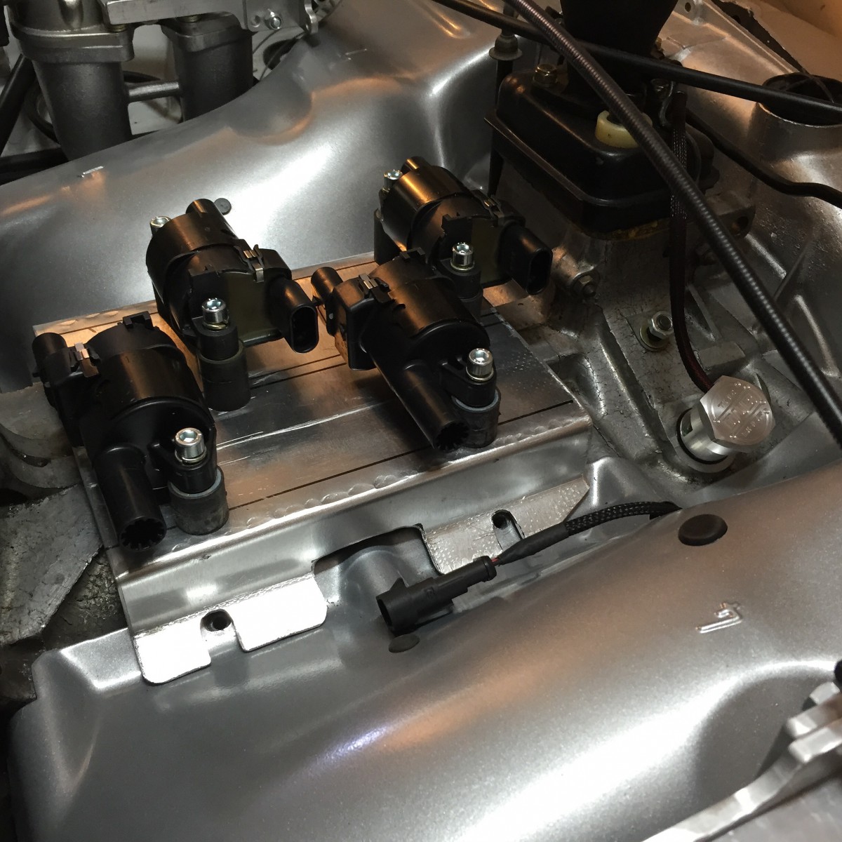

(IMG:http://www.914world.com/bbs2/uploads_offsite/matsgarage.com-15176-1439067920.3.jpg)
Also got the LS2 coils and made a bracket for them.

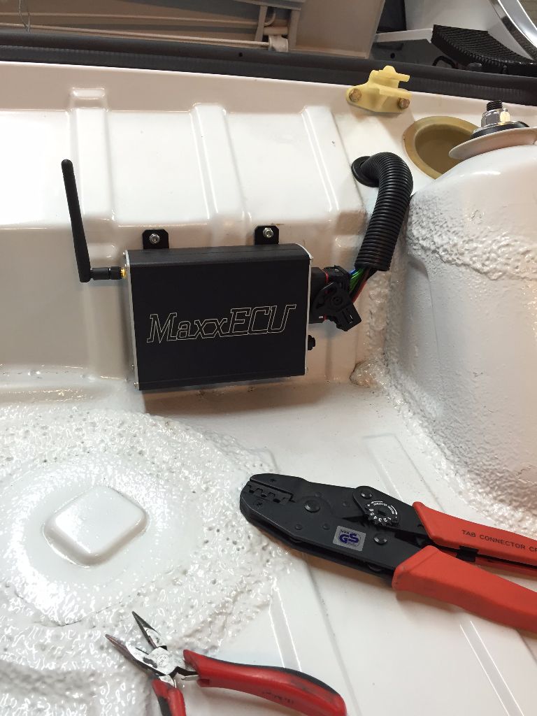

(IMG:http://www.914world.com/bbs2/uploads_offsite/matsgarage.com-15176-1444211646.1.jpg)
ECU mounted

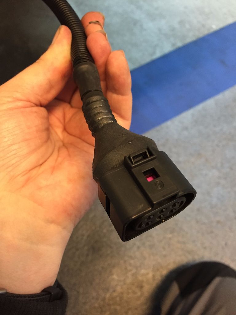

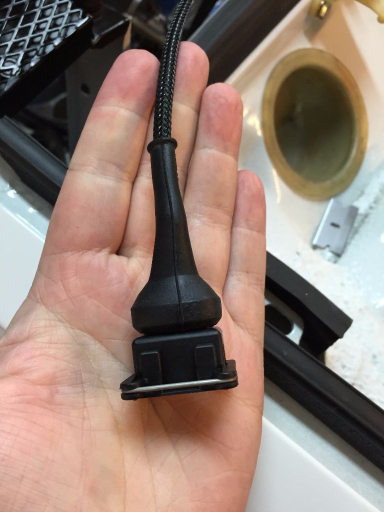

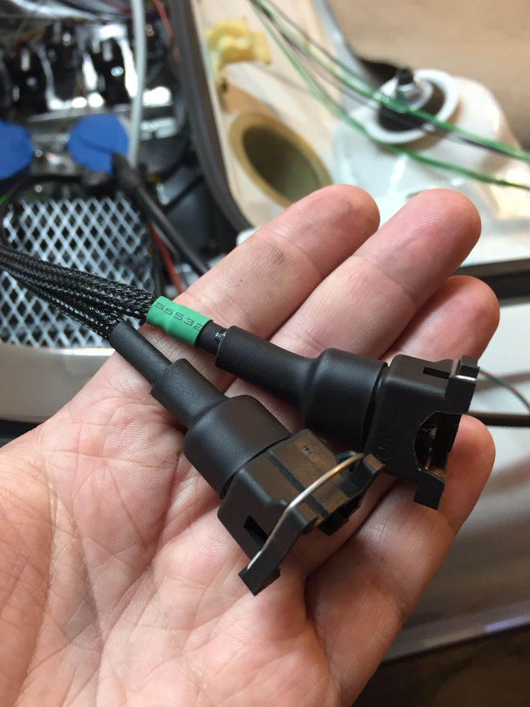

(IMG:http://www.914world.com/bbs2/uploads_offsite/matsgarage.com-15176-1444211647.2.jpg)
Injector connectors

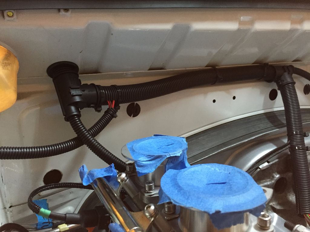

(IMG:http://www.914world.com/bbs2/uploads_offsite/matsgarage.com-15176-1444211648.3.jpg)

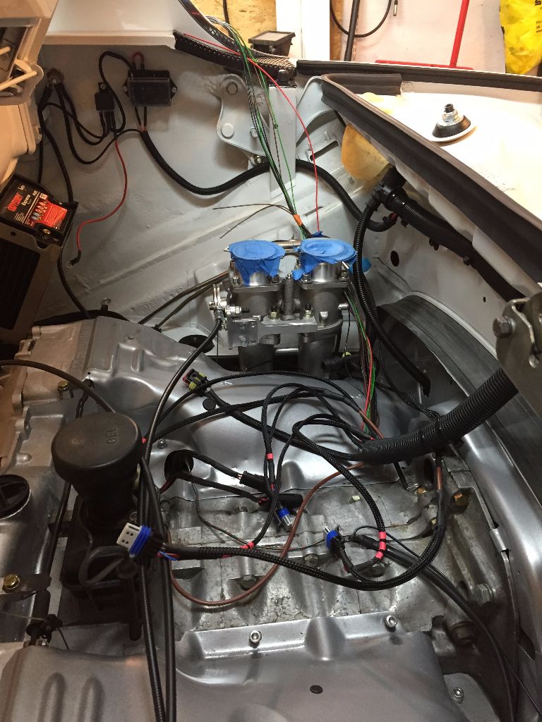

Engine harness routing
