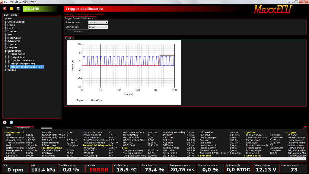

Houston, we have cranking rpm... (IMG:style_emoticons/default/biggrin.gif)
Got some work done today. Pulled the intakes off, removed the plugs and checked the plug gaps. All good. Proceeded to mount the oil filter, fill the engine with oil.
Then I built a remote start switch and hooked it up. *drumroll* It cranks! (IMG:style_emoticons/default/smile.gif)
(IMG:http://www.914world.com/bbs2/uploads_offsite/matsgarage.com-15176-1451149010.1.png)

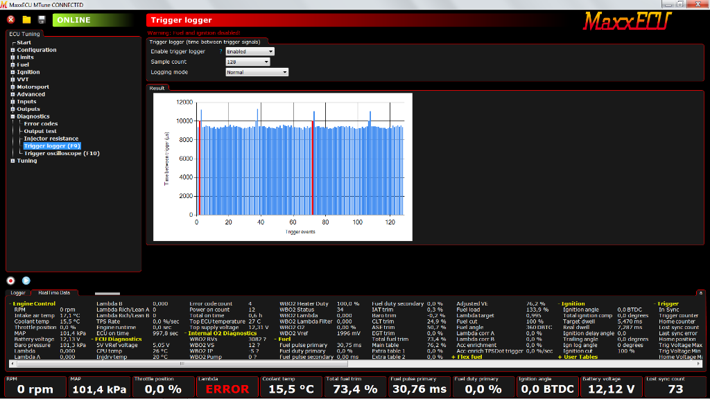

Nice with a built-in oscilloscope in the tuning software.
(IMG:http://www.914world.com/bbs2/uploads_offsite/matsgarage.com-15176-1451149065.1.png)

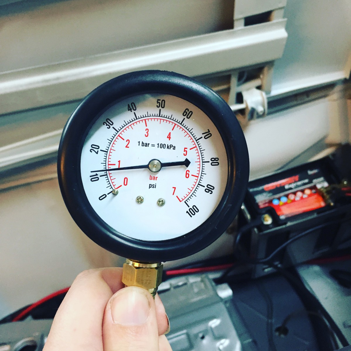

(IMG:http://www.914world.com/bbs2/uploads_offsite/matsgarage.com-15176-1451494467.1.jpg)
Oil pressure is up.

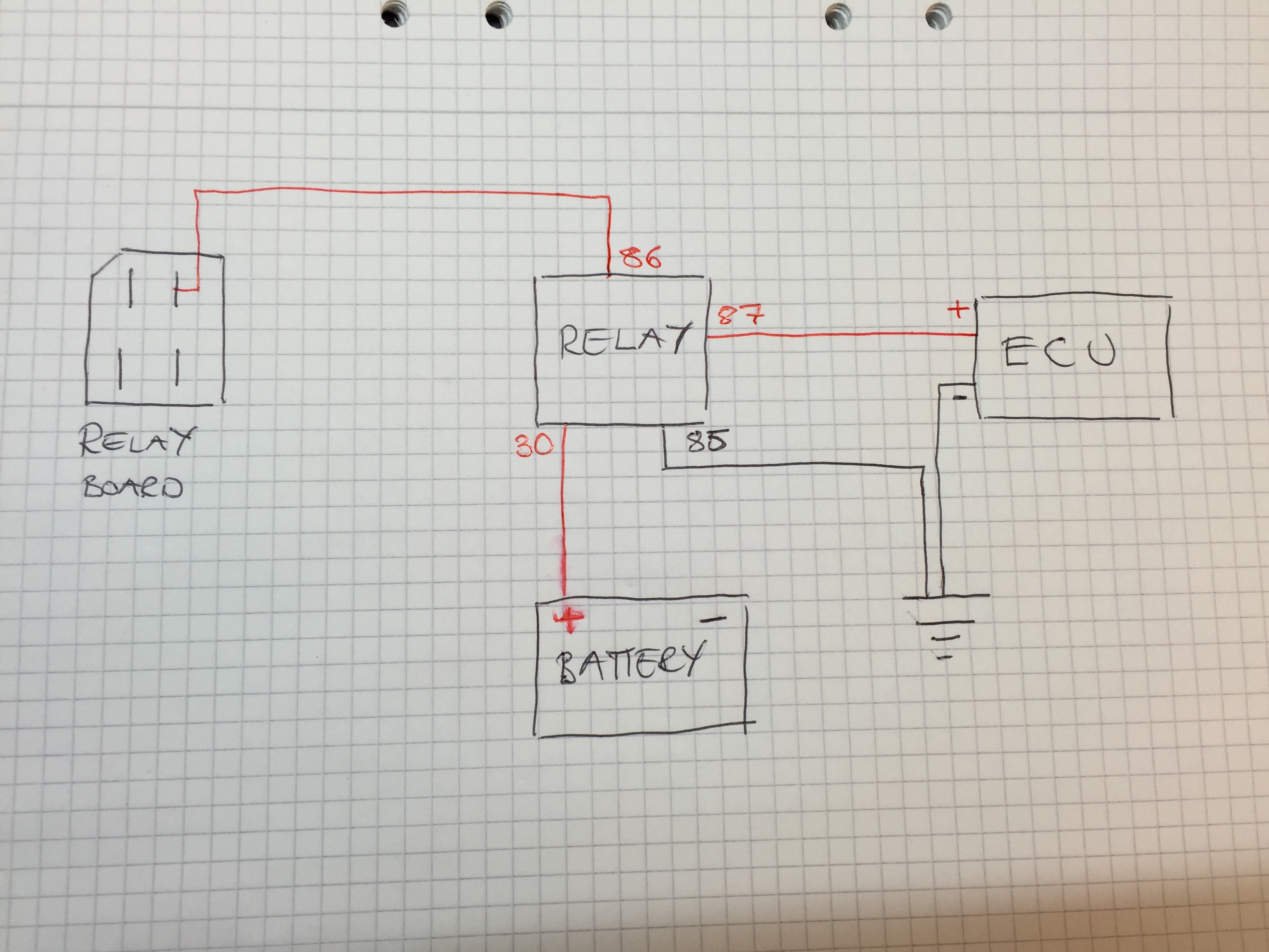

Granted firing it up revealed a few issues to be solved.
1. The new hi torque starter doesnt disengage quick enough, you can hear the slight whine in the beginning of the video till it disengages.

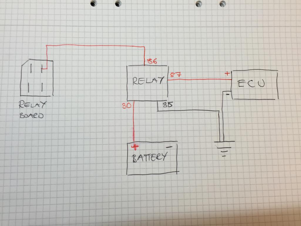

2. Turning the key off doesnt kill the engine, it keeps running and I have to kill it via the laptop interface to the ecu. I'm not sure why this happens.
This is how I've hooked up the ecu, switched power from the post on the relay board to a separate relay that controls the power to the ECU.

Your first two issues could be caused by a single thing. There might be something feeding back into the switched power circuit. I've done that by putting the wrong type of bulb into the taillights, for instance.
You don't have to drain the oil, or remove the exhaust, to replace the valve cover. There might be a little oil in the rocker box, but the "resting" level of the oil in the crankcase is below the bottom of the rocker box.

QUOTE(Dave_Darling @ Jan 17 2016, 06:56 PM) *
--DD
I found a thread earlier today (cant find it now tho) about the alternator backfeeding current when you turn the key off, just enough to keep the power relay energized.
The engine should die if you for instance push the brake pedal and this is exactly what happens to me. Turning the key off doesnt kill the engine but then pushing the brake pedal to light up the brake lights kills the engine. Apparently putting a diode in somewhere would fix this issue.
Edit: http://forums.pelicanparts.com/porsche-914...l-not-stop.html

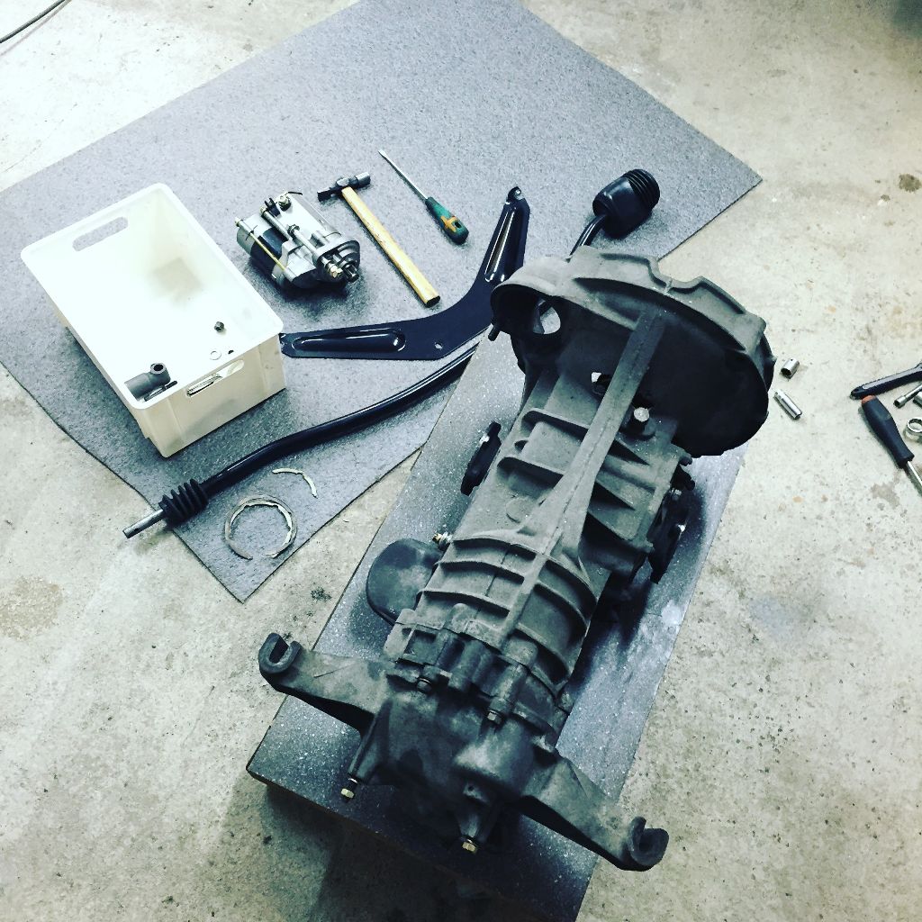

The last few weeks has been spend fixing issues found after getting the engine to start reliably. The biggest hurdle was the throwout bearing.
(IMG:http://www.914world.com/bbs2/uploads_offsite/matsgarage.com-15176-1455225577.1.jpg)
Last weekend the gearbox came out and I ordered a new throwout bearing and all the associated small parts.
(IMG:http://www.914world.com/bbs2/uploads_offsite/matsgarage.com-15176-1455225578.2.jpg)

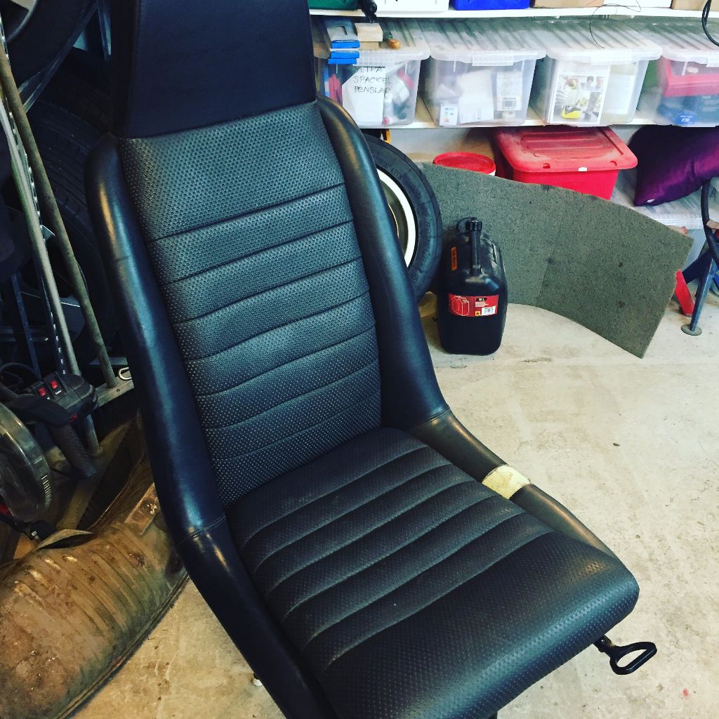

While waiting for the parts to arrive i cleaned up the seats. They need to be recovered eventually but for now the California patinated cracked and torn vinyl will have to do. This passenger seat is the better of the two.

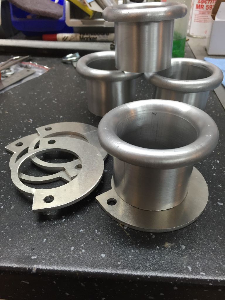

I also cadded up some baseplates for the new velocity stacks and had them lasercut at work. A good friend of mine got them welded up tonight.
(IMG:http://www.914world.com/bbs2/uploads_offsite/matsgarage.com-15176-1455225580.4.jpg)

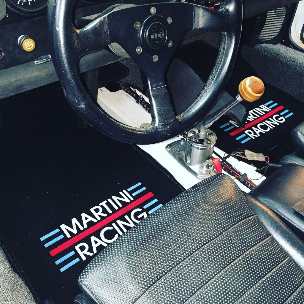

For my birthday earlier this week I also had a package arrive that I ordered about a month ago. Two custom front mats with the Martini Racing colours.
