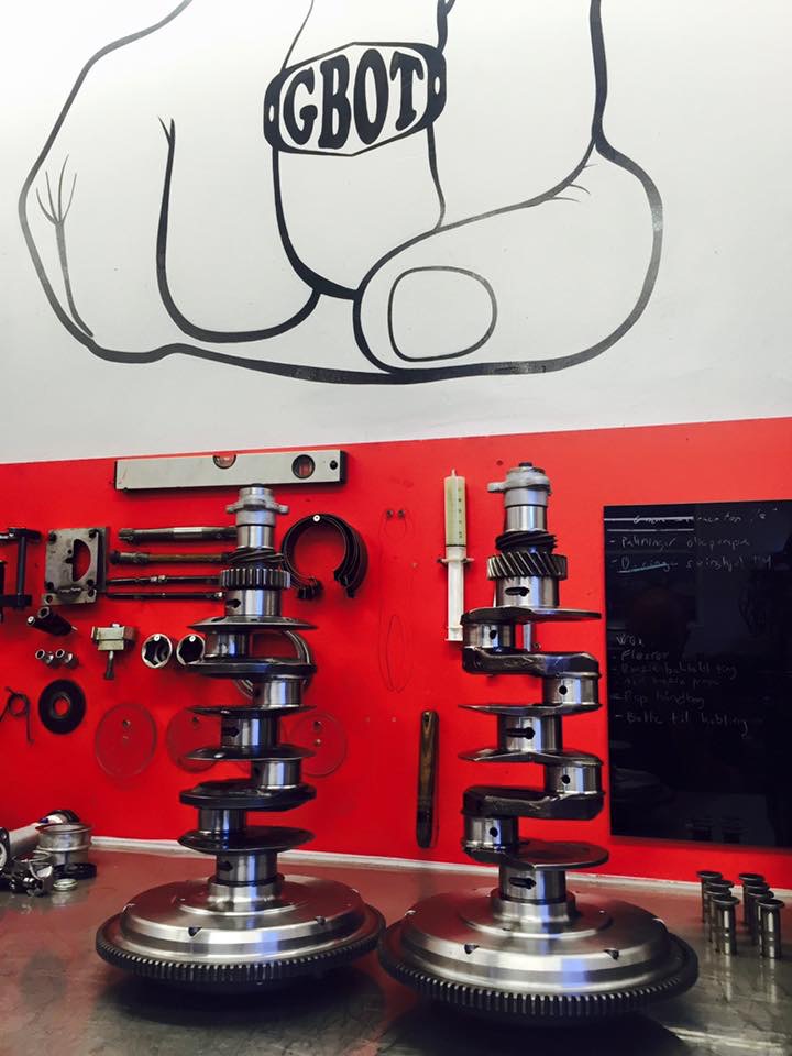

Oh yeah, one of these will go into my Engine...probably the right hand one (IMG:style_emoticons/default/wub.gif)
(Photo Jacob Spring @ GBOT)

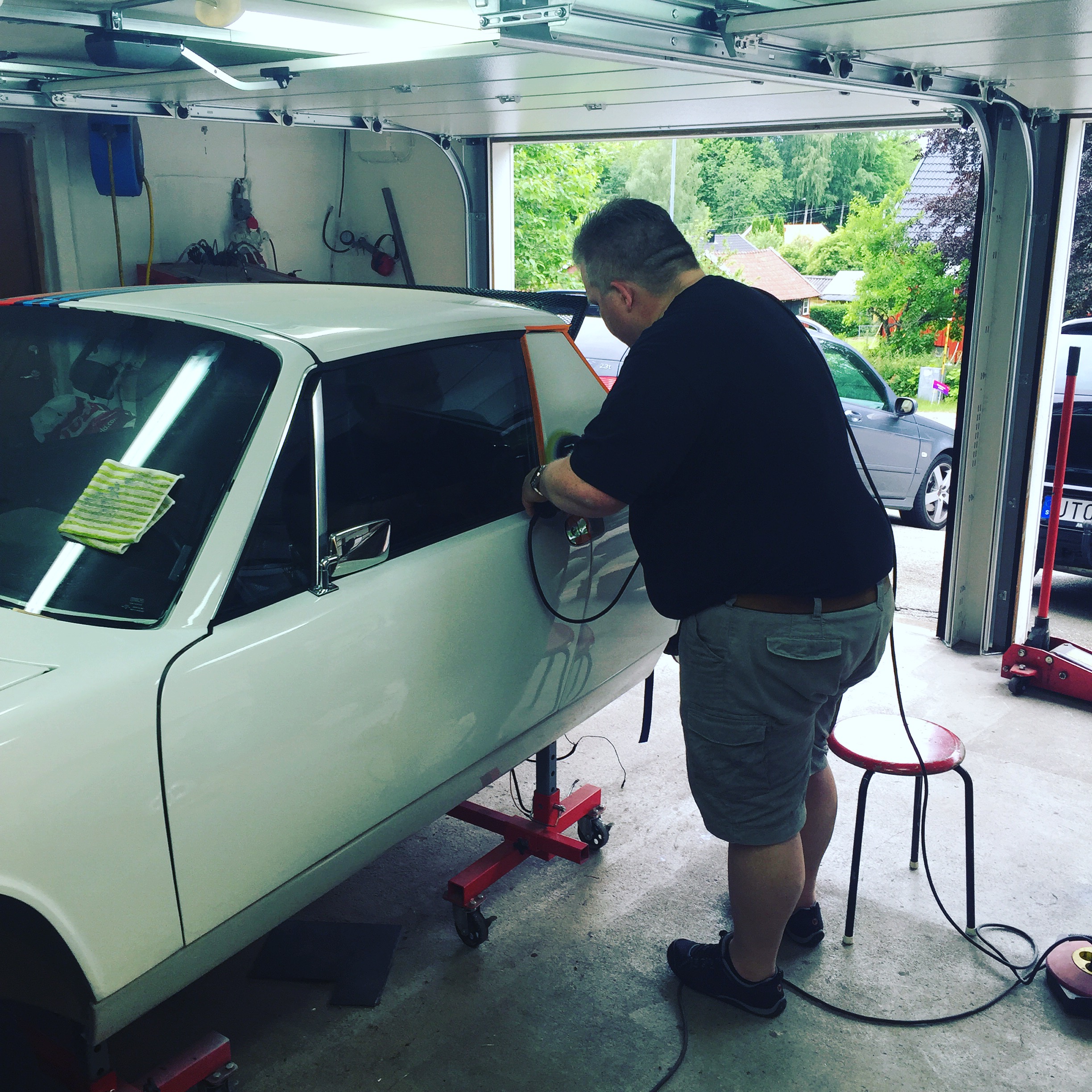

Well while the engine is still being built my mate Pontus and I decided to tackle the paint.
First polish and wax since it was painted about 18 months ago. What a difference it made! The downside of the polishing is that all the imperfections in the paint are much easier to spot and there are a few....
First pass was made using a fine medium-fine pad and a coarse compound, seconds pass using a fine pad and fine compund. All of the Rupes brand including the machine. Good stuff! (IMG:style_emoticons/default/smile.gif)
