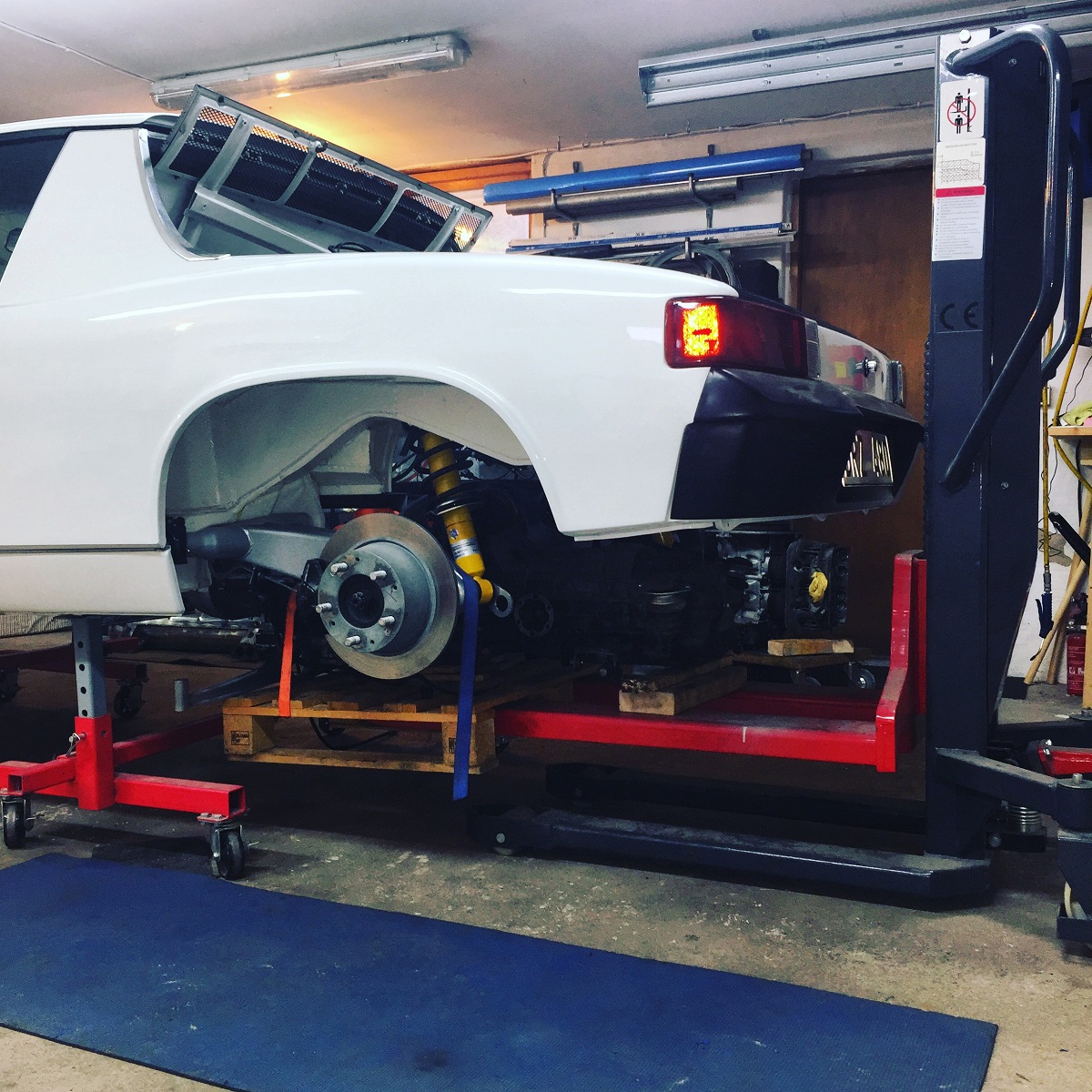

post Nov 27 2016, 02:18 PM
Post #223
Posts: 1,579
Joined: 22-November 12
From: Sweden
Member No.: 15,176

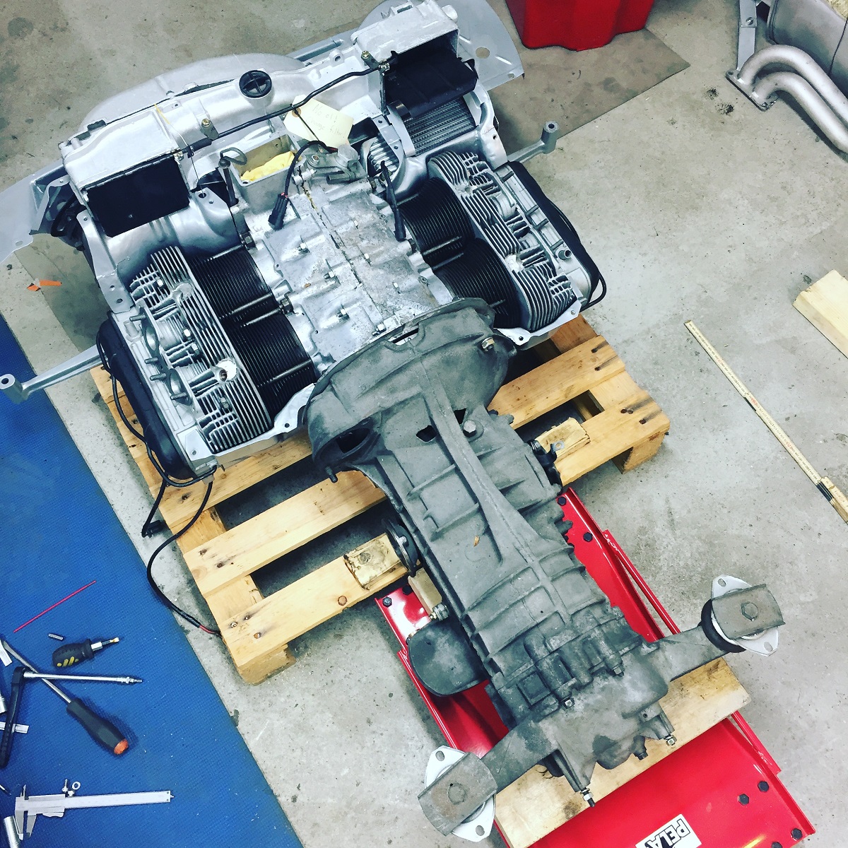

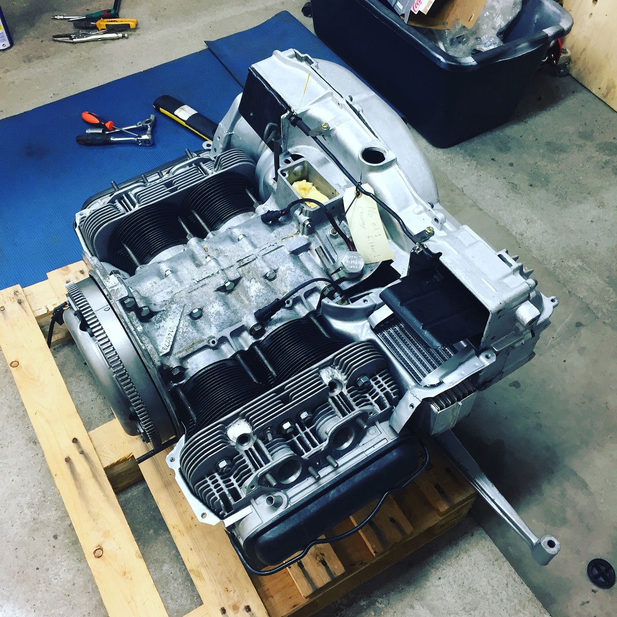

Engine is back!
Gearbox was happy to see engine back in the garage...
I'm happy to see them both back in the car. (IMG:style_emoticons/default/biggrin.gif)

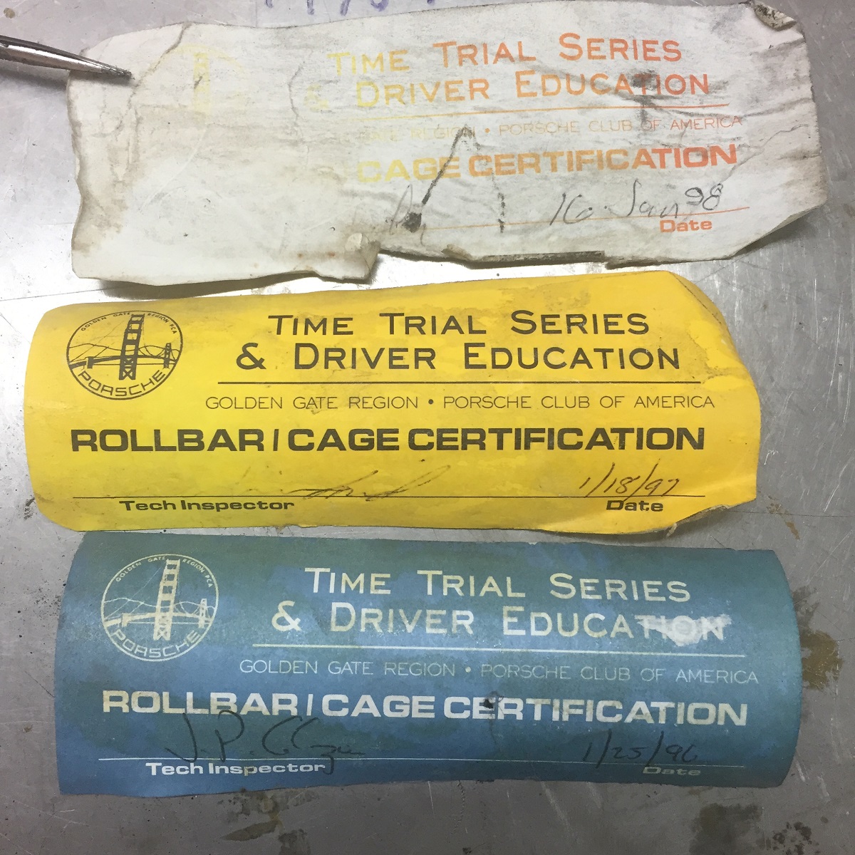

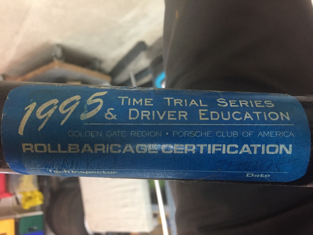

I've pulled the old roll bar out to try to get it ready for blasting and powdercoat but first
I rescued these old tech inspection labels from it.

914_teener
post Jan 8 2017, 11:29 AM
Post #232
Posts: 5,270
Joined: 31-August 08
From: So. Cal
Member No.: 9,489
Love the period inspection stickers.

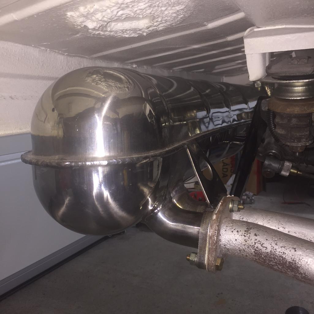

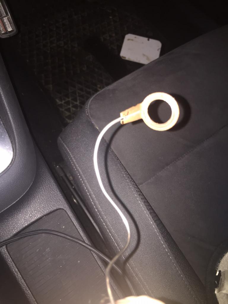

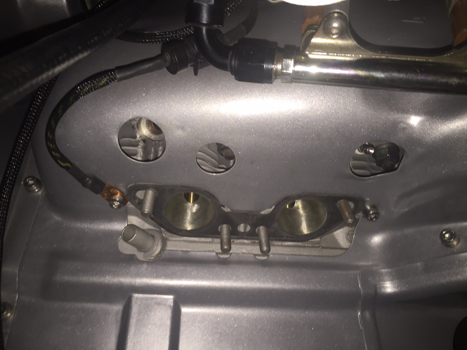

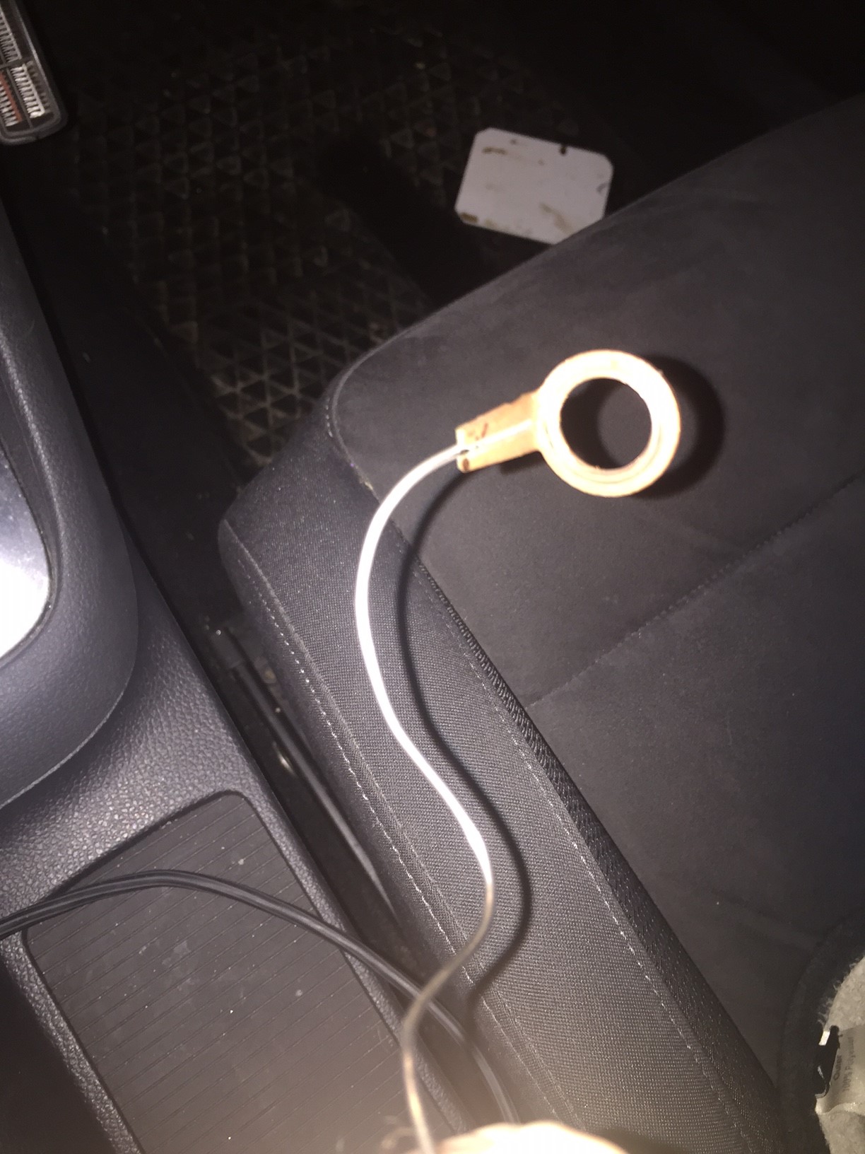

Pulled of the passenger side intake manifold to get the the #3 spark plug.
Removed the culprit temo sensor and I've sent it back to the vendor to hopefully be exchanged.

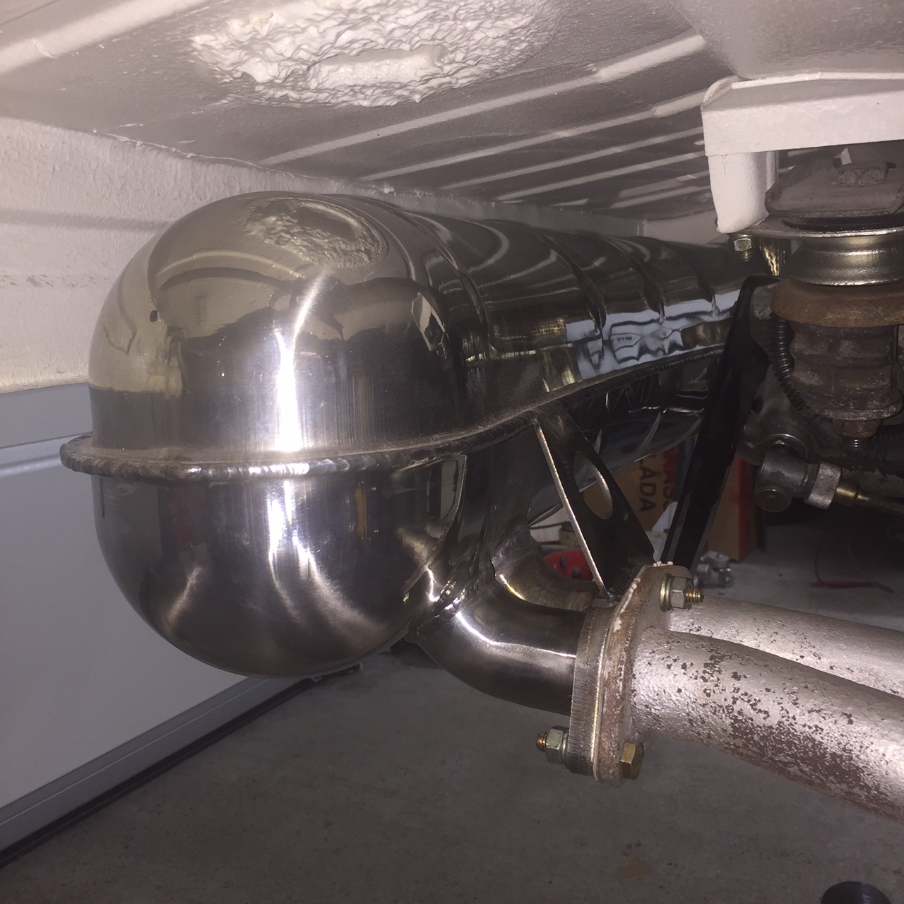

Very happy with the Scart muffler, the fit against the heater boxes was spot on, unlike the old Bursch snake pit that needed alot more effort to put in place.

post Jan 11 2017, 09:55 AM
Post #235
Posts: 899
Joined: 23-June 15
From: Central TX
Member No.: 18,882
QUOTE(falcor75 @ Jan 11 2017, 02:35 AM) *
Did you get the Scart Super Sound? Eventually I am getting one for my car. Can't wait to hear a video of it singing.

falcor75
post Jan 11 2017, 11:08 AM
Post #236
Posts: 1,579
From: Sweden
Member No.: 15,176
QUOTE(bretth @ Jan 11 2017, 04:55 PM) *
Brett
Yes I did.... (IMG:style_emoticons/default/biggrin.gif) Will be awhile yet for any highrev singing as we still will have 3-4 months of winter to endure.....

Well I got my faulty CHT sensor replaced and this weekend I've been running the engine on low revs and letting it heat up properly to check that both the air flap thermostat and oil cooler thermostat opens as they should. I've also verified that when the ecu sends 0 degrees ignition thats what the engine gets, also checked that the 27 degree mark lines up with the ignition locked to 27 degrees. Also been working on syncing the itb's as best I can with a synchrometer. The resulting airflow ended up at (6) (5) (5.5) (5.5) at 1000 rpm idle.

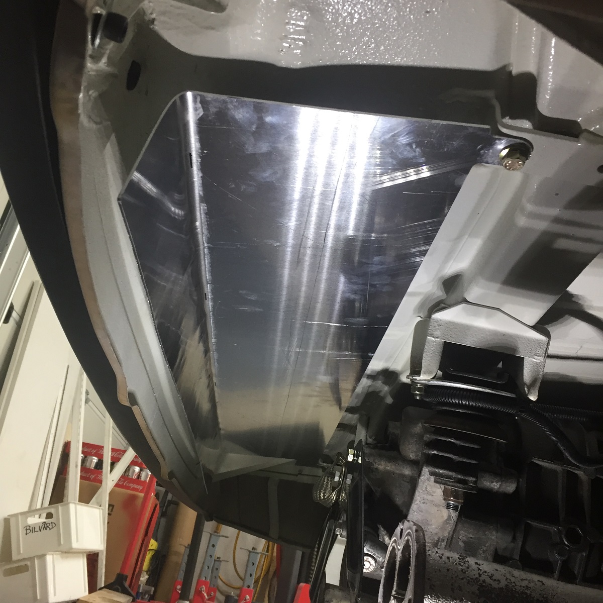

Larmo63
post Jan 30 2017, 10:33 PM
Post #238
Posts: 4,267
Joined: 3-March 14
From: San Clemente, Ca
Member No.: 17,068
No heat baffle above the muffler?
Maybe I missed that part of the thread.
Beautiful car!!!

post Jan 30 2017, 11:10 PM
Post #239
Posts: 1,579
From: Sweden
Member No.: 15,176
QUOTE(Larmo63 @ Jan 31 2017, 05:33 AM) *
Beautiful car!!!
Ummm...yeah about that..... (IMG:style_emoticons/default/unsure.gif)
I kinda forgot to put that back.....which I've noticed now as I've been running the engine that the trunk floor gets warm-ish. Got a solution for it tho, will hopefully show it in a day or two. (IMG:style_emoticons/default/smile.gif)

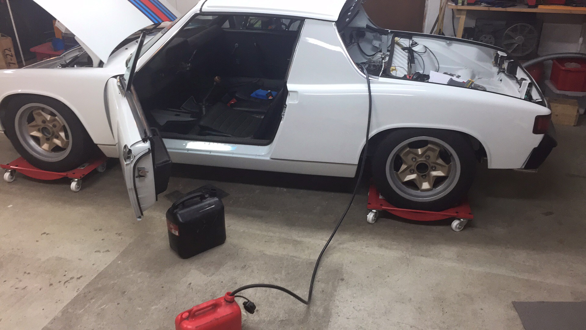

Slowly working thru my pre dyno checklist, draining the old gas from last years dyno attempt and will replace it with fresh fuel. The old fuel I put into the wifeys Saab and then I still had about 25 liters left so I had to call a friend over to put those in his car since I had no place else to put it.
Then onto the issue with the missing heat shield. I took a few measurements and drew one up in Solidworks, bought some 2 mm sheet of aluminium and then bribed the laser boys at work that cut the shape for me. Did the bend myself at home between two screwed together 2x4's. Using the rear sway bar holes as mounting points Then I will also add a couple of connections to the lower bumper mounting bolts aswell to keep it from rattling around.
