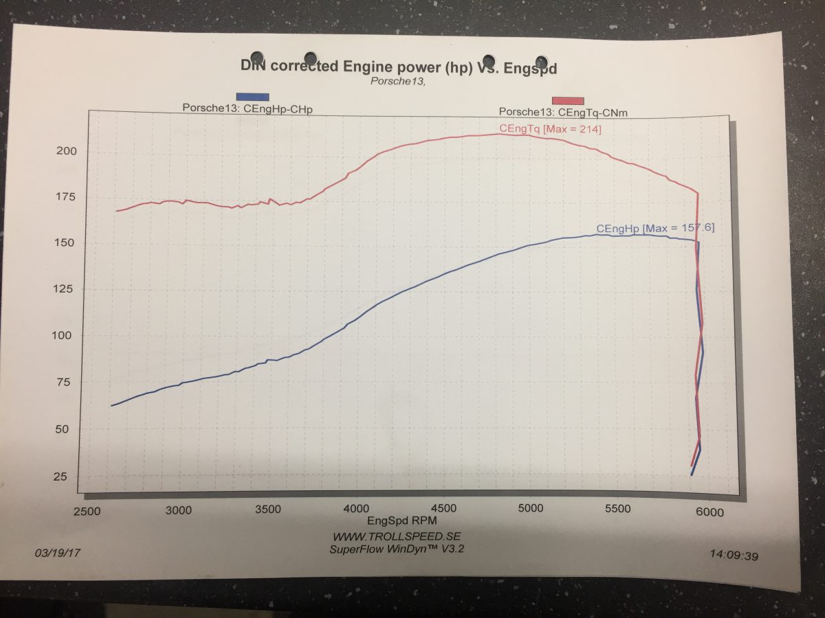

Thats a pretty good guess but it was a little bit more. (IMG:style_emoticons/default/smile.gif)
(IMG:http://www.914world.com/bbs2/uploads_offsite/matsgarage.com-15176-1489986680.1.jpg)
158 hp and 158 ft lbs.
Head temps ran between 140-170 C the whole time so that should be ok too.

What is going on with that graph? I will happily buy your numbers (158 HP/158 lb-ft torque) but that graph is showing over 200 lb-ft and the torque doesn't cross the HP at 5250 RPM!

QUOTE(Dave_Darling @ Mar 20 2017, 04:22 PM) *
--DD
The Torque is in Nm.....we damned metric europeans you know.... (IMG:style_emoticons/default/biggrin.gif)
214 Nm = 158 ft lbs if my online converter is correct.

Ah, crap! I missed the units on the graph!
*hangs head in shame*

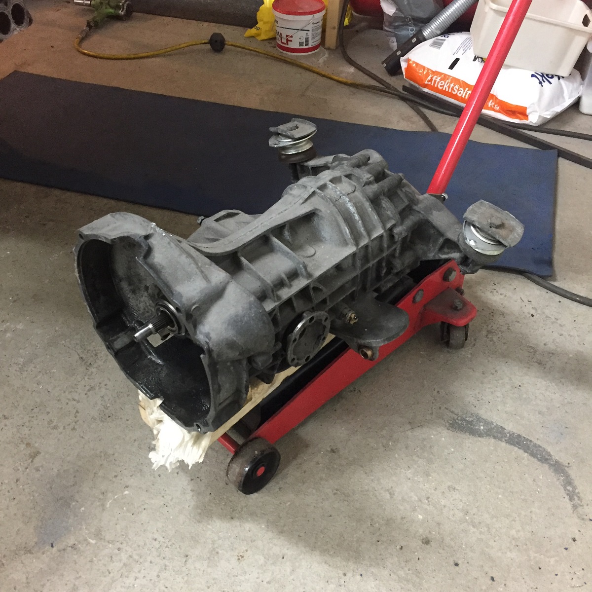

48 hours of happiness was all I got. Noticed a leak under the car and figured it was the tuna can that had seeped a bit more oil after the dyno day. Smelled the oil....transmission oil.... (IMG:style_emoticons/default/barf.gif)
Input shaft seal is leaking. AT least it seems to be replaceable without opening the transmission. Figures it would start leaking as I've already changed the gear selector shaft seal and have the double o-ringed speedo drive unit.
Oh well down in the garage after dinner. 1 hour and 32 minutes and the gearbox was out of the car..

Hi Mats, too bad a 2$ part (seal) caused this to your nice work, at least you got some wrench-time out of it ! :-)
Good luck with the fix !

Ordered two new input shaft seals today. Is there a good DIY guide to pulling the old one and installing the new one somewhere? Prefered tools?
