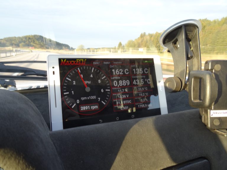

I left home at 5:20 am to drive the 255 miles south. Joining me I had my friend Pontus driving his Cayman as a backup/following vehicle.
(IMG:http://www.914world.com/bbs2/uploads_offsite/matsgarage.com-15176-1494790549.1.jpg)
Since I had barely driven the car the first hour was a bit nervous. It was also quite cold for the season, only 40F when I left so I got to put the heat on to keep warm. Further south there are a couple of long inclines that I was a bit nervous about but the car handled them well just touching 375F at the top of the hills.
About 20 minutes out from arrival we stopped for fuel just to be sure, I know my engine is running quite rich (lambda 0.9) and it got around 25 mpg on that part of the trip keeping an everage speed around 100 km/h.

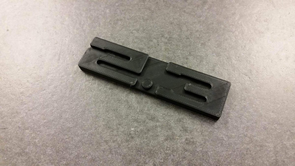

I designed this badge in Solidworks. It's basically a 1988 911 3.2 badge that I switched around. A friend 3D printed it for me and its got two strong magnets countersunk into the backside.
(IMG:http://www.914world.com/bbs2/uploads_offsite/matsgarage.com-15176-1500580702.2.jpg)
I finished the surface with a 1200 grit wet and dry paper and then painted it silver. Turned out pretty nice.

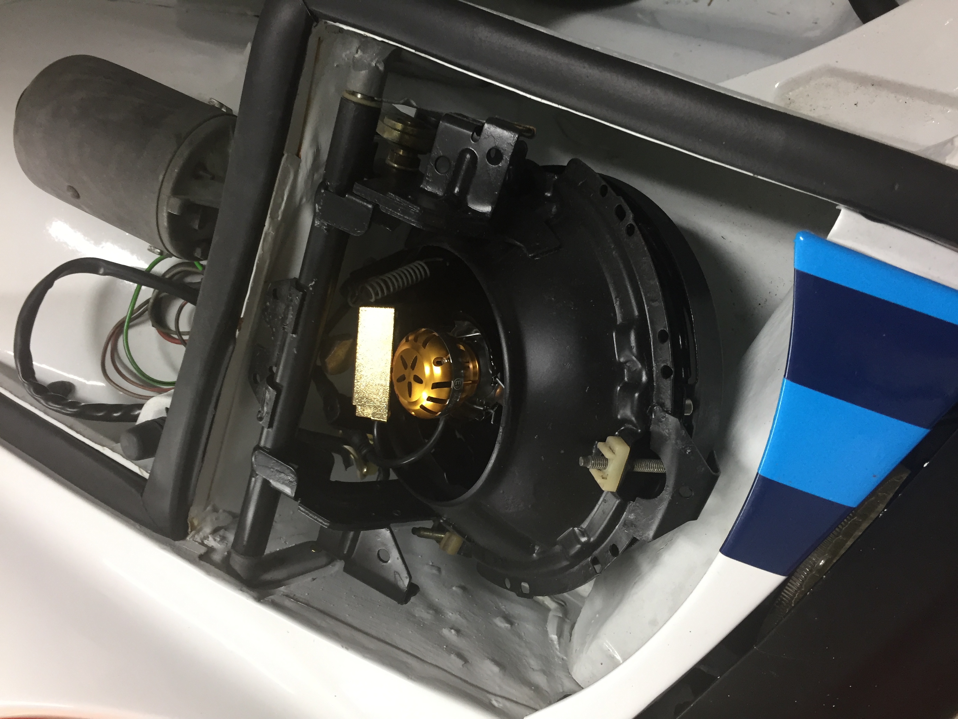

I also shot a two quite shakey movies from my phone while driving the same stretch of road both with the sealed beams and LED's.
I can post the links to them if someone is interested.
LED bulb installed.
