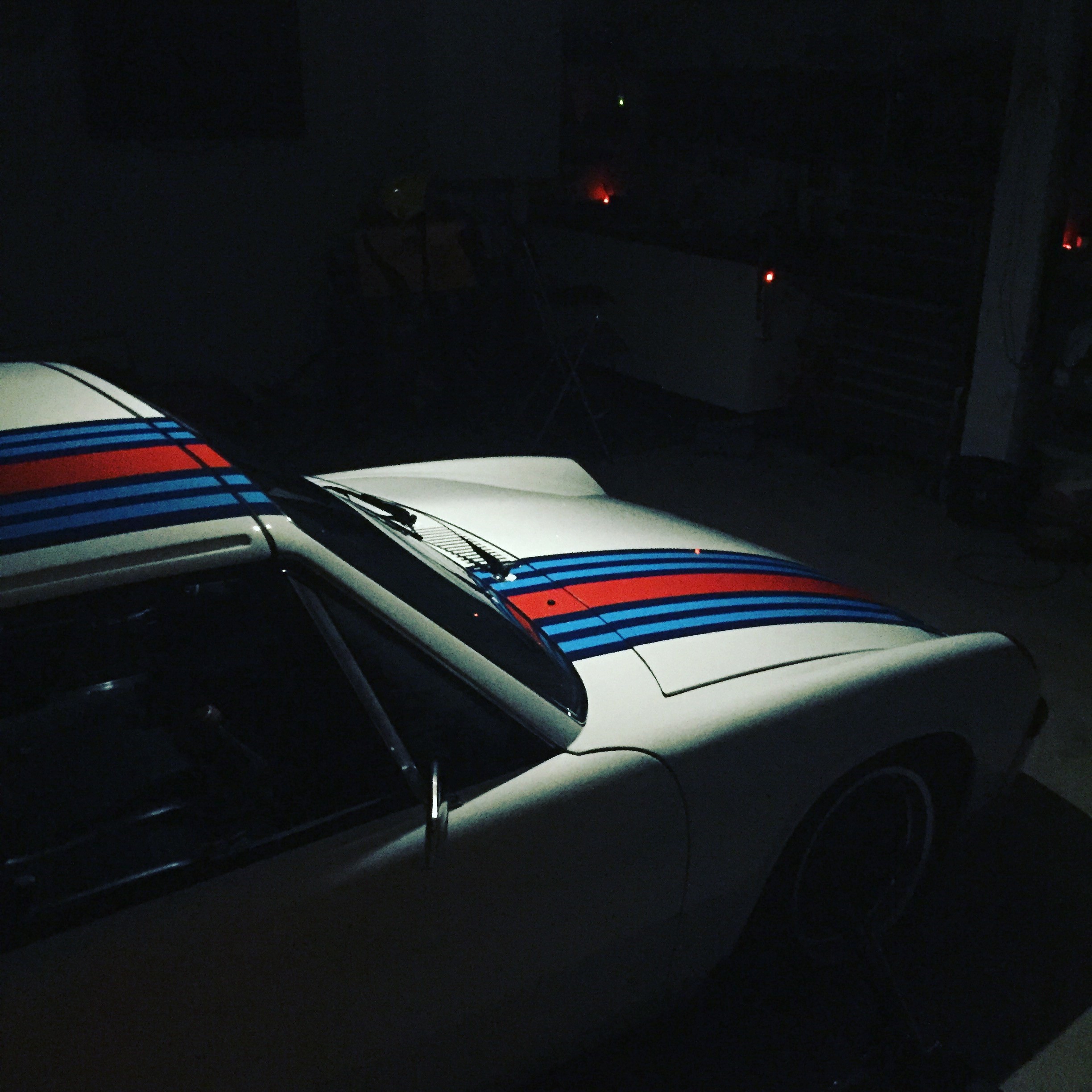

post Aug 31 2017, 10:51 PM
Post #323
Posts: 1,579
Joined: 22-November 12
From: Sweden
Member No.: 15,176
The other night when I came back into the garage after a short drive I caught this picture and got a little inspired. That moment after a drive and you turn of the bright garage lights. The silence is only interupted by the ticking noises of the engine beginning to cool down. Automotive nirvana right there. (IMG:style_emoticons/default/wub.gif)

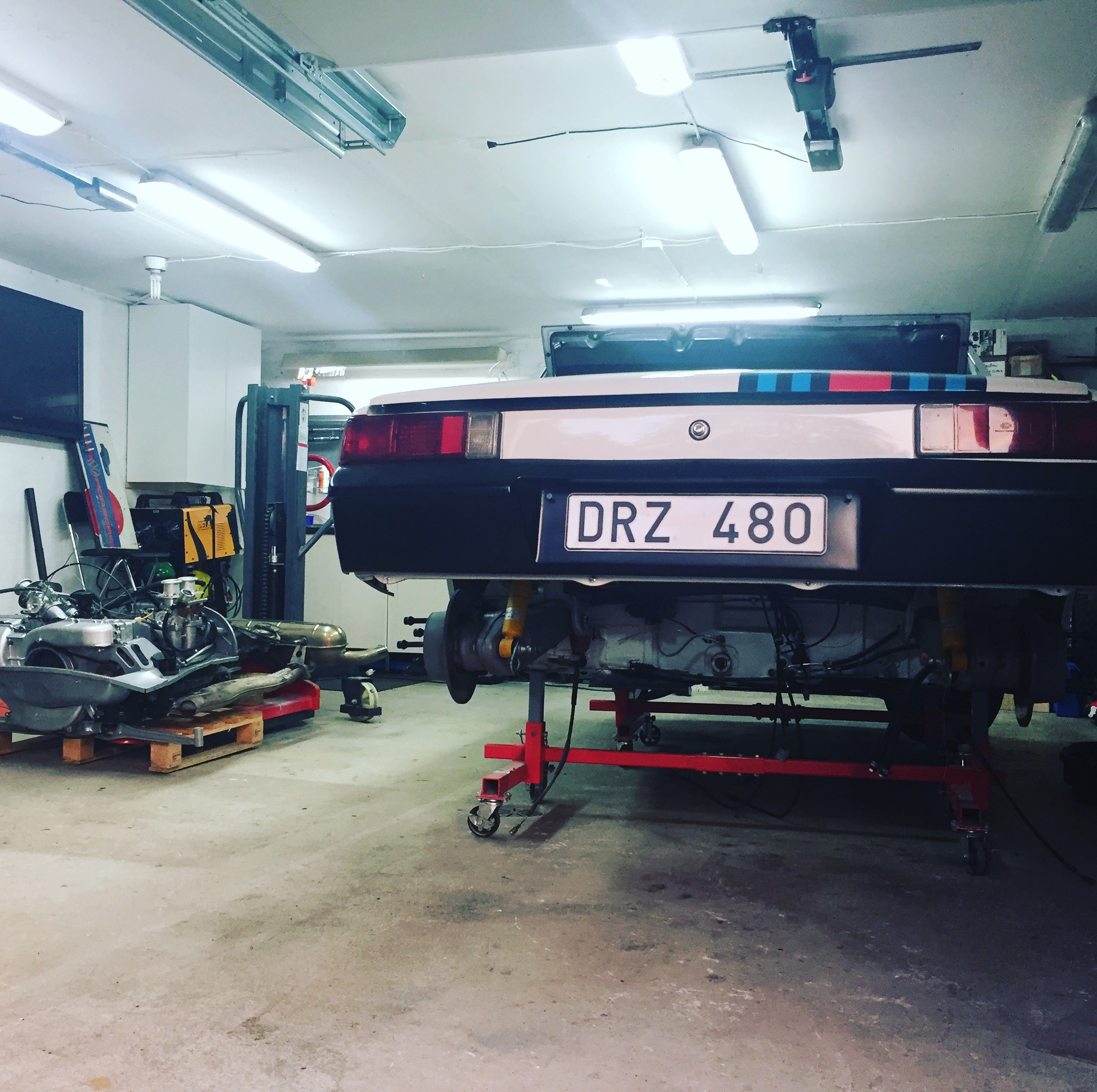

The 2017 season is offically over. I havnt driven the car very much since late July due to an increasing whining noise from the gearbox. Its most notable when everything is warmed up and you accelerate from a slow speed in high gear.
Passing thru a village and slowing down to 50 kph (30 mph) and then accelerating
back up in forth gear and you can hear an whining noise that is rpm dependant.
So engine and gearbox out. The gearbox was dropped off last week to a semilocal (3 hour drive one way) Porsche engine/gearbox rebuilder thats very highly recommended here in Sweden. Now to play the waiting game and praying that I dont get have to eat porridge for all of 2018 due to the repair bill. (IMG:style_emoticons/default/barf.gif)

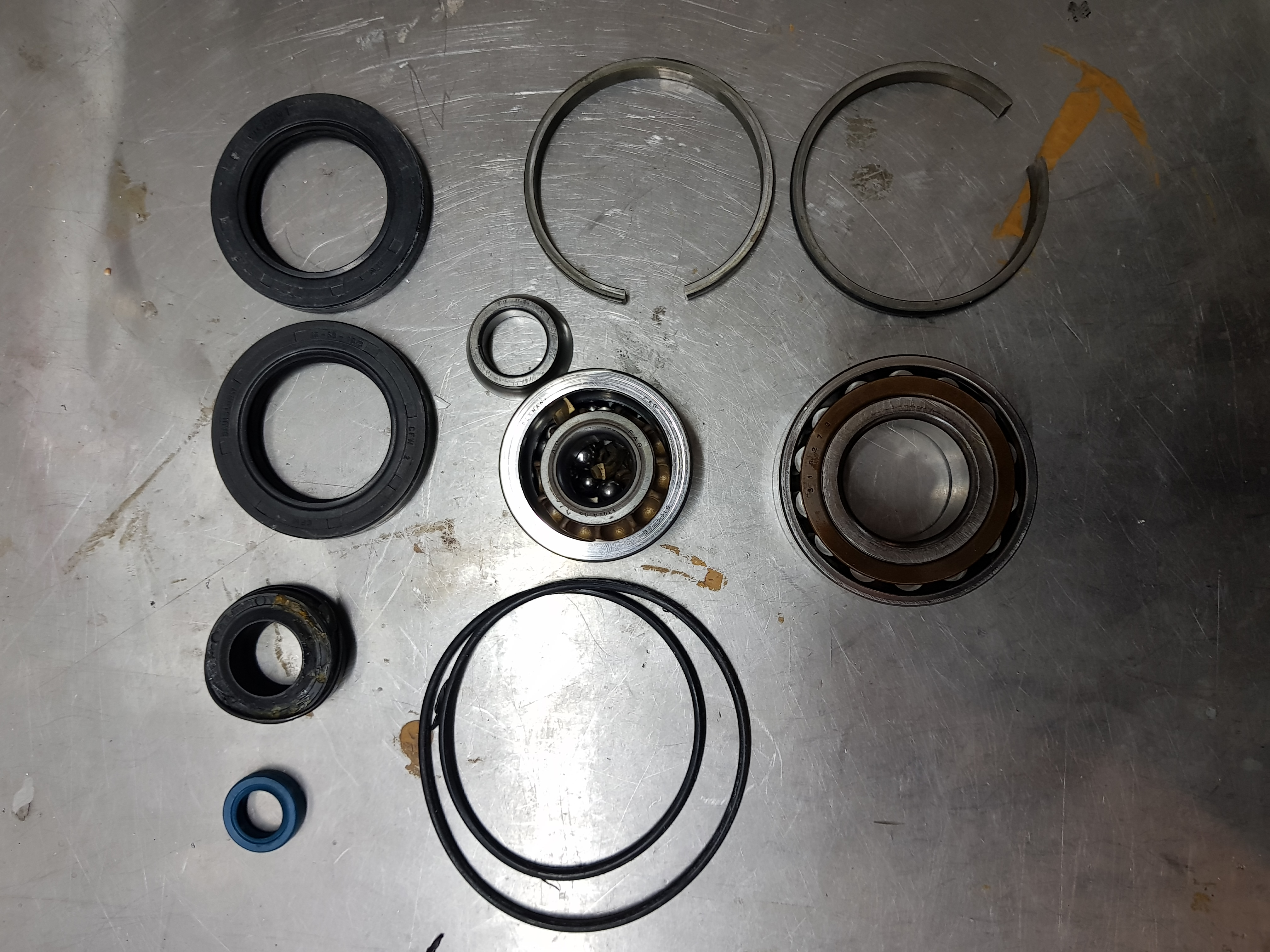

post Jan 14 2018, 11:03 AM
Post #330
Posts: 1,579
From: Sweden
Member No.: 15,176
Spent about 7 hours in the car today to go pickup my rebuilt gearbox and drive home again. These are the leftover parts. Changed two bearings, two synchros and all the seals and nuts and washers.
Now I'm just waiting for a few remaining parts I've ordered before I can put the engine and gearbox back into the car. The goal is to have it drivable by the end of March.
