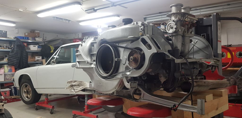

Well its winter here and its time for some service and leakfixing.
(IMG:http://www.914world.com/bbs2/uploads_offsite/matsgarage.com-15176-1579032000.1.jpg)
Engine out. First fixes was to remove the flywheel and pull the old Elring crank seal and swap it for a Sabo brand one. While in there's I've also adjusted the postion of my pilot bearing to make it support the input shaft a little bit more.
I thought I had a leak from the input shaft on the gearbox but it turns out it was more likely the reverse light switch. Took the old mangled brass? washer off and put in a new annealed copper one.
I still have to remove the washer I've spotted under the clutch pivot ball and see if that gives me a more centered clutch arm. Need to get a cheap 12 long 12 mm socket and modify it to get the pivot off.
While the engine is out I've also set the valves (zero lash on this engine)

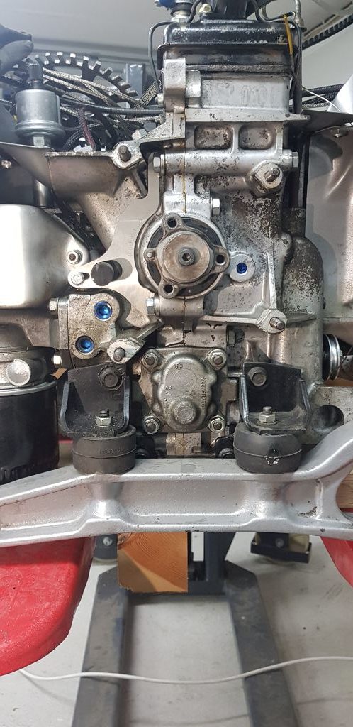

I've also noticed an annoying drip from the front of the engine. Typically its shown as a drop of oil hanging from the bottom of the drivers side engine bracket. (behind the engine bar in this picture)
I've taken the engine bar off and cleaned the entire front of the engine and wiped it dry. Now i'll let it sit for a day or two and see if the leak can be spotted. My main suspect is the oil pump.
