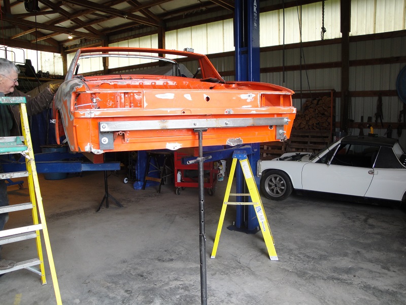

We're getting ready to move the project off the rotissere to the lift.
We'd rehung the doors . Pretty scary hanging there on the rotissere.
How many 100's should we allow for shrinkage when we reinstall the long?

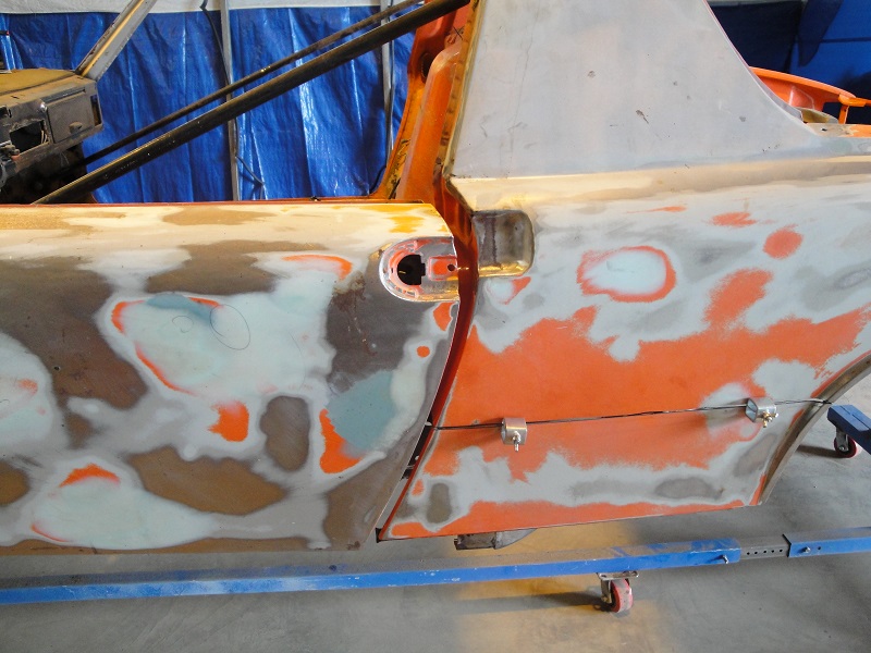

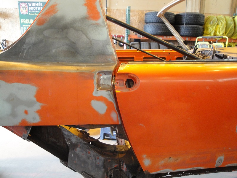

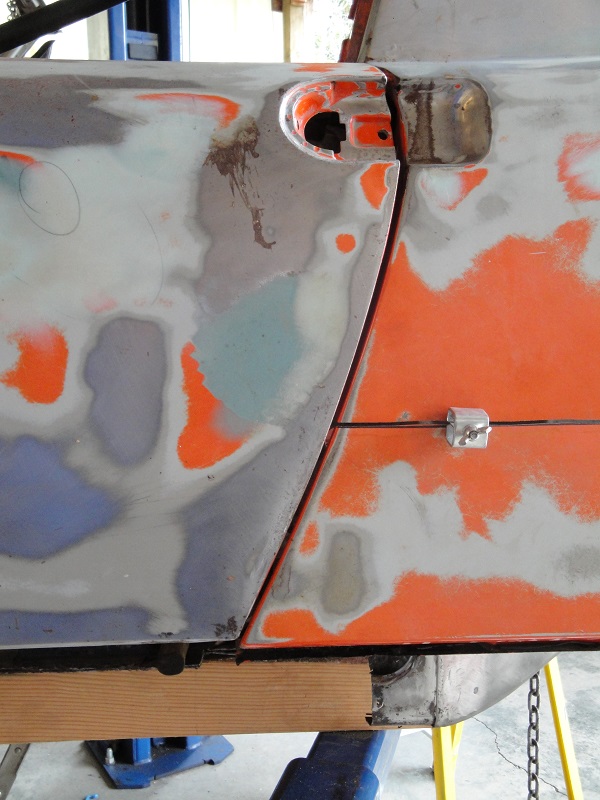

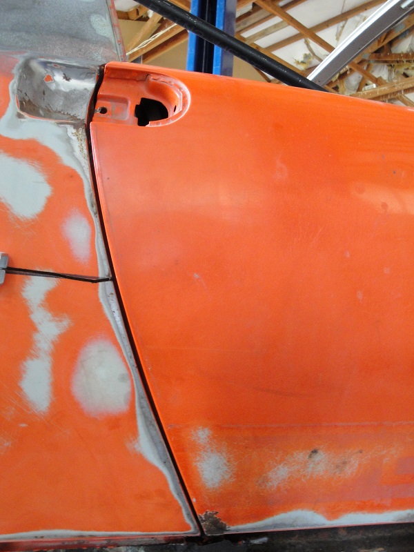

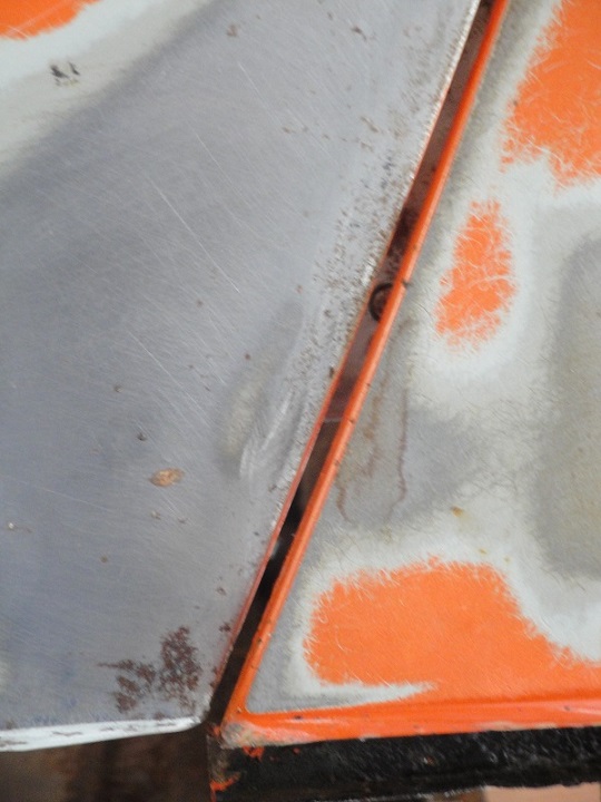

Here's the pictures I promised.
Put the doors back on to make sure everything is perfect.
Might need some adjustment. This is where I ended up even with the door brace installed in the beginning.
But this is with the drivers long removed.
Passenger side.

Not even close. It looks like you could use some shrinkage! (IMG:style_emoticons/default/biggrin.gif)
I think you need adjustable braces that allow you to pull or push the car until everything lines up.

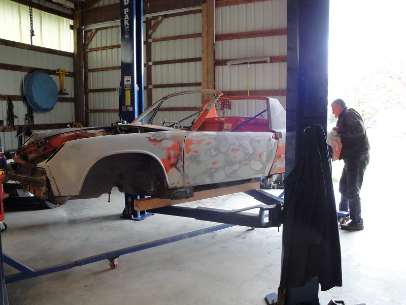

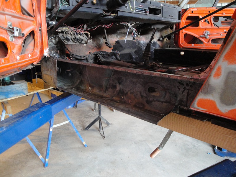

Moving from the rostissere to the lift.
The tall jack stands allow you to twist the body into position. Without the long, its kind of like a noodle.
I wish I'd done a movie to show you how flexible the body is without the long attached.
After a couple hours of tweaking. Getting closer.

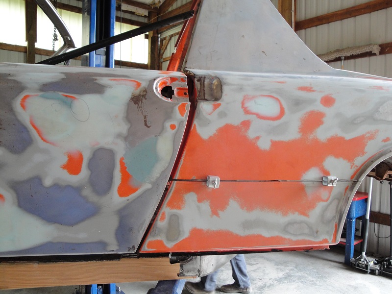

Almost getting there on the passenger side. But I'm working on the drivers side first.
Test fitting the drivers long. Even with this being an Arizona car. I'm putting in a patch under the jack point.

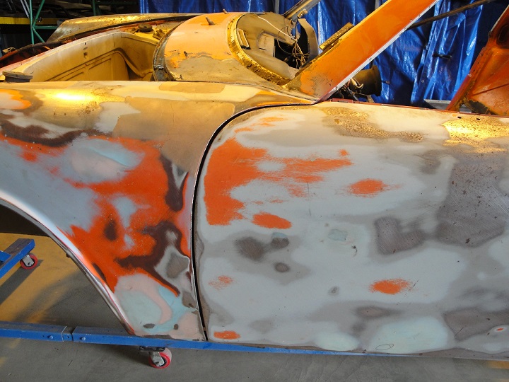

Here's the drivers side.

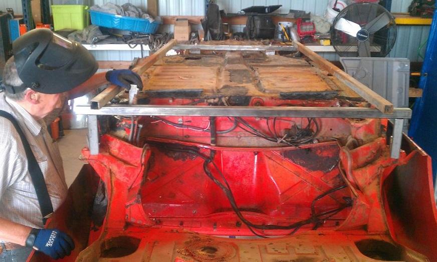

I do have adjustable door braces. I can move the door gap all over the place.
Without a long installed you can't believe how much you can move things around.
Just trying to get the top and the bottom of the door to match.
Looking for a gap of .19 to .21. I assume that's the correct measurement.
Being that's what the front gap is.

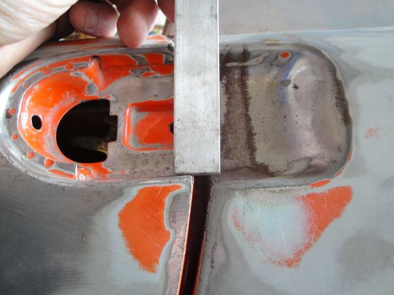

post Mar 13 2013, 10:07 PM
Posts: 3,900
Joined: 26-January 04
From: Sherwood Oregon
Member No.: 1,608
Here's the pictures from today.
Drivers side..
The nut plate on the door jam latch is a bit frozen. So its soaking with PB Blaster.
Pulls the door up just a smidgen. I'll tidy that up tomorrow.

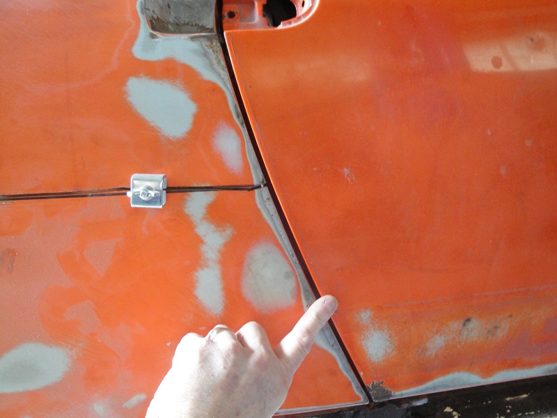

Here's the passenger side.
Real happy with the progress today.
My fabricator (Super In Law) mis-measured the patch on the drivers long. (IMG:style_emoticons/default/mad.gif)
Missed that it gets about .20 wider as is goes under the firewall.
So we didn't leave the shop till after 6:30.
