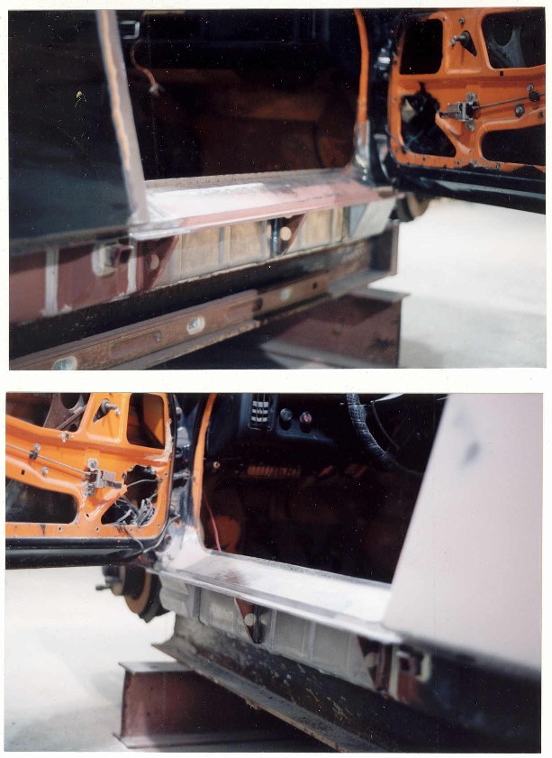

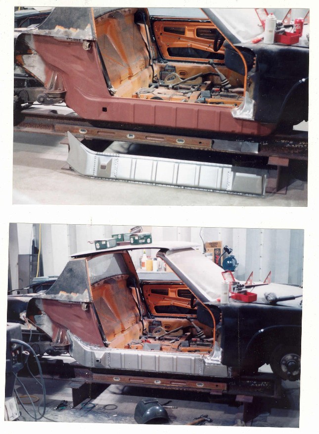

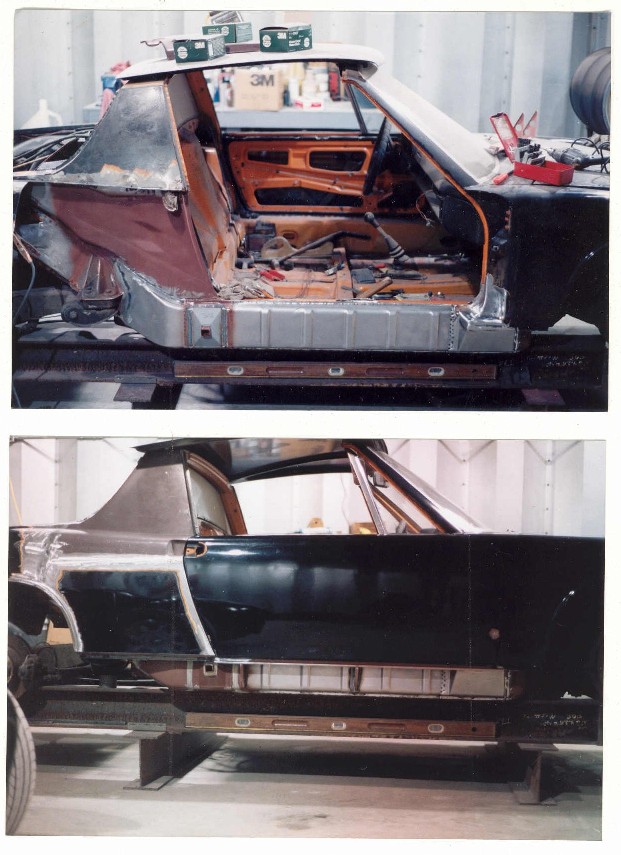

I got an email from Bill at Restoration Designs. Great information and pictures of the RD overlays. He read my original thread asking for installed pics but couldn't get the pics posted here so I wanted to post them. My body work guy uses RD and has nothing but great things to say about their product. I've heard the same thing from others as well. RD's parts will find a place in my project and I will post pics in my \"rust\"oration thread when the work is performed.
RD Web Site
Mike,
The guy restoring this car replaced the upper and lower wheel house
panels P330 & P331 and the inner rocker panels P301L/R before installing the frame stiffening kit P346L/R.  The original parts in these areas were stamped out of 18 gage steel .046 thick so when you add the kit which is also .046 you are then at .092 thick which is thicker than 16 gage steel which is .065 thick and as you know 16 gage is really not sheet metal but thin metal plate.  I think the frame kit is a cleaner more elegant way to go about this type of modification because the car still looks original, and the kit does not interfere with reinstalling the step plates and outer rocker panels.
Thanks,
Bill
www.restoration-design.com

Awsome Pics! This is good info as I ripped into my project car and found that due to AIR having been installed, all the sill supports on the passenger side and the triangular support at the front had been removed. Also the OEM jack plate (w/ "drain hole") while seemingly intact was VERY rusty on the inside (hit it with an hammer and watch the rust pour out) These supports seem to be the answer. (IMG:style_emoticons/default/clap56.gif)
But it looks like you have to replace the sill as well?
Gint
post May 19 2003, 04:23 PM
Mike Ginter
Posts: 16,098
Joined: 26-December 02
From: Denver CO.
Member No.: 20
Yup. The outer long shell must be intact and in good shape. These overlays are more of a "stiffener" but yet they retain the stock appearance. But RD sells the outer panel replacements as well.

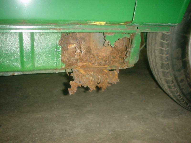

Do you have the email address of Bill at Restoration Designs? I just made a frightening discovery in my car, and would like to send him a pic to get his thoughts as to what I need.
thanks
Bleyseng
post May 20 2003, 07:48 AM
Aircooled Baby!
Posts: 13,036
Joined: 27-December 02
Member No.: 24
Post it here so we can see and maybe we can advise you, some of us here are pretty good welders.
