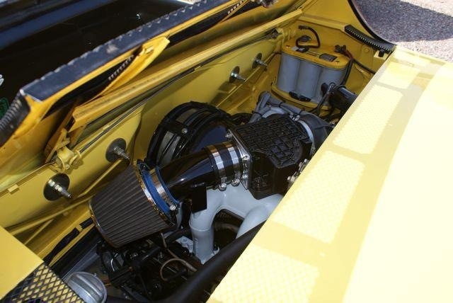

Here's mine. Linkage from throttle body goes to rear with bell crank in stock location.
No need to flip the intakes.

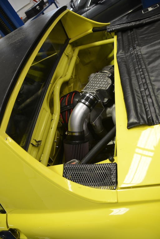

Mine is about the same...
Steve

Mine is exactly the same as Mike's (MOVQIK) above. Just not that shiny.

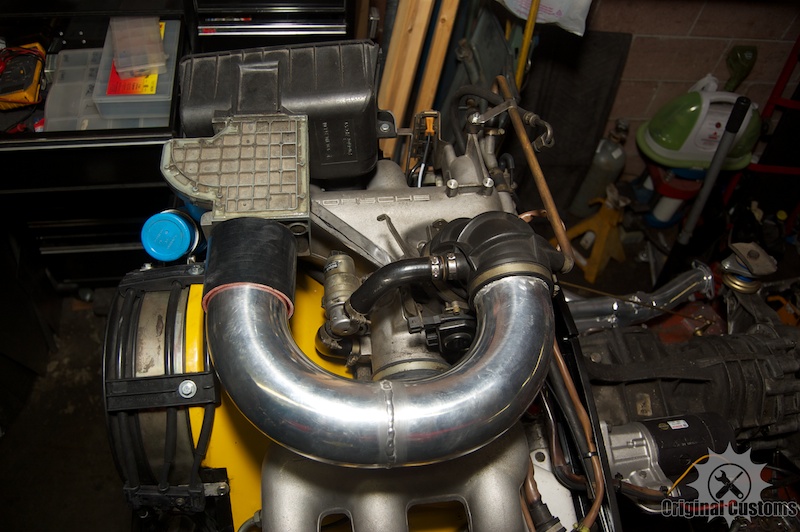

Flipped. Check page 3 on my build thread in my signature.
(IMG:http://www.914world.com/bbs2/uploads/post-9101-1332691040_thumb.jpg)

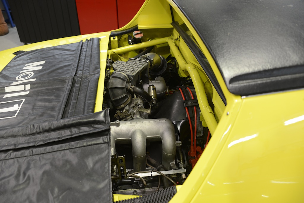

Something a little different. Keeps the stock air box and stock intake orientation. The air box is moved to the opposite side of the engine though. Clears the engine lid (with a slight mod) and the stock battery tray just fine.
