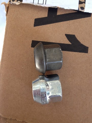

I have wheel studs pressed into all of my hubs and was planning on using the open steel lug nuts in the pic below. Are these going to be okay for the ATS wheels? They do not seem right. There is very little contact between the seat of the lug nut and the wheel. I need something different here, right? Where do I get it?
TIA
(IMG:http://www.914world.com/bbs2/uploads_offsite/lh5.googleusercontent.com-2075-1368377795.1.jpg)

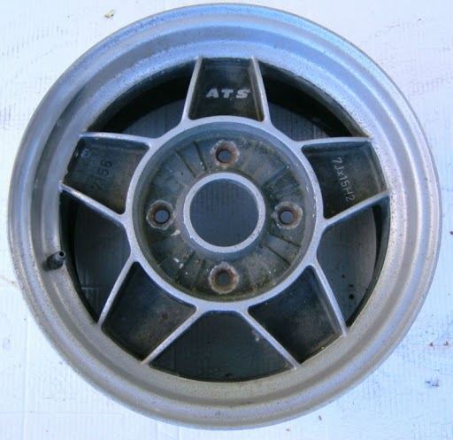

Here is a full pic of the wheel:
(IMG:http://www.914world.com/bbs2/uploads_offsite/lh5.googleusercontent.com-2075-1368377797.2.jpg)

Your lug nuts appear to have a "ball seat" design and the seating surfaces on the wheel are flat. I do not think these are compatible.
You will need to find compatible lug nuts.
I think you may have a second option and that is to have your wheels machined to accept metal inserts that will then accept the ball seat lug nuts. I don't have any more details on this process but I recall another 914World member posting information about his experience doing this.

Sorry thats not a great picture. The seating area on the wheel isn't flat. It's a more of a sharp cone shape than the rounded ball seat on the lugnut in the pic.

I think I found it. Cone seat vs. Ball Seat. I'll grab a few from ebay to test.

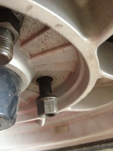

Here is a pic for reference. The cone seat lug nut works perfectly on the ATS wheels.
(IMG:http://www.914world.com/bbs2/uploads_offsite/lh6.googleusercontent.com-2075-1368638207.1.jpg)

Narrow body '71. They fit the rears fine. I should have them test fit on the front today.
