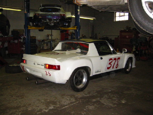

What I ended up doing (so far) is a set of cookie-cutter 18" European Racing Headers megaphones for unrestricted track use, and a SS Dansk 2-in/2-out gutted sport muffler for slightly muffled use. I may also need to get a stock-type 2-in/1-out sausage, or a quiet (50-series?) Flowmaster or other setup, for noise-restricted use. My car would have a hard time passing noise regs at a place like Laguna, even with a stock sausage muffler. The carbs and fan noise alone are substantial. (I am keeping the stock airbox around just in case; I thought about selling/trading it, but that might be a bad idea.)

In my v8 914 car we put in two glass packs where the original muffler was. They are stacked and hung on to the trans. The left side of the engine comes back goes across the rear of the car and exits out of the right side, and the right side comes back and exits out of the left. It all fits very well and I put 911 type exhaust tips,so it looks clean. The mufffler shop guy said he has installed a flowmaster muffler for a Camero application in 914s and it works well also. You could also install flanges so you can r and r your megaphones on track days.

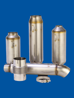

I am getting a set of mufflers like these, Coast, Burns, even pegasus have mufflers like these. They look really clean and cool with a nice set of spaghetii headers (IMG:style_emoticons/default/beer.gif)
