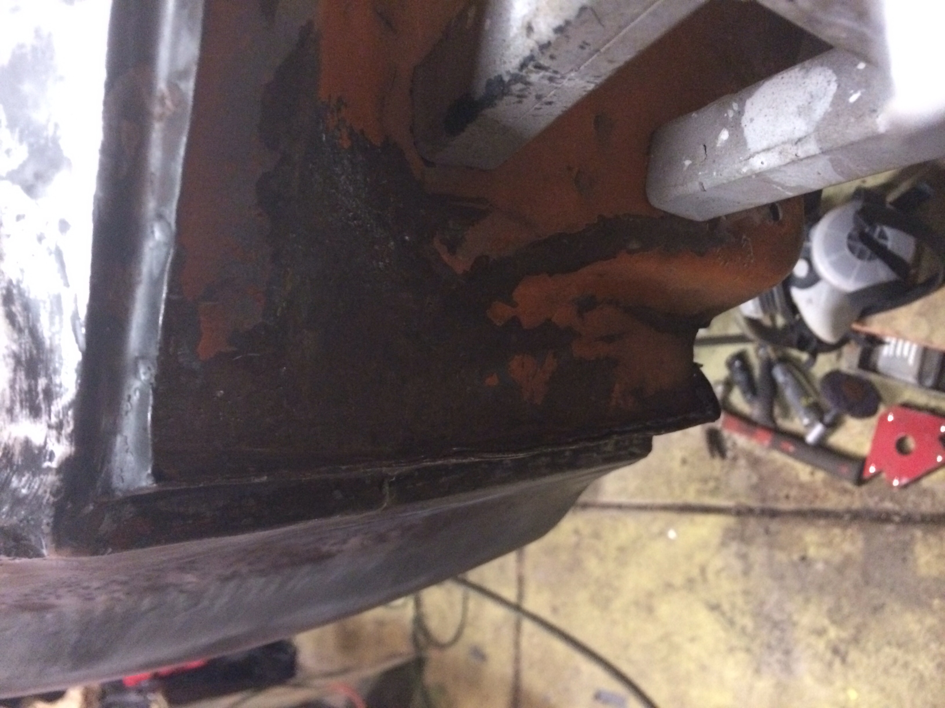

QUOTE(CptTripps @ Feb 12 2014, 08:21 PM) *
BUT...it looks like I have a bit of a mess in the passenger front quarter. Thinking I may need someone to cut one off of a body for me. This thing is chewed. Going to take a lot of work...or a panel. Thoughts?
What say the MetalSurgeon? It doesn't look rusted.

Not rusted. Looks like it was used as a teething toy by this guy.

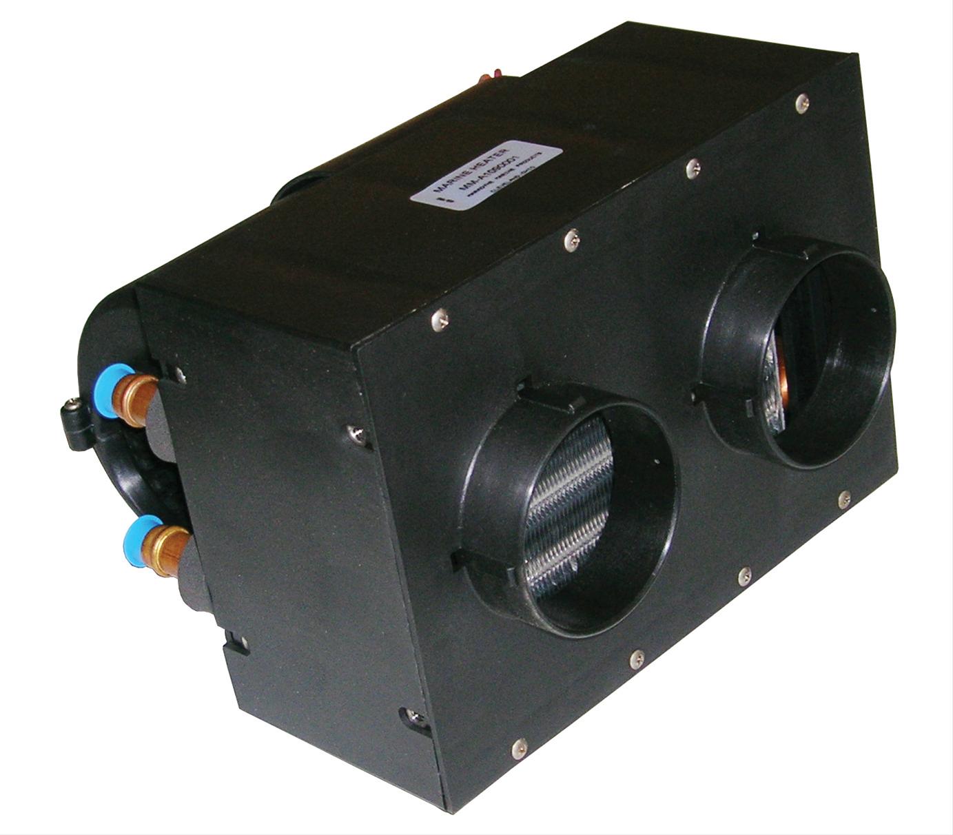

I was flipping thru the Summit Racing catalog and found this, if its heat only solution it might be interesting.
Summit Racing Part Number:SUM-991102-1
Heater Type:Dual front vent
Heater Material:Nylon
Heater Finish:Black
Heater Depth (in):8.625 in.
Heater Height (in):6.500 in.
Heater Width (in):9.500 in.
Heater Flow (cfm):260
Heater Output (btus):28,000
Fan Speed:3-speed
Uses Engine Coolant for Heat:Yes
They also have slight larger one. My car usually goes in at the end of October, and back out late March early April. I am putting in Seat heaters. But I am thinking about adding something like this, or a mustang heater core to the fresh air blower. I have auto-xed in the rain and snow, some times its nice to take a little fog off a window, and kep your hands warm.
Though for me it adds to the weight, weight is bad. But seeing is good, rain-x anti-fog, is also good, just like rain-x is good for cars with out windshield wipers.
Heres my rant, its hard to find weights of any products out there. Summit doesn't even list shipping weights, so if your picking between three items, all with in a few dollars of each other, I will pick the lightest one every time. Yet a racing catalog doesn't list weights. (IMG:style_emoticons/default/screwy.gif)
This thread and a few others linked in this thread will give you an idea what has been done. Bob BIGKAT_83 of course gets my pick for best street solution. (IMG:style_emoticons/default/aktion035.gif)
(IMG:style_emoticons/default/poke.gif) Doug you started that thread.

That's a very cool heater. I am at Summit about once a week, so I'll grab one next time. Great call! (I'll weigh it for you too.)

Since it will be the highest point in the system if it is under the cowl, I would add an air bleed to help purge the system.

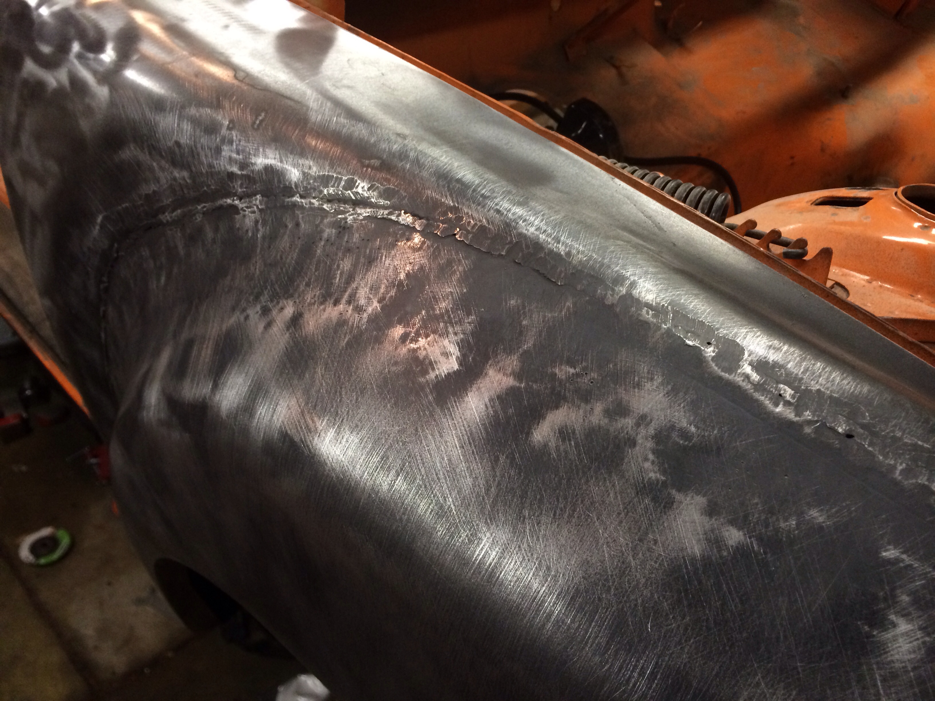

I would repair that. Take a propane torch and heat up the sealant that is wadded up in that pocket and scrap it out clean. The you can start to bump it back into shape. Wish I had the time to come help Doug but I won't be in Cleveland again until April.

I know you would Rick. I think I can get it on my own. Just going to take some time and patience. I don't have much of either. (IMG:style_emoticons/default/biggrin.gif)

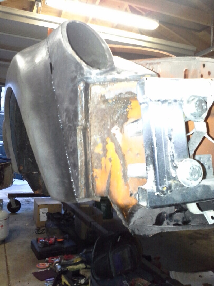

Bill got a bit done today. The front where the metal was all chewed up looks to be formed nicely now. Not perfect, but it is miles better and should clean up very nicely.
Next up is the flares. The welds were tightened up and ground a bit. I can see this coming together nicely too.
He thinks I'll be done and painted in about 3-4 weeks. He'll be on it 8h a day, so I'd expect we may be able to get through it a bit quicker.

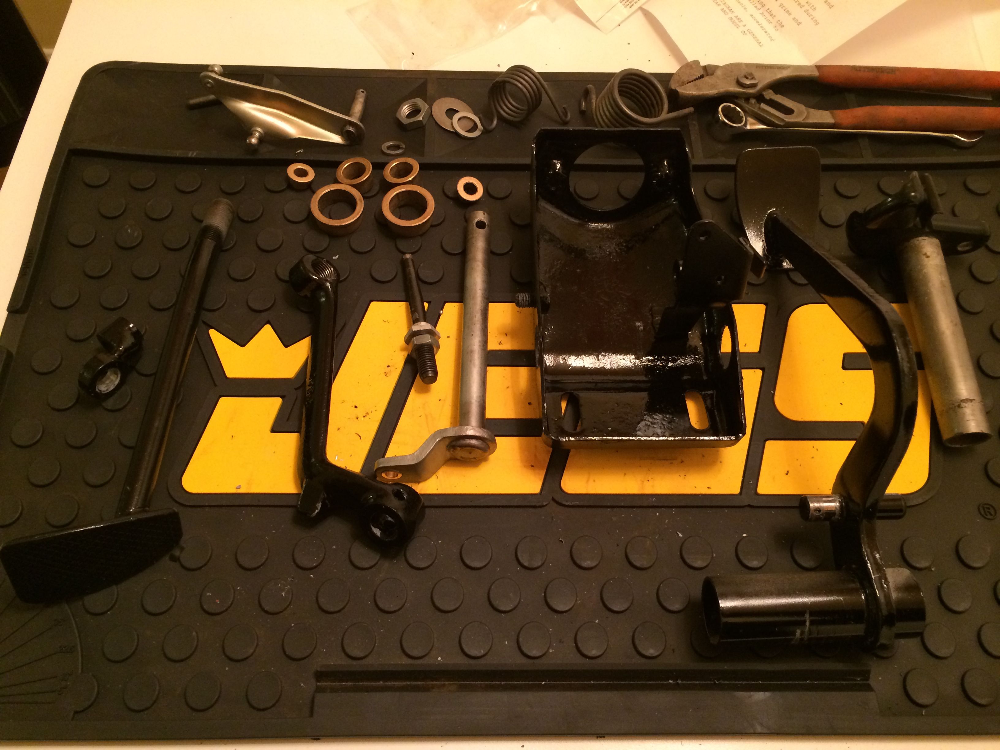

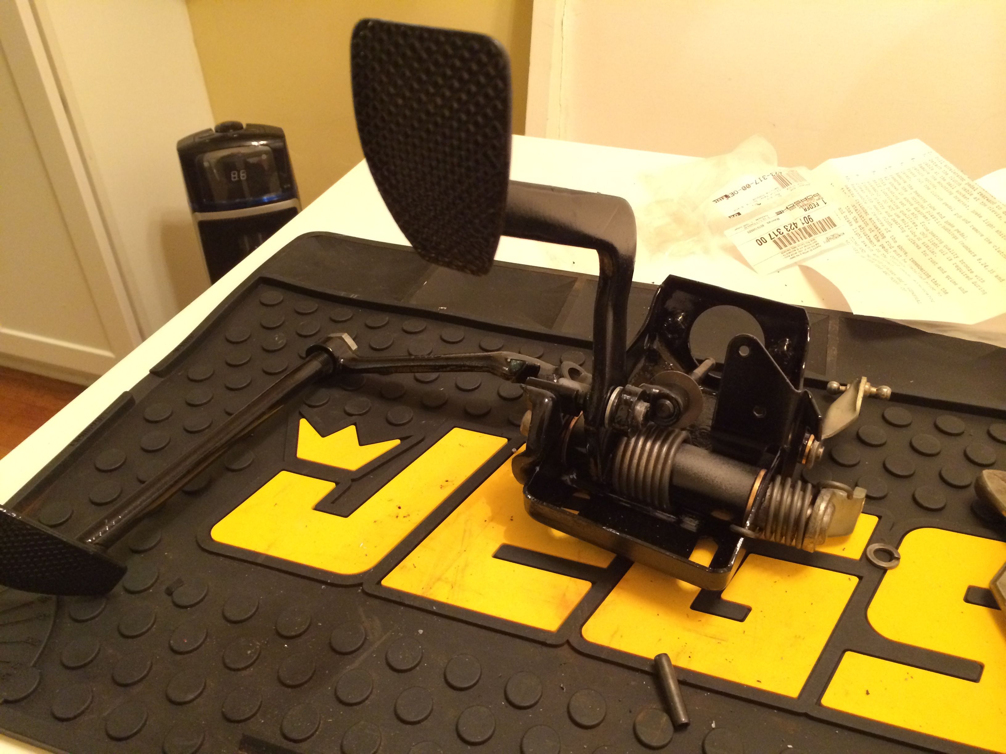

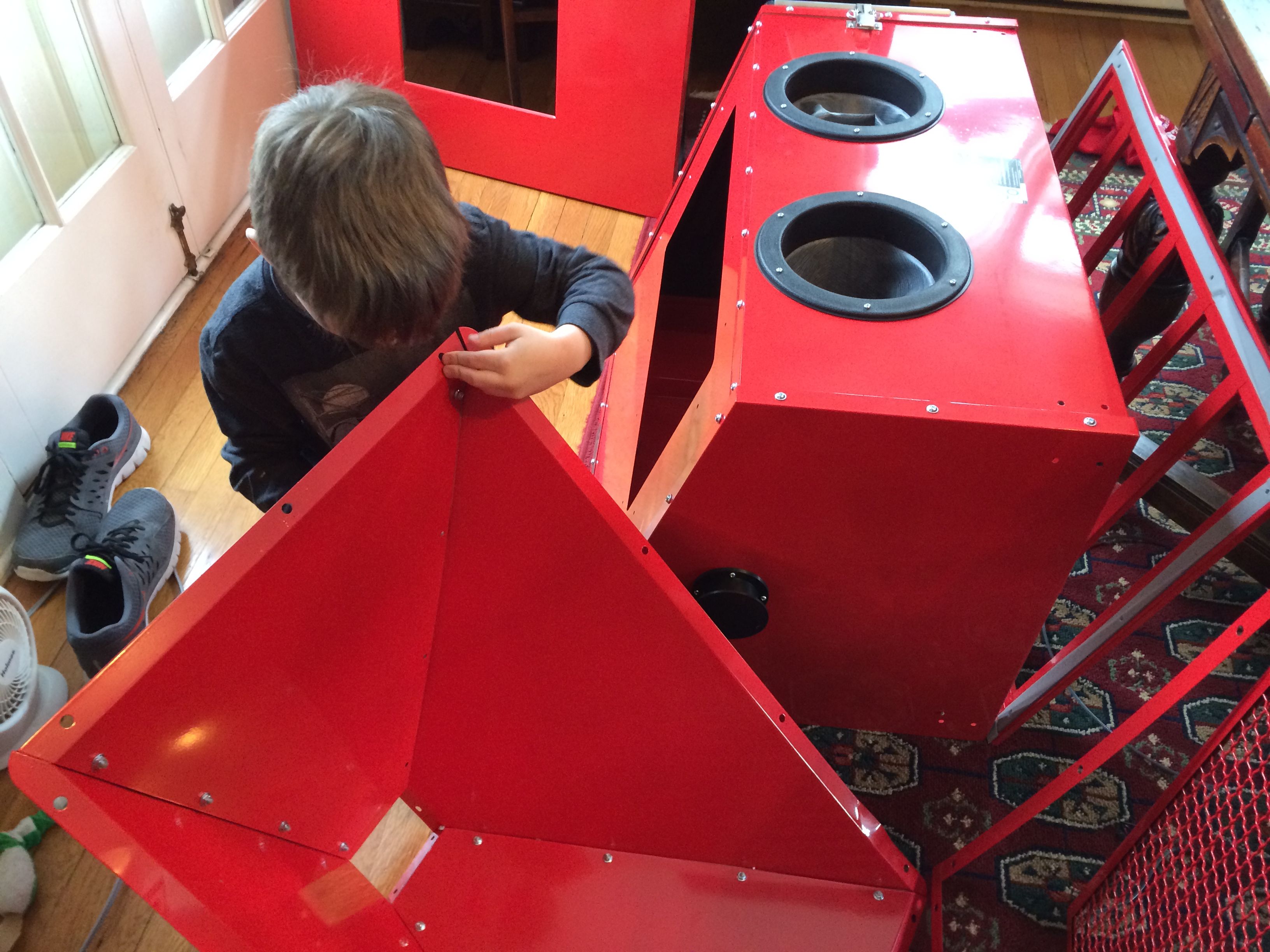

With Bill working on the body over the next few weeks, I can concentrate on all the other stuff that needs done. Part of that, is to get a lot of little things cleaned up.
So....Garrett and I went out and bought a blasting cabinet today. It was on sale from $299 to $209...and I had a 25% off, so for $150 I took it home.
I'd rebuild this cluster, but thought it would be a good idea to break it all down, glass-bead it, and get it out to powder coat after Kent is done with the hydraulic clutch build.
Attached ImageAttached Image
