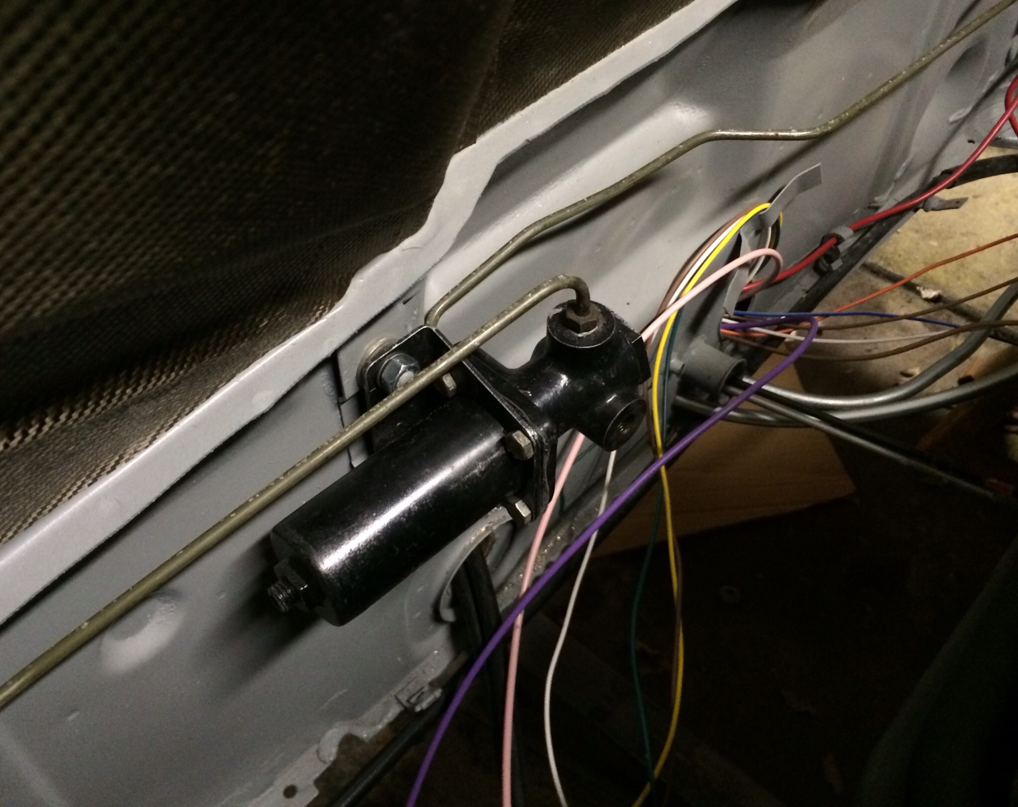

I spent an hour on re-building the proportioning valve tonight. I put it together wrong last time. Doh!

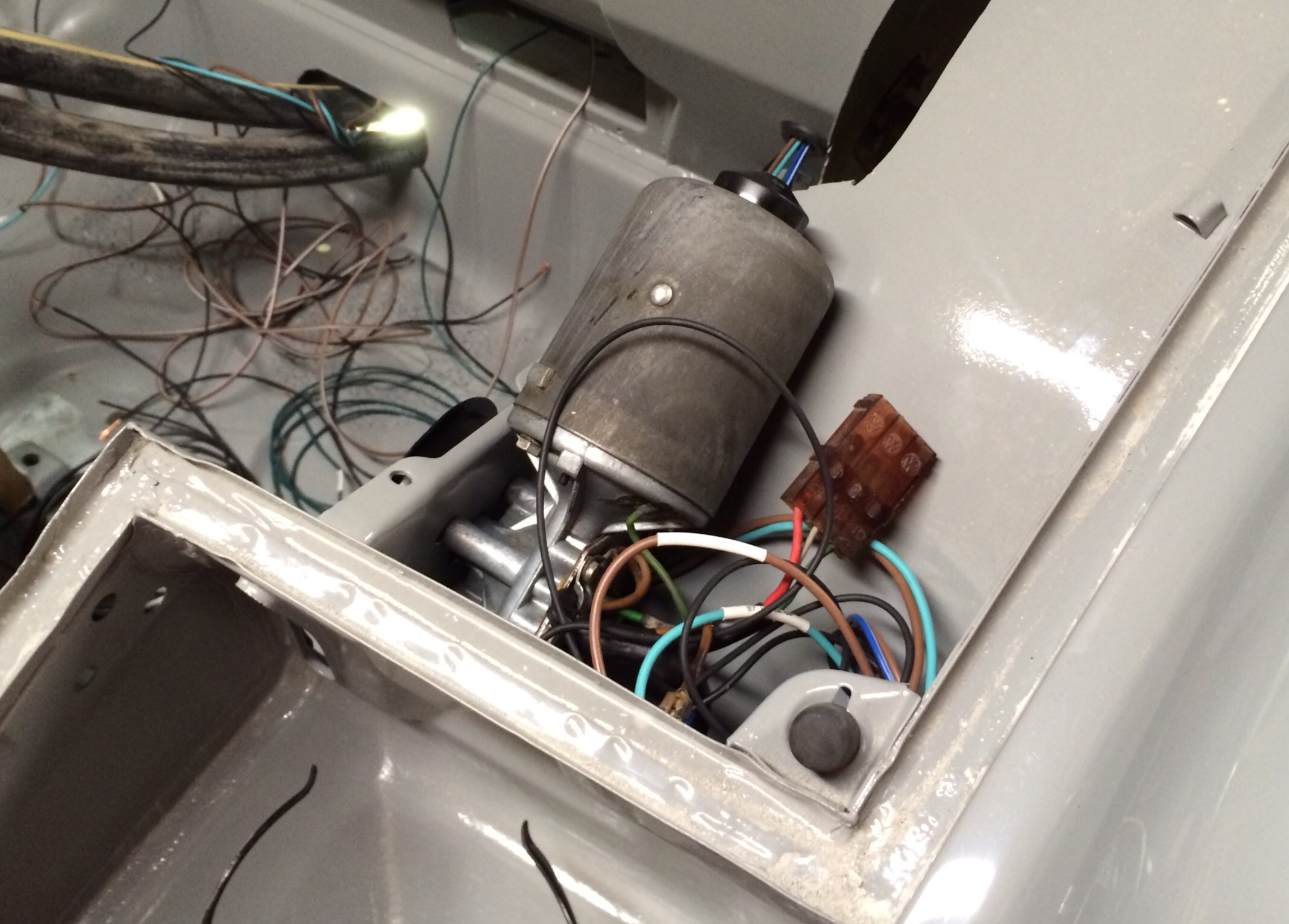

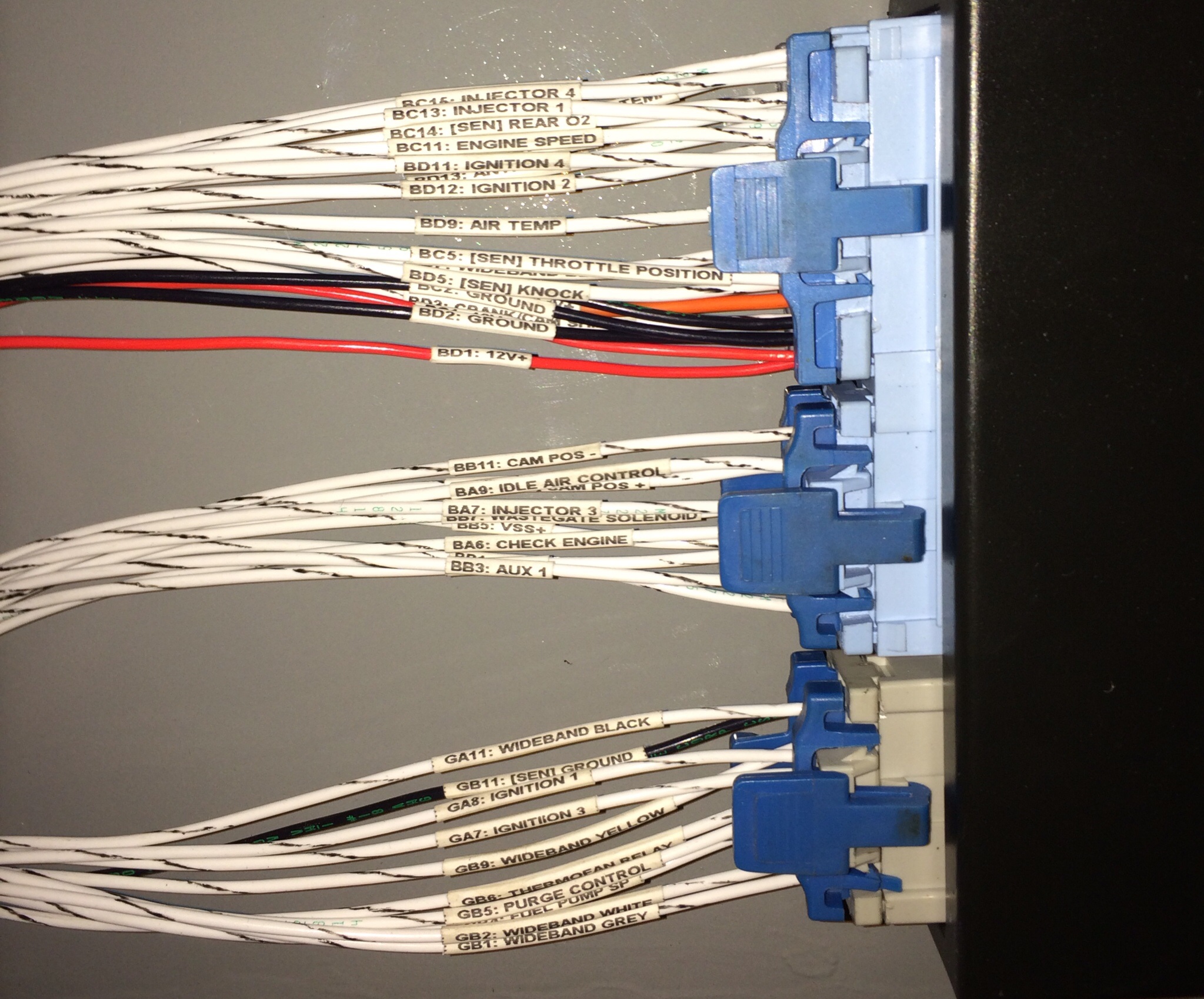

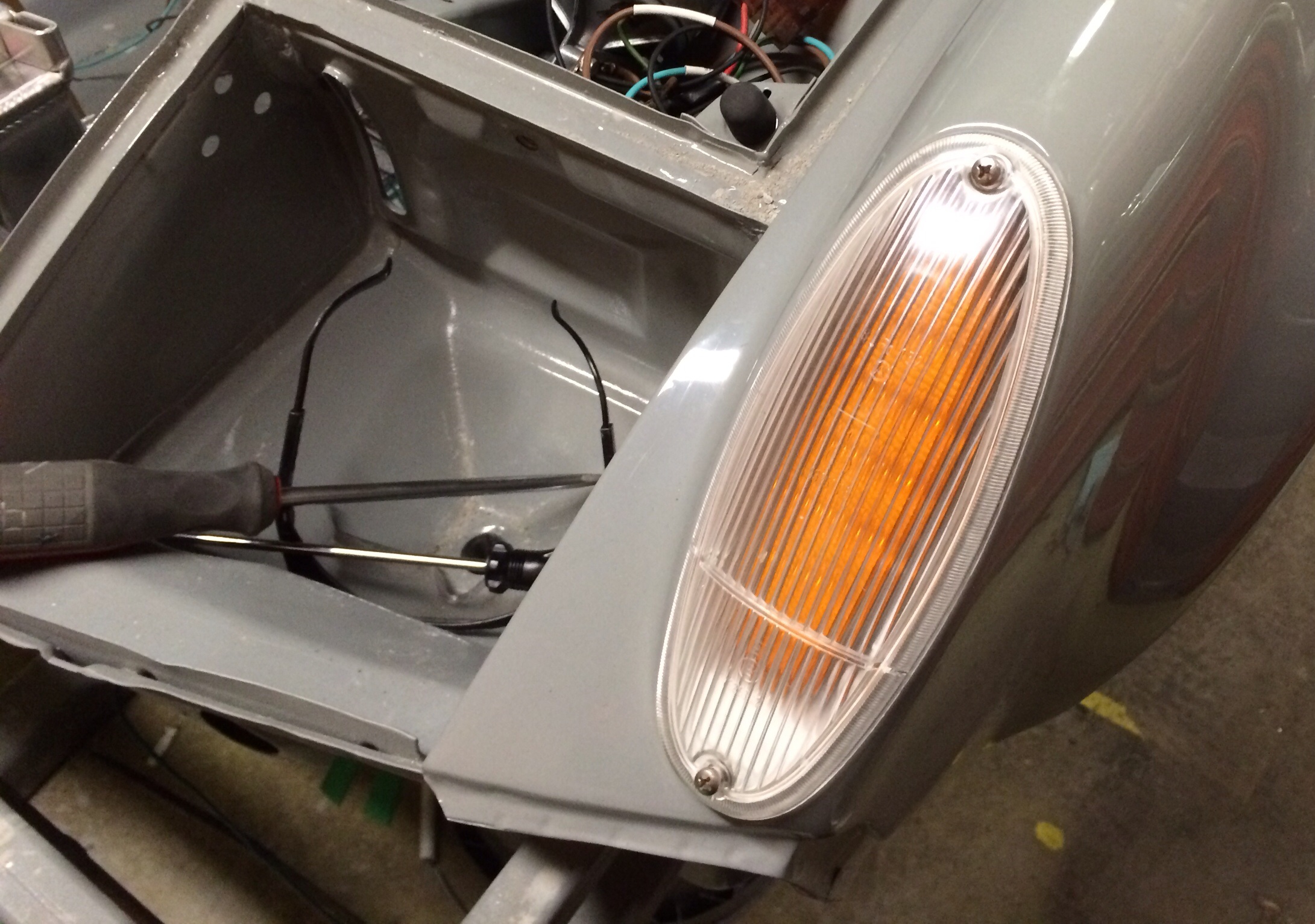

Then I ran the rear brake lines and played around in the front trunk a bit. Got the front marker lights wired up and installed. Then I moved to the ECU and got everything wired and ready to connect. Marking everything was important.
I also installed the wiper motor and squirters, only to realize I'm missing one of the rubber gaskets. Sent an email to Mark about that.
