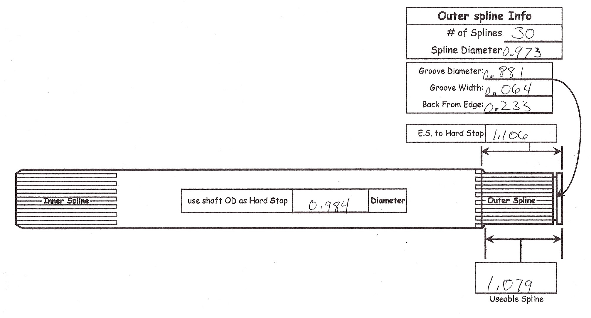

I used 914 axles with a 5 lug conversion and had Dutchman do the machine work. See 3rd photo down for the complete assembly in this post.
And here's the specs I used for Dutchman's to re-spline. You'll definitely want to take your own measurements, but they should be close to what I came up with.

QUOTE(sawtooth @ Sep 5 2013, 09:15 AM) *
Or just buy a pair of sway away axles from Ian at ColdWater
I cant find any ordering or contact info on the coldwater site. I was going to get one of his spline couplers.. I dont want to order one from australia,
Anybody know how to get ahold of that guy to order parts?
Im sure im missing something obvious
Also thanks for those notes, when i called dutchman they just asked me to send the 911 axles with inner cv removed and the subaru axle and remove doj, they didnt ask for those measurements..

QUOTE(Mwood @ Sep 5 2013, 10:57 AM) *
QUOTE(BIGKAT_83 @ Sep 5 2013, 08:46 AM) *
Both 911 and 914 axles can be used. I've had both done.
Bob
Did you have to take any length off of the axles as well as resplining them?
Thanks
Bob may have a different length but on my 914 axles I shortened them to 18" which seemed to work well.
