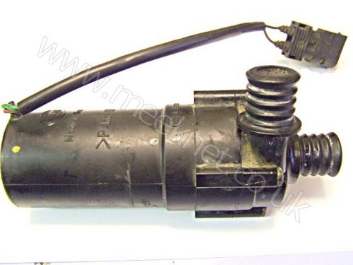

Still works good. It worked better with the rotary engine (runs hot). I'm thinking of adding a BMW heater pump inline to increase hot water flow.
BMW pump

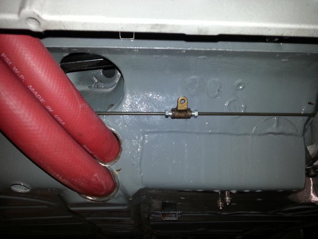

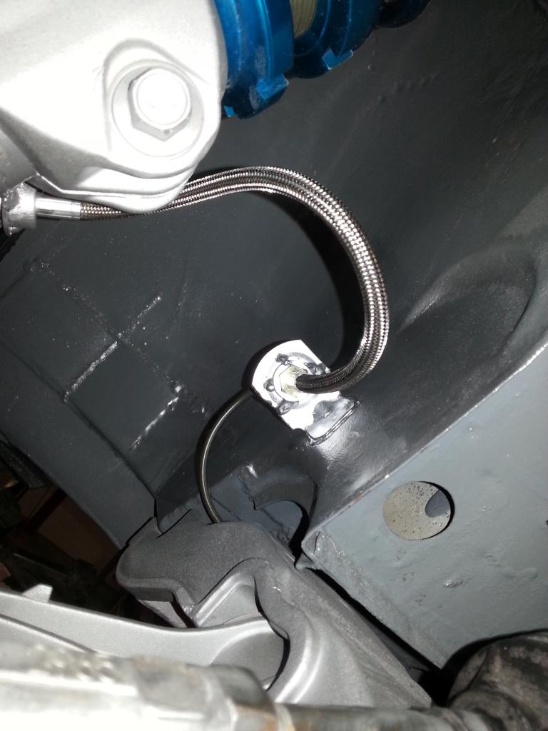

Working on the hydraulic system
(IMG:http://www.914world.com/bbs2/uploads_offsite/i60.photobucket.com-3782-1400635367.2.jpg)

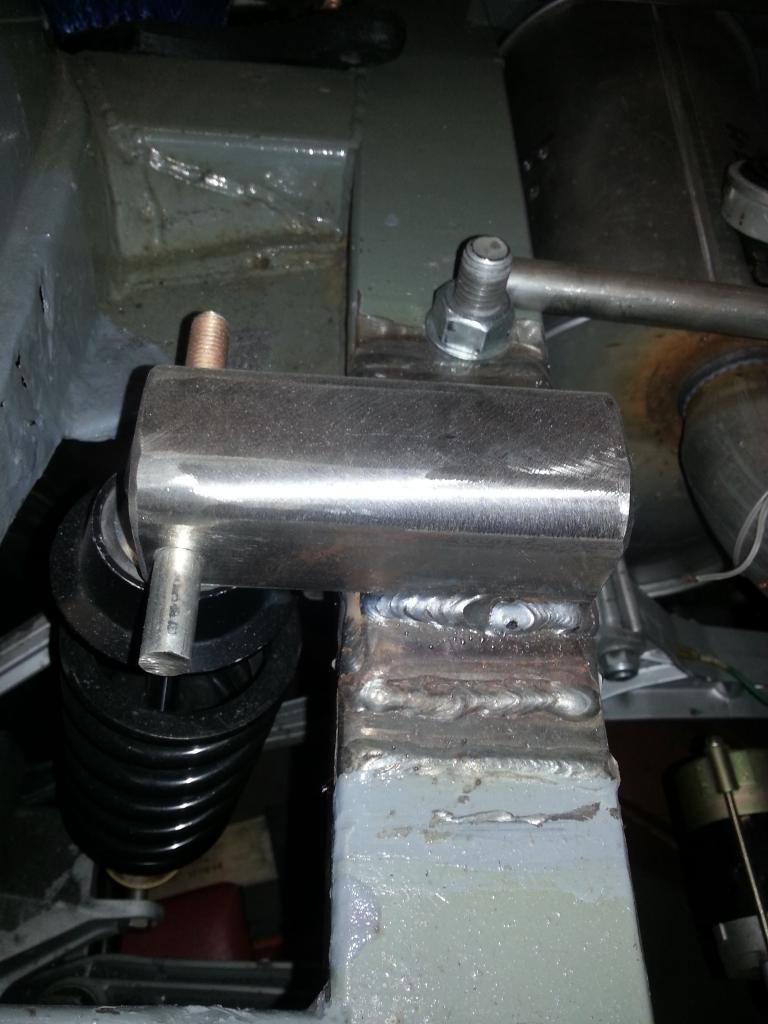

Above you can see I found some metal tube with a 9/16' hex on the I/D. Really just cut down some harbor freight sockets. I need 8 peace's to weld into position. it holds the brake hardware where I want it.
(IMG:http://www.914world.com/bbs2/uploads_offsite/i60.photobucket.com-3782-1400635367.3.jpg)
Here is the front junction two points ya can see the other is going inside under the fuel tank.
(IMG:http://www.914world.com/bbs2/uploads_offsite/i60.photobucket.com-3782-1400635367.4.jpg)
another shot of the hex hold down

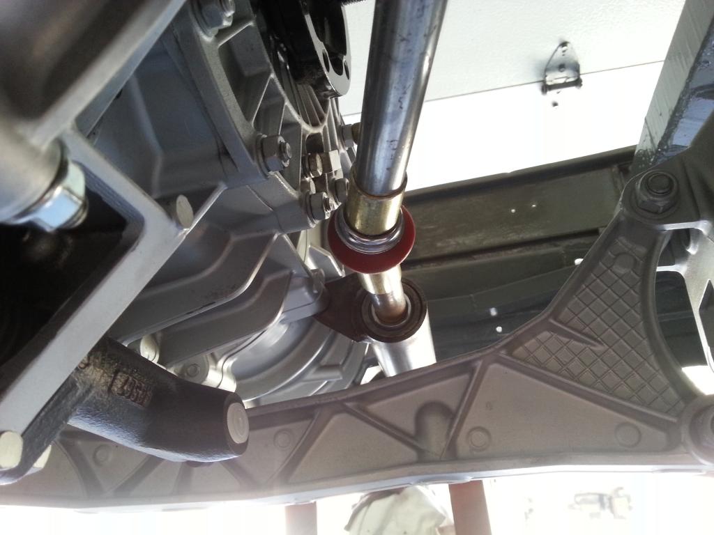

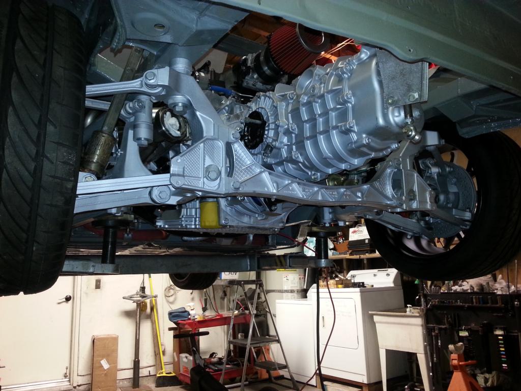

Here is a good picture of the rear set-up. Still need to get the rear springs.

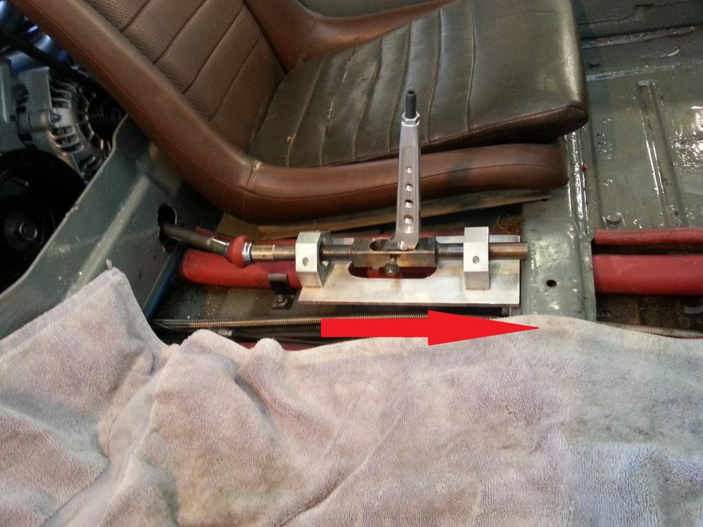

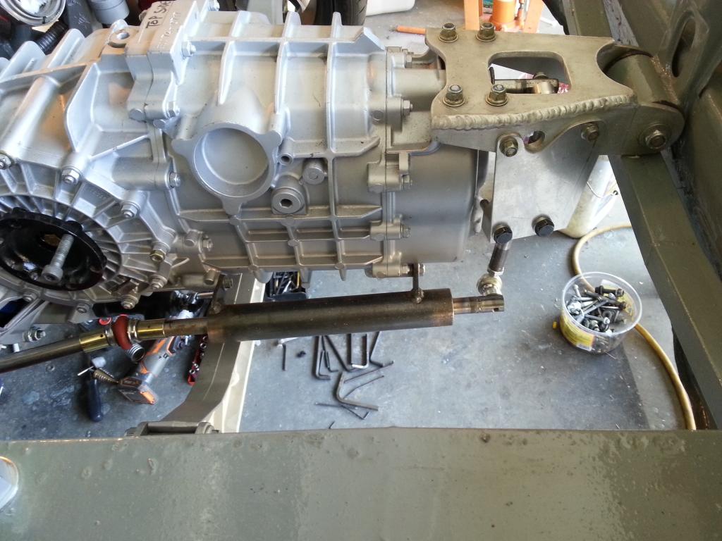

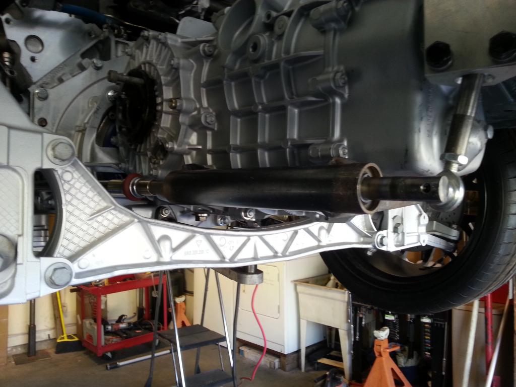

Starting on the solid shift linkage.
(IMG:http://www.914world.com/bbs2/uploads_offsite/i60.photobucket.com-3782-1402274281.1.jpg)
(IMG:http://www.914world.com/bbs2/uploads_offsite/i60.photobucket.com-3782-1402274281.2.jpg)
(IMG:http://www.914world.com/bbs2/uploads_offsite/i60.photobucket.com-3782-1402274281.3.jpg)
(IMG:http://www.914world.com/bbs2/uploads_offsite/i60.photobucket.com-3782-1402274281.4.jpg)

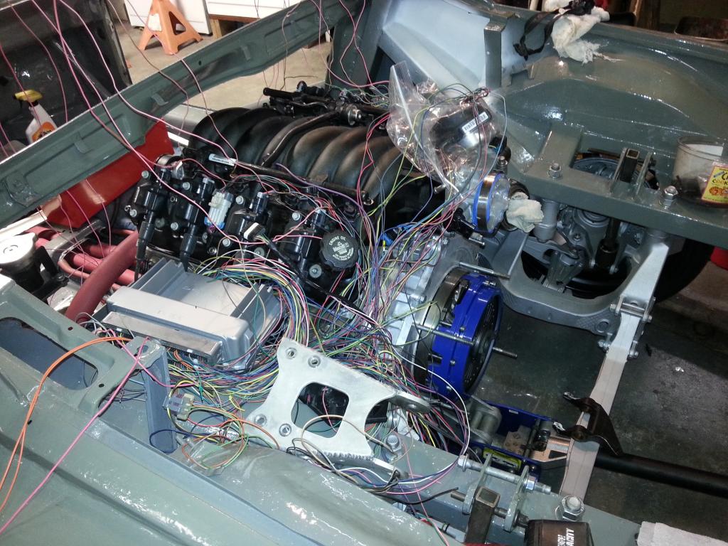

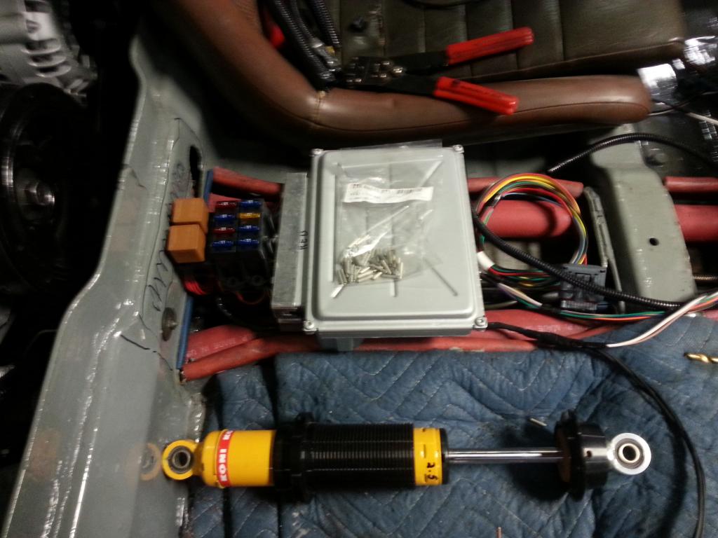

Been installing the wiring harness, I really wanted to have the fuse box close to the driver and not under the dash. The Ls1 PCM is also close to the driver seat. Both will be mounted in the center between the seats. The idea is to build a steel frame center console to house hoses, brake lines etc. Still have a ton of work to do !

John...good progress here with your build ! I didn't know of your black car's destruction BUMMER.
First thing we did on our Cayenne 914 v8 build is take every oe wire out. Re-wiring will be track car use only, so not as many circuits going back in. We will park our 914s parallel at Cars+Coffee one weekend (IMG:style_emoticons/default/driving.gif) (IMG:style_emoticons/default/driving.gif)

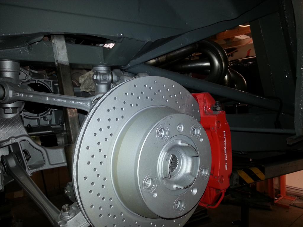

I've been working on my house for the last 8 months had to put the car on hold, well I'm still working on the house but the 914 is in the mix again.
Below is a picture of my rear re-don shock mounts. The older version just didn't make me feel very safe. There's a lot riding on the mount holding up so I used some trailer hitch material should hold up well. I'm likely going to connect the end of the mount to something to keep it from bending up even a little.
I've been away from my car far to long !!!! Gentlemen start your engines !
(IMG:http://www.914world.com/bbs2/uploads_offsite/i60.photobucket.com-3782-1417400883.1.jpg)
To refresh here is a picture of the rear suspension
(IMG:http://www.914world.com/bbs2/uploads_offsite/i60.photobucket.com-3782-1417400883.2.jpg)

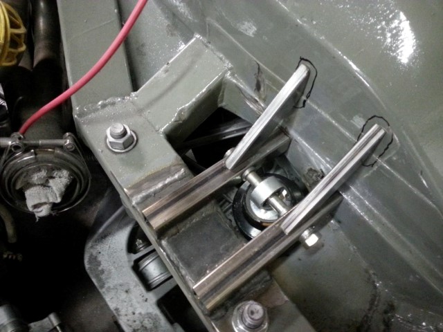

working on my transmission mount. The aluminum mount was well made but I felt it wasn't quite strong enough and got in the way of the cable shifter I'm going to use. My welding is strong but (IMG:style_emoticons/default/KMA.gif) ugly. No worries hours of tedious grinding will make it look a bit less ugly LOL.
I think this mount will hold up well and give the chassis a hand as well.
