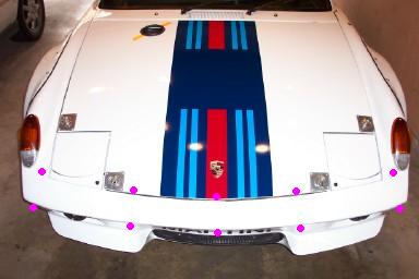

QUOTE(mharmon @ Apr 30 2014, 04:42 PM) *
Eric,
Would you mind posting a pic with the headlights down? I'm torn between adding the hood lights or not.
My 3 year+ build is finally nearing completion, and I can't decide what to do about the hood lights.
Thanks.
Mike
I am in the same boat, I love the look with the head lamps up, but when retracted not so sure. I was only able to find a few shots of 914 GTs with the hood lamps and the head lamps in the closed position.

I have a question on the front bumper. Was it reshaped in the area right in the middle of the car/hood, or was that the way it came? I used to always get on my soap box about how the top of the 916 bumper should be the exact same dimension all the way across the nose of the car (see purple dots in pic). However, anymore it seems like on 99% of the cars that have theses bumpers, they all are narrowed in the center. Was just curious if this was how they were installed or how they were now being molded.
Awsome build.

QUOTE(Scott S @ May 8 2014, 01:40 PM) *
Only the real 916 bumpers have the same width across the top.
I have never seen a reproduction that got it right, they all narrow in the middle.

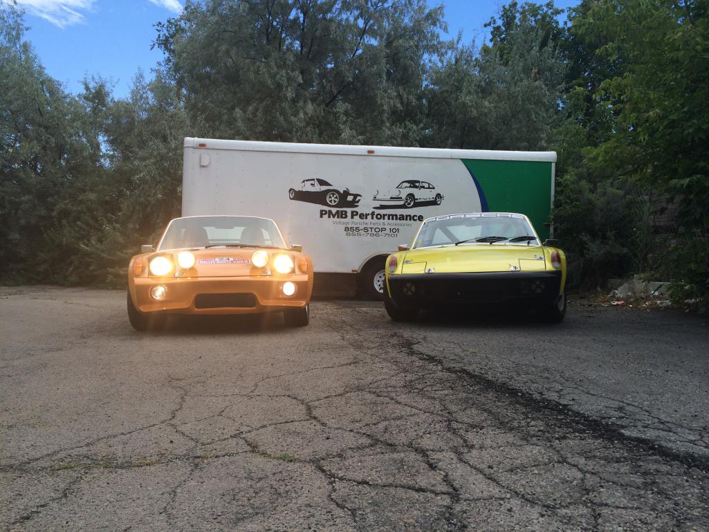

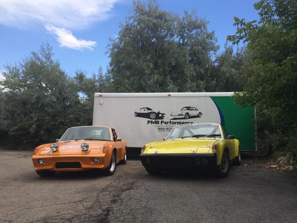

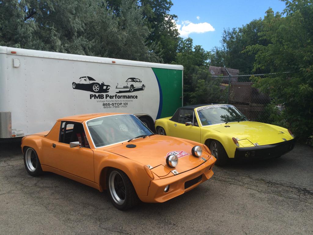

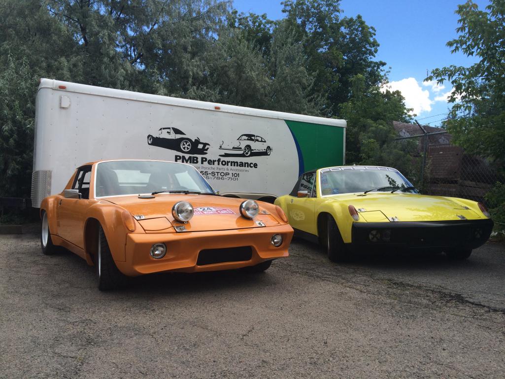

All done. Back to Mike and off to run at Miller Motorsports Park tomorrow.
Still looking to sort out a window solution for the full Lexan panes.
The car ended up eating another turn signal switch and that was the last straw. The dash harness was the last stronghold of "interesting" wiring. We bit the bullet and went all in. From left to right across the dash. All switches, all gauges... everything was sorted and put back to factory condition. A few melted wires in the big rats nest appear to be the culprits.
We took a few pictures before we gave her back. Enjoy.
