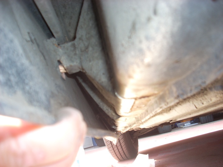

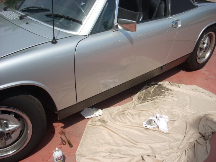

(IMG:http://www.914world.com/bbs2/uploads_offsite/i237.photobucket.com-17475-1403416291.1.jpg)
Ended up jacking it up so I could get at the screws with an impact driver.
(IMG:http://www.914world.com/bbs2/uploads_offsite/i237.photobucket.com-17475-1403416292.2.jpg)
Top part of the rocker cover had rivets.
(IMG:http://www.914world.com/bbs2/uploads_offsite/i237.photobucket.com-17475-1403416292.3.jpg)
Drilled out the rivets. Couldn't decide if I should take off the sill cover but I ended up leaving it alone.
(IMG:http://www.914world.com/bbs2/uploads_offsite/i237.photobucket.com-17475-1403416292.4.jpg)
These proved to be my nemesis. The center one finally budged after a beating with the impact driver. On the rear screw I had to resort to a Vise Grip but broke off the head. I could never get the front one to budge.
(IMG:http://www.914world.com/bbs2/uploads_offsite/i237.photobucket.com-17475-1403416292.5.jpg)
About 2 lbs. of dirt and debris fell out. If you wanted quicker acceleration releasing this mess would do it. (IMG:style_emoticons/default/biggrin.gif)
(IMG:http://www.914world.com/bbs2/uploads_offsite/i237.photobucket.com-17475-1403416292.6.jpg)
(IMG:http://www.914world.com/bbs2/uploads_offsite/i237.photobucket.com-17475-1403416292.7.jpg)
After all that this is what I found. Phew. I think it looks clean. I don't think I even need to pull the other side except to release all the dirt.
(IMG:http://www.914world.com/bbs2/uploads_offsite/i237.photobucket.com-17475-1403416292.8.jpg)
Pop-riveted the cover back on. I have a selection of rivets and found some that worked perfectly.

Nice job!!.
Ha! I spent today doing the same thing! (IMG:style_emoticons/default/smile.gif)
My pile of crud was smaller.

I found a bunch of rubber worms. They came from the years of racing; rubber peeling off the slicks. What amazed me was the fact that none of the other PO's (3) ever pulled the rockers.

Hi Swooshdave- Nice work thus far but you are only 1/2 way there. You definitely need to pull the passenger side rocker as that it where you will find trouble if it exists. The driver's side looks nice, pull the passenger side and clean it and hopefully it will be as nice.

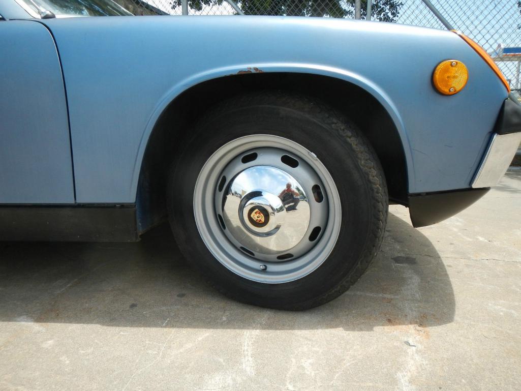

Those are not 356 wheels. 356's never had 4 lugs. I think those are aftermarket chrome rims and caps, mostly marketed at the Volkswagen crowd.

You'll find that most of us will not represent these cars to be something they arent. Dont get me wrong, they are a Porsche.

I posted this picture a few weeks back, appropriately in the sandbox, cause I mentioned the similarity to a penthouse babe's nipple..... (IMG:style_emoticons/default/aktion035.gif) probably why I am drawn to them.
1 respond-er said they were 356. I know you can't believe everything you read, but his are not much different...... a bit less nipply, but close enough to fool me.
and you have good eyesight, cause I don't see any lugs on post #1 pic. I would bet they have 4. (IMG:style_emoticons/default/confused24.gif)

I don't need to see any lugs. Porsche 356 5 lug wheels have a raised area around the oval cutouts around the rims. These rims are flat around the cutouts. Another giveaway is Porsche 356 rims have 10 oval cutouts and these only have 8. Pull a hubcap, I can guarantee there are only 4 lugs.

Sorry to burst your rocker bubble but the other side is actually the one that is usually worse.
You started with the "good" side!
