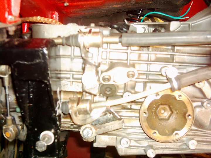

ajracer
post Aug 18 2005, 10:10 PM
Post #66
Posts: 204
Joined: 18-April 04
From: Toronto, Canada
Member No.: 1,945
Greetings:
Well just hour before the weekend and FIRE-UP the baby and evaluate how
everything is before maybe a spin around the country at the Canadian Por
Volks Festival this Sunday.
Just re-installed the tranny this evening, my own Custom Flywheel, a new
Kevlar Clutch and Special Pressure plate. An YES for any newcomers viewing
this thread BOXSTER tranny behind my Chevy LT1 350. A few days ago finished
up the cable shifter brackets, fabricated a clutch linkage in order to maintain the
914 cable set-up. No sure about the operation of clutch set-up yet, but can
always convert to hydraulic if needed. Radiator, shroud, fans and electronics
also went in over past few days.
Just need to ADD the Water, hook up electrics for fuel pump and should be
Vroom, Vroom, Vroom. Update to follow; excitement is GROWING !!
Allan

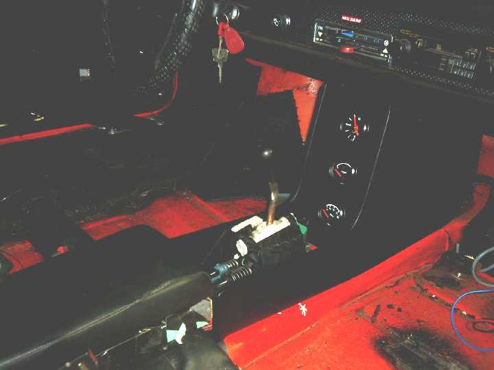

Some photos for those interested.
Vehicle is now driveable and I have about 100 miles on the V8 - Boxster
engine tranny combination. The cable shifter is real sweet and precise,
but couple of minor items to sort out with the engine, clutch linkage, etc.
Diffinitely has some balls, and MY first time DRIVING any 914 !!! but this one
is easy to "fall in Love with"
Allan

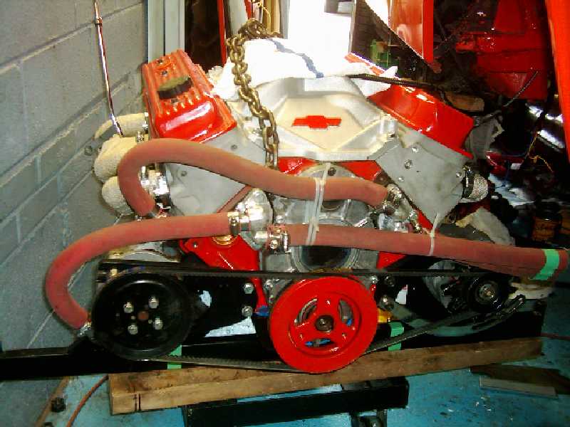

Another photo for Roger;
prior to installing into teener

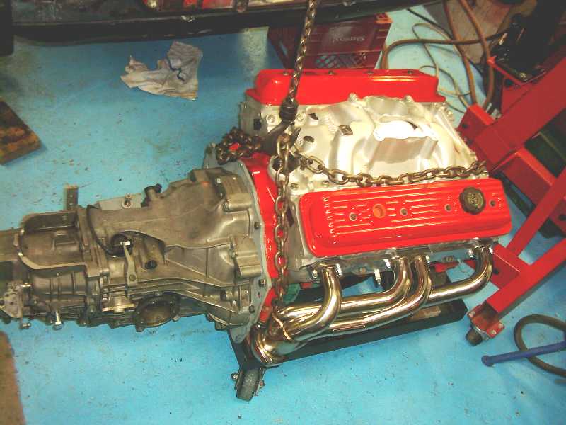

ajracer
post Oct 8 2005, 09:52 PM
Post #74
Posts: 204
Joined: 18-April 04
Member No.: 1,945
Another one for Roger
during tranny installation
