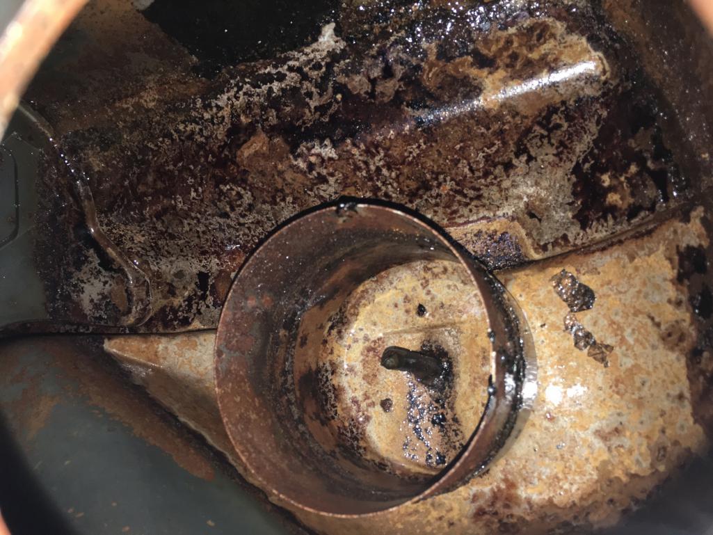

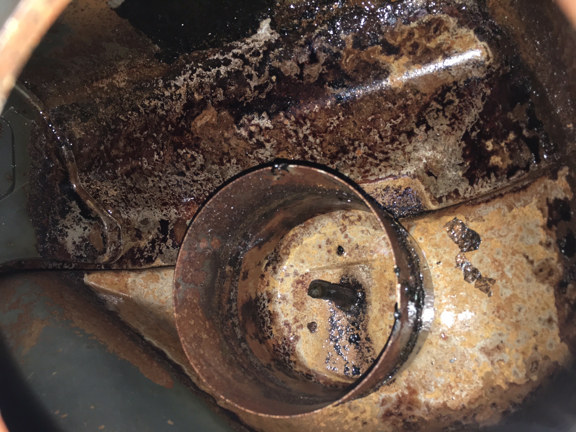

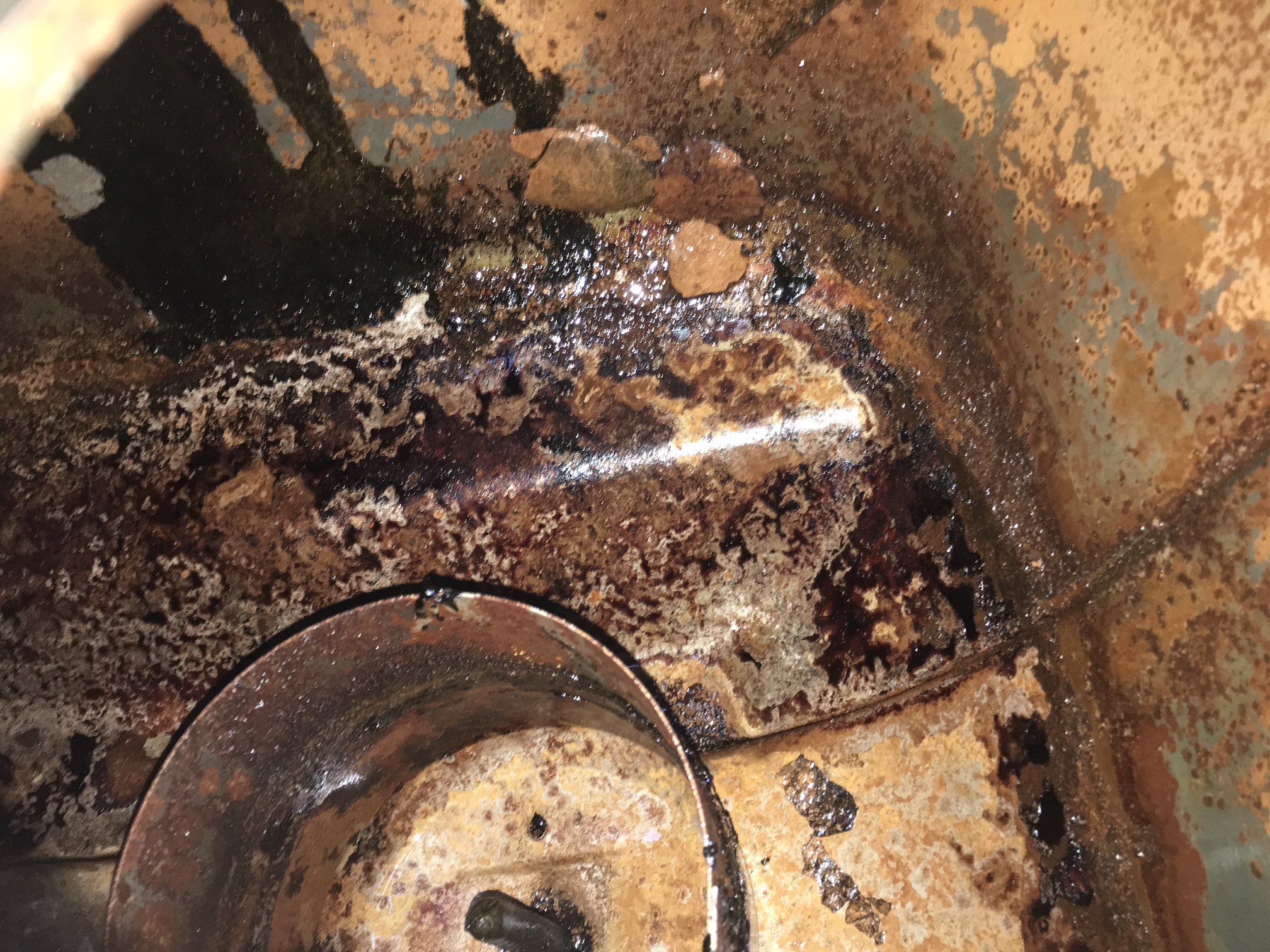

I took some time tonight and started cleaning the gas tank. There was quite a bit of debris in the tank but I think most of it was caked on varnish. I hosed the tank out real well and it looks pretty decent, not too rusty but plenty more to get out. I went ahead and poured a couple gallons of apple cider vinegar in it and will let it soak a few days.
Before pics

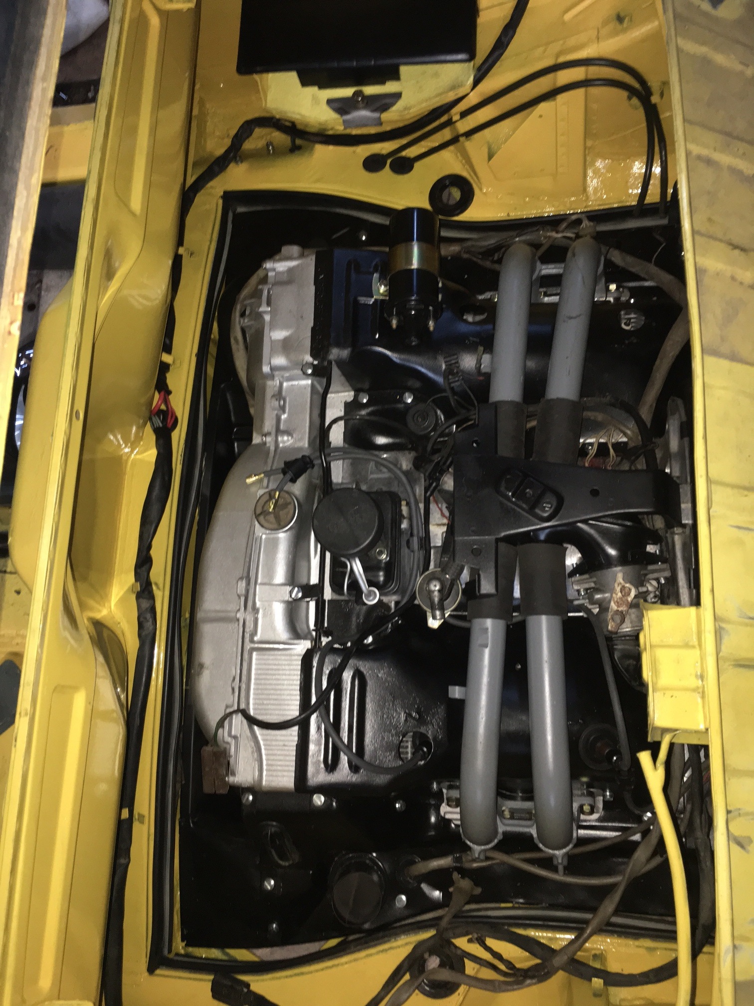

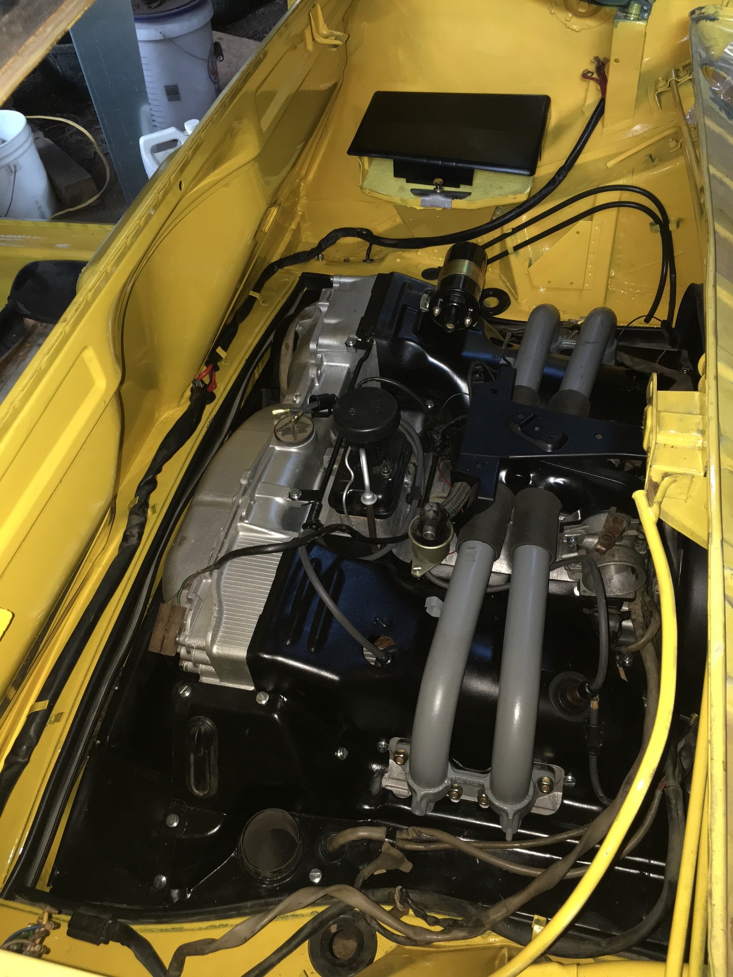

Got the engine installed today. Installed the new clutch fork bushing. Mated the transmission. Installed the intake on top of the motor and routed the wiring harness. Also installed all new bushings for the shifting system. I'm hoping to button up some more things things tomorrow (fuel lines, vacuum lines, exhaust, distributor) and will be very close to starting it up.

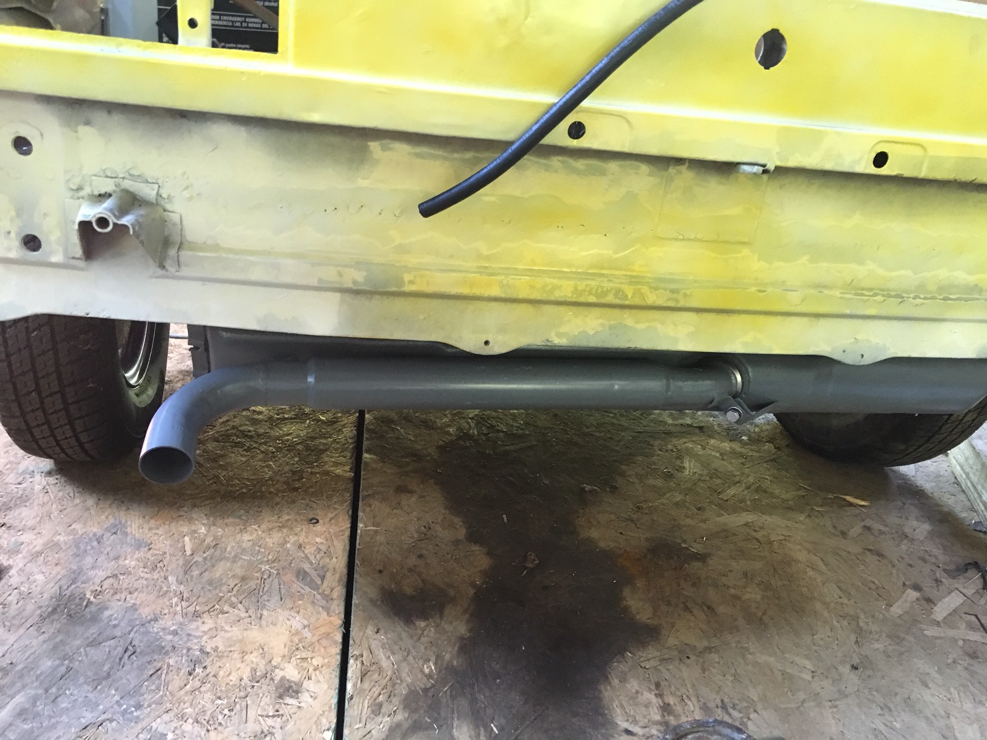

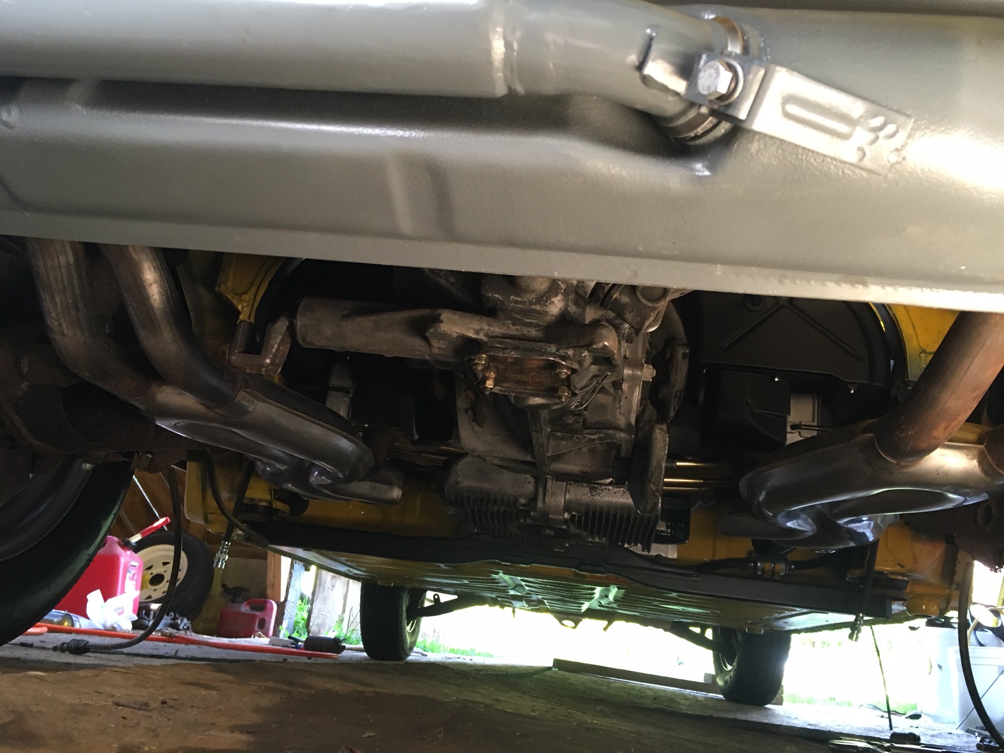

I got the exhaust installed on the car. Also installed all the fuel lines/injectors on the engine and then proceeded to finish cleaning out the gas tank, replacing the sock screen, cleaning the sending unit, and replacing the upper seals. Distributor is also cleaned up and ready to install.

Got the rest of the motor hooked up tonight. Turned the key... No smoke (IMG:style_emoticons/default/smile.gif)..... And no fuel pump (IMG:style_emoticons/default/sad.gif). I was eventually able to get the pump going but still could not get it to start. It came real close to starting but no cigar.
I'm thinking Im either not getting spark at all four or some of my injectors are not squirting. I'll be doing some more tests tomorrow to hopefully get it going..

Talked to PMB today. Calipers should be here by the end of the week. (IMG:style_emoticons/default/piratenanner.gif) In the meantime I have plenty of work to do. I took some time tonight after I got the motor running to clean up the axles and got them degreased. Will hopefully assemble and install tomorrow.

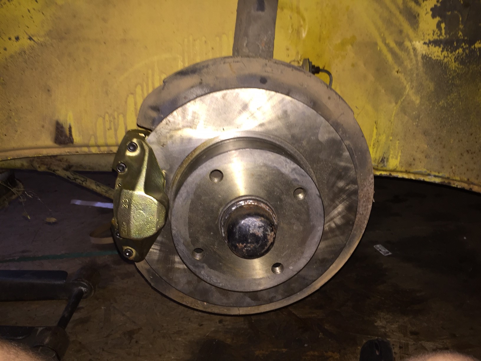

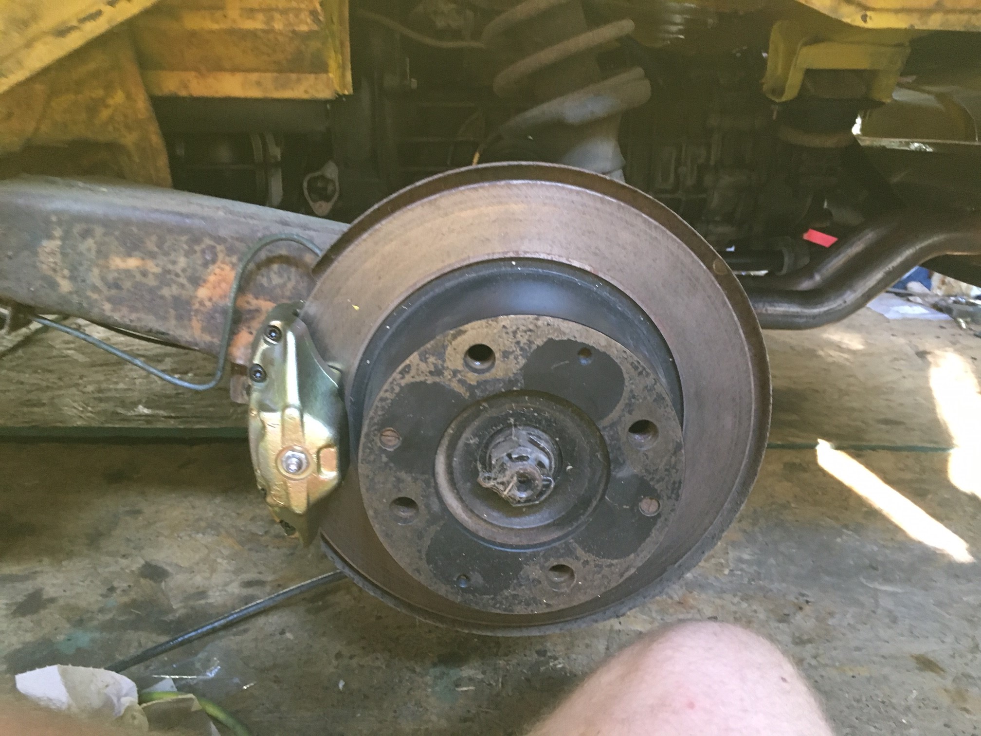

Unfortunately the week before Okteenerfest I started to have some medical issues and could not work on the car. So I ended up missing the event and the car is still not drivable. Although I’m still having issues, I recently started to feel well enough to get back on the car. I installed my new calipers. soft lines, and some lightly used rotors on the rear of the car. For the front I installed new rotors, bearings, calipers and soft lines. PMB is having some issues sending me all of my order. I was missing the brake caliper hardware for the front and they are taking their sweet time to correct it. Luckily I went out last night and found some cores with the correct hardware and went ahead and installed them. I started to do my initial bleeding but ran out of time. The only thing the car needs to start driving is to bleed the brakes. Hopefully this weekend I can take it on the road just in time to enjoy some of this beautiful fall weather.

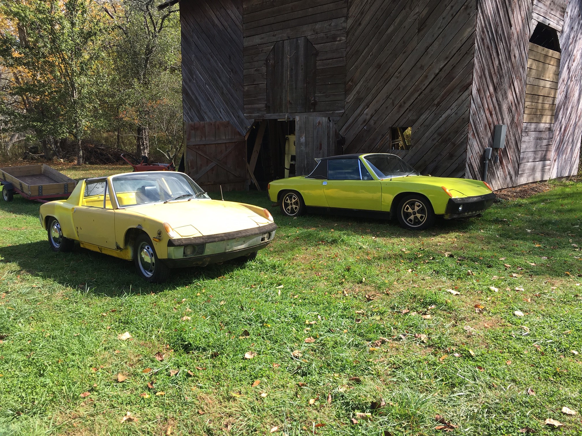

Well it ain't pretty but it is now running and driving. (IMG:style_emoticons/default/driving.gif) I'm officially stoked.
I bled the brakes, tied up some cables underneath, and spent some time adjusting the shift linkage. It's probably been about 4 weeks since I last started it and it roared to life instantly. (IMG:style_emoticons/default/smile.gif)
I've only driven it around the block and around my field a couple times but the engine runs so smooth and so far completely dry underneath. I can already tell the 1.7 is pretty gutless but I'm looking forward to putting it through its paces. The transmission shifts like butter which is good news since the state of the transmission was unknown up to this point. Front lights all work, horn works, wipers work, turn signals work.
