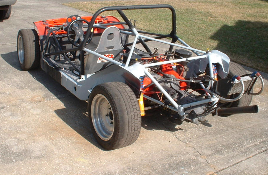

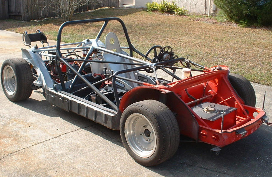

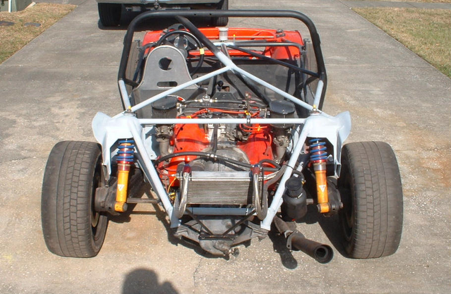

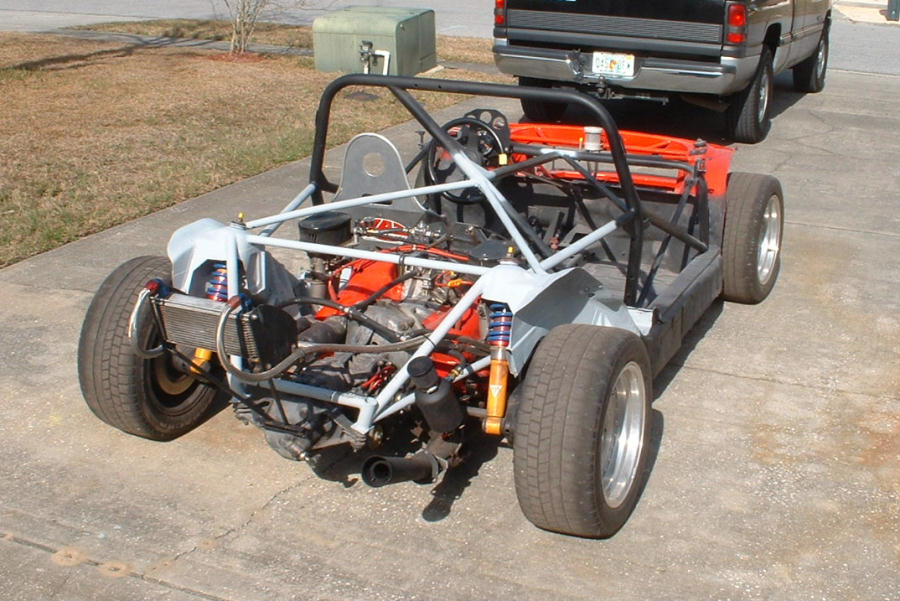

I built the lightest 914 in the history of mankind. ![]() ![]() ![]() ![]() ![]() ![]() ![]() ![]() ![]() ![]() ![]() ![]() ![]() ![]() ![]() ![]() ![]() ![]() ![]() ![]() ![]() ![]() ![]() ![]() ![]() ![]() ![]() ![]() ![]() ![]() ![]() ![]() ![]() ![]() ![]() ![]() ![]() ![]() ![]() ![]() ![]() ![]() ![]() ![]() ![]() ![]() ![]() ![]() ![]() ![]() ![]() ![]() ![]() ![]() ![]() ![]() ![]() ![]() ![]() ![]() ![]() ![]() ![]() ![]() ![]() ![]() ![]() ![]() ![]() ![]() ![]() ![]() ![]() ![]() ![]() ![]() ![]() ![]() ![]() ![]() ![]() ![]() ![]() ![]() ![]() ![]() ![]() ![]() ![]() ![]() ![]() ![]() ![]() ![]() ![]() ![]() ![]() ![]() ![]() ![]() Group: Members Posts: 132,310 Joined: 3-February 03 From: Jacksonville, FL Member No.: 222 Region Association: None |

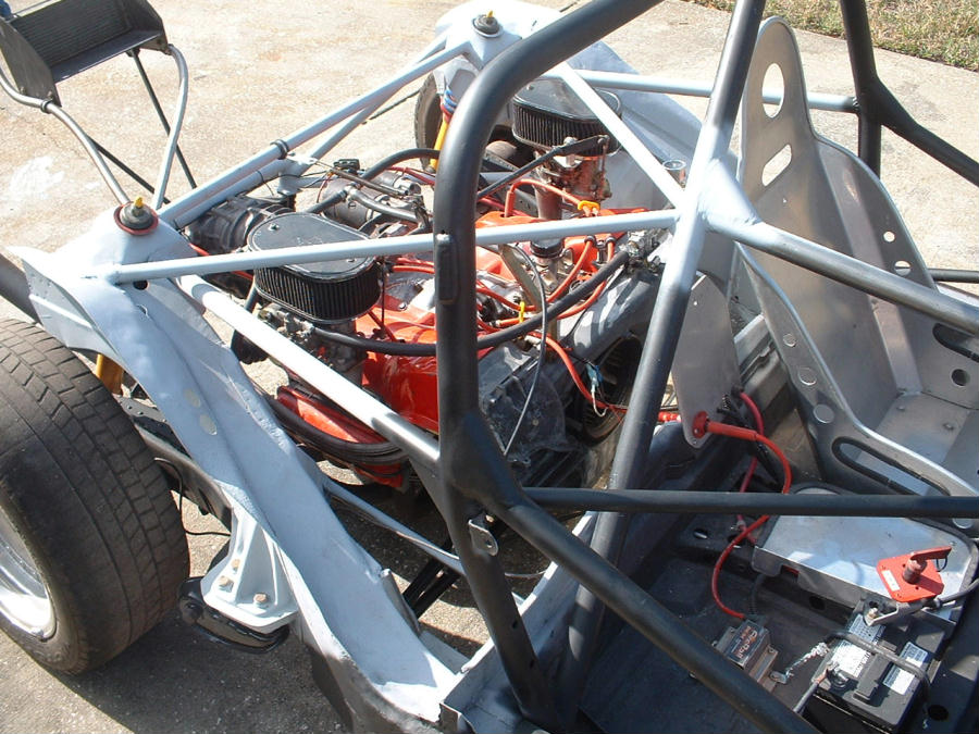

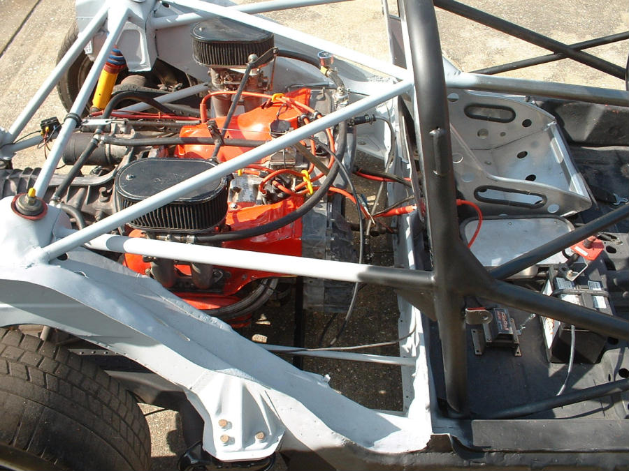

I got it back together enough to get it running yesterday.
Had a few problems, leaky gas line fitting and it wouldn't turn over. Gas line fitting was fixed quickly but the starter had me going for awhile. It seems my stater relay needed to be grounded to the car. I have it mounted on the bar with clamps that have rubber insolators on them. I had to run a seperate ground wire but it started right up. It is seems very low... Attached thumbnail(s)
