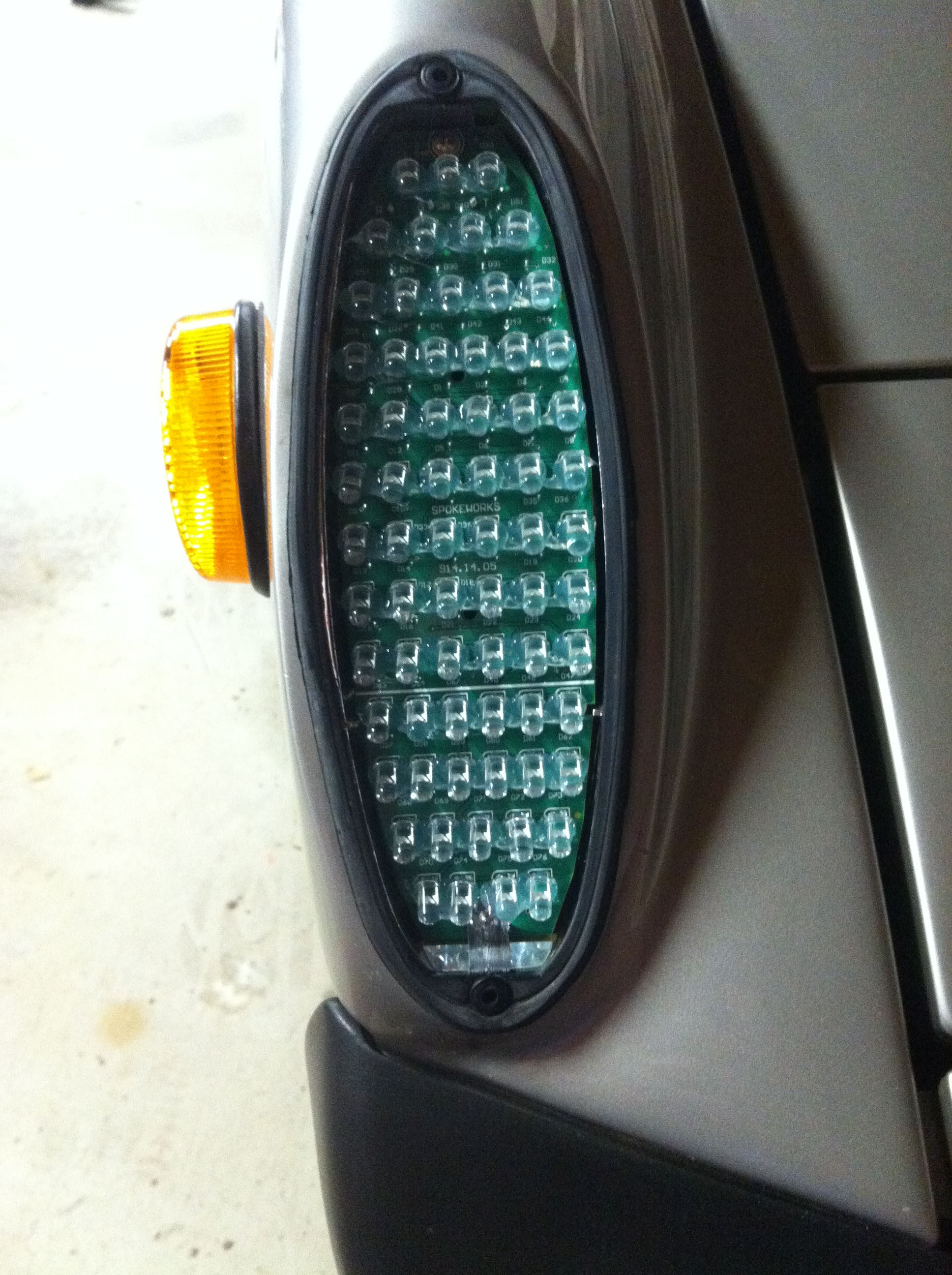

Having recently participated in an Amazing Group Buy for Spoke's front and rear LED turn signals... ( Thread here: http://www.914world.com/bbs2/index.php?sho...mp;hl=LED+bulbs )
I wanted to round out the rest of the exterior bulbs for the car making it fully LED (not including headlights yet...)
I recently finished my project and figured I'd post up info to help others that are looking to make that change as well. Its as easy as changing out the bulbs, provided the LED's are the right replacements...
I used superbrightleds.com as my vendor, there are other choices, I'm not saying any one is better than another, this is only meant for a guide for those who want to skip the research portion and get 'er done. If you guys have more to add go for it...

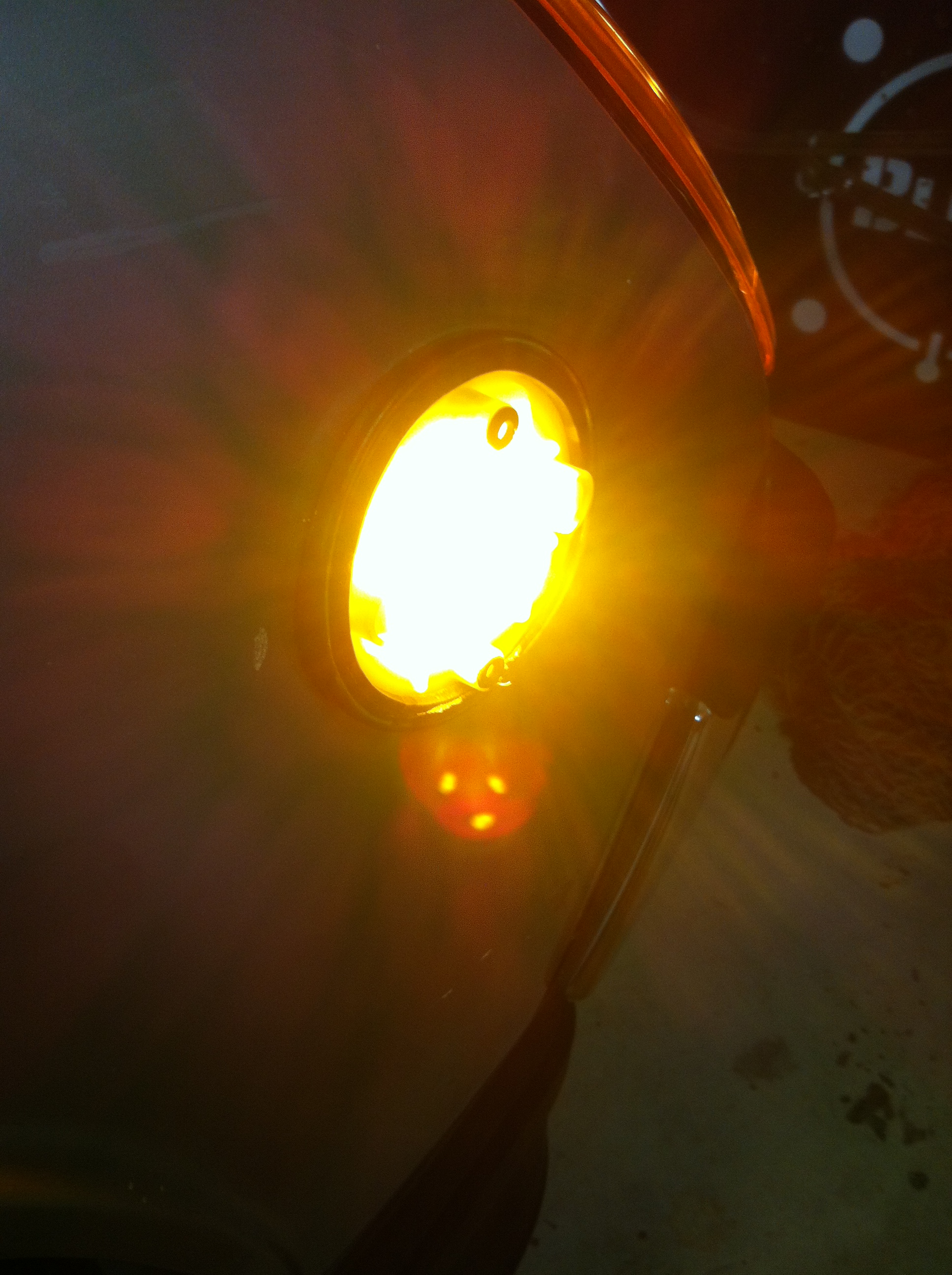

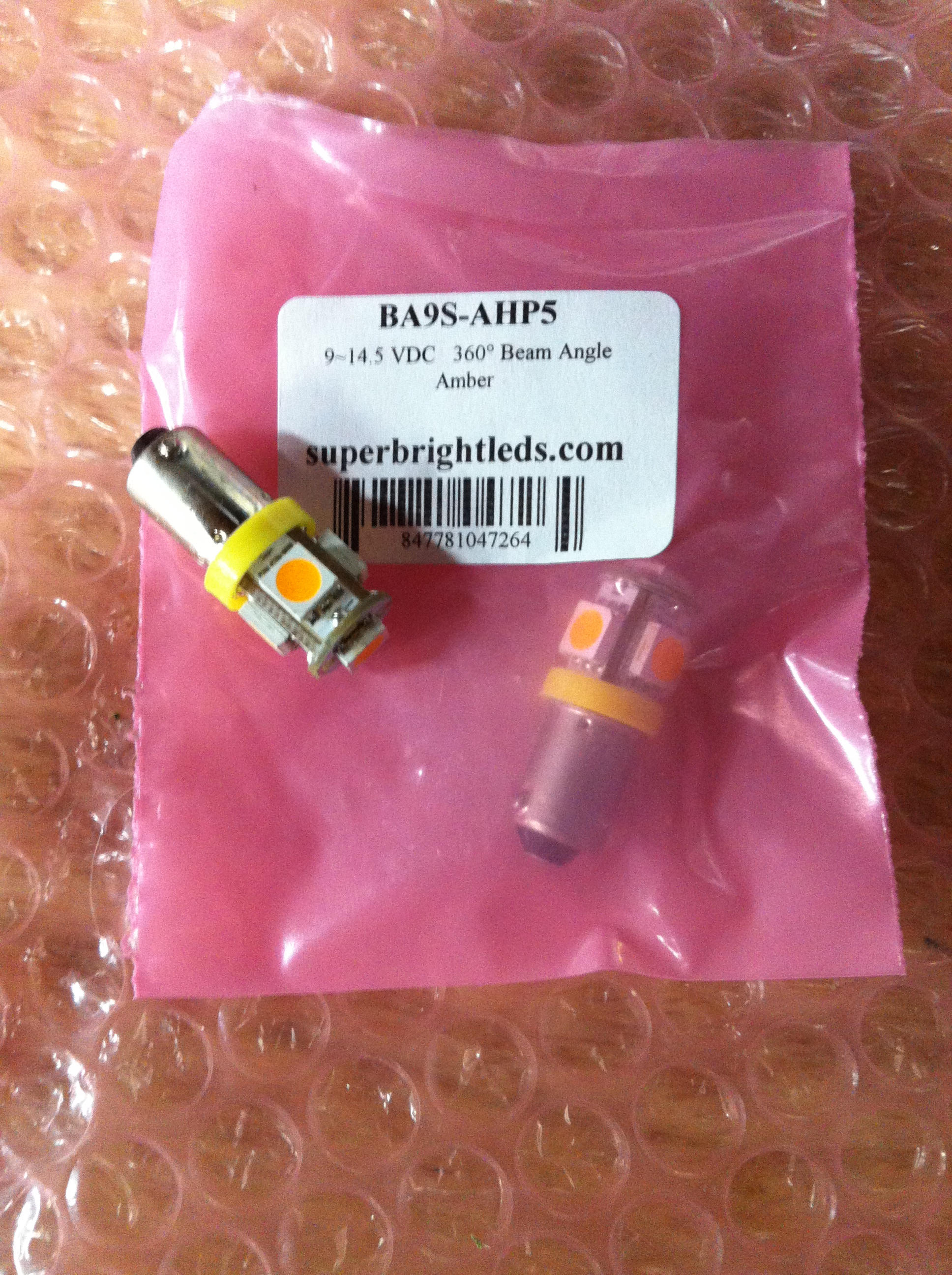

eric9144   (2) Front side marker bulbs – Amber $6.95...   Mar 13 2015, 03:02 PM

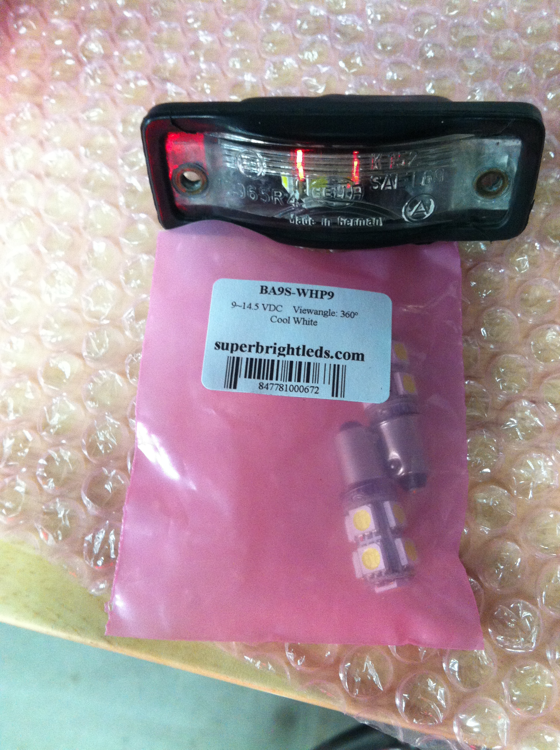

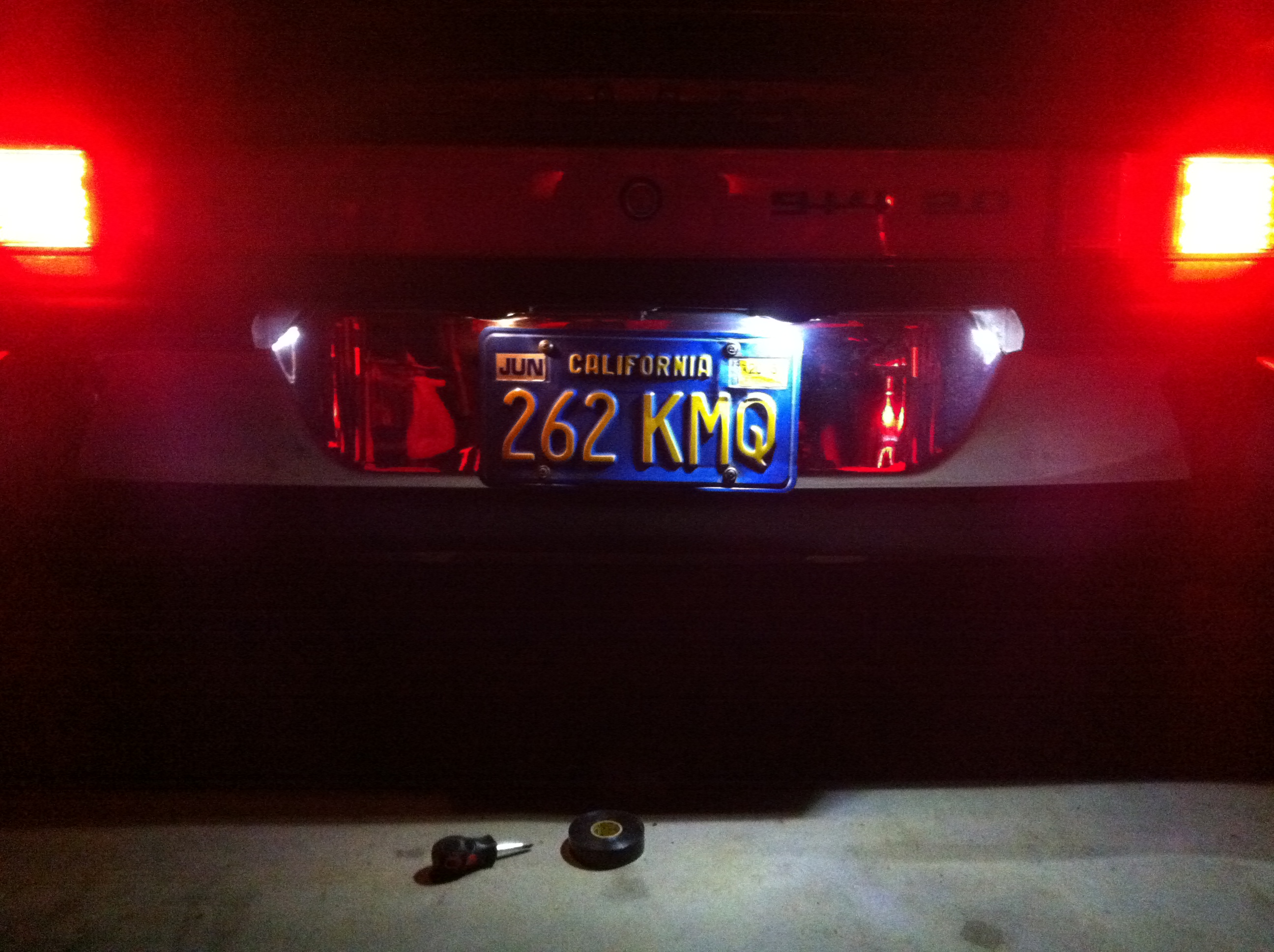

eric9144   (3) License Plate Lights and Rear Trunk Light bulb...   Mar 13 2015, 03:04 PM

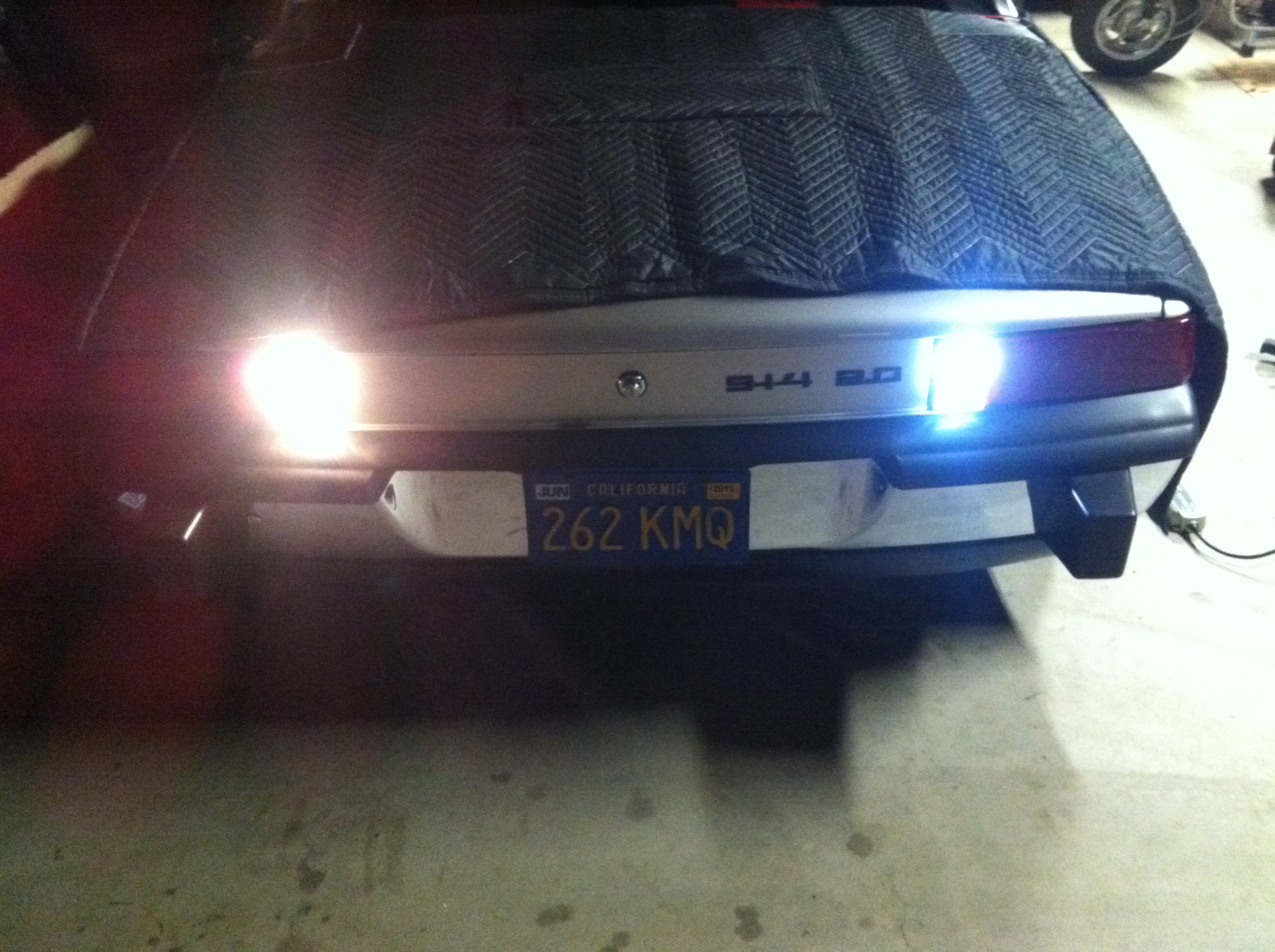

eric9144   (2) Reverse Light bulbs – 1156 Cool White 100 de...   Mar 13 2015, 03:05 PM

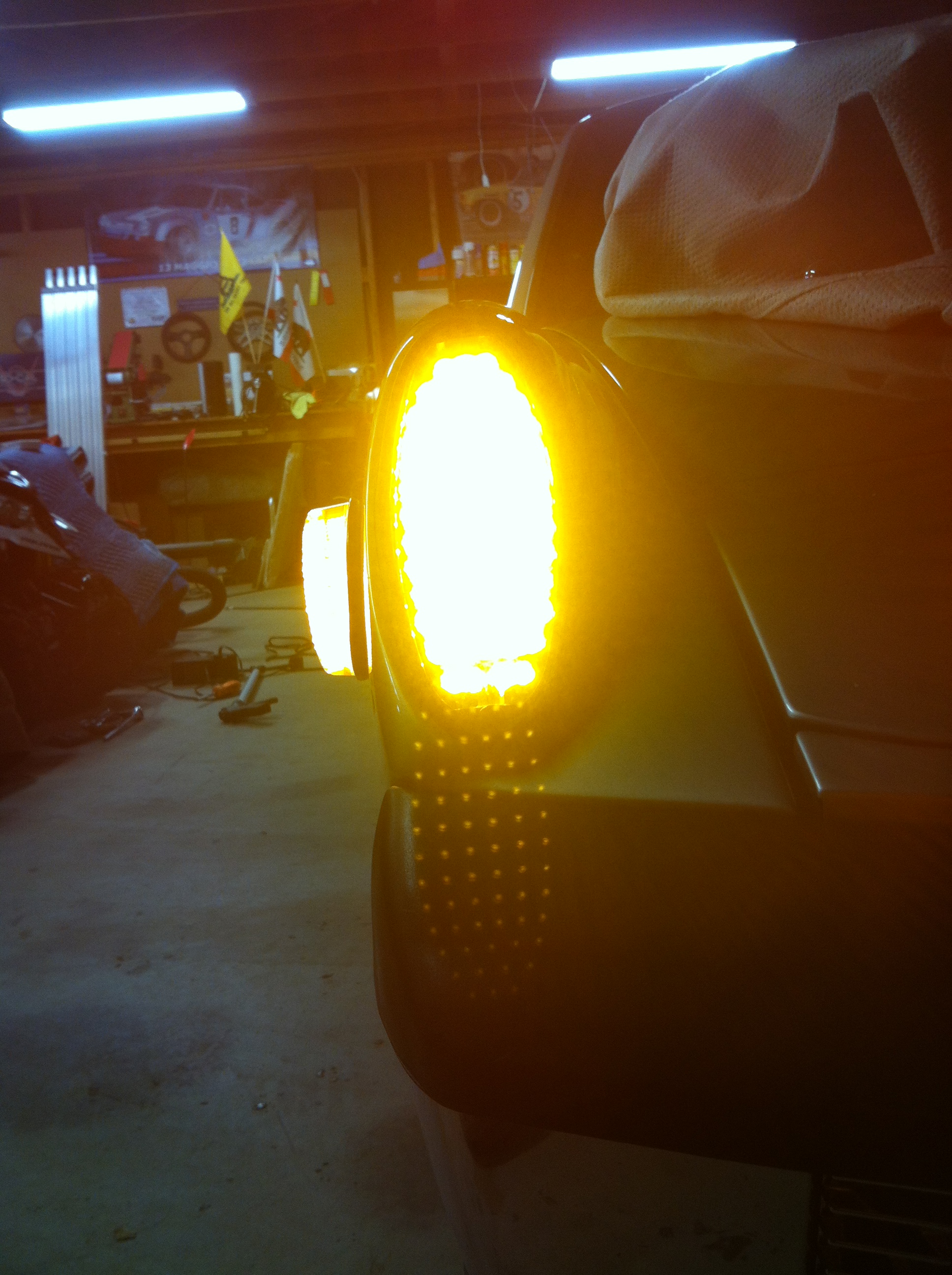

eric9144   Other photos for reference... Note brightness of ...   Mar 13 2015, 03:11 PM

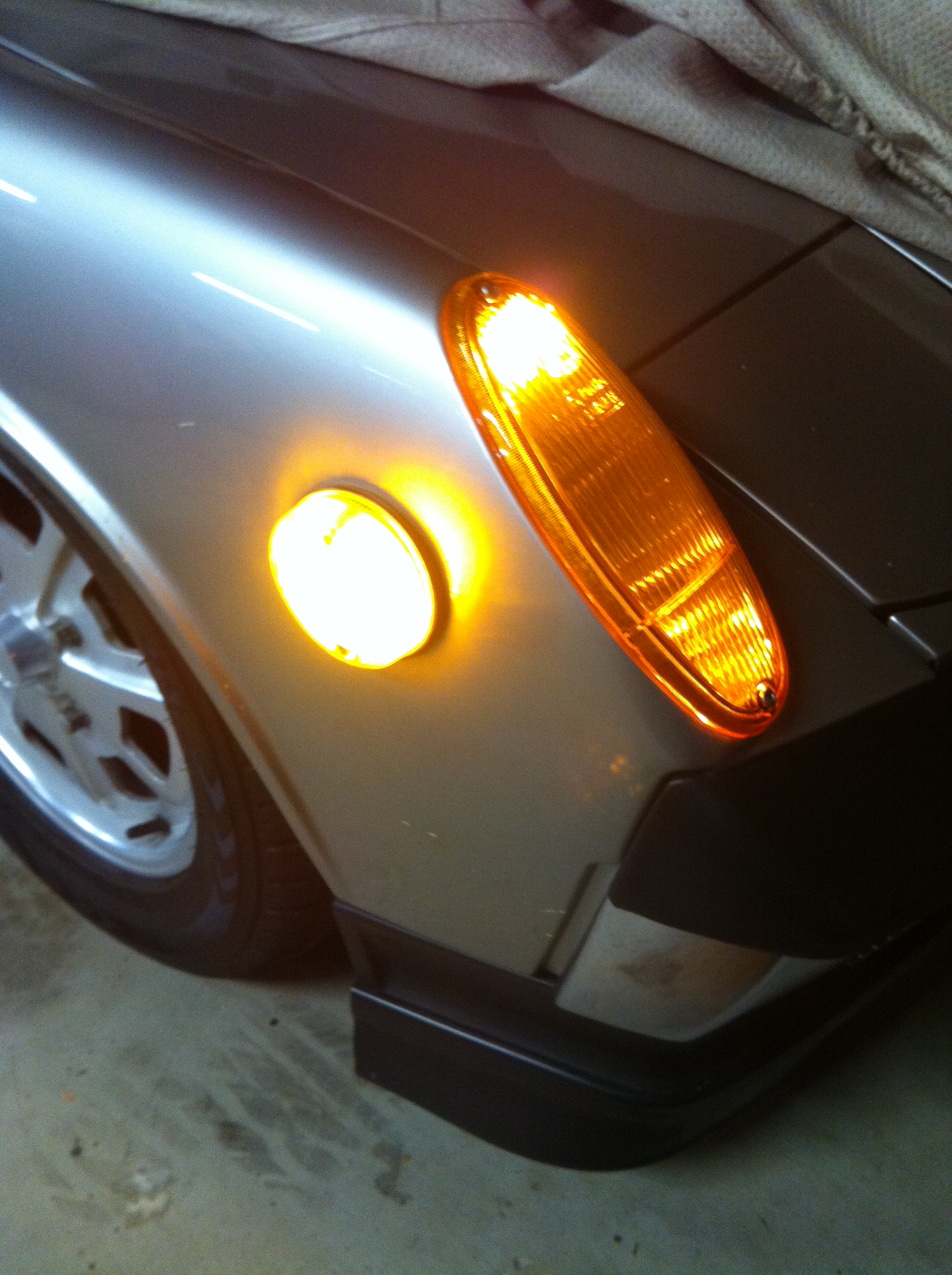

eric9144   Front complete with Spoke's LED boards:   Mar 13 2015, 03:13 PM

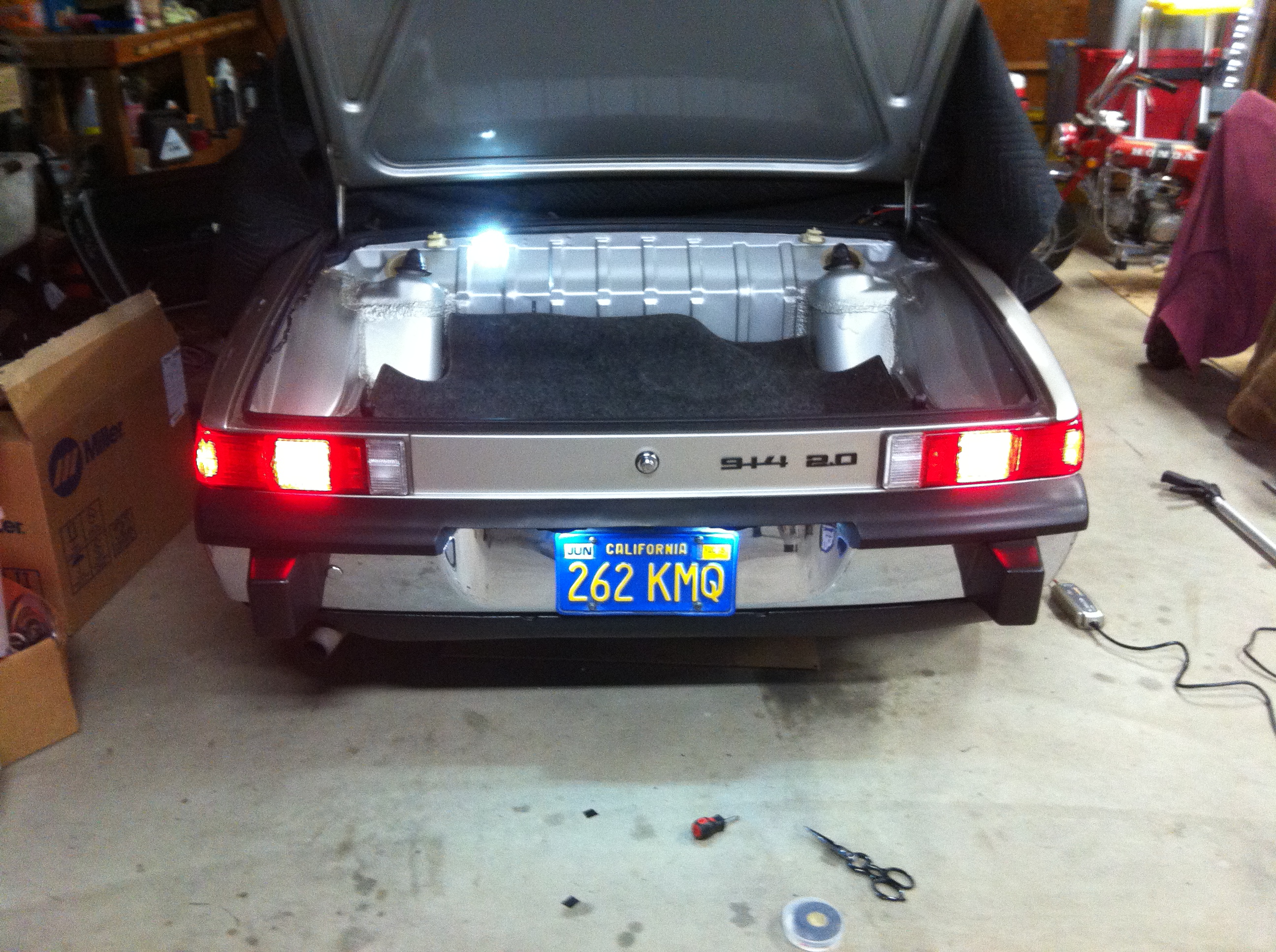

eric9144   Rear of car complete: :headbanger: The picture...   Mar 13 2015, 03:14 PM
