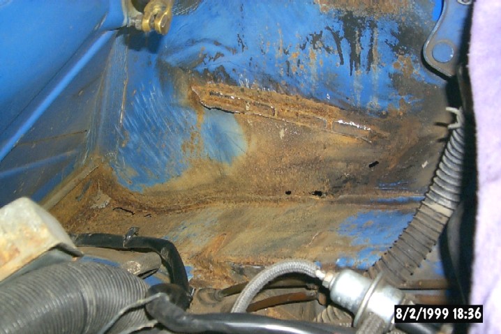

Fist Pic : The Rust
cdmcse   My Frame Repair Project   Feb 13 2005, 12:15 AM
cdmcse   Where the motor mount was.   Feb 13 2005, 12:15 AM

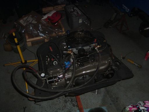

Bleyseng   Whats with the electrical cable coming out of the ...   Feb 13 2005, 09:41 AM
jd74914   looks good http://www.914worl...   Feb 13 2005, 10:10 AM
cdmcse   These cables in the heater tubes are for a front t...   Feb 13 2005, 11:25 AM

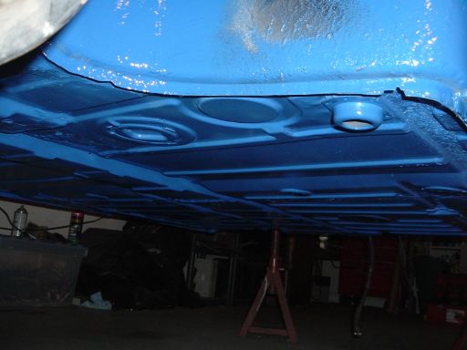

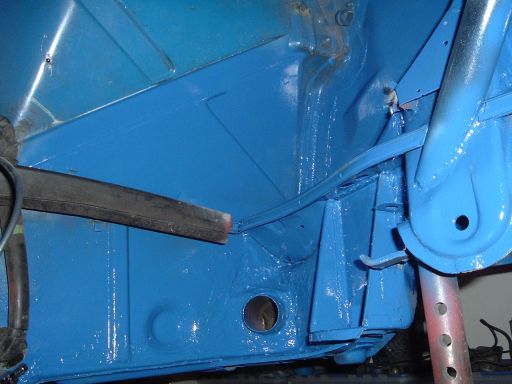

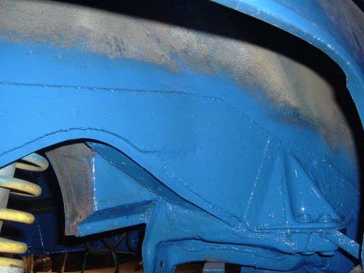

cdmcse   A little farther along... POR-15 Silver Applied   Apr 7 2005, 11:08 PM
cdmcse   Another...   Apr 7 2005, 11:10 PM
Root_Werks   Sweet! Another 914 saved from the rust monste...   Apr 8 2005, 08:44 AM
maf914   Way to go, Chris! Great looking work. Also...   Apr 8 2005, 11:17 AM

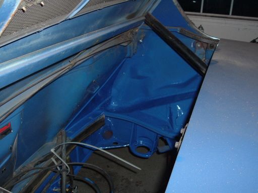

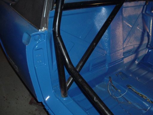

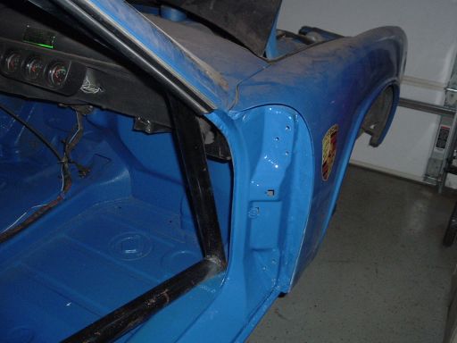

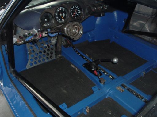

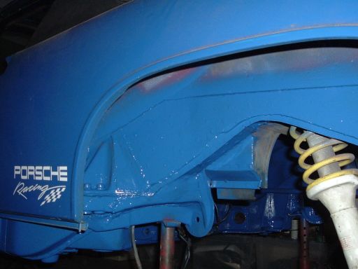

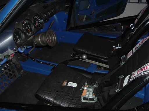

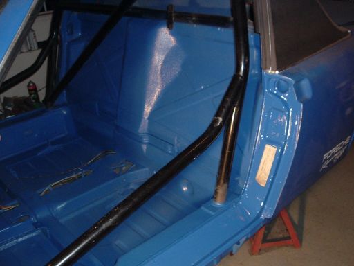

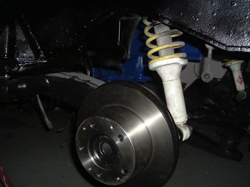

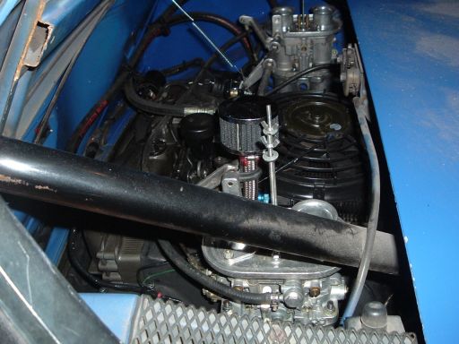

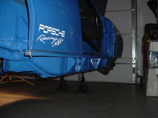

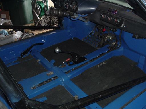

cdmcse   Well I reached what I feel like is a major milesto...   Apr 12 2005, 09:44 PM
cdmcse   Another...   Apr 12 2005, 09:45 PM
cdmcse   Another   Apr 12 2005, 09:46 PM
cdmcse   Last one. Now just a few more bits on the outside ...   Apr 12 2005, 09:47 PM
dakotaewing   How did you apply the Por-15 and primer? Gun or br...   Apr 12 2005, 09:52 PM
cdmcse   http://www.914world.com/b...   Apr 13 2005, 09:16 AM
Gint   That does look fantastic. Nice work.   Apr 13 2005, 10:08 AM

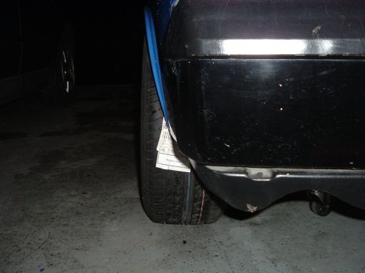

cdmcse     Apr 14 2005, 12:24 AM
cdmcse   ...   Apr 14 2005, 12:58 AM
