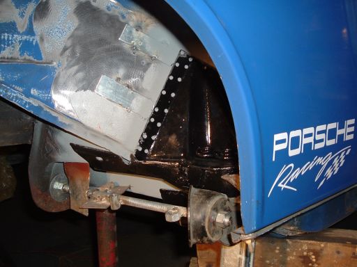

More Progress, it is too nice outside for my teener to be on jackstands. Fitting the Right outer suspension mount (Thanks Cloudbuster for the rust-free CA part).
