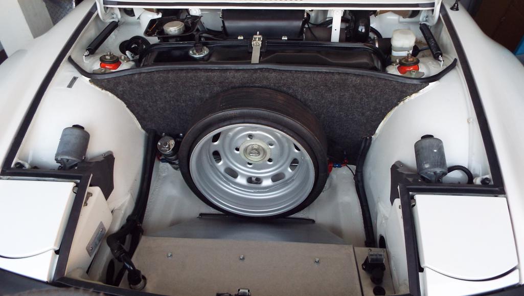

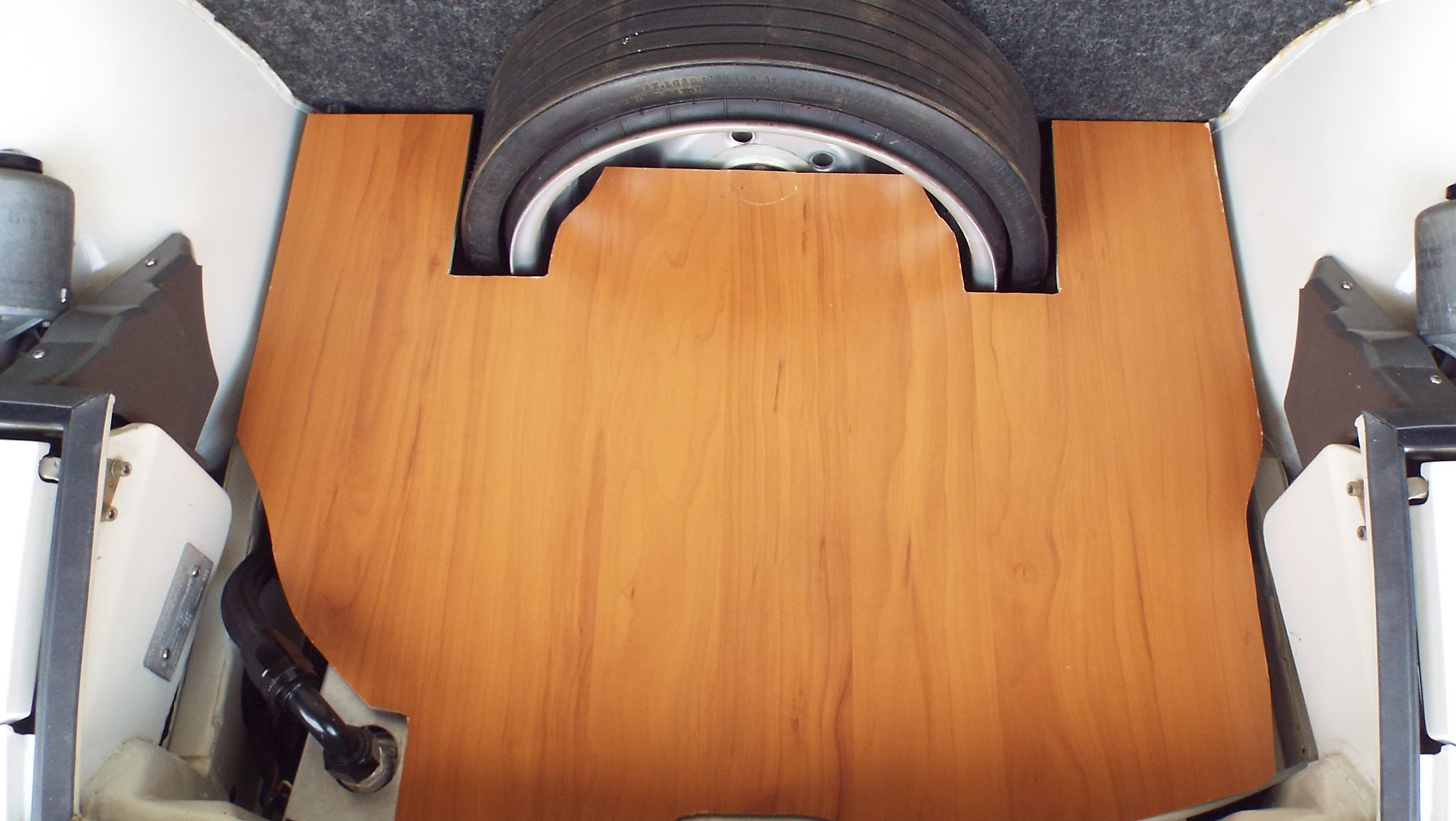

Frunk!

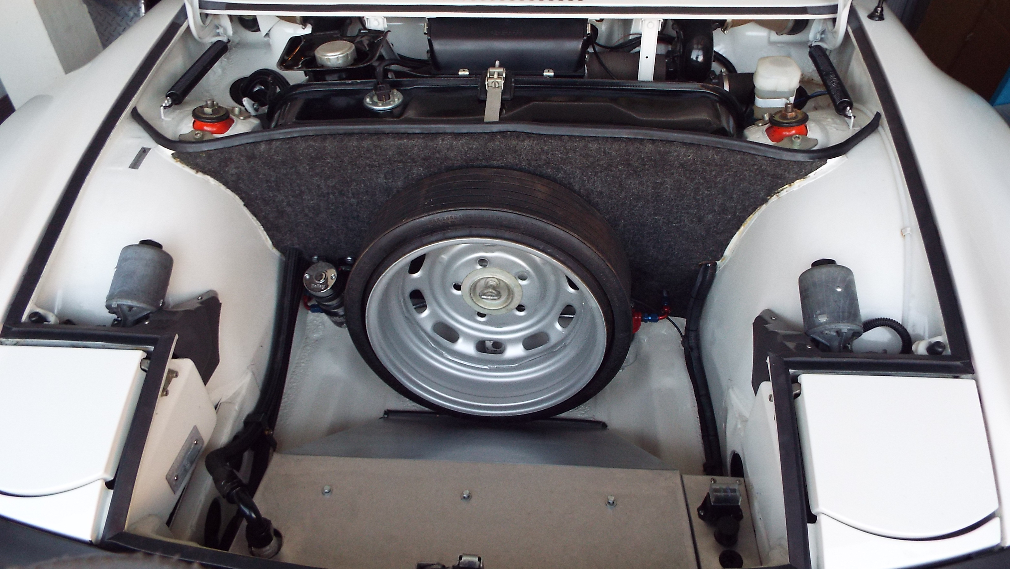

Well Defianty showed off his new frunk board (below) so that got me going on mine. Thanks! Something I had thought about several times but just hadn't got to yet.
So now is a good time! (IMG:style_emoticons/default/smile.gif)

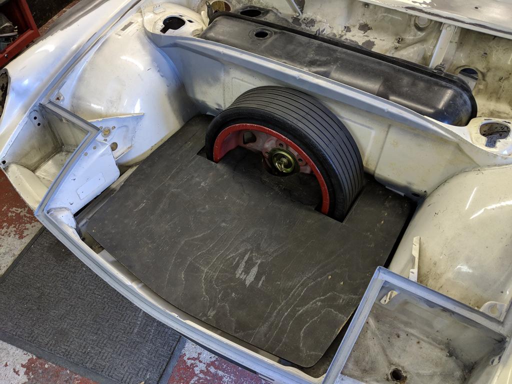

Here is Defianty’s inspiration board in his Frunk. (IMG:style_emoticons/default/beerchug.gif)

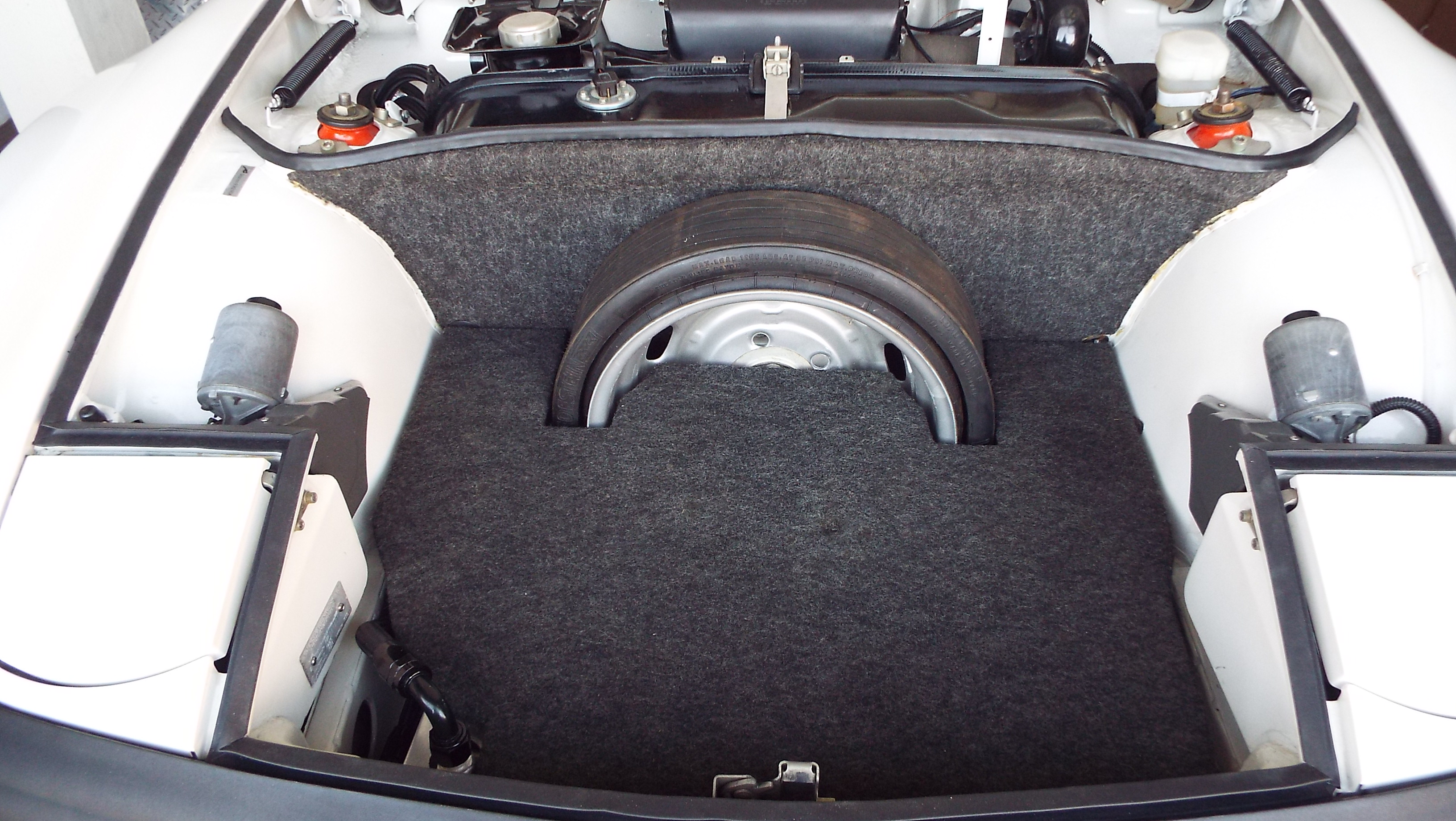

This is mine without:
I was actually able to somewhat re-use the one that came with the car which I learned on disassembly was actually a home built thing anyway. I started by using that board (well actually it was a 1/8” piece of flimsy melamine) as a template by removing the carpeting and modifying (IMG:style_emoticons/default/sawzall-smiley.gif) (sorry I forgot a before pic). Then when I had it to where it would fit with my oil cooler shroud (completed eons ago). I cut up piece of ¼” cabinet grade panel for the final product. (IMG:style_emoticons/default/sawzall-smiley.gif)
Began with a cutout for the spare tire bolt like Defianty has and then put it right back in as I realized the spare hold down bolt when turned sideways supplies additional support for the board inside the rim. Quarter inch is fairly sturdy so the jury is still out on whether to anchor it down as it seems to fit pretty well and I only see a car cover ever going there. (IMG:style_emoticons/default/laugh.gif)
3M 90 spray glue and staples and I am a happy camper!. On to the next thing! (IMG:style_emoticons/default/biggrin.gif)

Nicely done my friend.

Excellent Jim, looks nice and tidy now. I can't wait to get mine covered in Perlon to finish it off.

(IMG:style_emoticons/default/blink.gif) wow............that trunk (IMG:style_emoticons/default/wub.gif)

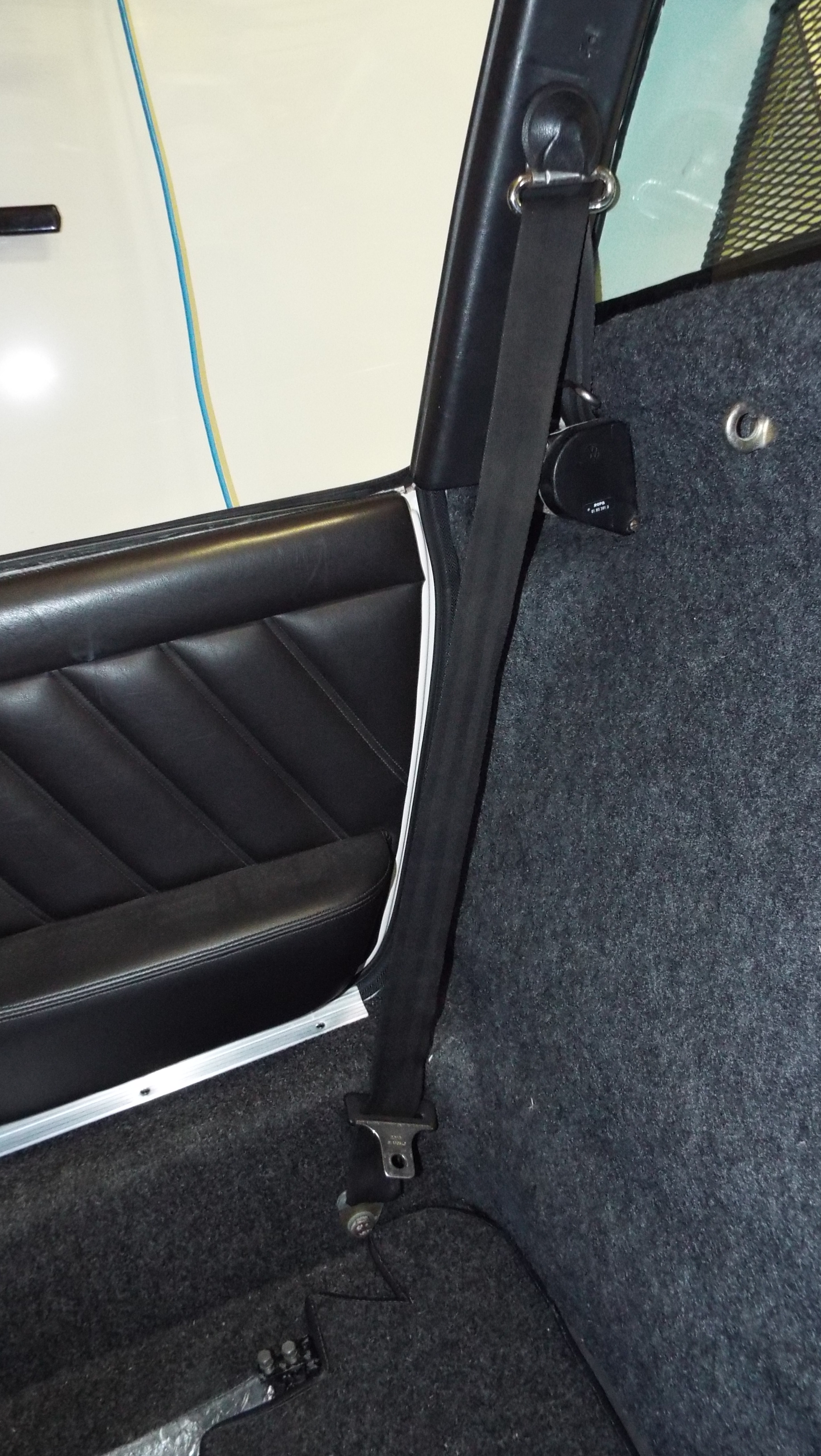

Seat Belts Finally! (IMG:style_emoticons/default/biggrin.gif)
Doesn't seem as though seat belts would be a very big deal but it kind of turned into one! When I bought this project, which I have mentioned a few times, it had been off the road over 20 years. It came with some very old and outdated shoulder harnesses. At first I thought I too would do shoulder harnesses, and someday that may still happen, but for now I just want to go with stock seat belts.
Seems simple enough. Right? (IMG:style_emoticons/default/idea.gif)
Actually I thought this issue was way behind me when I bought what I thought were 914 belts 2 years ago from a buddy of mine. I came to find out recently, when trying to install them, they were actually VW, so they were way too long and attachment points were facing wrong. Larmo63 helped me out with info by texting pictures of correct belts and answering questions. Thanks (IMG:style_emoticons/default/beerchug.gif)
In the mean time I posted a WTB (IMG:style_emoticons/default/type.gif) here for the chrome guides that go behind the recoilers. Got those from puebloswatcop thanks you very much for the great deal! (IMG:style_emoticons/default/beerchug.gif) Then I realized the chrome guides could not be installed unless the belt was completely disassembled DUH. Now I am thinking I have to buy "914" seat belts and post another WTB (IMG:style_emoticons/default/type.gif) and got some leads.
Now here is the funny part if you are still reading. (IMG:style_emoticons/default/smile.gif) It dawned on me just last night that I could cut off the end that attaches down on the long and shorten the belt that way and while apart install the correct chrome guides. Both problems solved! I somehow had it stuck in my brain they could only be shortened from the recoil end and that did not look promising. Today I took them to my local upholsterer and we shortened the belts 2 and a half feet and installed the guides.
Ta Daaa! VW seat belts converted to 914 for a very modest price. And the recoilers work great! The interior is coming together.

You can pry the chrome guide apart at the end where it is joined and slip the belt through the small opening. Then, it all bolts behind the reel and doesn't show.
That's what I've done before to make a 911 belt work in a 914.
Moot point. (IMG:style_emoticons/default/KMA.gif)

QUOTE(Larmo63 @ Nov 24 2017, 09:55 PM) *
I believe you but mine looked to be tacked together pretty well up further and even at the joined end of the guide. Have to admit I did not try to pry it apart. Oh well they HAD to be shortened anyway. (IMG:style_emoticons/default/biggrin.gif) Thanks again!

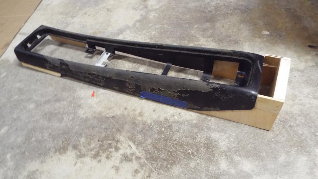

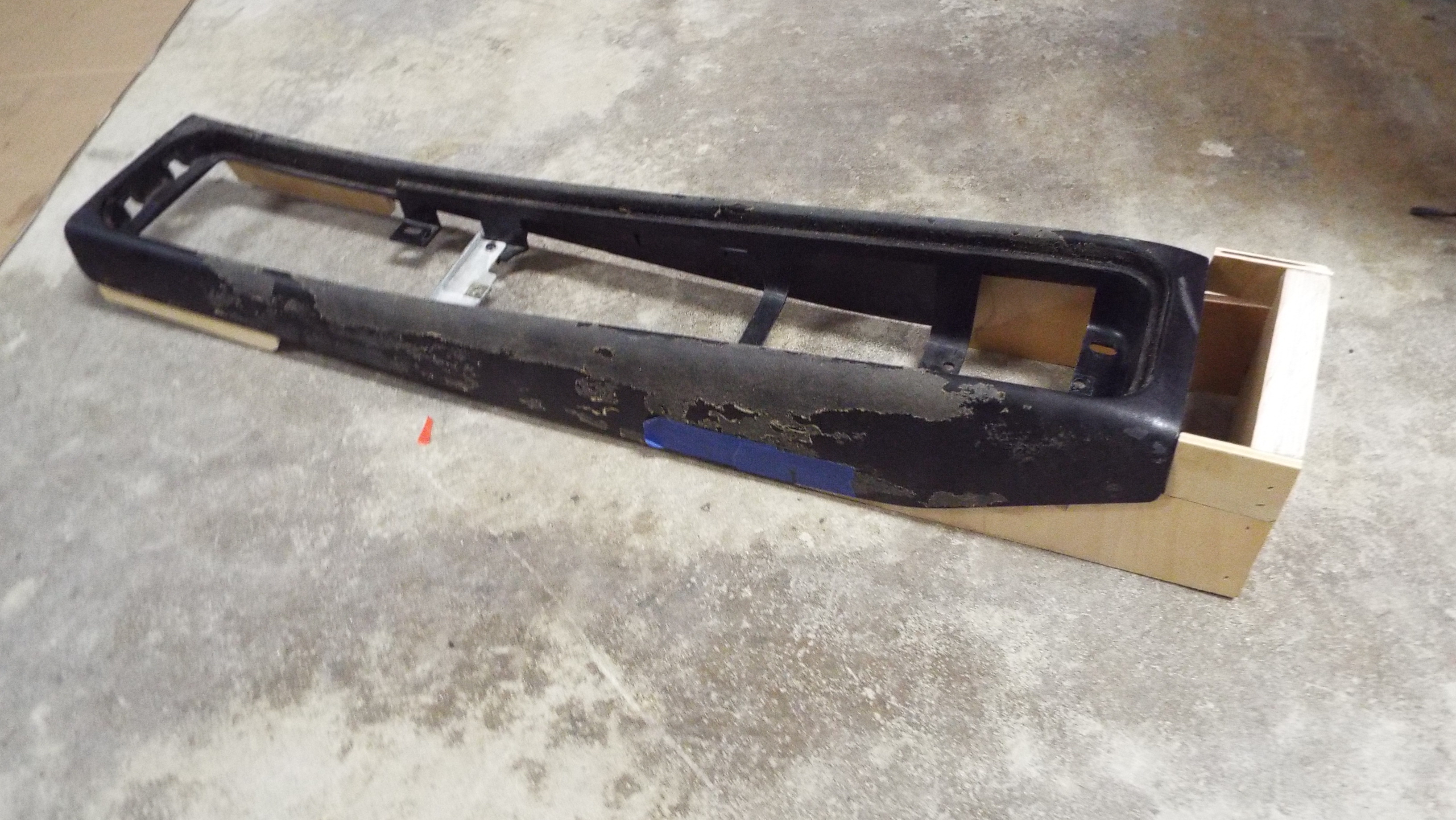

Ah Yes The Console

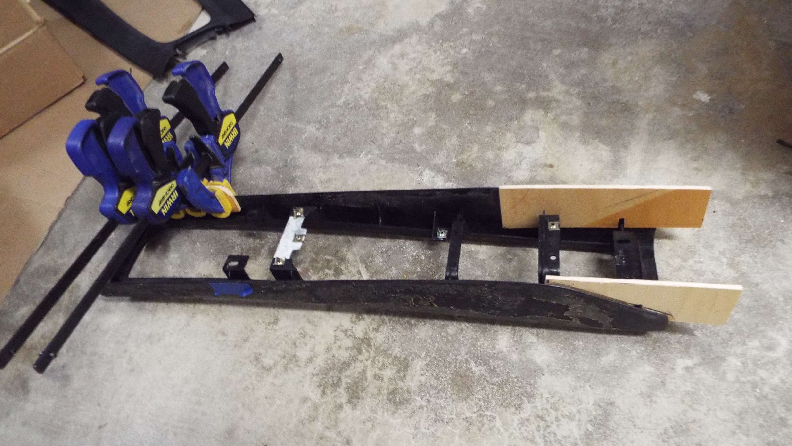

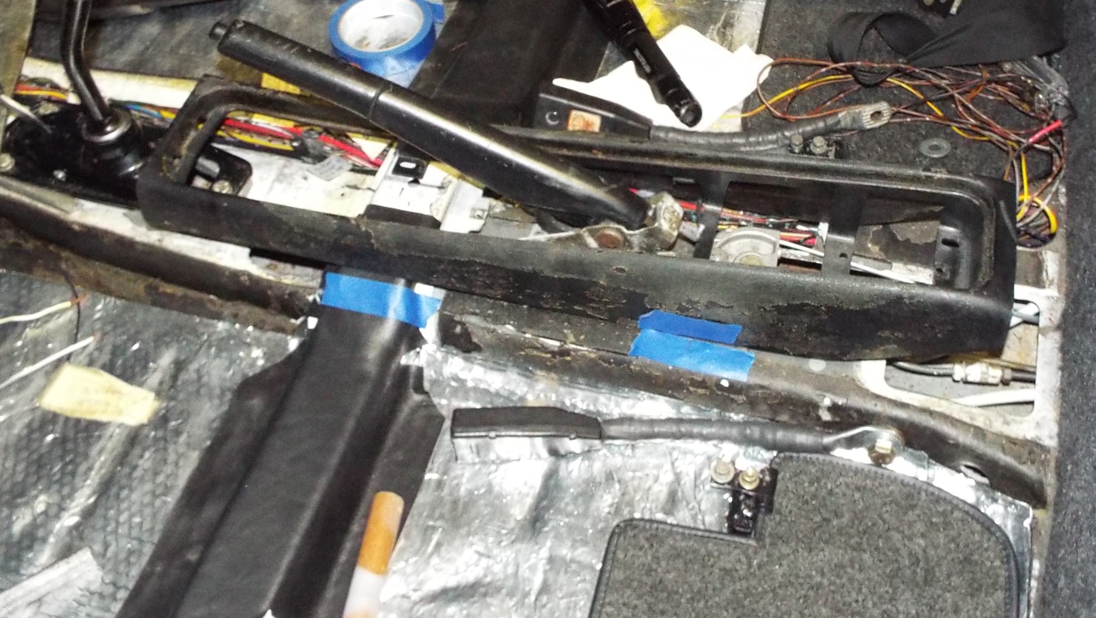

The next thing I’m tackling is the console to house my center pull hand brake. Going to start with this console the PO furnished with the car and see if I can make it work.
It actually is a Porsche PN that starts with 964 so at the least it is a Porsche part! (IMG:style_emoticons/default/biggrin.gif)
This project has been rattling around in my head (IMG:style_emoticons/default/idea.gif) for quite a while and it is now time. I’m a wood worker so here goes…… (IMG:style_emoticons/default/sawzall-smiley.gif) More to come.
(IMG:style_emoticons/default/white914.jpg)
Lucky9146
post Nov 26 2017, 08:06 PM
Post #371
Posts: 1,711
Joined: 22-September 14
From: Poway California
Member No.: 17,942

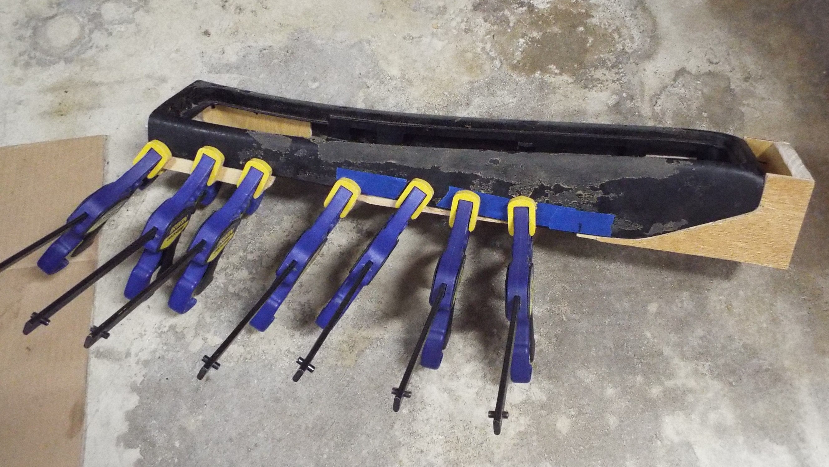

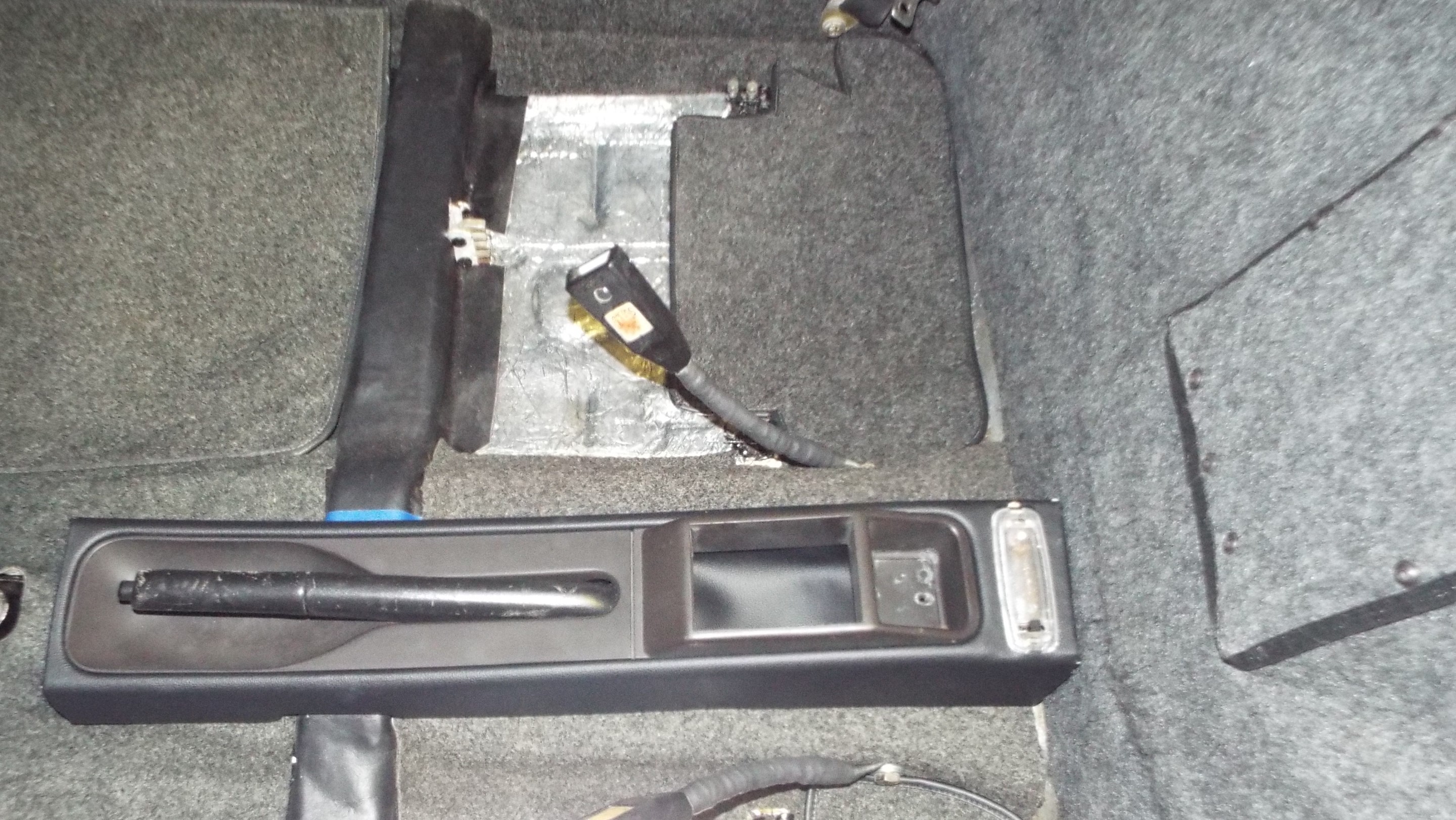

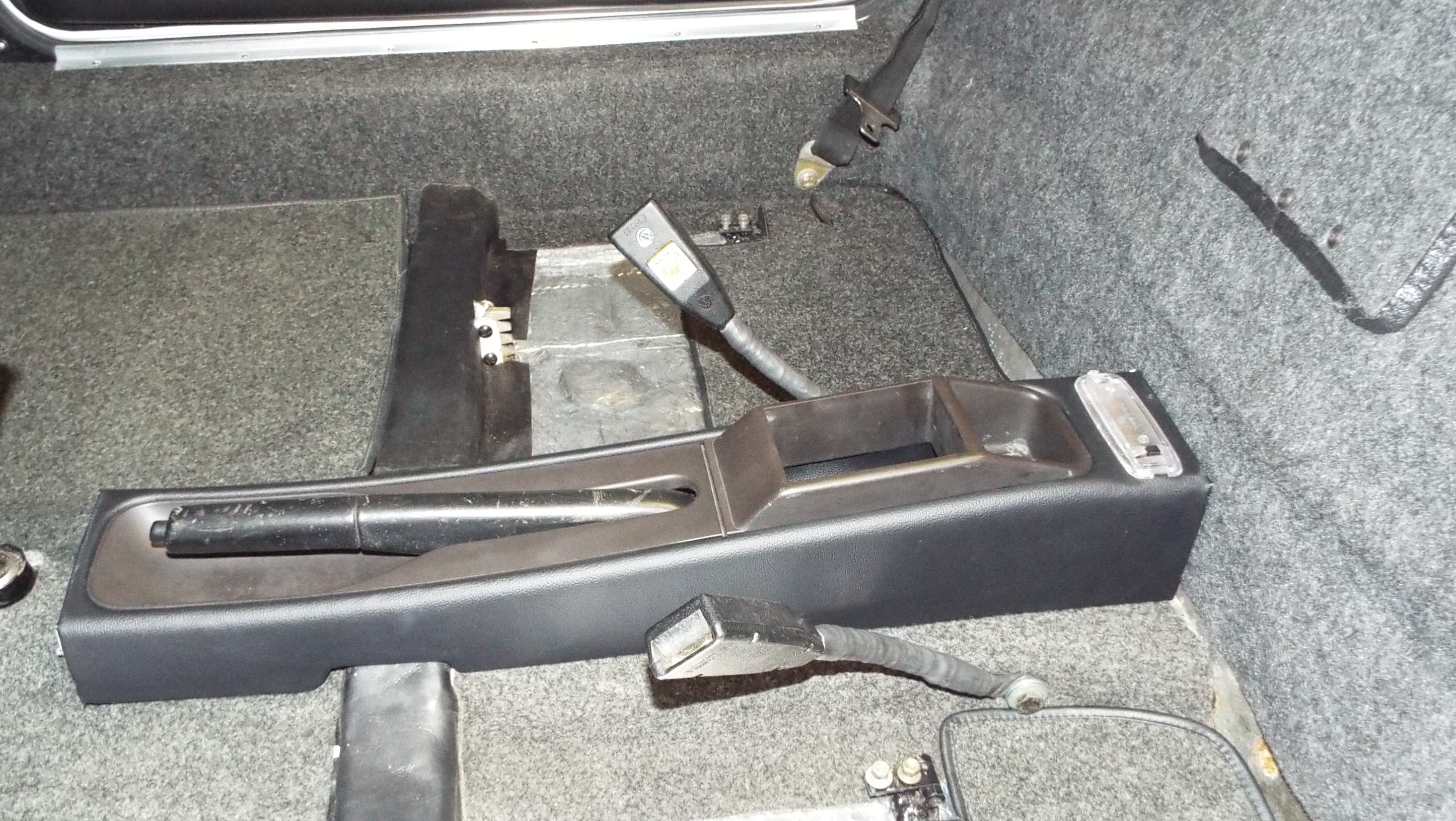

Console Complete!
Went way better than I hoped it would. (IMG:style_emoticons/default/piratenanner.gif)

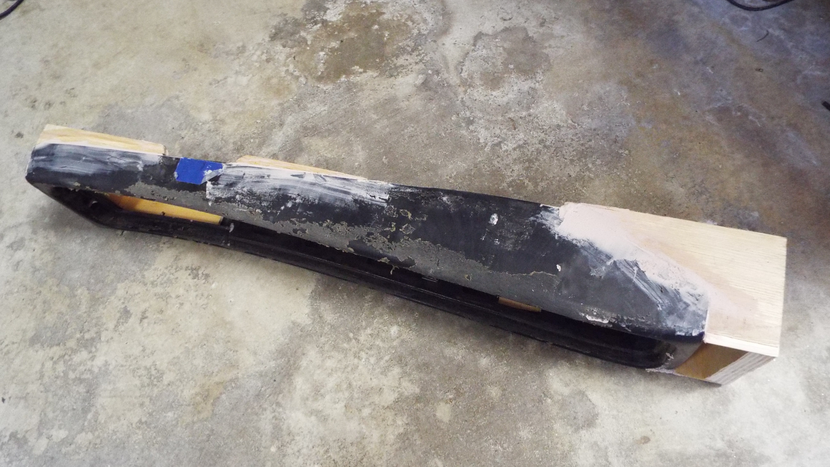

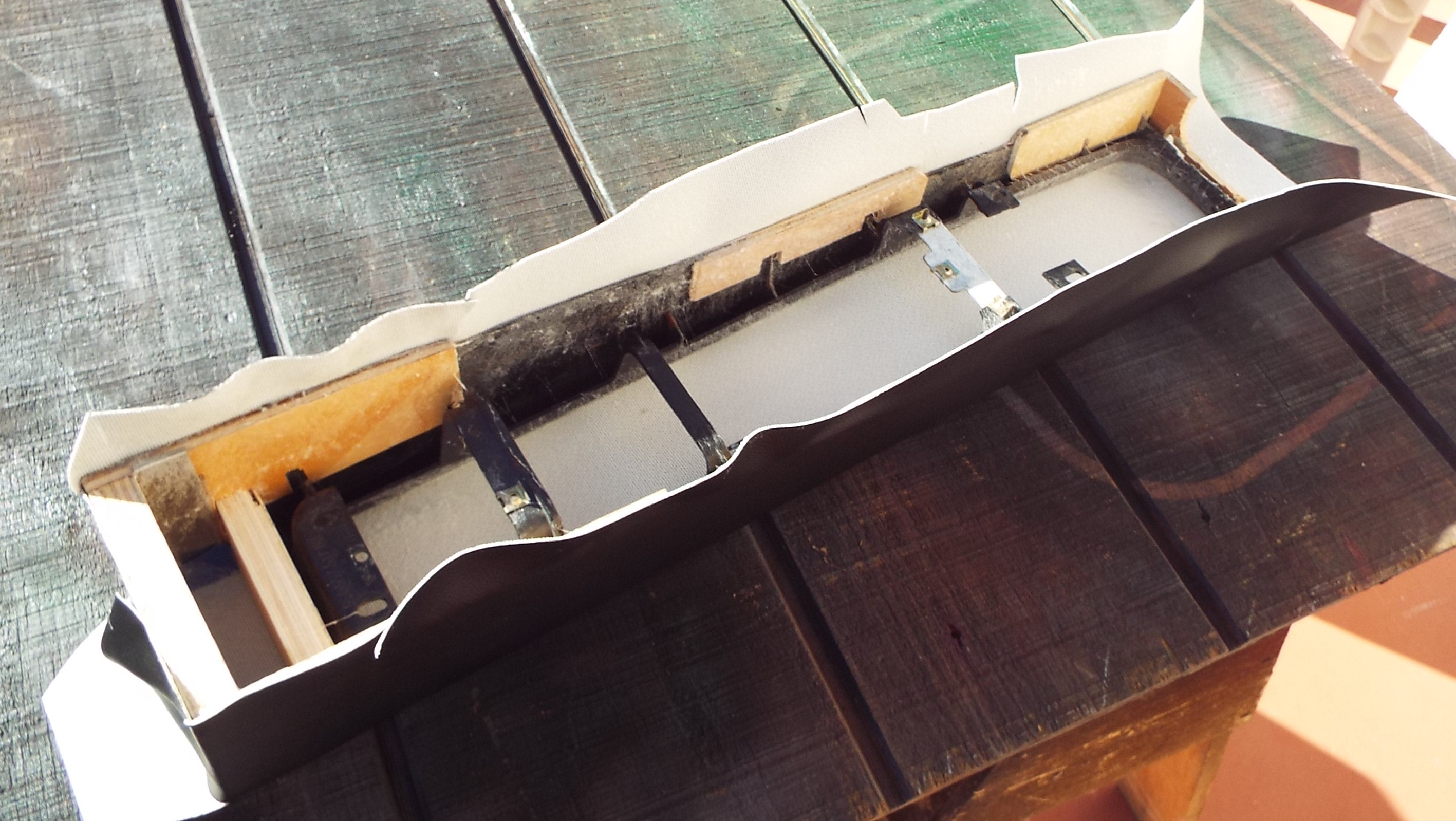

Lots of clamping to achieve the thickness needed to match the outsides after gluing structural pieces inside.

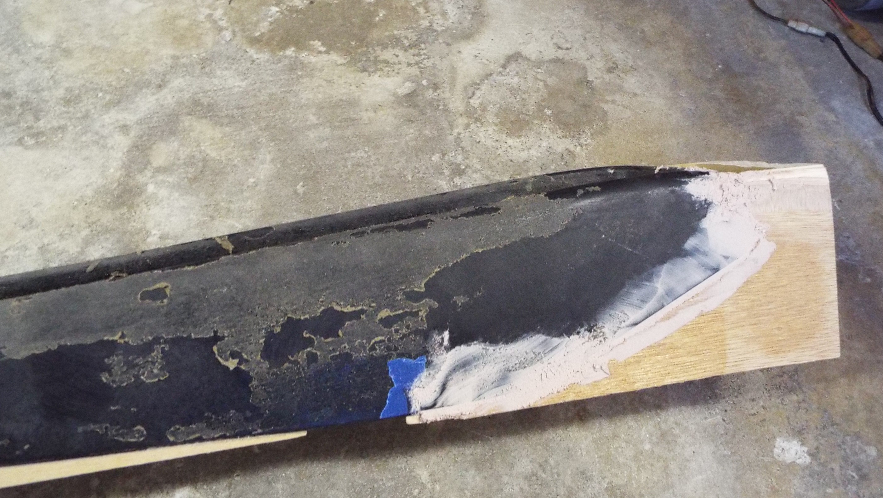

The bondo stage, one of several applications.

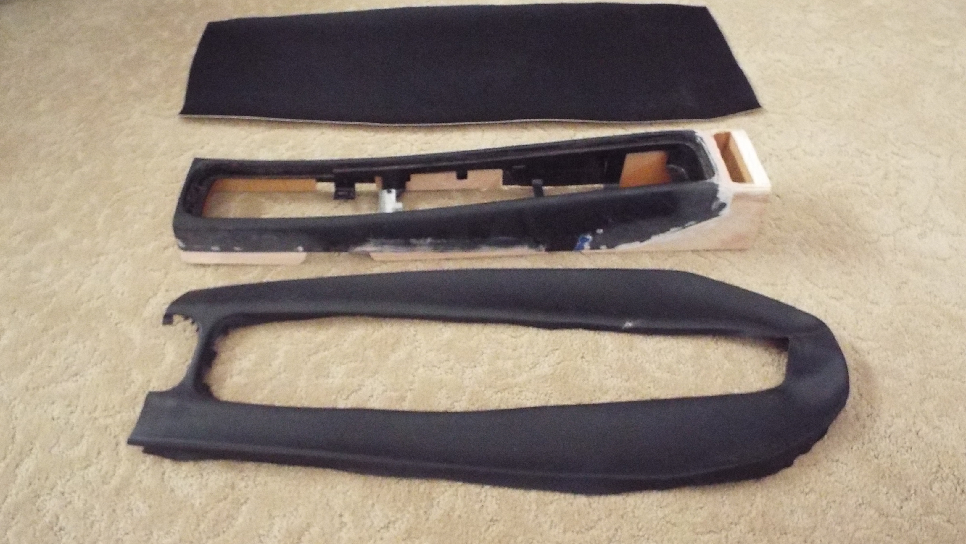

Lucky9146
post Nov 26 2017, 08:13 PM
Post #372
Posts: 1,711
Member No.: 17,942
That new piece of vinyl is somehow going to replace the original vinyl shown in the fore ground, pretty cool that grain matches on the new.
Gluing was the most stressful part but it went off without a hitch, just slow.
Totally happy with the end product and now a place for the interior light!

The guy I got the vinyl from said this was thick vinyl and would be difficult to work with but a hot sunny day here sure helped. Would have liked to have made the front rounder but that would be my only improvement. As it is it still took several days to complete.
On to the next thing! (IMG:style_emoticons/default/bye1.gif)

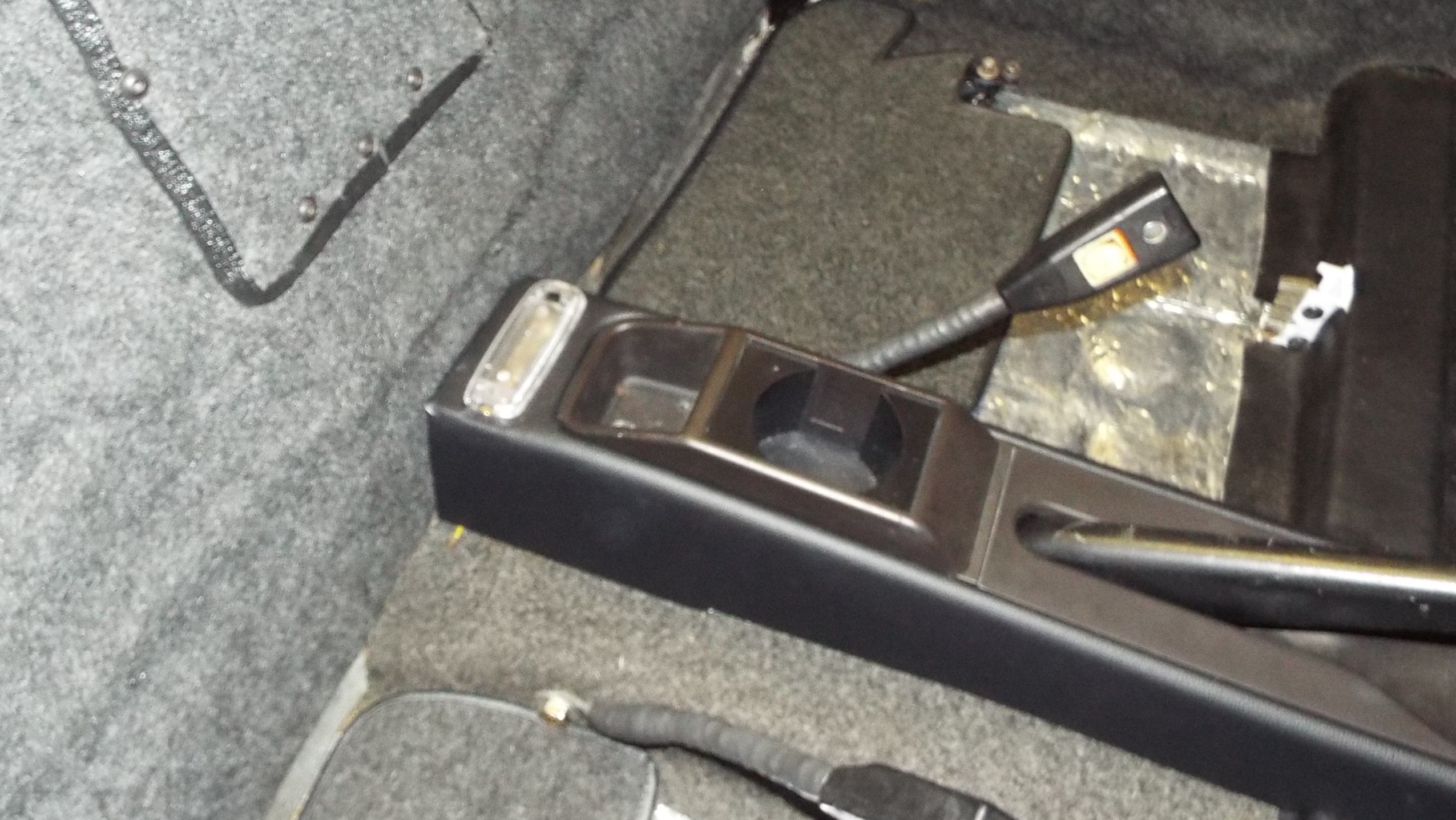

Awesome work! I see you even left a space for a cup holder. Re-purposing that interior light was a nice touch also.

Lucky9146
post Nov 28 2017, 12:46 AM
Post #379
Posts: 1,711
Member No.: 17,942
QUOTE(moparrob @ Nov 26 2017, 07:32 PM) *

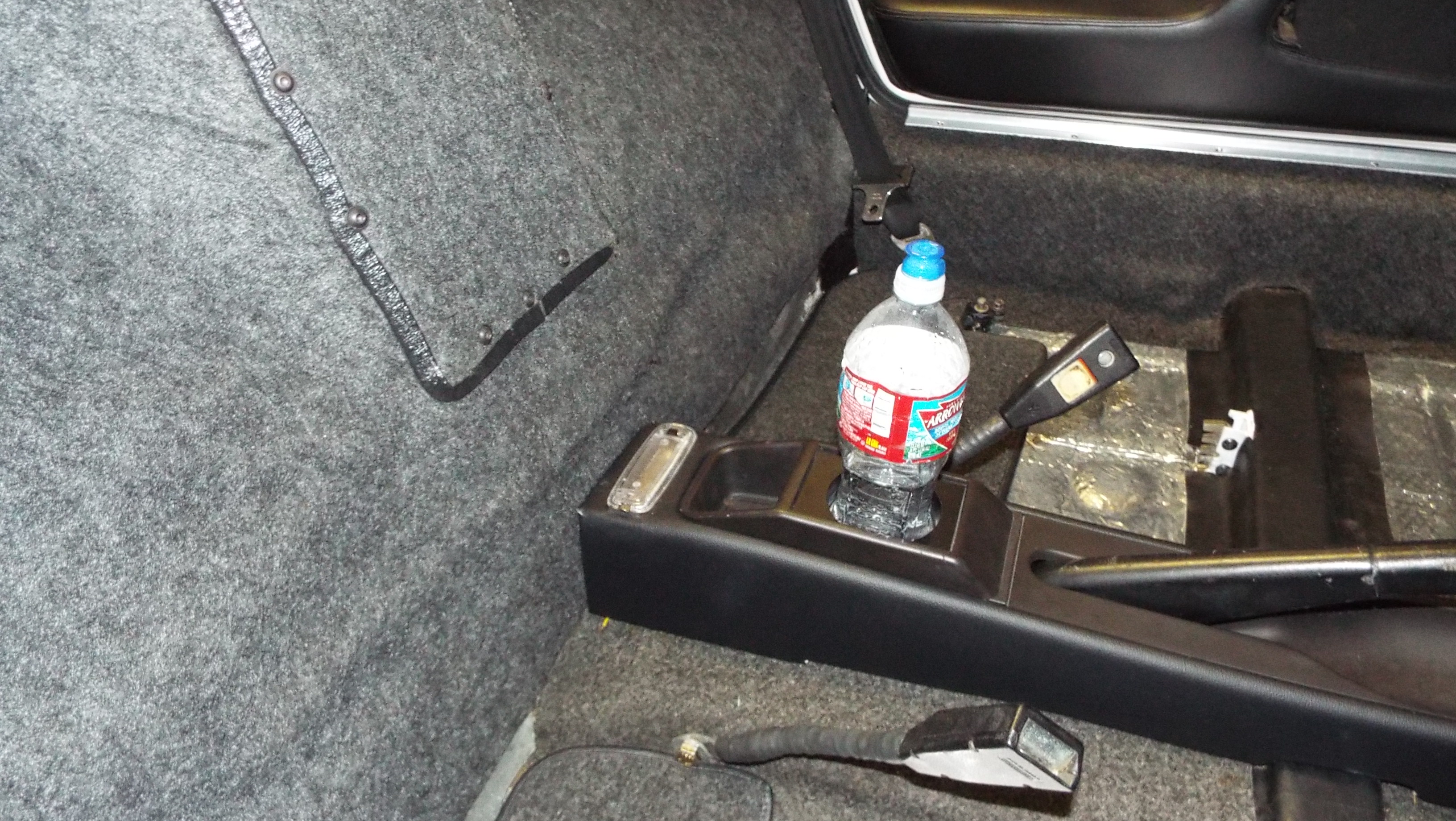

Porschetub, Whitetwinturbo, Edward Blume, and Defianty Thanks guys! (IMG:style_emoticons/default/beerchug.gif)

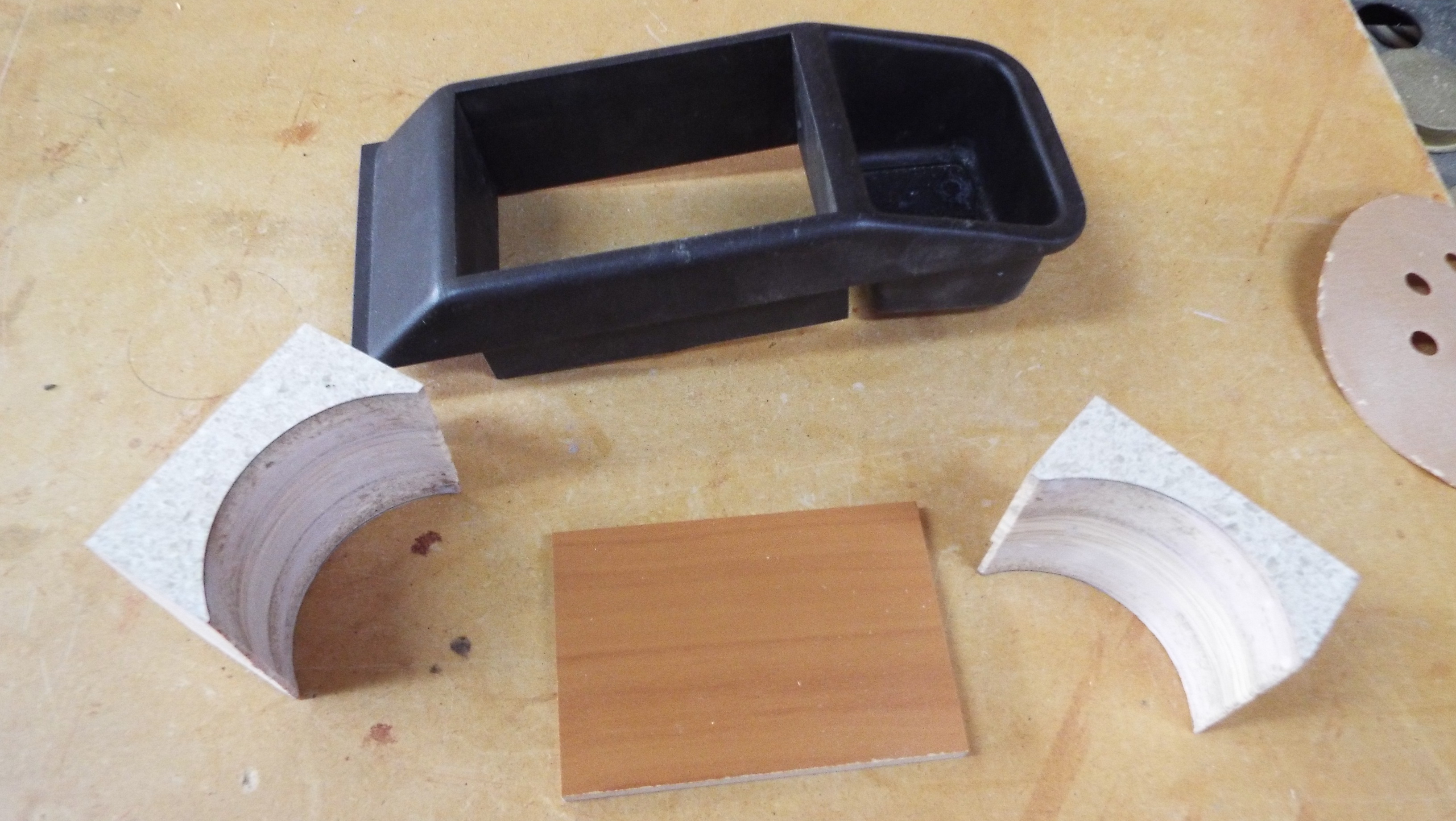

Thanks Rob and yes the cup holder was in work already but I was so happy with the way the vinyl came out I couldn’t wait to finish it to post pictures so here it is the cup holder! (IMG:style_emoticons/default/biggrin.gif)
Every 914 should have one (IMG:style_emoticons/default/beer3.gif)

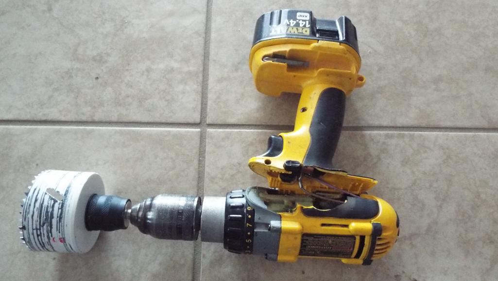

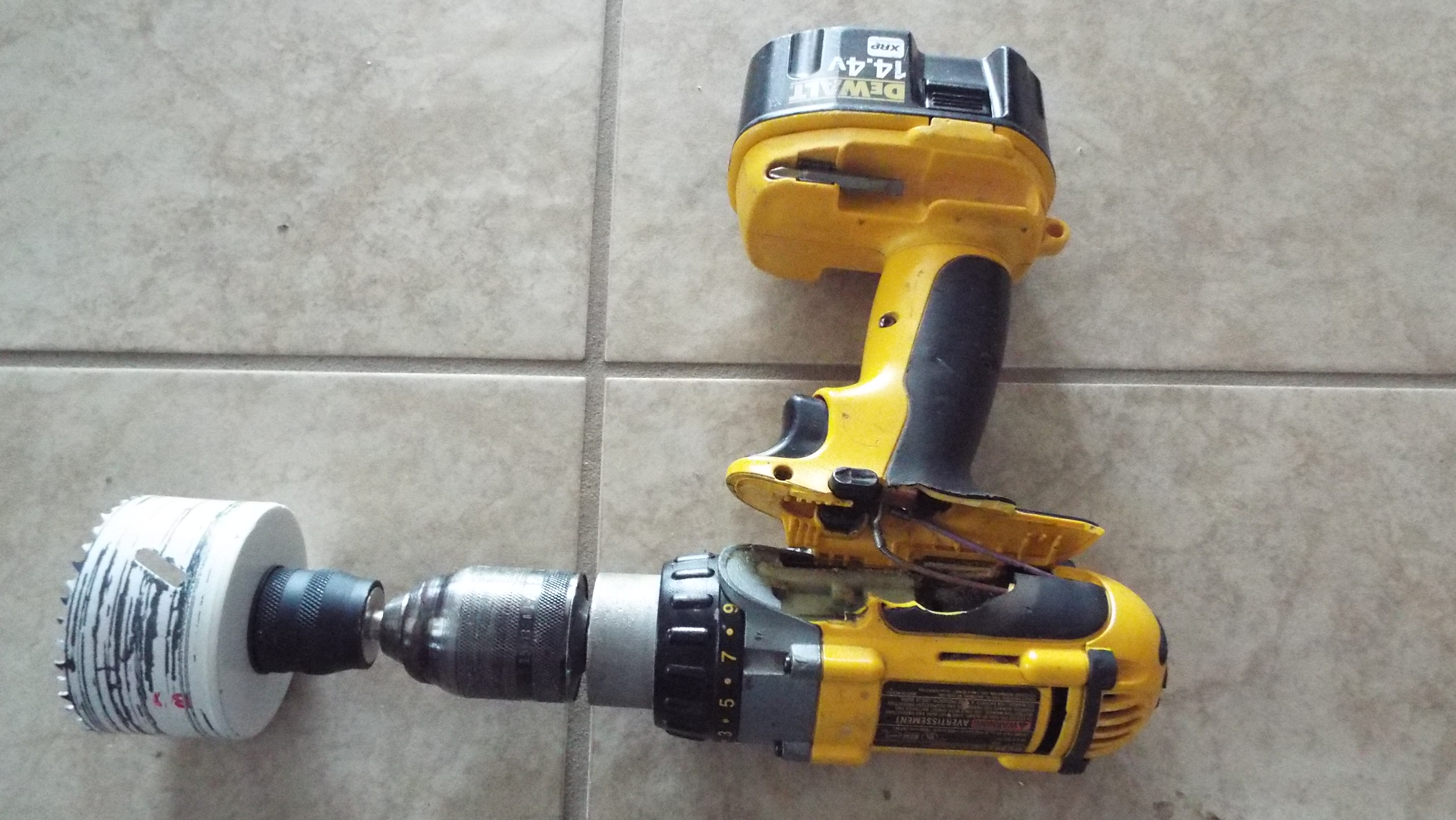

One last thing on the console and that is there was a casualty with the project.
One of my Dewalt's bit the dust. I first tried some maple and should have used my drill press, the hand drill didn't like it. (IMG:style_emoticons/default/headbang.gif) I may have, shall we say, "dropped" this drill before. (IMG:style_emoticons/default/lol-2.gif)
Christmas is around the corner (IMG:style_emoticons/default/santa_smiley.gif) (IMG:style_emoticons/default/biggrin.gif)
