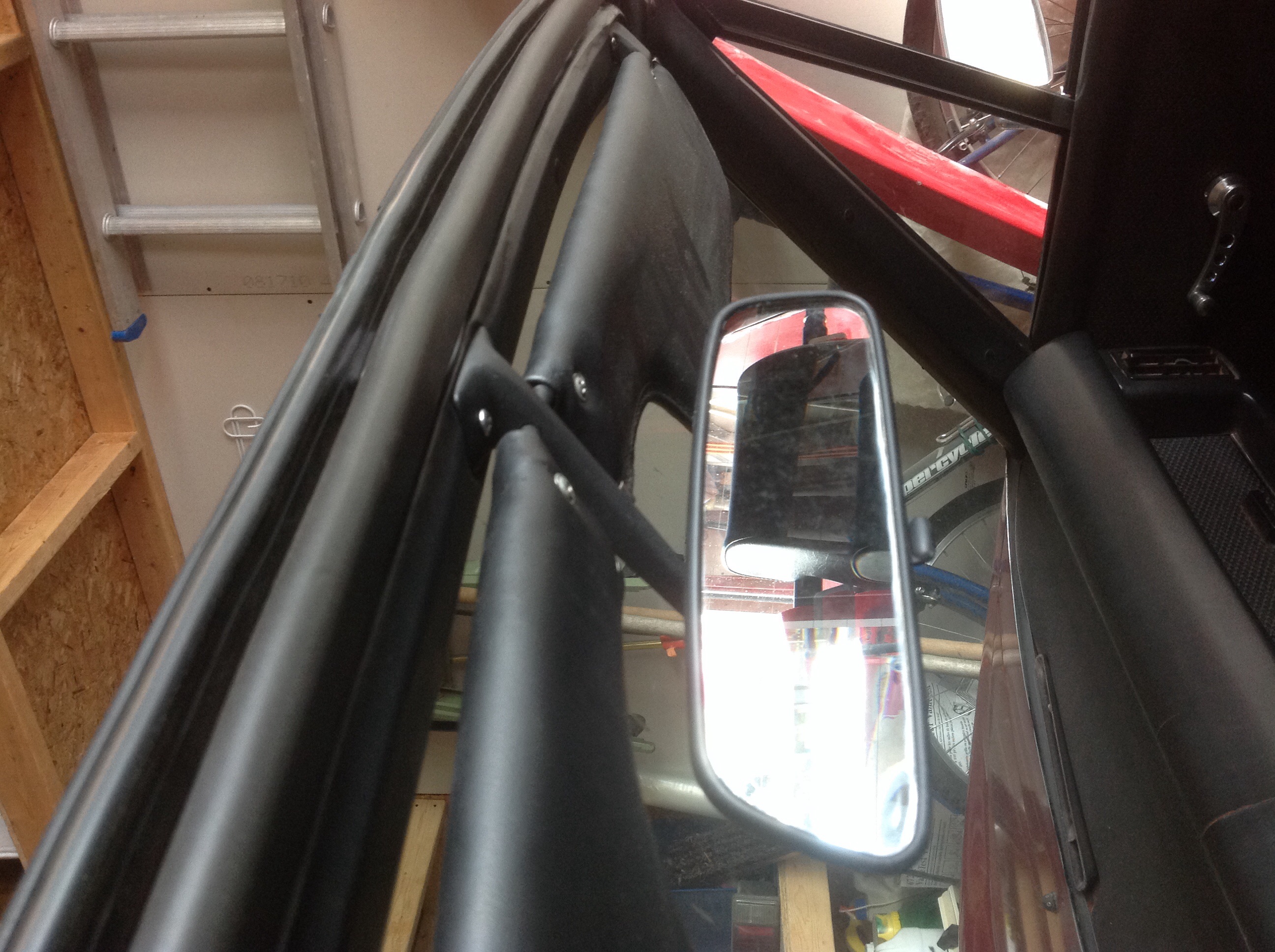

Going to revive this thread as I am looking for this BMW mirror. My current mirror keeps falling off the new adhesive pad as if its too heavy or something weird- its an aftermarket mirror so makes sense I guess.
Every BMW E30 mirror I see does not have any holes in it like the pictured one in this thread and I cant seem to find anyone in various threads actually specify the part number of the mirror, have seen E30 mirrors mentioned and E28 mirrors mentioned but want to confirm. Thanks
