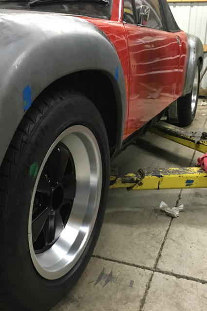

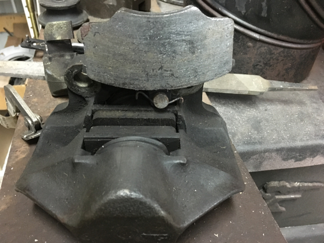

January Update: Michigan Build
Michigan Build Link
Build progress :
Back at it over the last few weeks, installed 5 Lug package from PMB Performance. Pressed in new bearings, and seals. Turbo tie rod ends, rack spacers, and shorter firmer springs and shocks.
Unexpected challenges:
Had to trim the calipers a bit to fit the rotors.
Vendors:
I purchased from PMB Performance, again.
Progress Pictures:
Attached ImageAttached Image

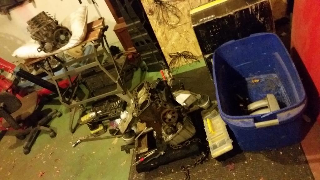

January progress report, Dr. Phil's back to black flipped, goes metallica-copper that is:
Challenge- time, money, etc, body guy moved out of state, my garages is filed.with boxes-
See my thread- house sale, moving,., sold one tub with some parts,
Good news is that gives me the money to actually pay for some work on the car- copper one, so I'm switching tubs. This one needs more work, way more but it's the one I wanted to keep and I couldn't do both!-
I have my jack points and long parts, rear floor pan, etc from restoration design. And a new dash from PMB!!! I actually installed the dash a few weeks ago!
Parts bought: powder coated parts from Bruce Stone!!
Need new paint and body guy!, asked Scott but he says no openings,

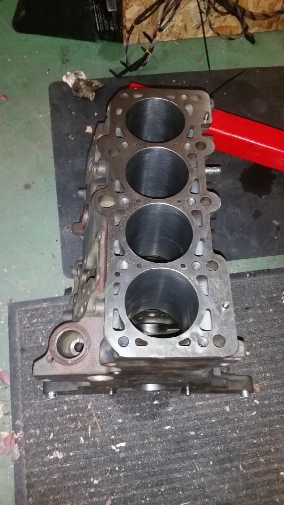

January Update: http://www.914world.com/bbs2/index.php?s=&...t&p=2284502
(IMG:http://www.914world.com/bbs2/uploads/post-172-1451756629_thumb.jpg)
Finalized the trans mounts
(IMG:http://www.914world.com/bbs2/uploads/post-172-1452003862_thumb.jpg)
Tore the engine down to its bits, sent it to the machine shop.
(IMG:http://www.914world.com/bbs2/uploads/post-172-1452935818_thumb.jpg)
Got it back the next week. Cleaned, Honed, decked, Balanced, and rods installed.
(IMG:http://www.914world.com/bbs2/uploads/post-172-1454305350_thumb.jpg)
Tore the head down after the machine shop cleaned and decked it. Cleaned up the valves. Removed all the casting marks on the intake and exhaust ports. Installed nitrite coated stainless exhaust valves, lapped the valves, installed new guide seals, installed heavy duty valve springs (9k rpm limit now). Rebuilt the lifters, installed the cams, new cam chain, seals, and torqued everthing to spec. Head is now ready to install.
Plastiguaged the new coated bearings to ensure proper spec and installed the oil pump drive with new seals.

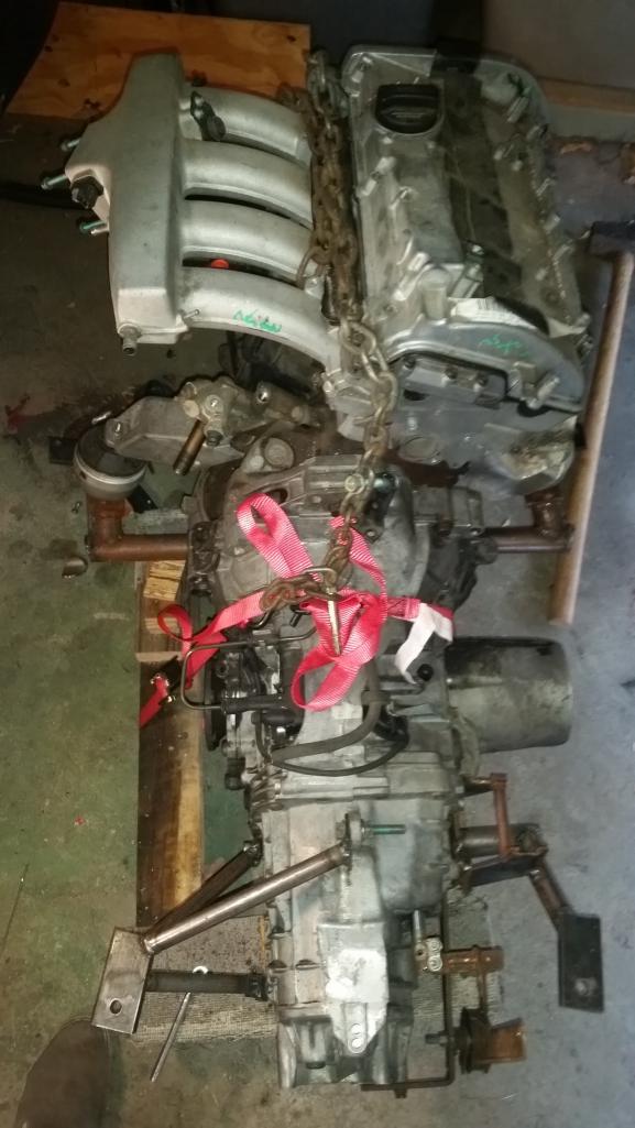

January Progress still in rear boot hell (IMG:style_emoticons/default/headbang.gif) I might be slacking on the 914 but slacking on the work being done in the shop.
Fixed:
Ford Escort - redid a few items, car deemed not worth the investment.
Chevy Cobalt - redid a bunch of items
VW EOS - pulled the nose off the car to change a windshield wiper pump (IMG:style_emoticons/default/wacko.gif)
VW Jetta - Pulled the bumper off to get the low beam head light bulbs in properly (IMG:style_emoticons/default/screwy.gif)
In process:
VW Rabbit - being rebuilt now
Chevy Truck - tranny blew, will be rebuilding that one soon.
914:
Rear Bumper all mocked up, need to (IMG:style_emoticons/default/welder.gif)
Rear Trunk - All mocked up, need to (IMG:style_emoticons/default/welder.gif)
Couch slave cylinder all mocked up, need to finish the (IMG:style_emoticons/default/welder.gif)
Wow see a trend here
Rear Tail lights, got a bunch of euro lenses, my NOS units from Germany, have cracks. (IMG:style_emoticons/default/headbang.gif) Company blames shippers, shippers blame company, box only damaged on one corner.
Spoke, sent me my LED tail light boards, just got them today (IMG:style_emoticons/default/beerchug.gif) (IMG:style_emoticons/default/piratenanner.gif)
Time to move on to something new, Rear Wheel wells, or engine compartment (IMG:style_emoticons/default/idea.gif)
I do keep copious notes in my build tread.
