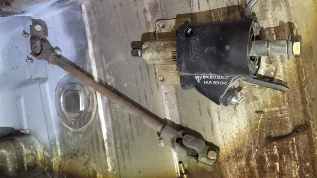

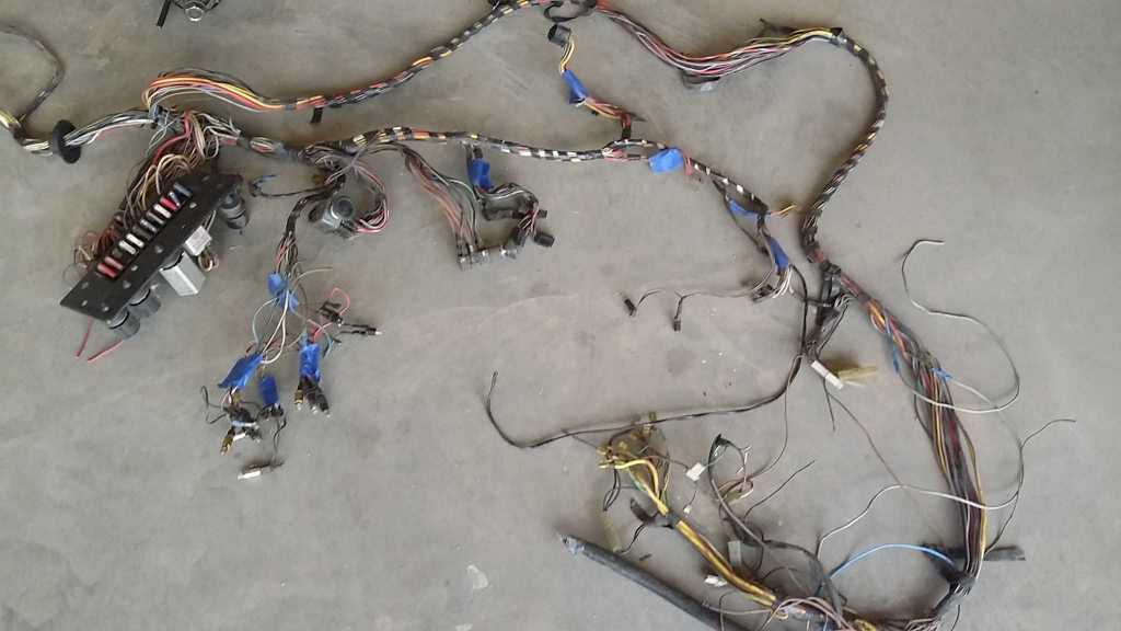

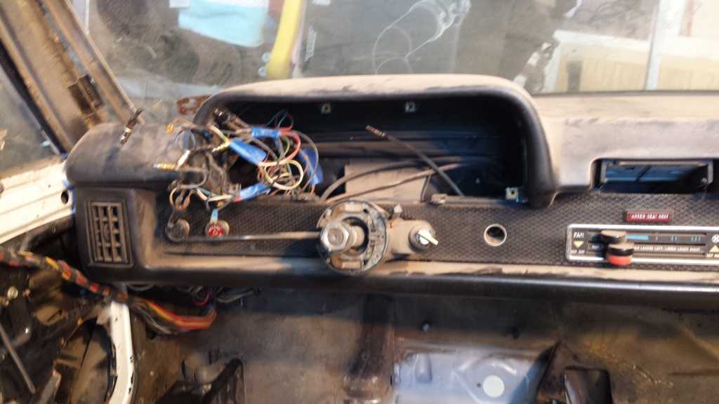

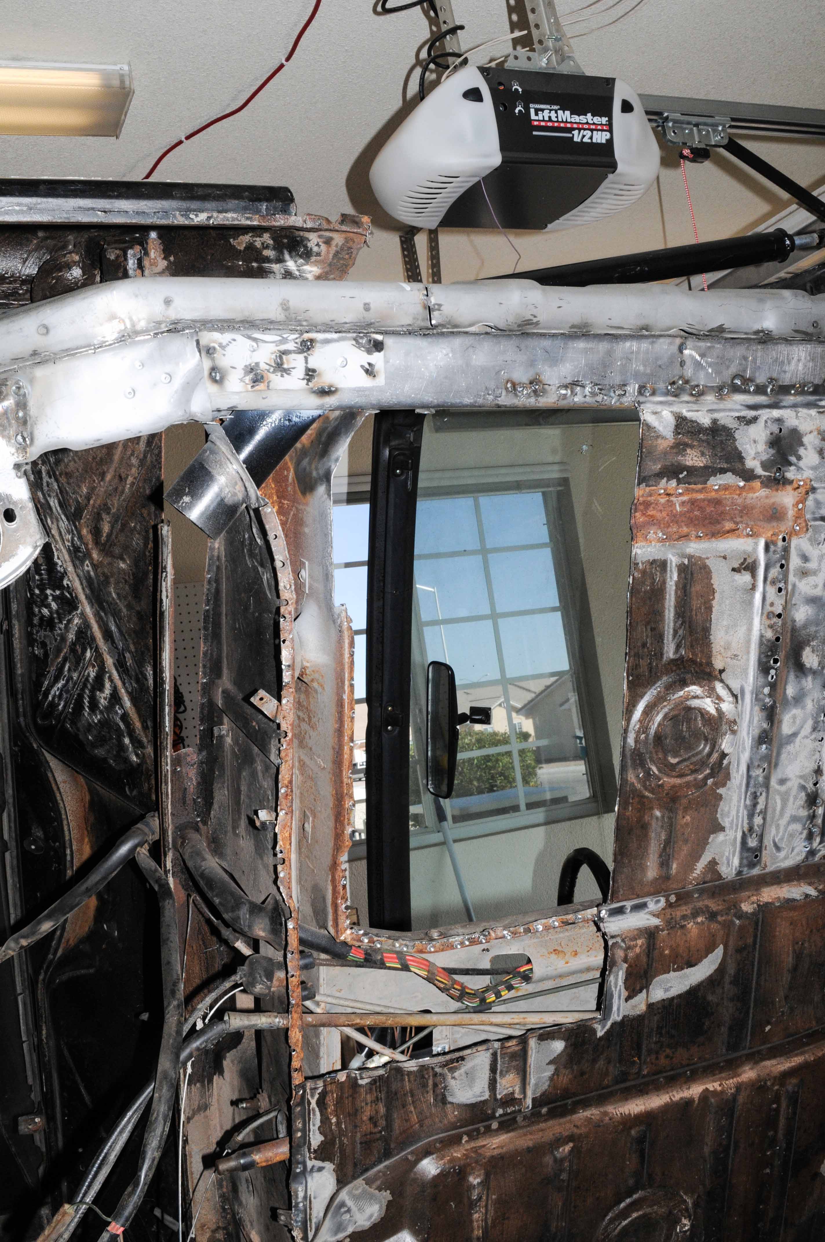

January Progress: Not a lot this month. Focused on removing wiring harness & relay board, steering column, lower dash, upper dash. Been working indoors gathering all my wiring notes and details. I already have schematics made for motor and modified 914 schematics - just need to combine them into a plan since it'll get a whole new set of harnesses.
Challenges: Cold weather & short days. Need to attempt to remove the dash frame with the windshield installed. If it becomes a major hassle I'll just remove the windshield and wrap it for storage.
Vendor Participation: None this month.
Pictures:
Wiring and dash removal
(IMG:http://www.914world.com/bbs2/uploads/post-1191-1454125631.jpg)
(IMG:http://www.914world.com/bbs2/uploads/post-1191-1454125667.jpg)
Steering column out & dash frame left.
(IMG:http://www.914world.com/bbs2/uploads/post-1191-1454125656.jpg)
(IMG:http://www.914world.com/bbs2/uploads/post-1191-1454278386.jpg)

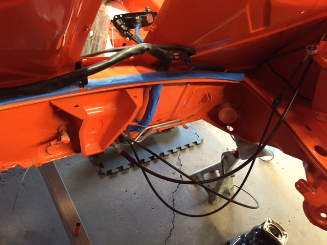

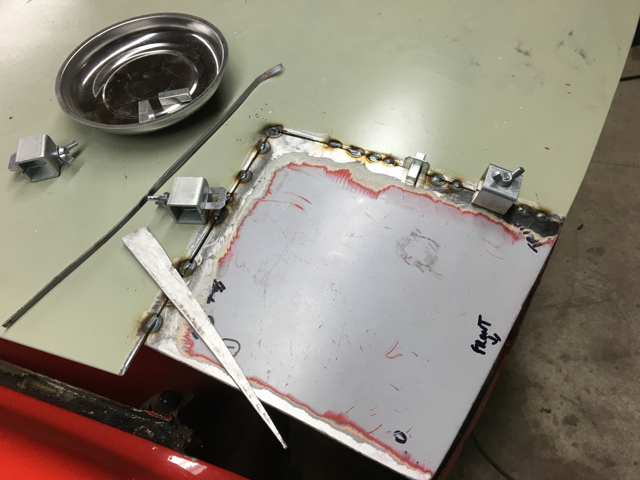

February update.

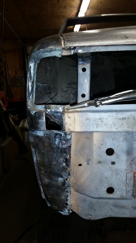

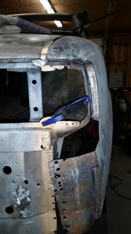

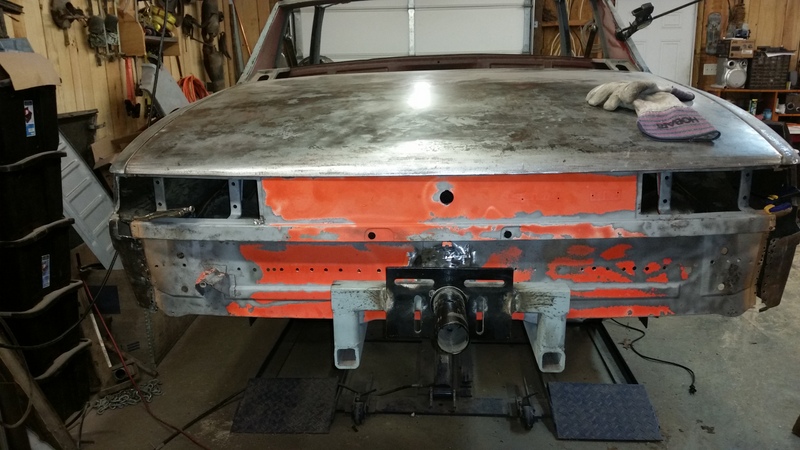

No seriously an actual update!
I got a lot of work done to the arse end this month. I repaired my repair panel, the trunk mid section and the rear truck corners.
I also set the quarter and trunk lid in place to line every thing up.
Challenges: Rust, always more rust!
I still have to get the nerve to weld it all together (any tips?) and the I can fix the corners of the fenders.
Unfortunately I still have not used any vendors or shops.

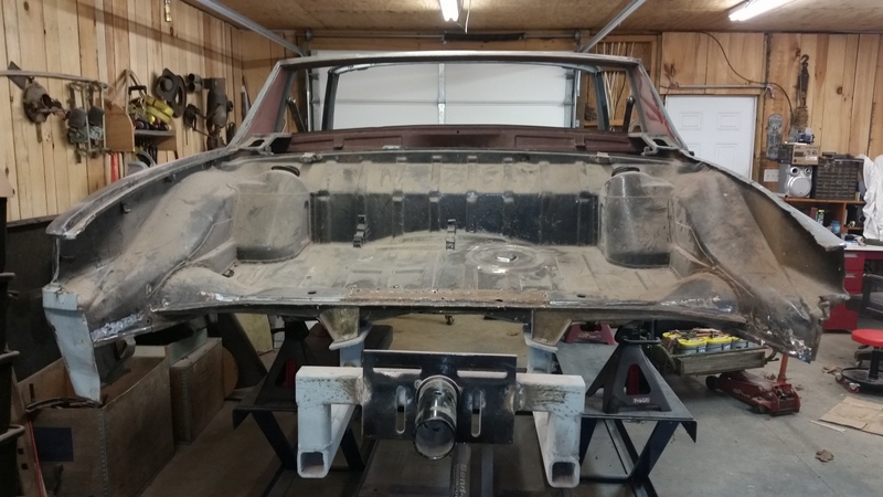

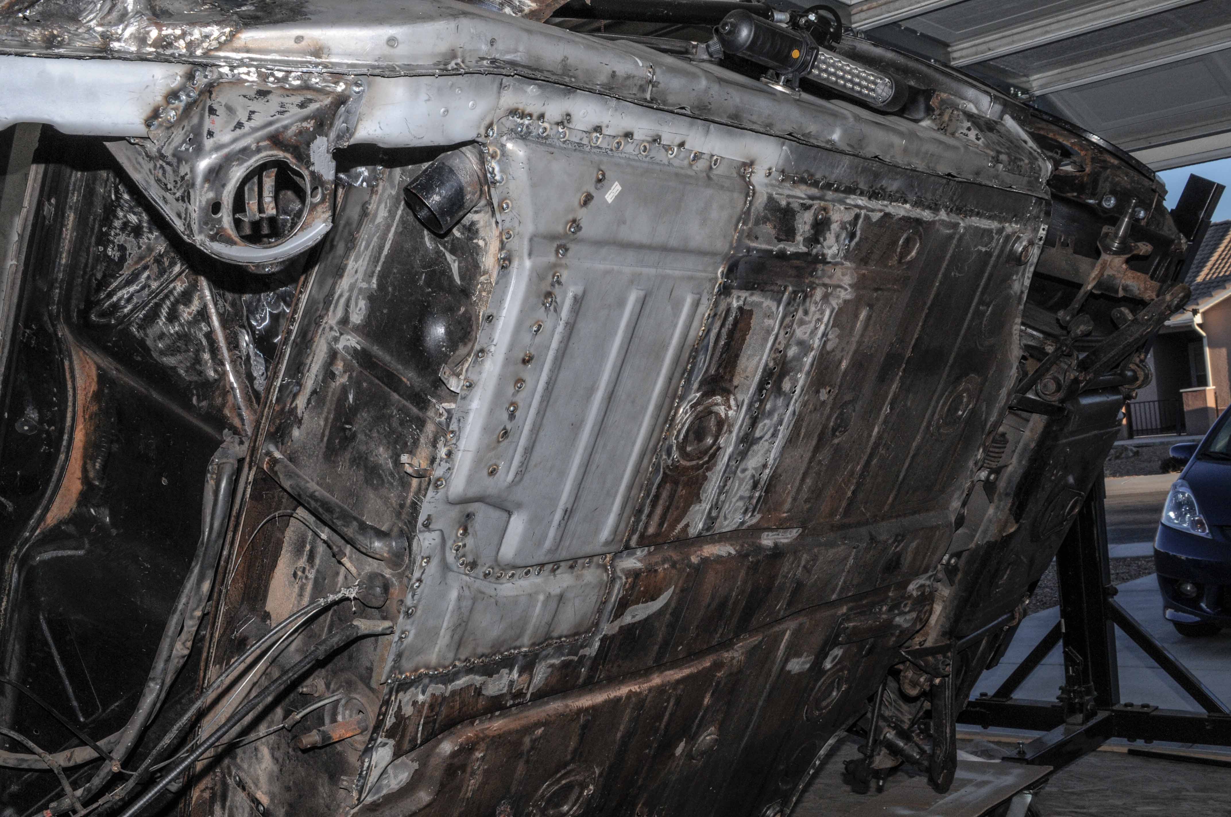

This month's progress:
I feel like I got a lot of work done, parts ordered and we are moving.
Hitch is done as of today, until it gets off the rotisserie.
Sub straps mounts installed
Shoulder harness strap mounts mocked up, driver left shoulder is done.

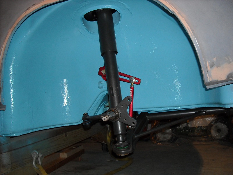

Working on the engine mount, I am moving away from using the -4 mount and going off the firewall. It is welded up, and ready to be installed, cleaned the chassis, and minced everything up.
Other significant items:
All 4 fenders cut off, so I can get in there and work.
Will be working on the engine compartment next month. And rear suspension console re-enforcements.
BTW, I have been keeping track of the cost of this build. Not bad, but I have ordered quite a few parts that are not going into the build (IMG:style_emoticons/default/headbang.gif) When your doing as much customs work as I am, sometimes you have to purchase an item in the hope that it will work out. That being said, I am well above 500, so I would be a hall a famer if this was baseball.

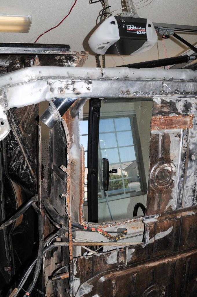

This month was definitely better than the last, there were no injuries to hold me back, and the only challenges were getting a new class of students (the first 2 weeks are a lot of work) and the in-laws being in town.
I received nothing from vendors, still waiting/hoping for free stuff...

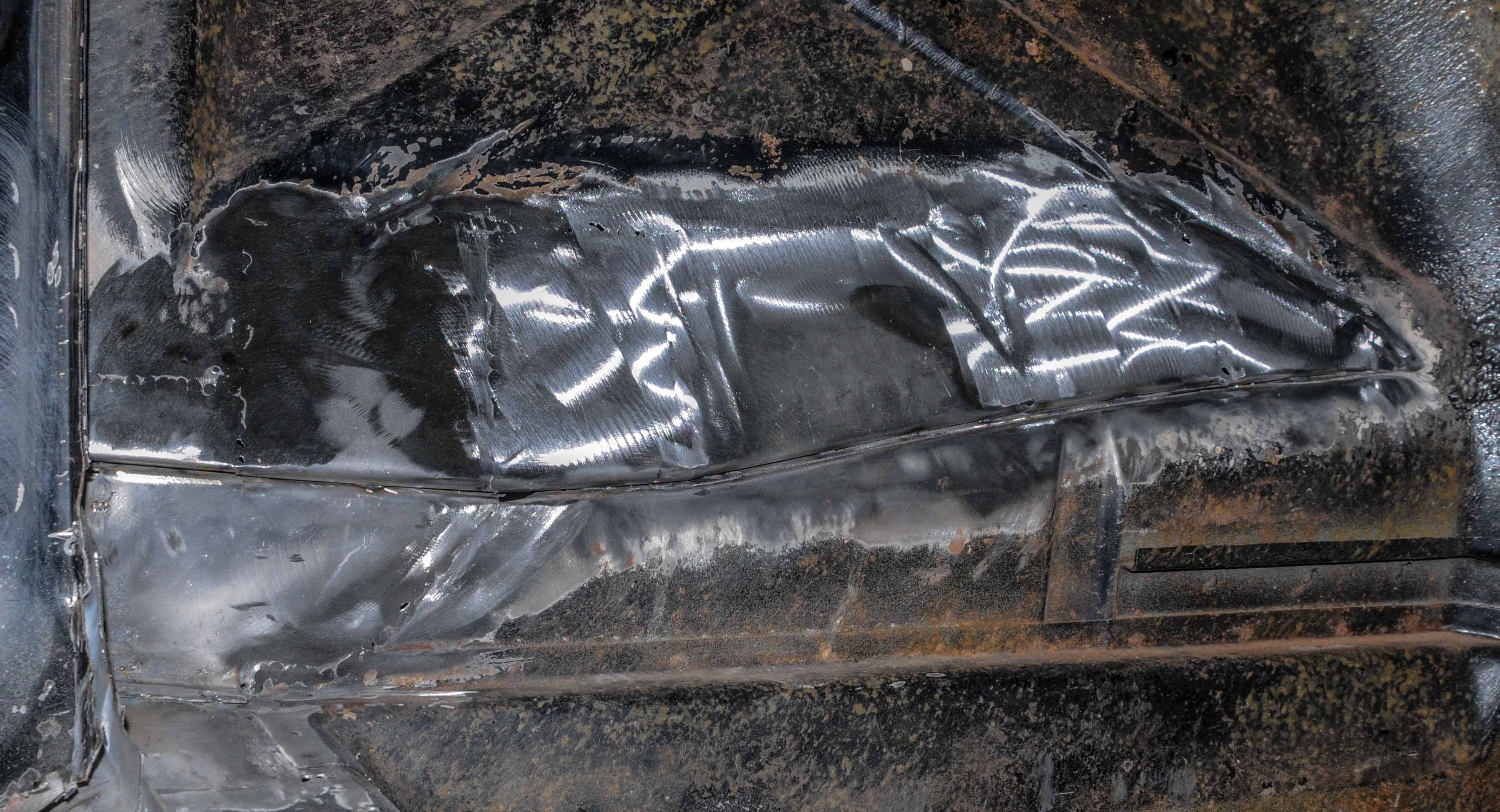

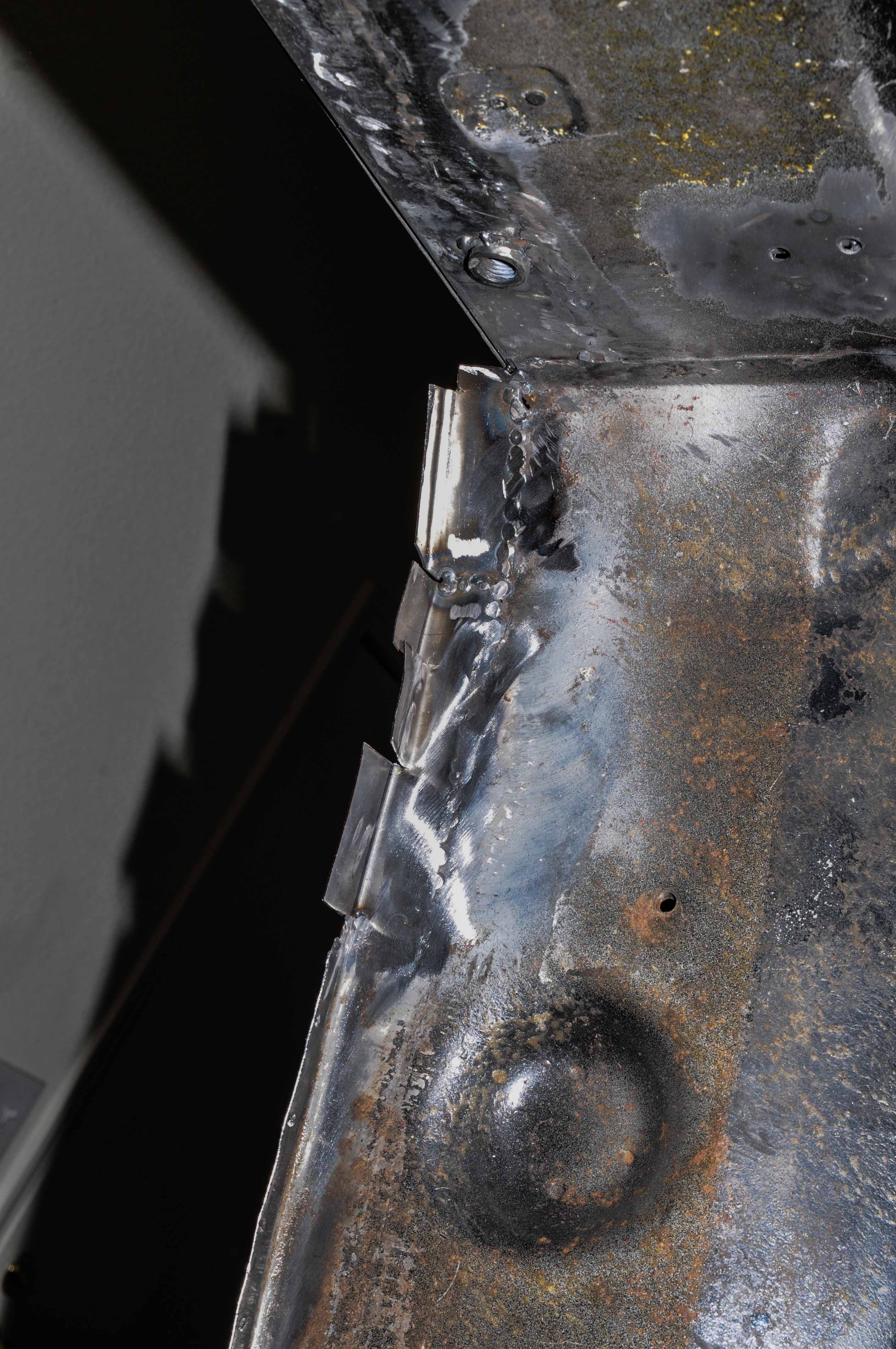

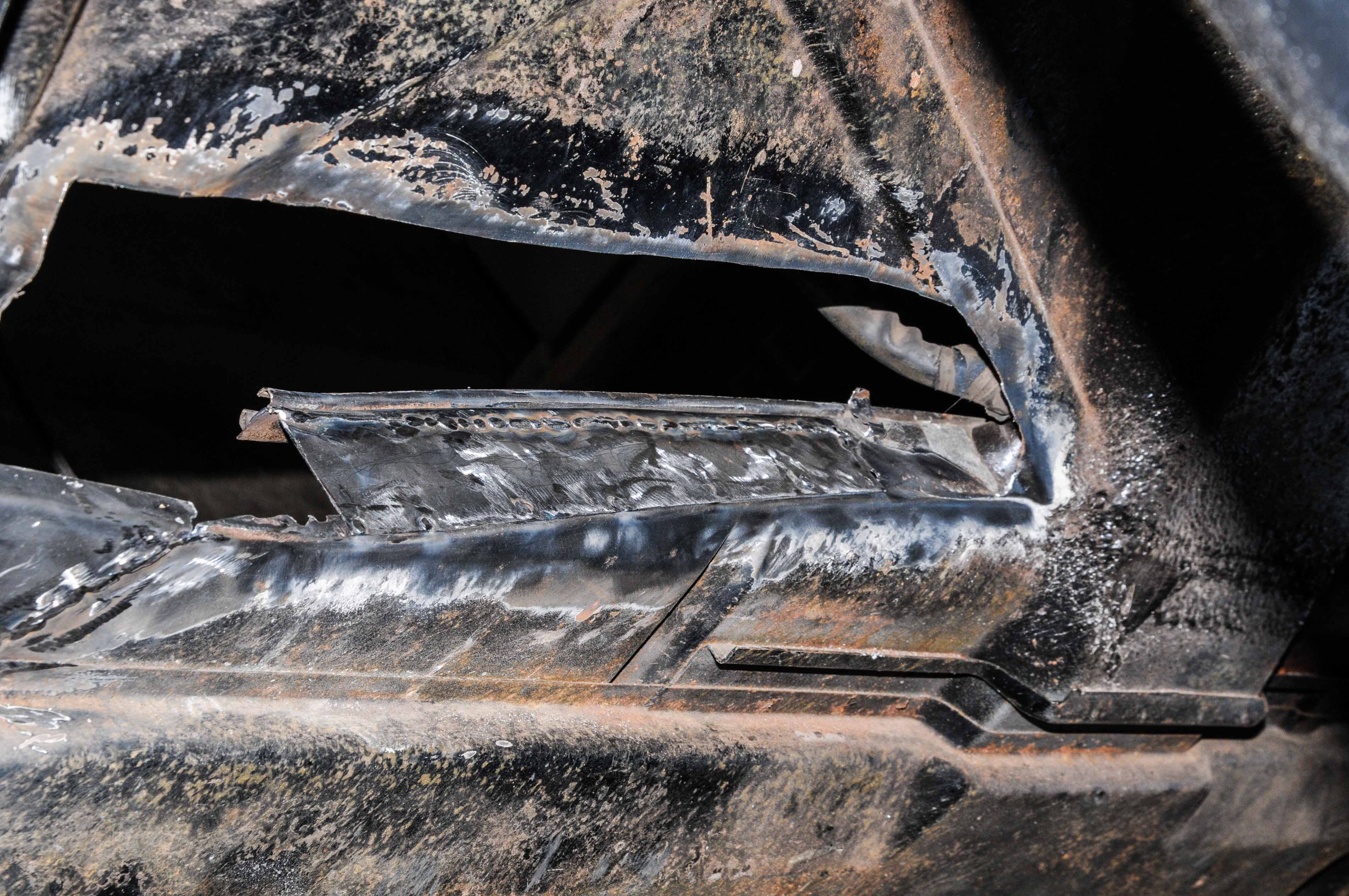

The work done was: 1. Cut out the bad section of the floor. 2. Finished off the lower firewall. 3. Finished the front engine tray. 4. Finished the upper firewall. 5. Welded in the new floor section.
I guess my biggest challenge was finding sleep, getting fabbed pieces to fit, and most of all getting the rear corner of the floor piece to sit flush on the long. That corner stuck up a few mms (a cm + on the very end) while the rest of the piece fit perfectly. I figure the issue was due to me fabbing the inner long and not getting it exactly right. I fixed the issue by doing the first couple plug welds where it did sit flush, then hammering the piece down, doing another plug, hammering the next and so on all the way down the line.
The floor was one project that I am extra happy that I have the rotisserie.

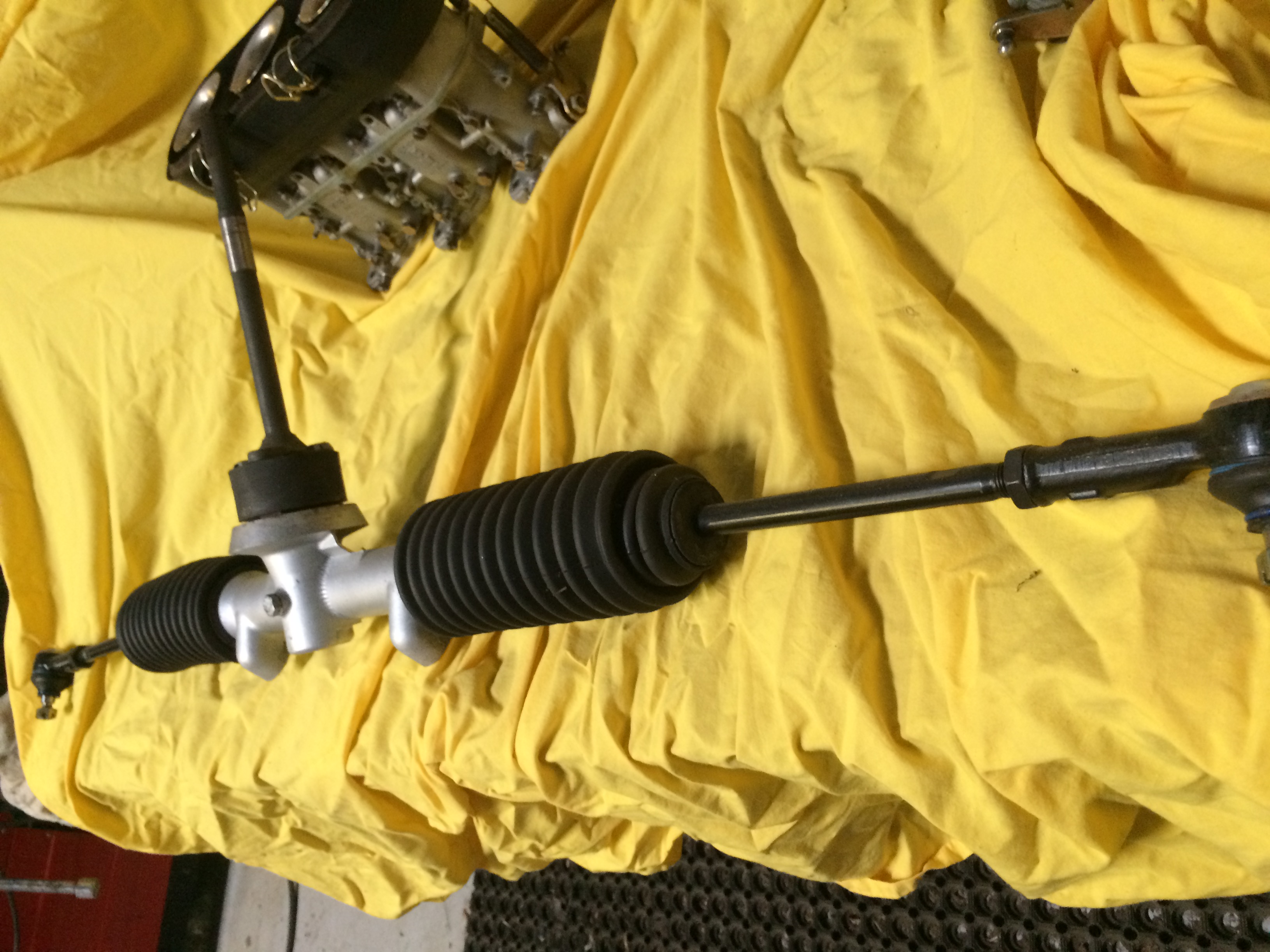

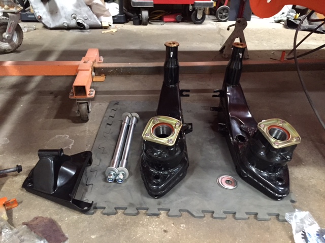

Well january and February were wet and cold so a lack of work was done to the car, i rebuilt the front calipers and steering rack, ordered some more parts and unfortunatly that was about it !
vendors used-
PMB
Ebay !
next month i'm fully back on the case another year older but ready to go !!!
whitetwinturbo
post Feb 29 2016, 10:51 AM
Post #195
Posts: 1,391
Joined: 22-October 11
Member No.: 13,704
Brake rebuild looks nice (IMG:style_emoticons/default/beer.gif)

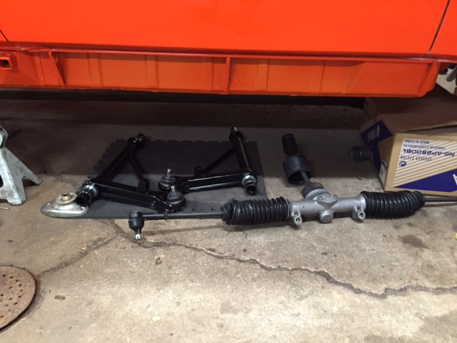

This month I have had a lot of help from Mark at 914Rubber both technical and financial with the discount. The discount has really helps since I have replaced almost every piece of rubber on the car. The most helpful tip when trimming the rubber strips to the correct length was to put soapy water on the knife blade. It cuts like butter with soap water but without the soap water it grabs and gives ragged edges.
I got the new stainless fuel lines installed this weekend along with the clutch cable and speedometer cable.
I have started to assemble the suspension components which I hope to start installing sometime this week.

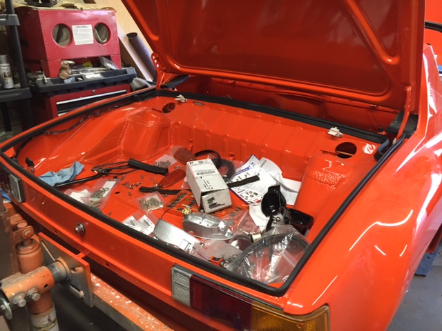

Now that my friends is (IMG:style_emoticons/default/cheer.gif) ORANGE (IMG:style_emoticons/default/cheer.gif)

February Update: Michigan Build
Michigan Build Link
Build progress :
Well, still on it. Worked on the hood to eliminate the headlamp doors. I, know, it took me a while to convince myself to do it. The pop up headlamps are a great feature, but.
Unexpected challenges:
Getting the cut correct, on both sides of the filler pieces.
Vendors:
No chance to do that this month. Not that I don't want to!
Progress Pictures:
The rest of the hood, and more @ Michigan Build Link Thanks for the look.

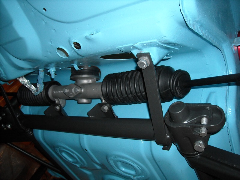

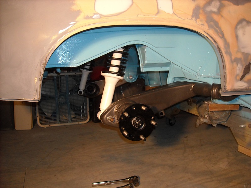

February progress.
Got the steering rack finished and installed, along with the struts and sway bar.
also installed the new bearings and Elephant Racing rubber bushings into the rear control arms and got them installed.
So it has suspension now. (IMG:style_emoticons/default/aktion035.gif)
Looking for all my old pieces of brake lines to use as patterns when I bend the new ones.
Although I boxed and bagged everything when I took it apart. I didn't label the boxes. Duh.... (IMG:style_emoticons/default/blink.gif)
so I started taking things out of the boxes and writing down what was where. one of these evenings I will enter every thing into a searchable file, so I don't have to open 3 or 4 boxes just to find a part. also making notes of anything that needs to be done to any of the parts. and threw away a bunch of stuff, like old vacuum hoses and spark plug wires etc.
good cold weather project..
