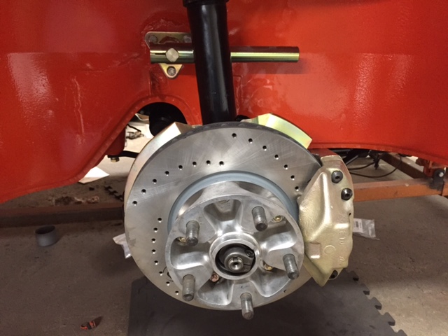

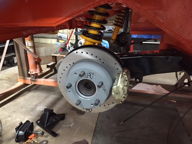

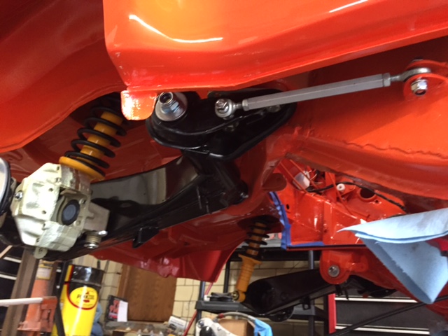

QUOTE(Olympic 1.7 @ Mar 1 2016, 08:42 AM) *
February progress.
Got the steering rack finished and installed, along with the struts and sway bar.
also installed the new bearings and Elephant Racing rubber bushings into the rear control arms and got them installed.
So it has suspension now. (IMG:style_emoticons/default/aktion035.gif)
Looking for all my old pieces of brake lines to use as patterns when I bend the new ones.
Although I boxed and bagged everything when I took it apart. I didn't label the boxes. Duh.... (IMG:style_emoticons/default/blink.gif)
so I started taking thing out of the boxes and writing down what was where. one of these evenings I will enter every thing into a searchable file, so I don't have to open 3 or 4 boxes just to find a part. also making notes of anything that needs to be done to any of the parts. also threw away a bunch of stuff, like old vacuum hoses and spark plug wires etc.
good cold weather project..
Yeehaw.. UPS just dropped off my Fastenal order... new caliper bolts..
So nice (IMG:style_emoticons/default/popcorn[1].gif)

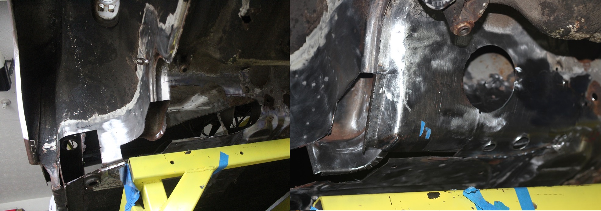

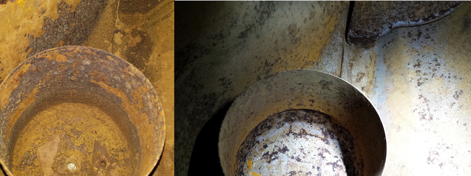

Put off posting a February update, the 18 degree temps were not a great motivator. Got some good work done in January and February, though. Got the front passenger side corner mostly put together, so the long will have something solid to connect to up front. Then, since sitting on the garage floor did not seem so appealing, I figured I'd work on the tank a little.
Here's the corner weld-up. Cut some out of all three layers you can see here, and started welding in the patches I fabricated- before & after:
This is the clean up of the tank, done using electrolysis- before & after:
Only real challenge was convincing myself that sitting on a below-freezing garage floor would be worth it.
Not sure if group buy stuff and things we get from other members should go in with vendors/shop help, but I did get a set of LED taillights from Spoke, and 914werke helped me with the suspension mount up front. Thanks guys!

QUOTE(mbseto @ Mar 6 2016, 11:01 PM) *
How did you clean up the rust like that????????? (IMG:style_emoticons/default/idea.gif)

"This is the clean up of the tank, done using electrolysis- before & after"
Here is a good link on how the process works, been used for years.

QUOTE(02loftsmoor @ Mar 18 2016, 09:46 AM) *
In the interest of community, I'd be more than willing to write up this process with colored glossy photos with circles and arrows, etc. But as mentioned, there's a ton of information already out there.
In short, you need a battery charged (or some source of current). Fill the tank with water and washing soda (1 tbsp/gal). Use a piece of steel as a sacrificial electrode and dip this into the tank without touching it to metal. Hook the tank to the negative, and hook the electrode to the positive. It'll suck the rust right off the tank. You have to occasionally pull out the electrode and clean it off. A few sessions and it's pretty rust free.
