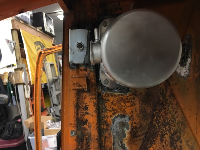

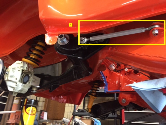

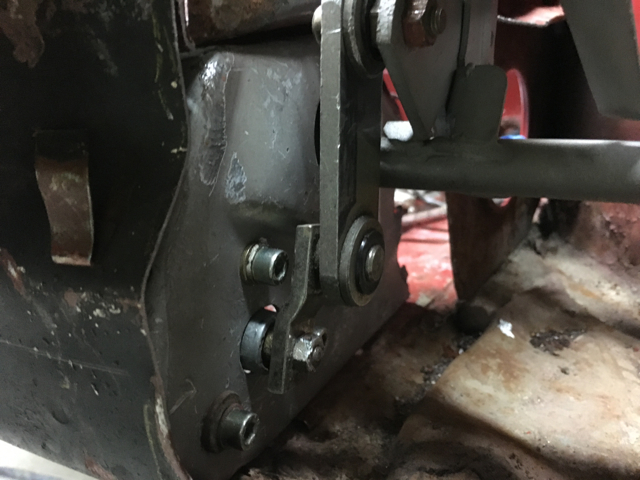

............what is this and it's function?
ClayPerrine
post Mar 30 2016, 08:44 PM
Post #222
Posts: 16,567
Joined: 11-September 03
From: Hurst, TX.
Member No.: 1,143

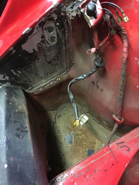

QUOTE(whitetwinturbo @ Mar 30 2016, 09:19 PM) *
That is a turnbuckle setup to make rear toe adjustments easier. It was done on the GT racers from the factory.
whitetwinturbo
post Mar 30 2016, 08:46 PM
Post #223
Posts: 1,391
Joined: 22-October 11
Member No.: 13,704
.........got it .................thanks.

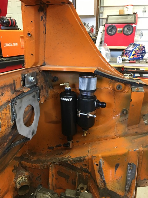

Mounts are in for the fuel filter, Breather catch can, Cooling system over flow catch can, and the Coolant expansion tank. Harness mounts are also done, and re-inforced for my and my co-pilots safety. New setup allows me to have the harness and standard road seat belts in place.

Olympic 914

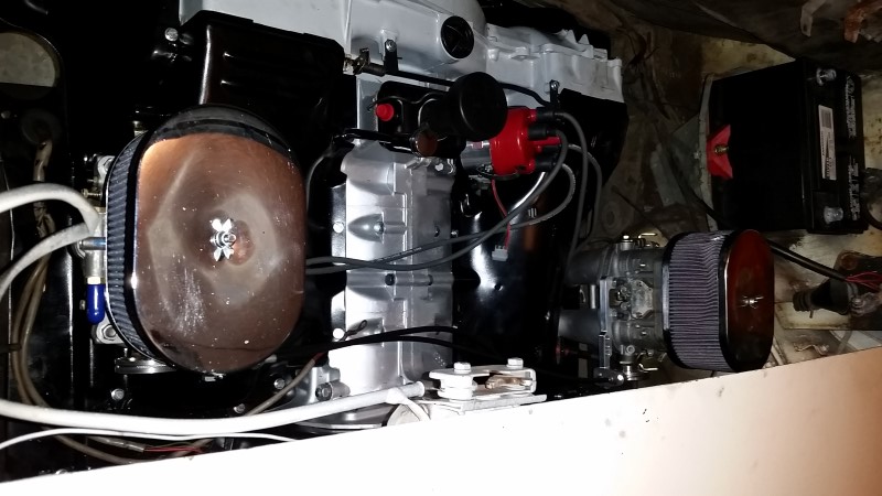

Put the engine in for what is the last time unless I absolutely have to remove it.
(IMG:http://www.914world.com/bbs2/uploads/post-172-1457470776_thumb.jpg)
Got a stroke of luck and due to the placement of the engine/trans I was able to use stock VW bus CV joints with my adapter on the hub side and 100mm flanges on the trans side. These are the same axles in the Renegade hybrids 500hp axle kit. Even bigger plus is I can go to the local parts store and pick up replacements. (IMG:style_emoticons/default/smilie_pokal.gif)

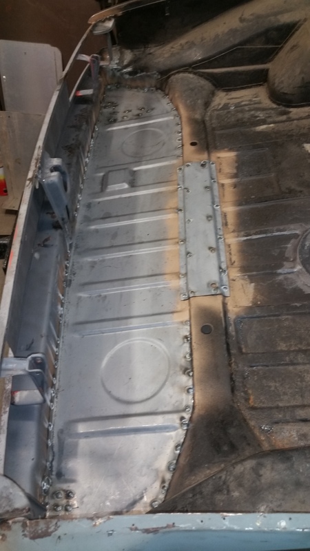

Got some work done. Rear trunk is pretty well done. I have to add the muffler shield but I will hold off on that for now.
Moved on to the Pass rear quarter, but am having trouble getting everything lined up. Oh well.

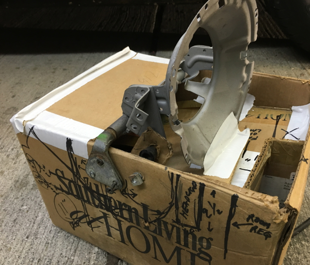

On to the headlamp's. Goal motorized headlamp's in the front bumper. With a solution for headlamp laws.
Unexpected challenges:
After thinking I was all set on location, actual fit changed the idea 180* so lots of restarts.
Vendors:
Picked up a pair of conversation kits for the front turn signals.
Progress Pictures:
The rest of the headlamps, and more ( in addition posted a trick for fixing dents in dash pads)@ Michigan Build Link Thanks for the look. And thank you to all who voted and viewed the "Michigan Build"

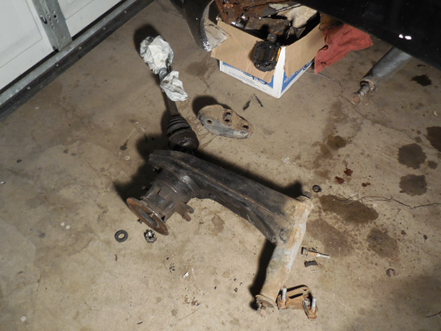

Broken CV on driver side. Refurbed with help from malcolm2 (IMG:style_emoticons/default/beerchug.gif)

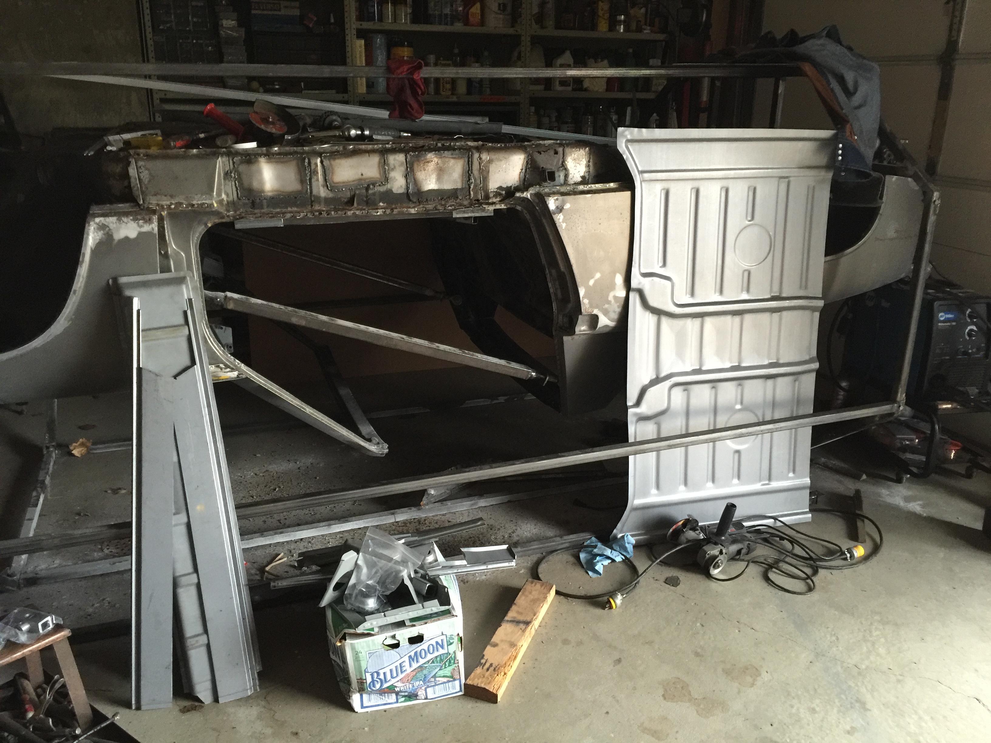

March Progress: Not a lot this month. Been piecing together sheet metal to close off the rear firewall at the trunk. Going slow.

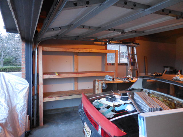

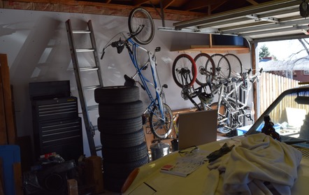

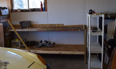

We have spent the majority of the month getting organized in the garage after insulating and drywalling. Got my first actual workbench and and tool chest. Turns out not having a place to store tools leaves you in a constant search for the right tool. Who knew?
New Workbench
Before
After
Shelves
I still have to install the some insulation in the ceiling rafters but figure i can do that in chunks.

Well, Month 7 is upon us and I’ve made good steady progress this month.
Again I’ve managed to find time every day to do something on the car.
This months achievement is getting the Dashboard refurbished and back in, including refurbishing all gauges and controls.
Challenges this month were still finding problems and faults that I’d not known about. Wrestling the blower box seals (plenty written in other threads) and finding ingenious ways to overcome them.
I’ve made a start on a tool for helping refurbish my wheels and also made foundation repairs for retrimming the rest of the interior.
Again working in a tiny garage is the biggest hurdle, which has resulted in me having to work on parts from the car in my garden, my small shed and my sons bedroom!
So please take a look at my Build Off Thread and I hope you enjoy what you find.
