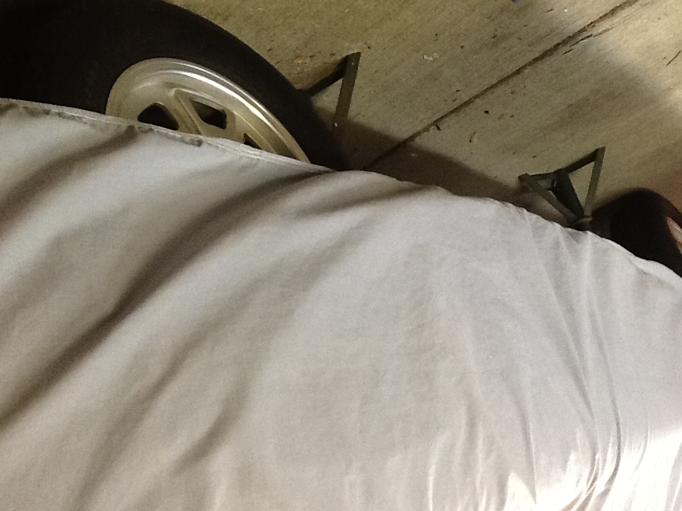

Just got home from a month-long vacation and can't wait to get to work this weekend! Vacation was fun even with all of the time spent with in-laws...
Needless to say, no progress was made on the 914 in April, just as no progress was made in March due to the finger incident, subsequent infection and resulting pneumonia.

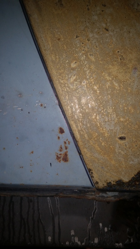

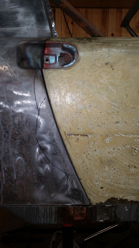

Well May has be back on track. Doug L. came over and saved the day. We went from this:Attached Image
To this:Attached Image
After I took the fender back off and fixed some of the problem spots, I reinstalled it and after a lot of finagling, I got it back in place.
No vendors, but lots of help from Doug!
Biggest problem was figuring out how pulling or pushing on this spot moved all the others.

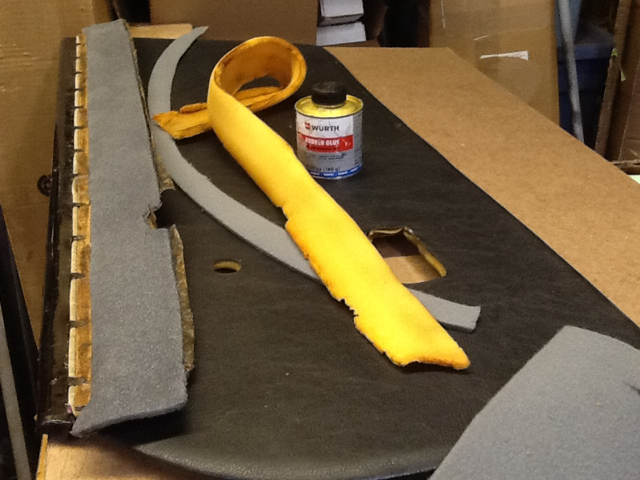

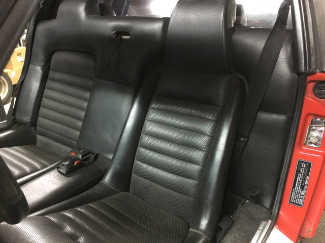

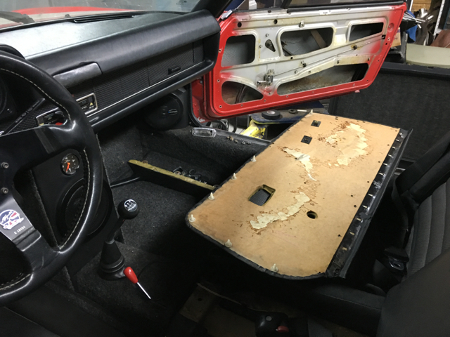

Month 8 has flown by and like all previous months I’ve managed to find a few hours each day to work on the car, and update my diary late into each night.
Achievements this month,
90% of the interior is restored and back in, and the car is starting to look real pretty.
Challenges.
Again it’s been a rollercoaster of highs and lows. Things didn’t go to plan, my friend breaking the windshield I’d spent hours carefully removing from the car and cleaning up, the trimmers continually having trouble with the knee roll (that in the end I had to re-trim myself) and issues with parts. On the flip side with a little perseverance as a whole the car looks fantastic and much better than hoped for.
Purchases.
Still working through the large box of parts from 914rubber, some parts from Porsche Centre and some disappointing parts fro AA that will be going back!
With just a handful of months left now in this 12 month build challenge I feel that the light at the end of the tunnel is near and I can’t wait to finally get to drive it!
It’s an epic read this month (it sure took me a good while to write up and photograph) so thank you in advance for taking time out to read my ramblings.

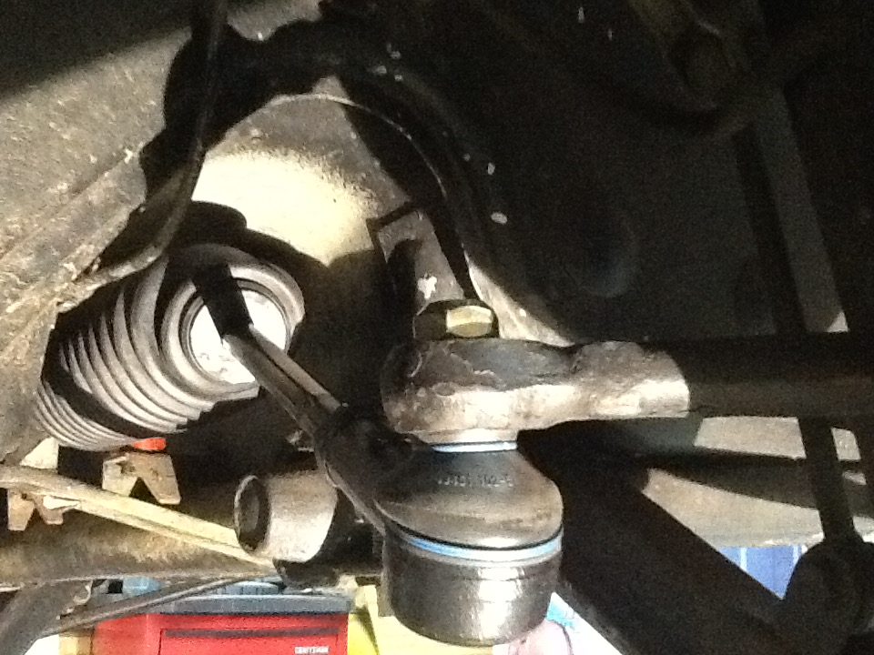

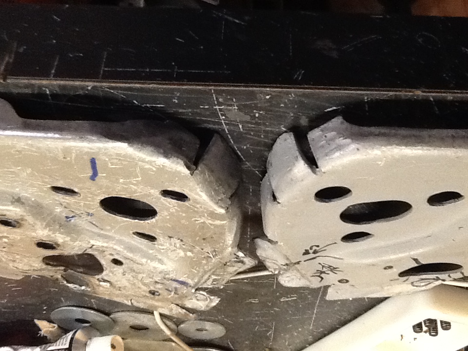

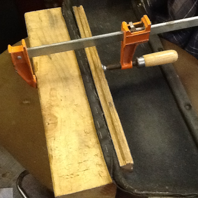

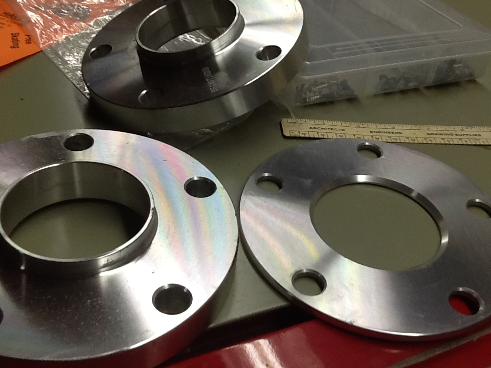

Headlamps have become a daunting task. Each time I think I have it right, I over think it and start again. The housing is not square, the tuBe for the monts is on a angle. When rotating the housing the geometry changes. I'm getting close, and looking at additional lamps in the turn signal buckets.
I found disscustion about turbo tie rods, well what I got from eBay a few years back looks now to be fake. So....I got a set for a great price here on the form and installed them correctly. Much better with the steering stops, and now I have the bellows to.
A lot of catch up and correction this month. Found the front spacers were to large, poor clearance to the fender. Originally I had 10mm in the rear, and 20 in the front. 10 all around should work, waiting on the new front spacers to arrive.
Unexpected challenges:
Many, as explained above. Also camara with a phone failed yesterday, so pictures lower quality this month.
Vendors:
Customadeonly.com (spacer's aluminum)

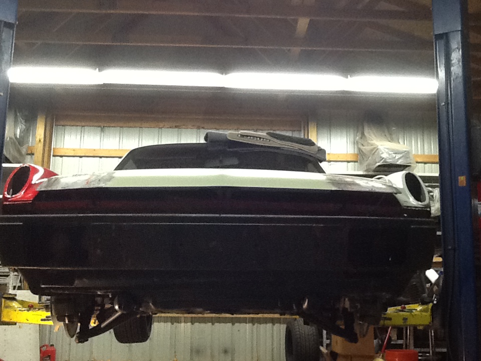

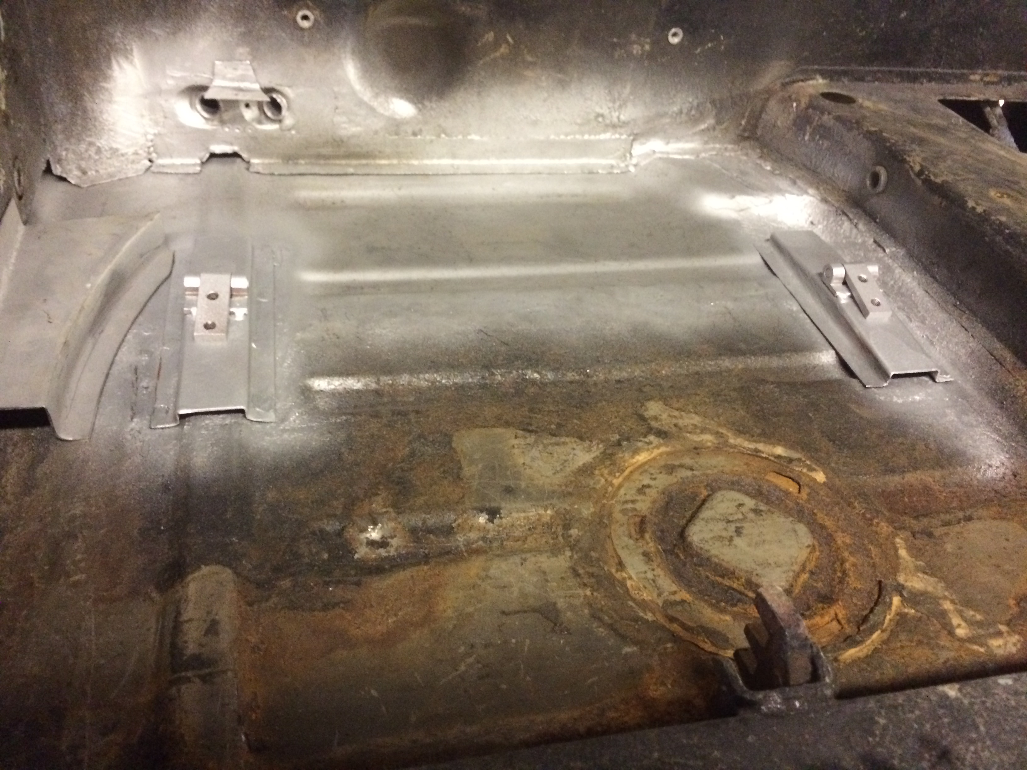

May Update:
Daughter got married, and the event went off extremely well. With all the sleepless nights I got a few things done.
Tangerine Racing rear shock mounts installed, and welded up 4 rust holes in the trunk. Finished welding my engine mounts into the car.
Vendors used:
Tire Rack
Ebay
Tangerine Racing
Rebel Racing
Elephant Racing
Jegs
914Rubber
Simple Digital Systems
and my friends Boxster S stash of parts
Most troubling issue, ran out of mig wire, which means there is 49 pounds of the stuff used in the build of this car, I would say 90% of it gets ground out.
Frustration number 2, is it seems my rear trunk has a gravitational pull of its own. Just when I seem to be moving on, I look up, and see light shining through the trunk floor. (IMG:style_emoticons/default/headbang.gif)
Car is getting uglier per day it seems, and no light at the end of the tunnel, it will be so worth it when it is done.

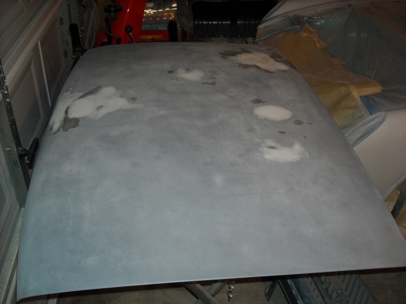

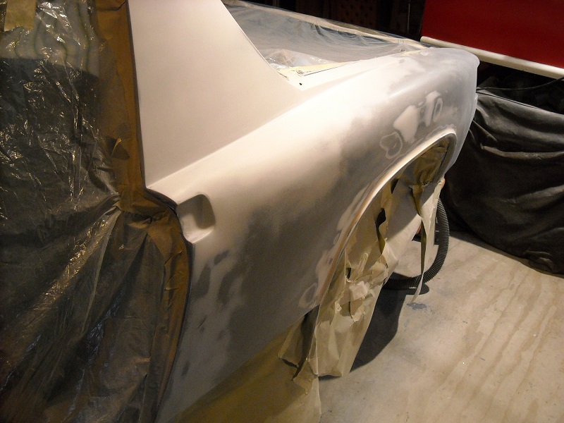

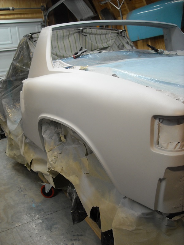

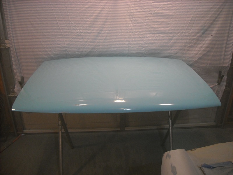

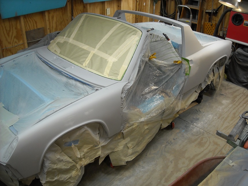

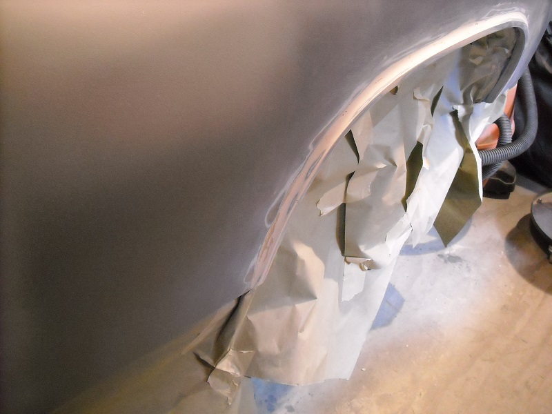

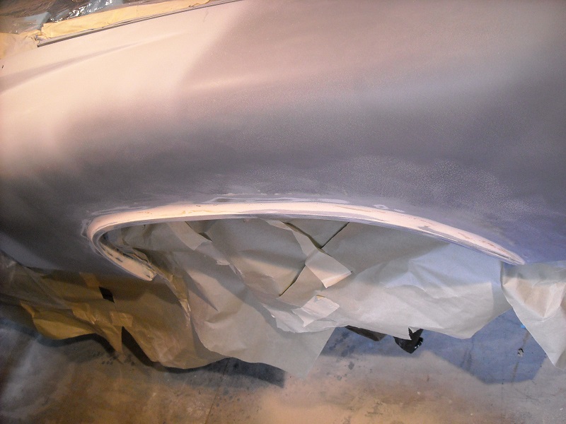

Olympic Blue Resurrection May 16 update.
Well I have continued to work on the body, I just haven't posted anything about it. I mean how many pictures of a couple fenders in primer can people stand.
lots of work trying to get the lips on the fenders to look just right. I think I finally got them.
Many many hours into this.
Finally I think its good enough.
Also decided to finish the trunk lid.
it has the final paint on now.
Next step will be to get the paint on the tub. So I will block this down hopefully only one more time ( Ha-Ha ) and shoot some real paint.
I can't wait to start putting it back together.
(still have to do the doors and front trunk lid though.)
Vendors :
Picked up some parts at Hershey. And met a bunch of fun people.
