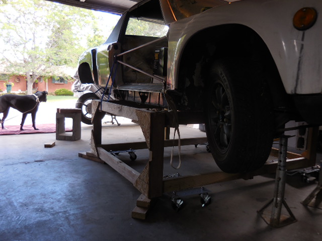

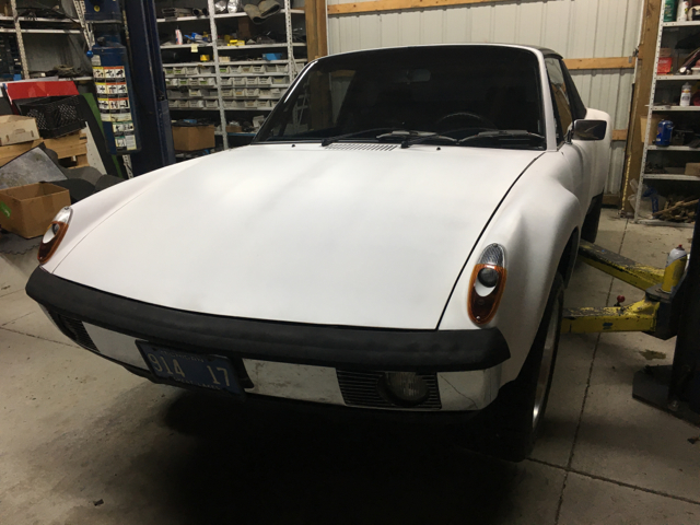

I know its been a while since I rapped at ya and I want you to know that Amy & I have been some busy little bees since my last 914 post. Unfortunately the Porsche & 914world competition were placed on the proverbial back burner while other responsibilities took priority.
So starting in October I went with my wife Amy to go wash our cars at Green Mountain Car Wash located in Lakewood Colorado. The parking lot was packed tighter than a pair of wranglers at a rodeo. We spoke to the owners who were both in their late 60's who were looking to put it on the market and get out of the business. After a refinance and 9 months of countless trials and tribulations we can finally announce that we are the proud co-owners of Green Mountain Car Wash!!! We closed on the wash on July 15th and learning the ropes has been eating my free time for lunch and dinner.
Alright so that was excuse #1 and as many of you know my wife was pregnant so you can imagine what excuse # 2 will be.
We are very excited to announce that Amy gave birth to our beautiful son Wylie Ryan Arnold born on August 23rd. He has been a hell raiser since he was born and we don't expect that to stop anytime soon.
Attached ImageAttached ImageAttached Image
On to the 914 news!!!
So things have leveled off at the car wash a bit and we are getting back into a somewhat normal routine (if you can call it that) and I am getting back to working on..... You guessed it. My 914. I am resuming work by getting it up onto a stand that I built and onto wheels so that I can move it around the garage when the wife wants to pull in. She got dinged with hail a month ago and it did $6,800 so getting the Porsche more mobile was also a priority.
That is all the progress on the Porsche as of now but I am happy to announce that we are back at it again!!!
-Brett & Amy

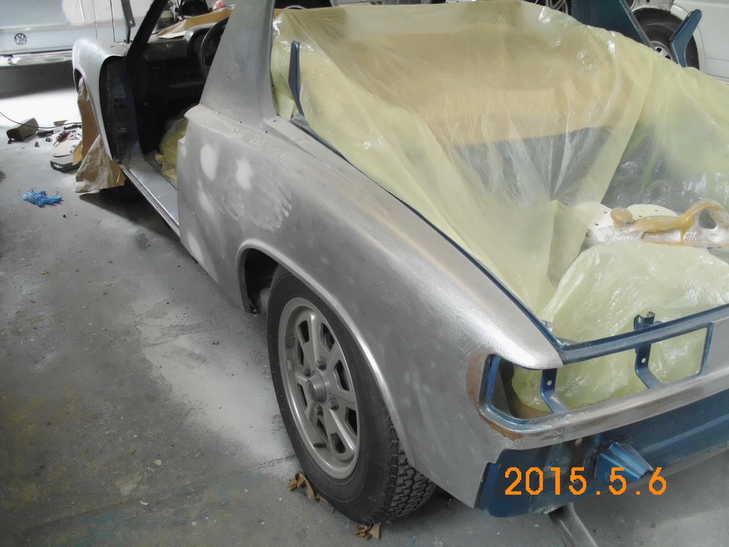

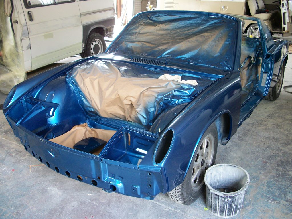

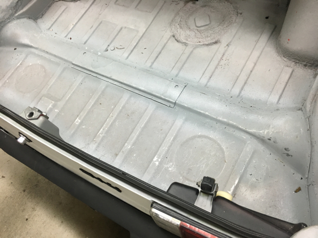

August update:
Lots done- brought the car home from Tangerine-
New floors, longs , pedal area, metal work on the rear fenders, so finally installed Restoration Design parts that I bought back in January or so.
Recent purchases from 914 rubber - sail panels and front trunk seal, new gas pedal, - but I have much more to order- also made a template for the front trunk mat for cocomats to be made to match my existing cocomats in the car-
Then due to depletion of funds, I pulled the plug on getting car painted- the guy I was booked with had done some really nice cars but the second time I met before my scheduled time to begin project , well the "estimate changed by 40% increase- can't afford that so when the day came to get it done I cancelled.
So no paint before okteenerfest (IMG:style_emoticons/default/dry.gif) (IMG:style_emoticons/default/dry.gif)
But it's ended up being a wise decision, because I called up Bob Woodman here - local Porsche shop- and explained what I was up against and it turns out he has a metal worker body guy that has done some really nice work on some 911's and looks like he can do the finish work on my fenders AND full prep for paint!
This will start next month and I am confident that it will be done right, seeing their completed projects- they use a different paint shop than I was going to- one that I happen to know but also was on the list from World member Bill Dunster- they do use the PPG Deltron product he suggested !
But just for now I need to make sure the car is ready for the trip. I had a very noisy fuel pump amd that was replaced last week, and running better. Also more tune up- going into Bobs shop just to recheck the alignment and balance after all the work done on longs and floor. then just to have better clearance , I have 6 newly restored 16x6" Fuchs coming from Alex at Magro Wheels in Tampa that will go on the rear and I will take the 7's off for now. If once the paint prep and body work is done buy Woodman the clearance is still less than 1/4" I will not put the 7s back on- they may go up for sale. I'm not going to risk ruining a new paint work and body work that has been done- I love the 7's but the 6's look great too - really if I had done that in the first place would have saved myself a lot of time trouble and $$-
So I guess that's about it for now- I wound complete body and paint before end of contest- but it will be done, done right- done well . Best done right so I don't ever have to do it again!! Just like the floor and long repair that CFR/Tangerine did! I will not ever have to do that again-

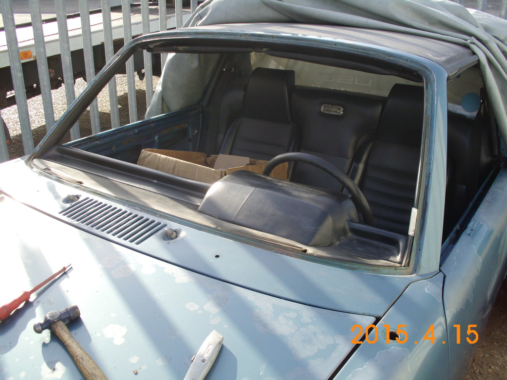

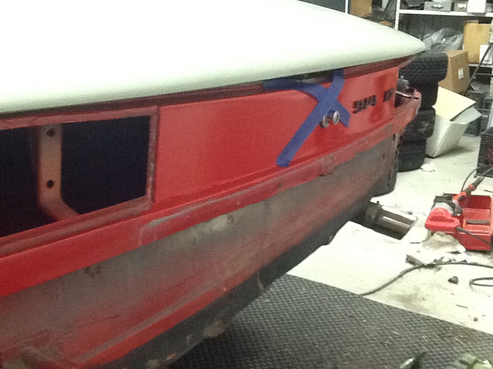

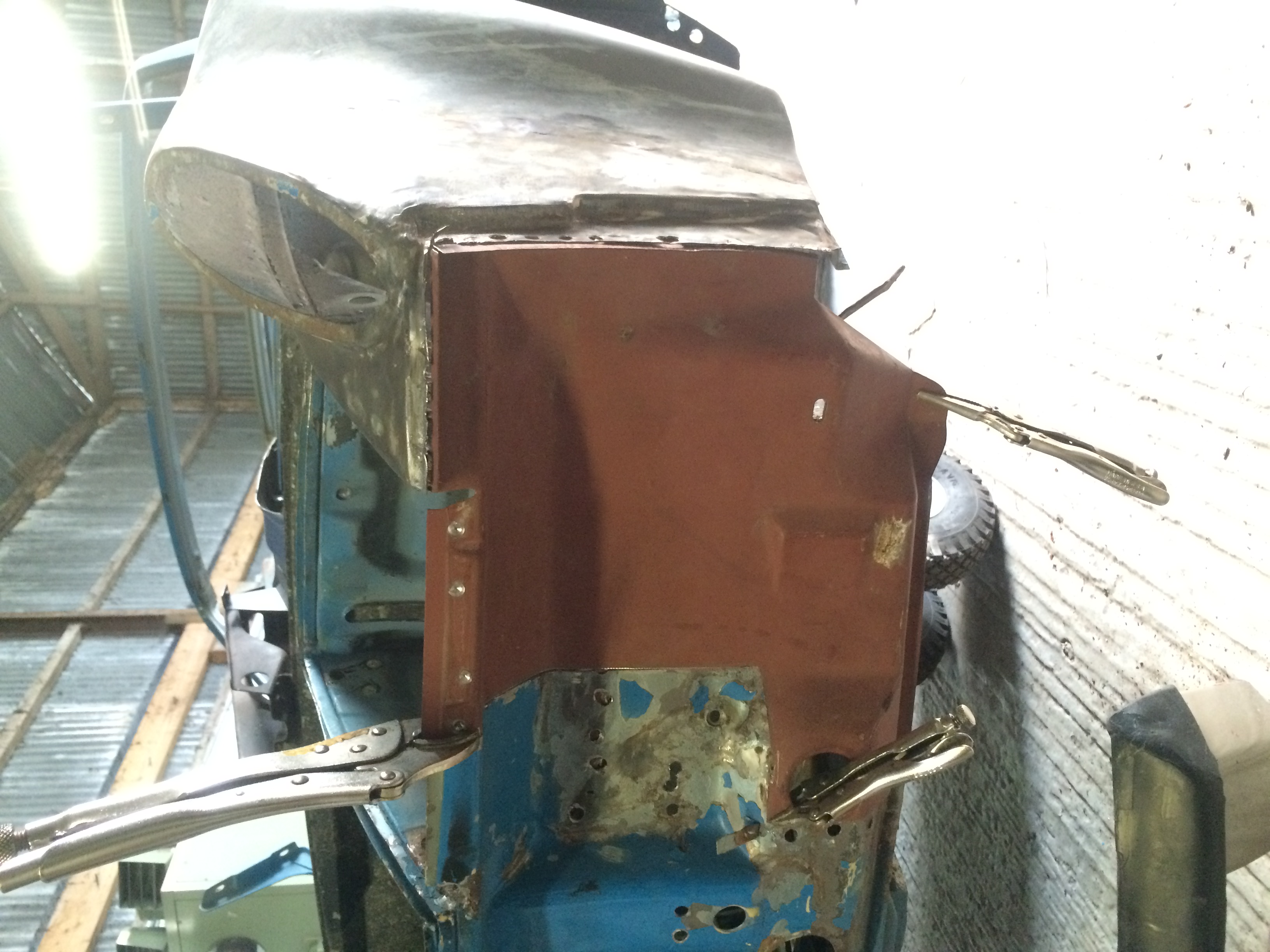

Right I'm back ! Mojo restored finger working !!
Finished the NON 914 work so the brownie points are earned !
Firstly I wore my 914 T shirt on holiday, very cool and vey proud !
So the proper work started , the damage need to be cut out to let the bumpers fit so that I don't need the inch of bondo that was previously there ,
I'll keep pushing on now I'd been racking my brain on how to repair this, I'm happy with the fit now

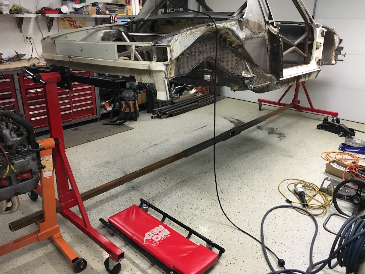

So cool to see some cars up & running. Congrats guys! I don't think I'm gonna make it by 9/14/16. Hope they'll let me re-up for next year's challenge.
914-SHO Project
July/August Progress: Just minor progress. A portion of the underside is now in primer.
Challenges:
Other projects. Family first. Life.
Vendor Participation: None this month.

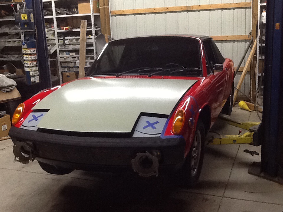

I was ask for a painted picture of the car, (that was not in the plan) Check out my Build page. And no more "asking". (IMG:style_emoticons/default/smile.gif)
Iv got to stop working on this car, Im finished with the contest, hit my 5 major goals, yet it never ends. So Im taking a short break, till tomorrow. (IMG:style_emoticons/default/av-943.gif)

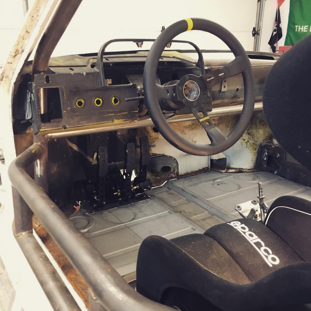

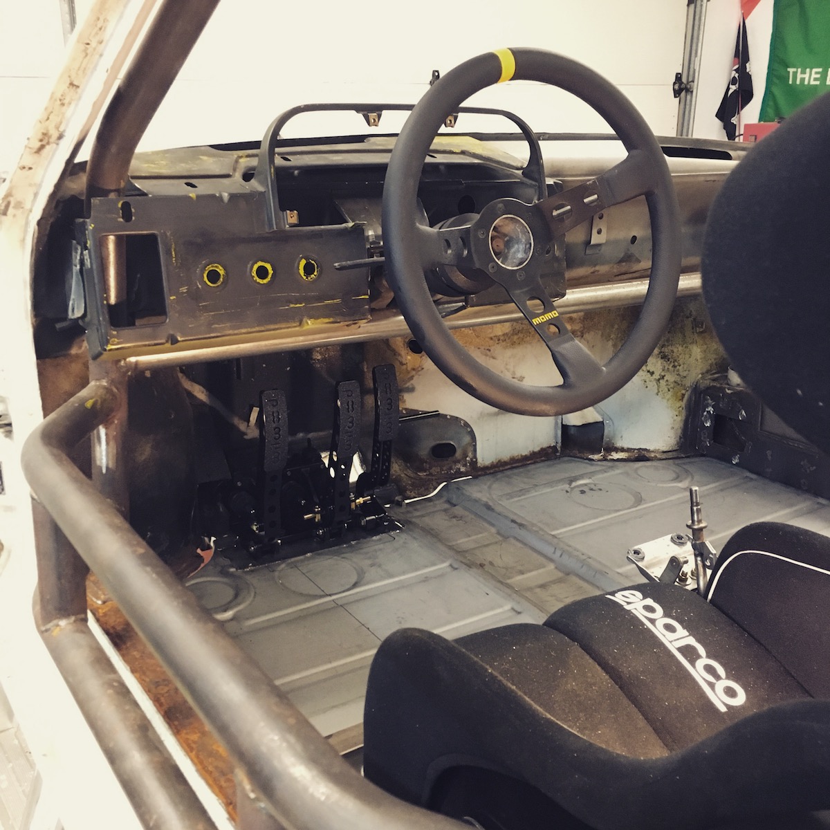

Chassis is finally ready for bead-blasting and prime!
Reinforced the rear suspension mounts.
Mocked up the Wilwood pedal install.
Rebuilt my rotisserie to prepare for transport to blasting shop.
Started work on the engine/trans mount.
Got the suspension bits back from powder coating, they look amazing.
Chassis should be off to the blaster early next week, then I can focus on installing the floorpans, and prepping for paint.
Challenges:
As always, time. Had a few good track-days with my 911 and it finally broke down. Spent a few good long days repairing it.
Also, money: I need to put in a big order for suspension bits, putting it off as long as possible.
In all, the chassis-prep has taken much longer than I expected. I thought Id have the work all wrapped up in early May but theres just been so many little details to work through.
None at this time, though I need to order more metal from Resto Design soon.

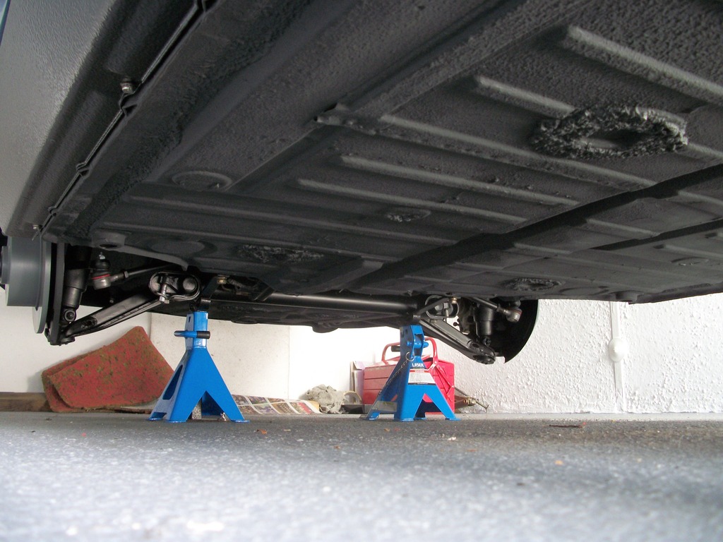

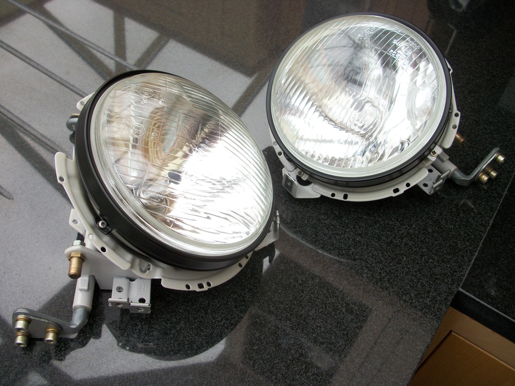

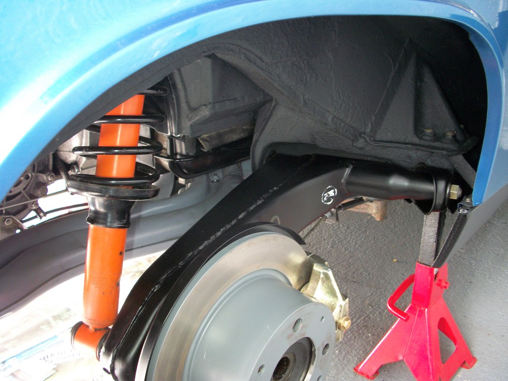

Month 12,

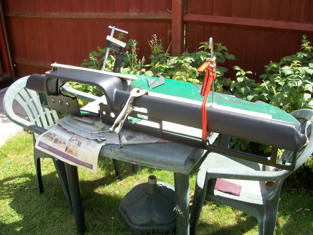

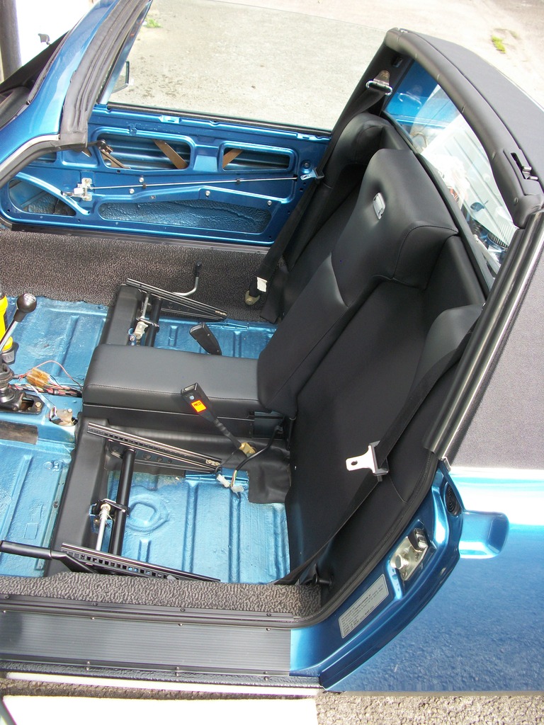

Thanks again guy’s for the kind words of encouragement in my Build thread. Like I said earlier, there’s some really great work gone on this last 12 months in the 2016 Build-off-Challenge, I’ve really enjoyed seeing and reading others progress on their 14’s.
So on to month 12 and to September 14th final round of judging.
This takes me up to day 350 of my 914 ownership and 11 ½ months of the build. I did a rough count and I believe I found on average 6 hours a day, every week day and somewhere around 26 hours each weekend (not counting my visit to ER when I had the TIA stroke) to work relentlessly on the car. This didn’t include maybe 30 minutes a day writing up my diary for 914world.
So all in all I reckon to take my 914 from an unloved wreck that hadn’t been driven in 7 years, to a car that anyone of us would be proud of, took me 2800 man hours.
Plus 175 hours sat at my PC writing this diary and uploading pictures!
Not forgetting that 90% of this build was done in a 16ft x 8ft garage a block away from my house with no power or light.
As an overseas participant and due to the time line of my build I wasn't eligible to ANY of the great vendor deals or discounts on offer.
So what you see is purely for benefit to others as I took no personal gain from being a participant in this contest. (Apart from maybe a tee shirt to come. I presume we get these at the end Steve? after the final results?)
So…..to bring us up to date, check out my build thread here.
http://www.914world.com/bbs2/index.php?sho...7250&st=100
Enjoy!

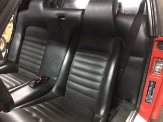

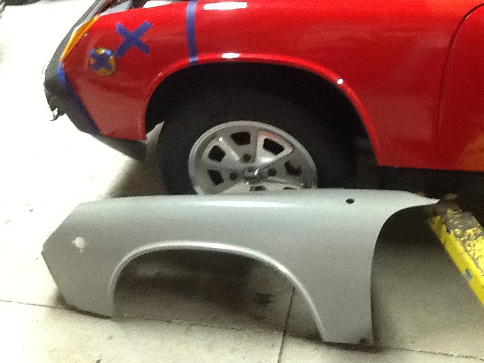

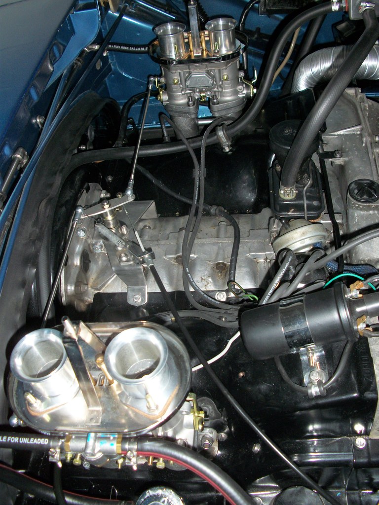

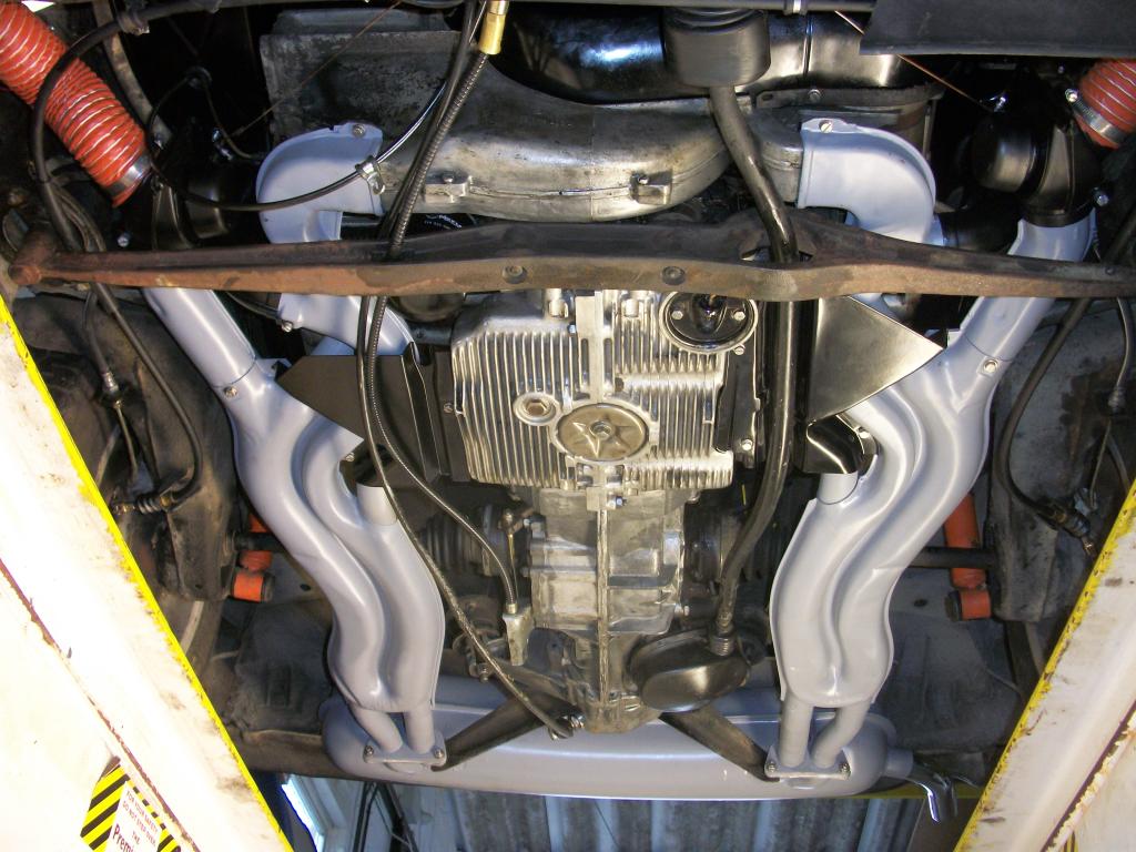

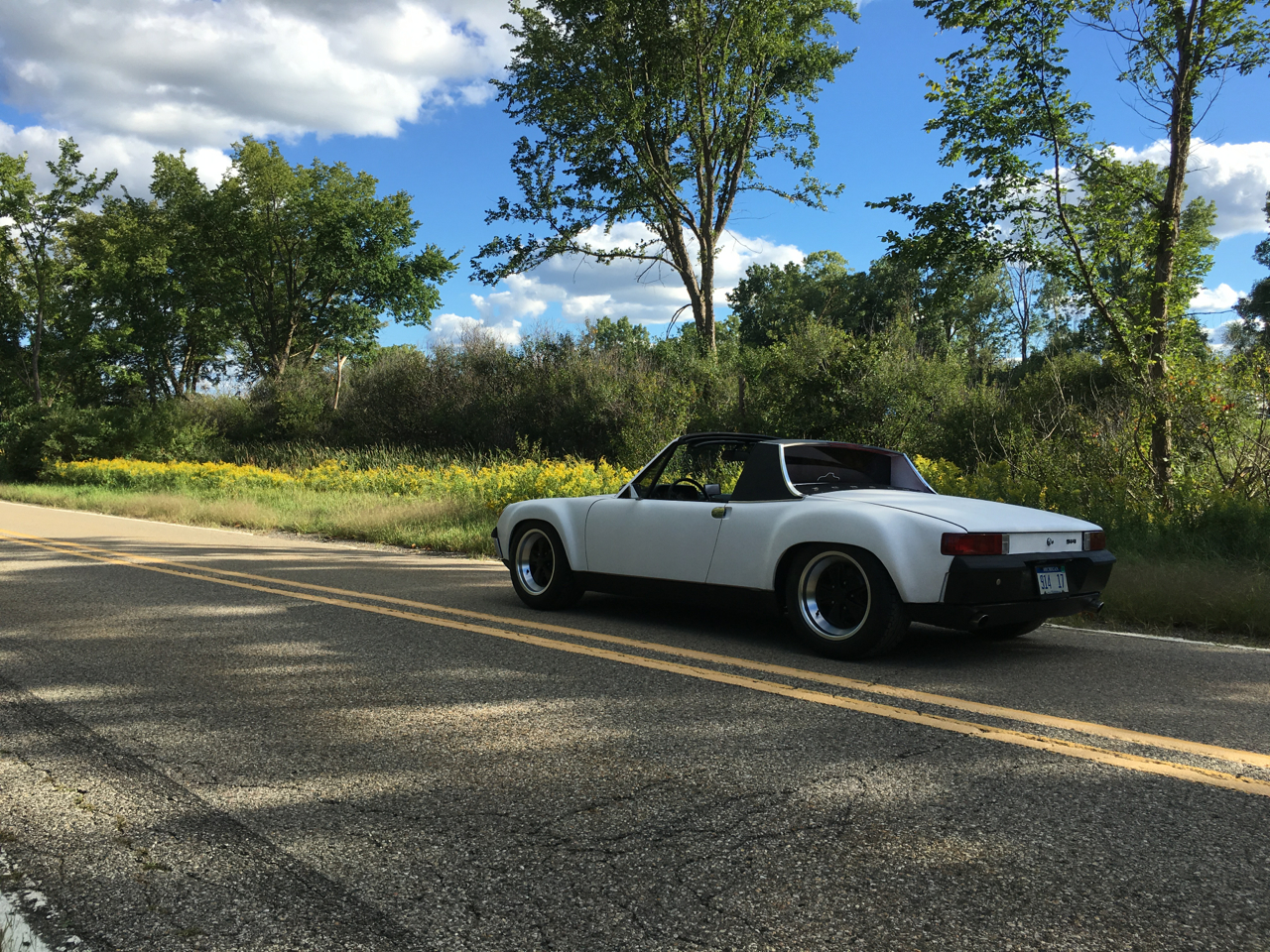

Build progress :

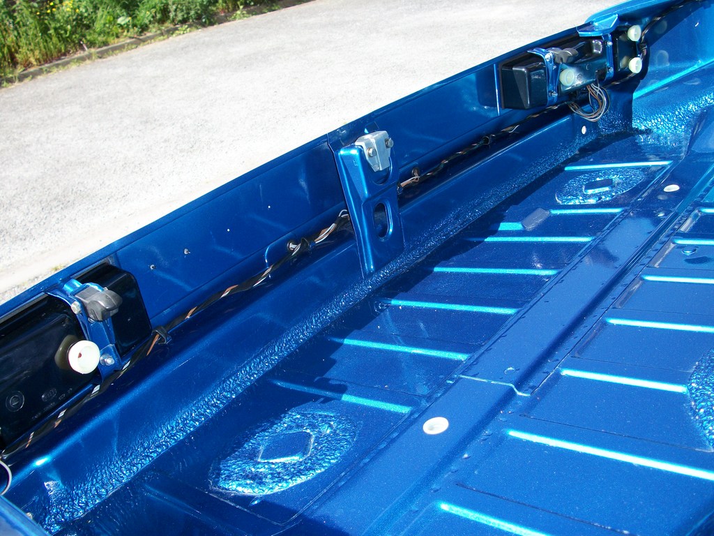

A lot has happen in this month. I was going to just finish up a few things little things over the last 14 days, and then, I should paint the car!, since I'm going to Okteenerfest. So, I sprayed Plasti-Dip flat white. Came out OK, and I can peel it off!
The engine was running some what rough. So I learned a lot about carb adjustment, and balancing. Thanks for the help from our community. That took a while, I'v always run FI.
Changed out the targa sail trim back to chrome, from black. Installed wiper arms, lettering on the grill also chrome, from black.
Drove it and pictures last Sunday. Im done.
Unexpected challenges:
Last second, 3 day labor day weekend paint job.
Vendors:
Local Paint supplier.
Progress Pictures:
Here are some before and after pictures, and a few others.

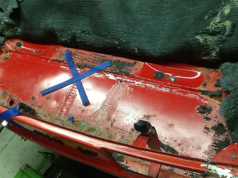

5 Major Tasks to complete during the Challenge:
1. Replace back half of rear trunk floor. (Rusted, rear ended, poorly patched)
& Replace entire rear body panel, and Bumper. (Rear ended, poorly repaired)
& Patch in 1/2 left front fender. (Poorly repaired)
2. Delete headlamp doors, modify hood, and relocate headlamps.
3. Install 4 steel flares, and modify all valances. 5 lug, and wheel tire package.
4. Build up, and replace engine.
1.7 914 Engine balanced
260 x 396 Cam .006
96mm Big Bore kit
Mallory Unlite Distributor 14004
Weber 40 DCNF (w/ very short intakes)
Air jet 1.80 Main 1.25
2.0 L exhaust
5. Major interior renew.
Un-planed:
6. Paint
Misc:
Turbo tie rod ends, rack spacers, and firmer springs and shocks. Also went with a pair of old front calipers I had from the 70's these are Girling calipers, that were tested for use on some VW's And a few other things. Also a stock steering wheel.
I try to use original hardware, and parts, where i can.
Previously installed Dr.Evil rear view mirror, 3rd brake lamp, and Triad exhaust. Sound system 5 way amp, w-sub and iPod plug only, no head unit.
Without the challenge, and all of the members here, I would have never got this done, much less within a year. Since as an example my other project car is over 10 years a work in process.
I have enjoyed working, and sharing the thing I enjoy doing with my free time. I have been an owner since the 70's and still enjoy every view. See some of you at Okteenerfest, my last 914 event was
2005 Mid-West Classic I took this same car there then. Im long over do.
Thank you, to all.
