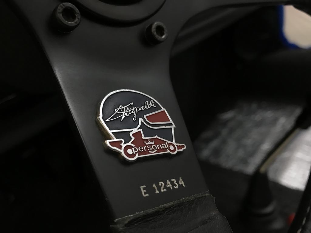

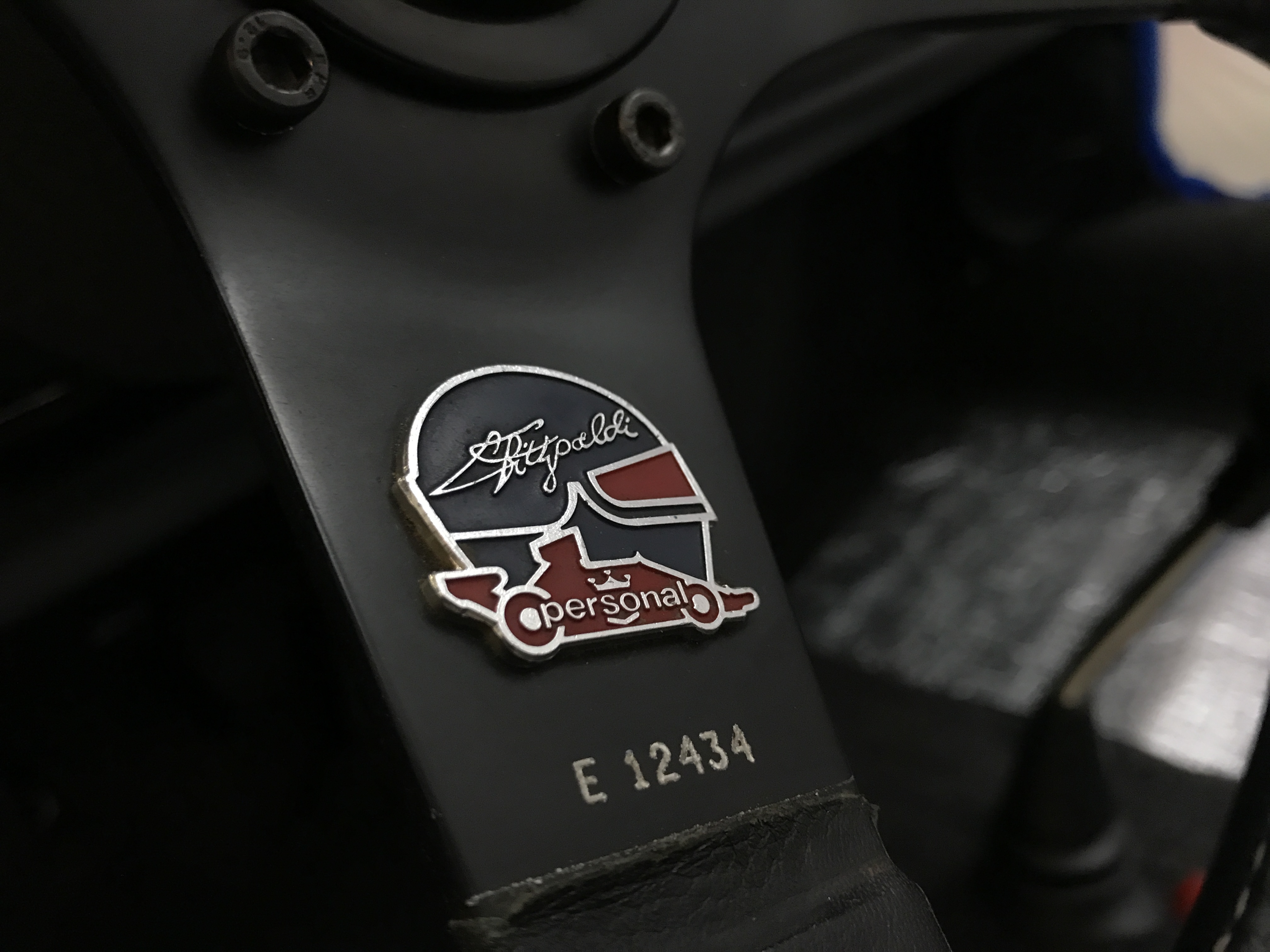

Wow man that is looking great. Is that an Emerson fitipaldi steering wheel??
Garland
post Jul 2 2017, 04:44 PM
Post #143
Restoration Fanatic
Posts: 1,438
Joined: 8-January 04
From: ......Michigan......
Member No.: 1,535
QUOTE(Curbandgutter @ Jun 29 2017, 10:23 PM) *
Yes it is, had it for many years

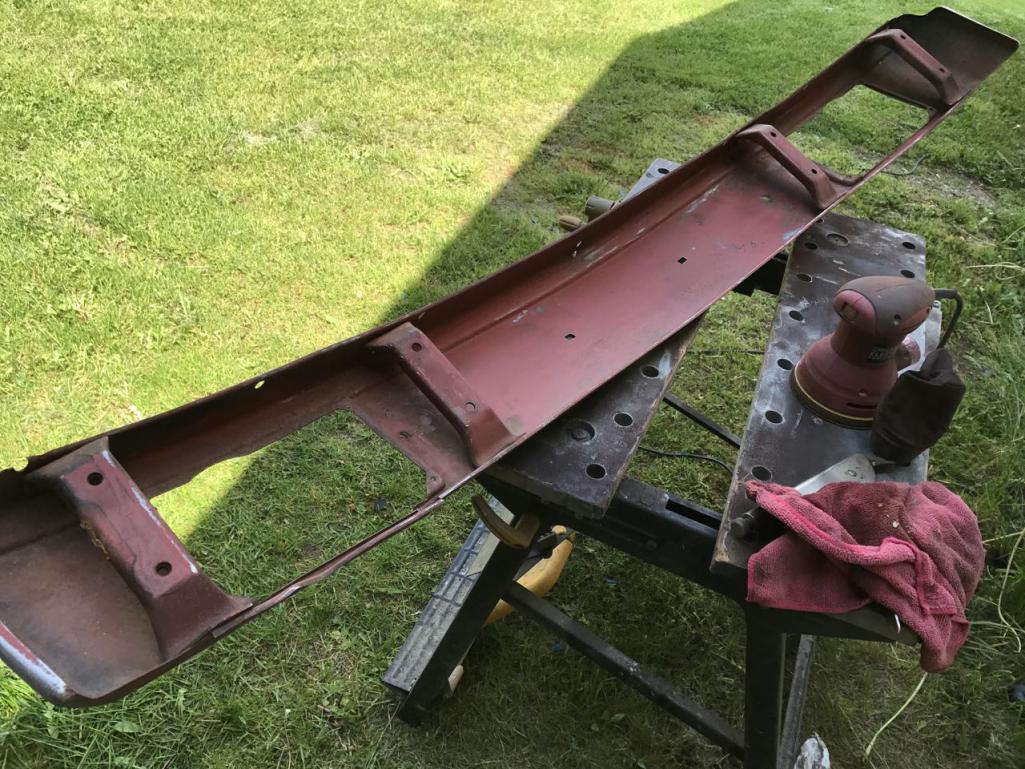

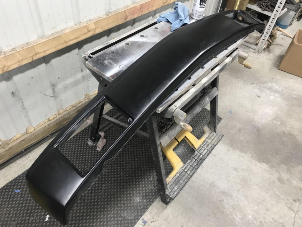

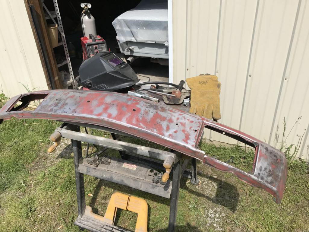

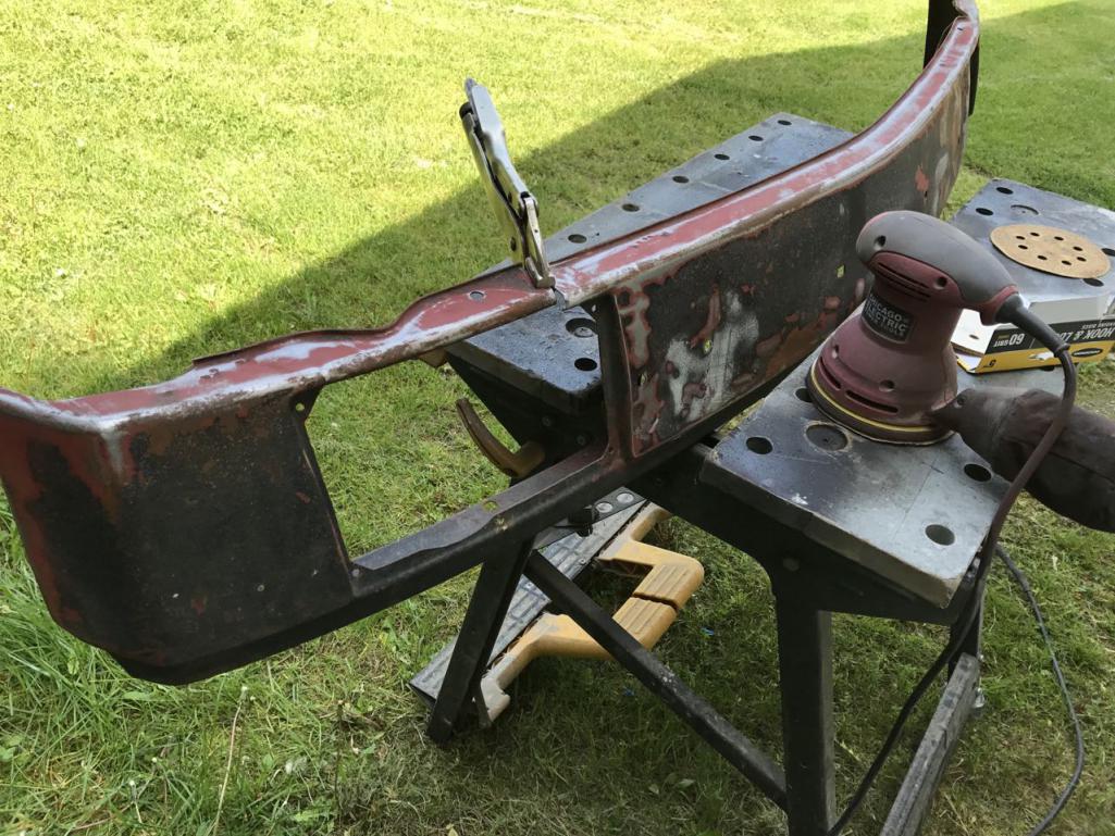

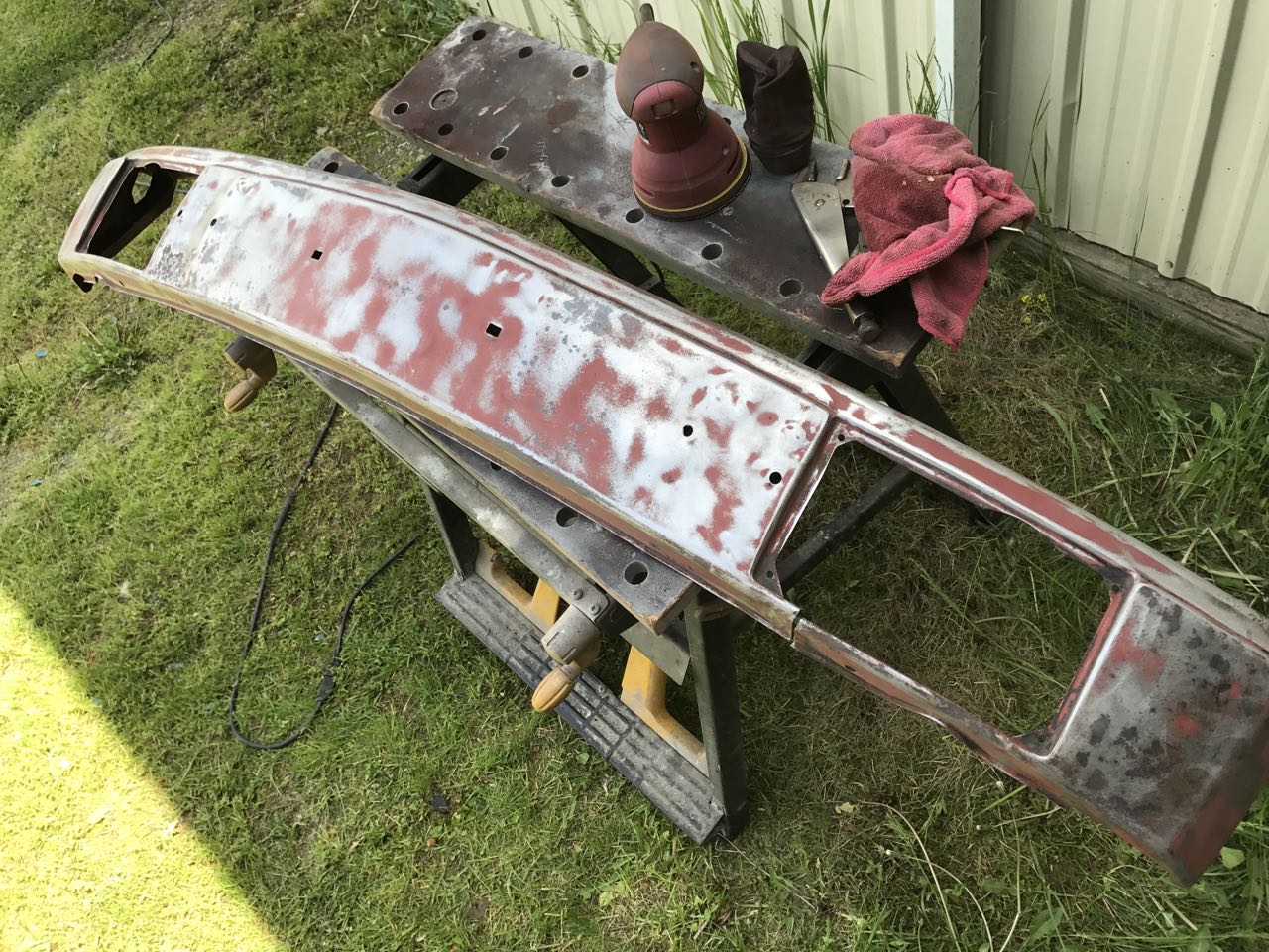

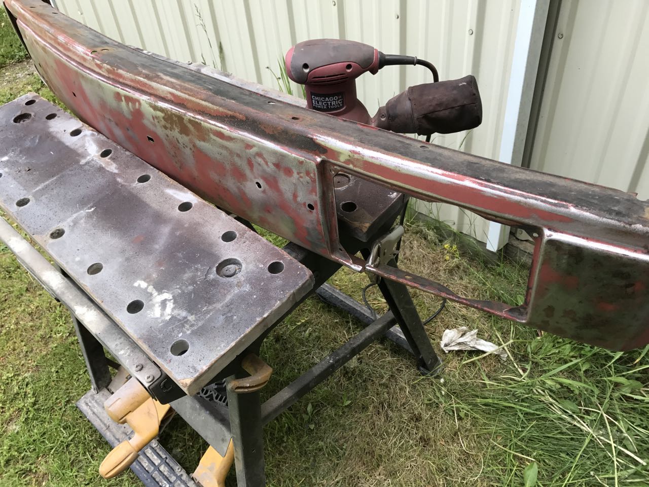

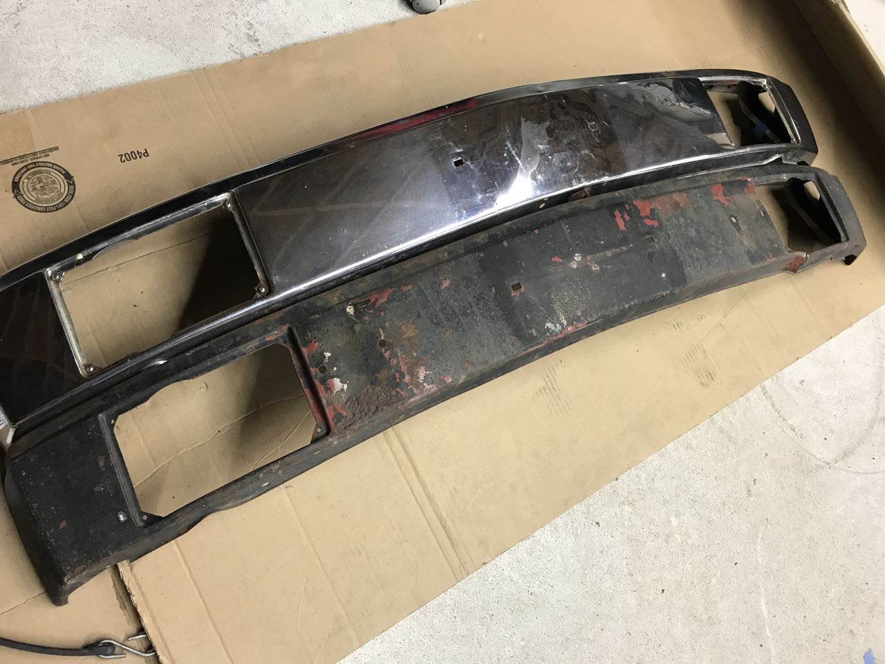

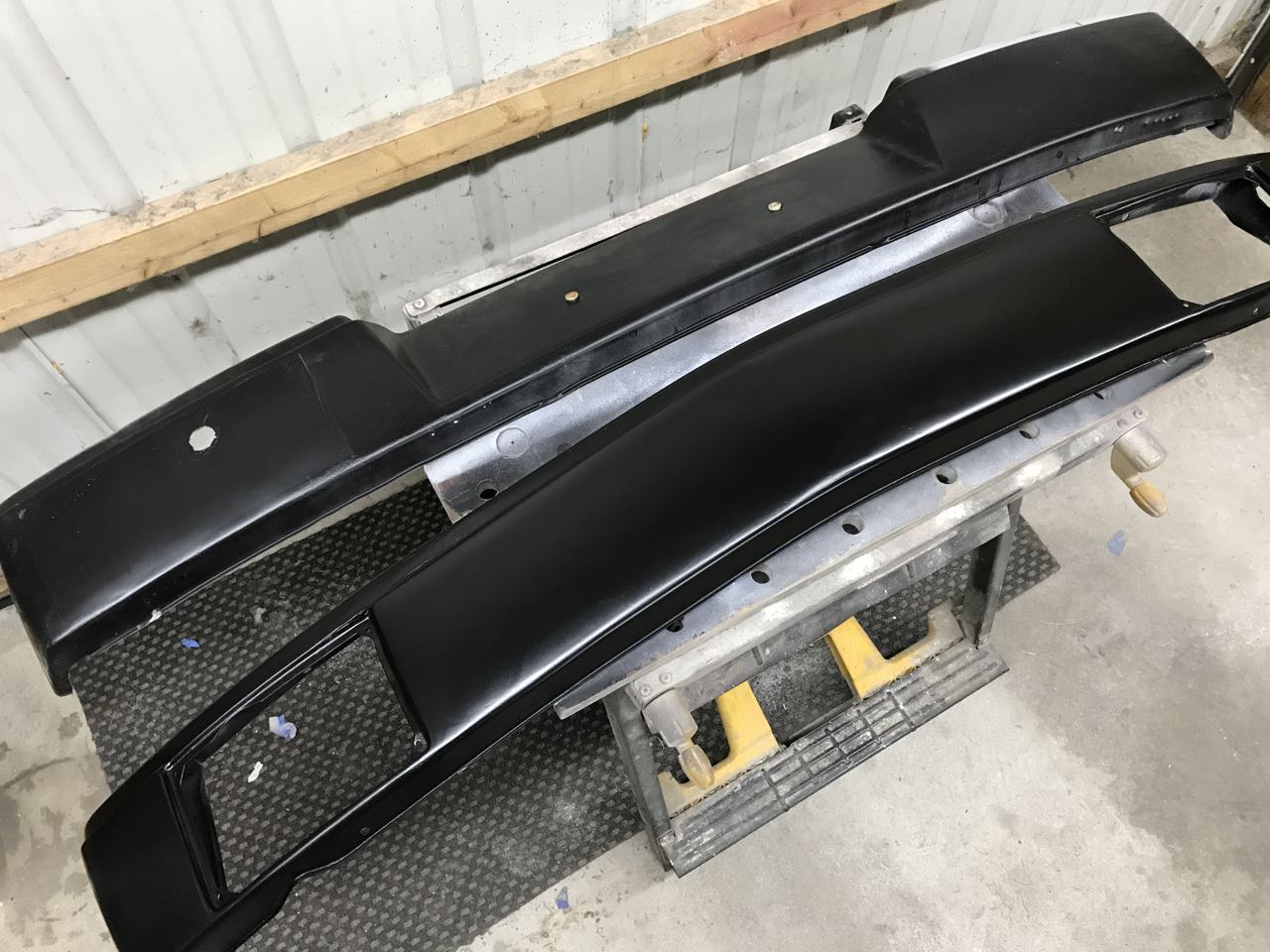

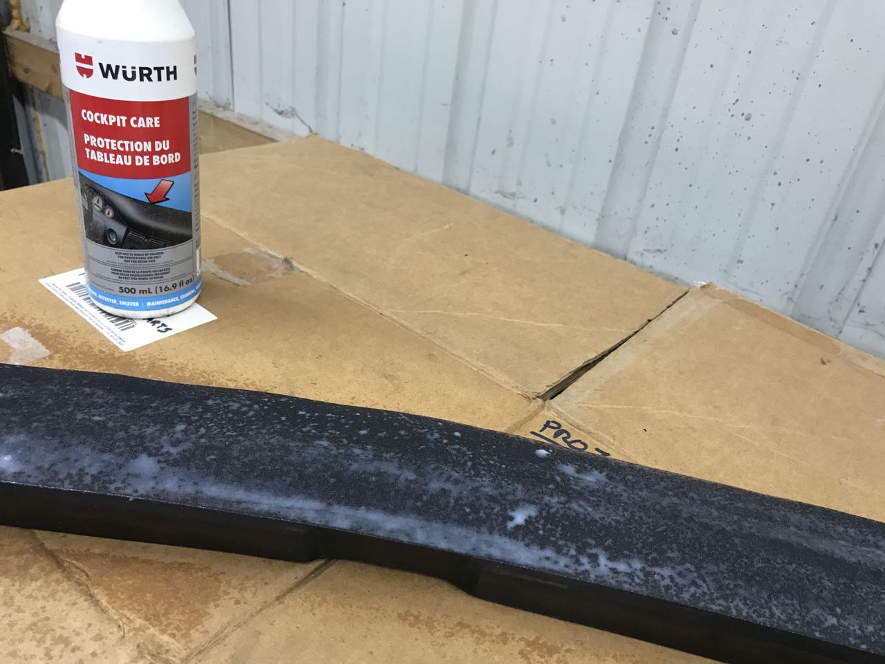

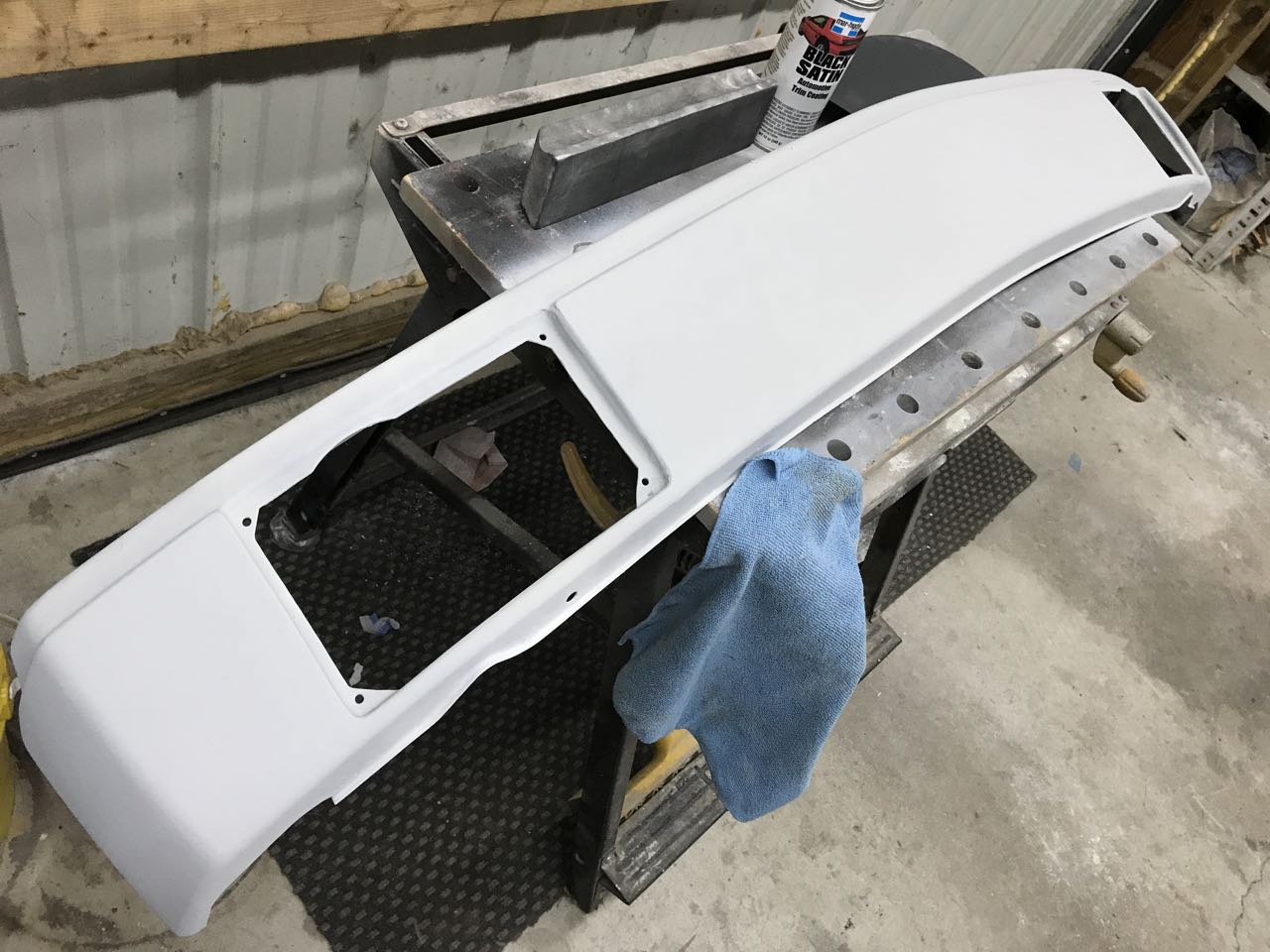

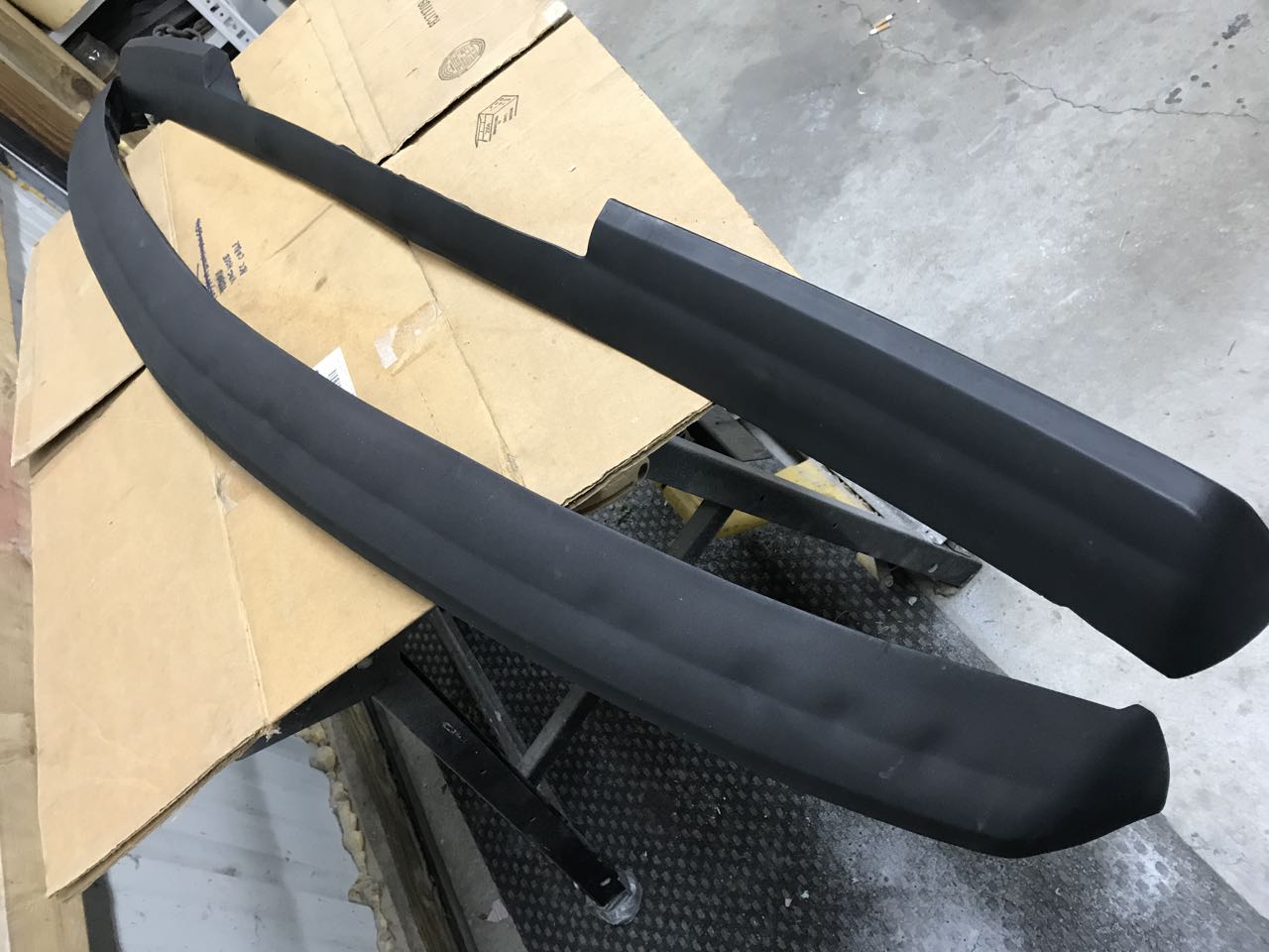

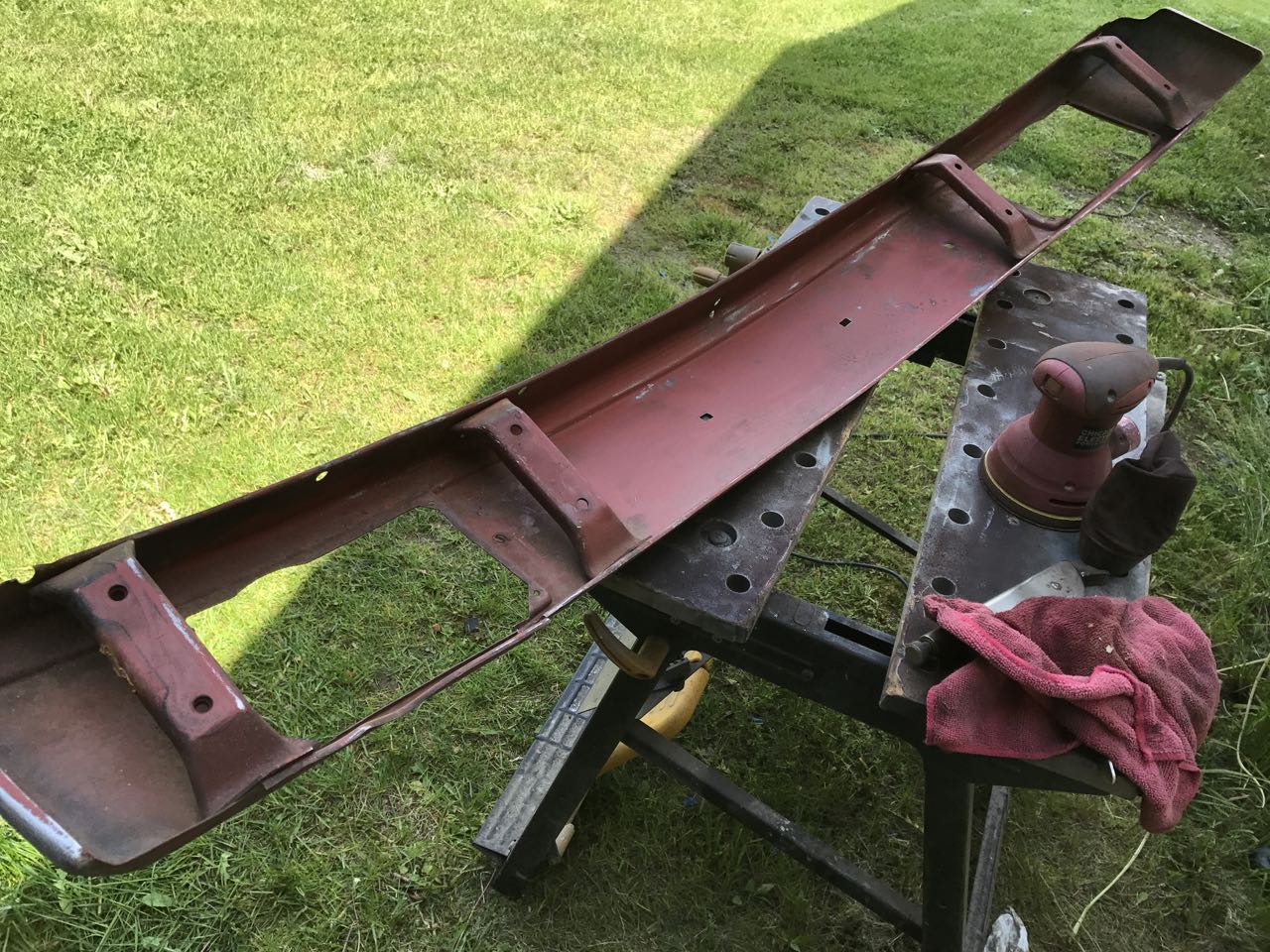

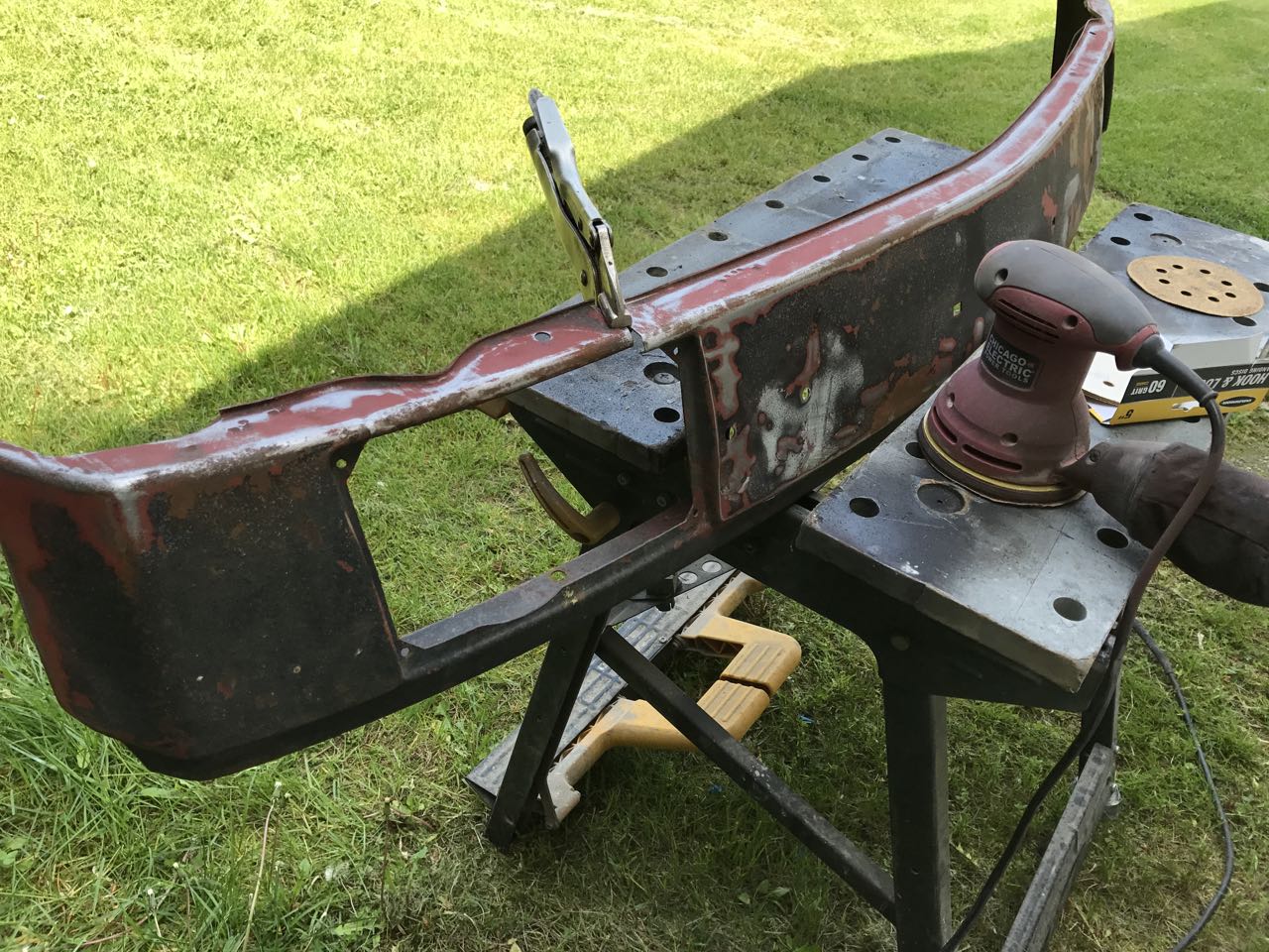

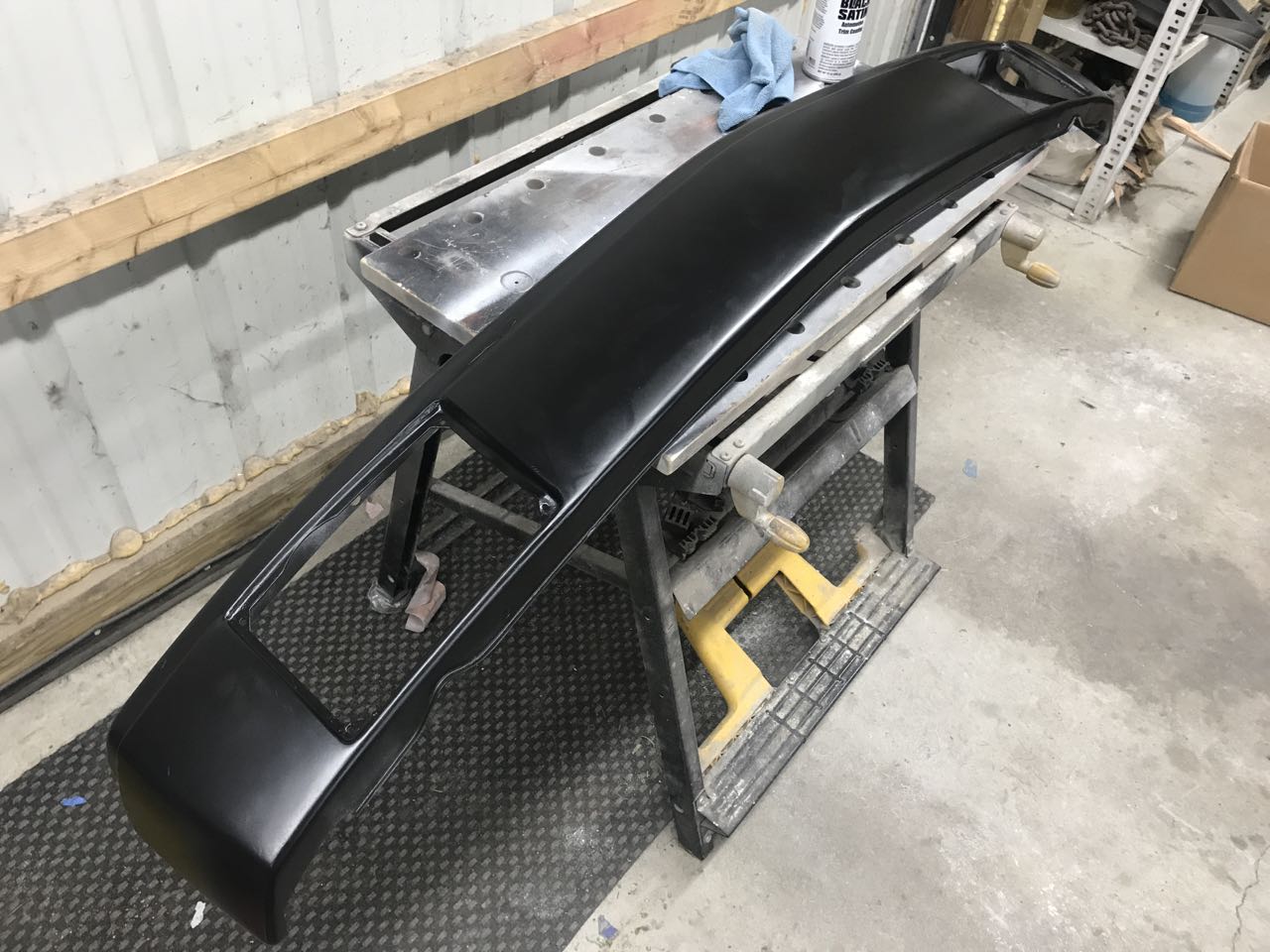

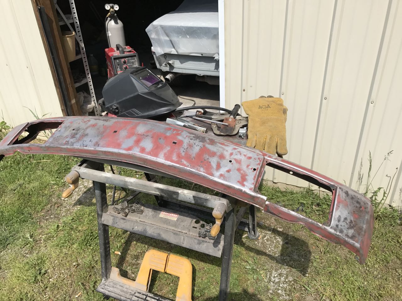

Been busy, retouched the rear bumper. Saved a old front bumper.

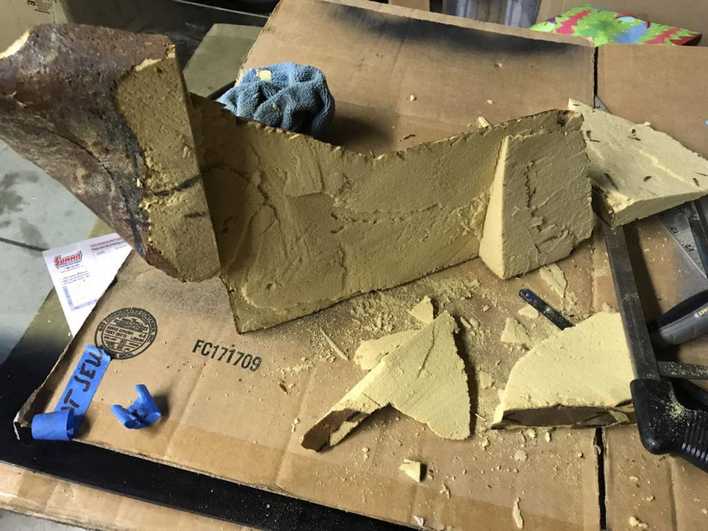

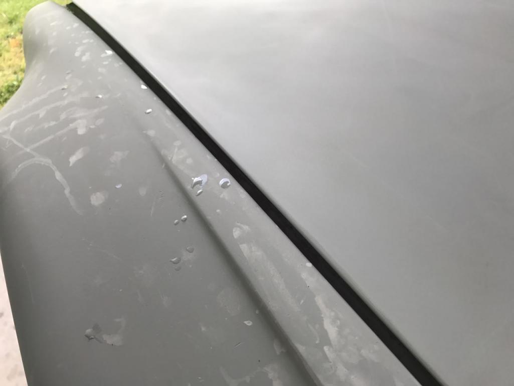

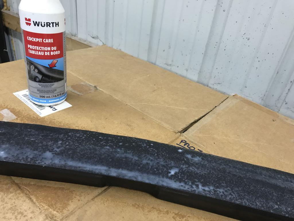

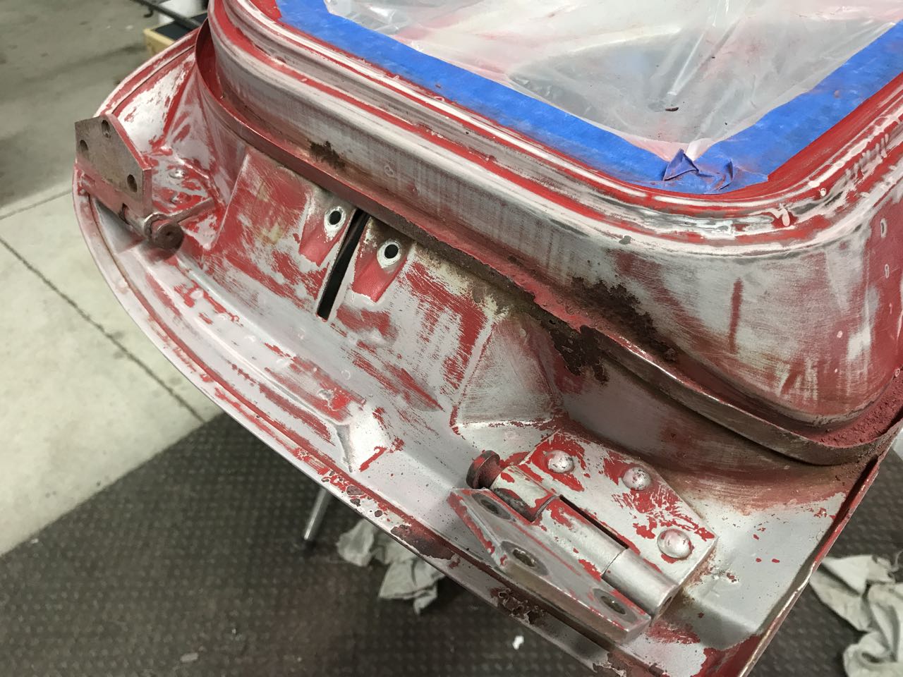

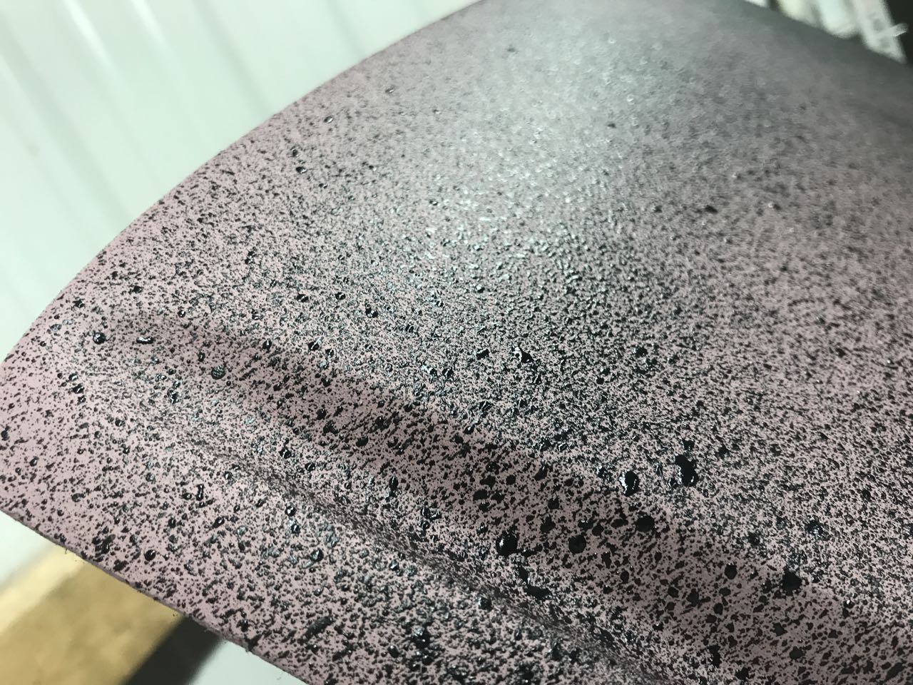

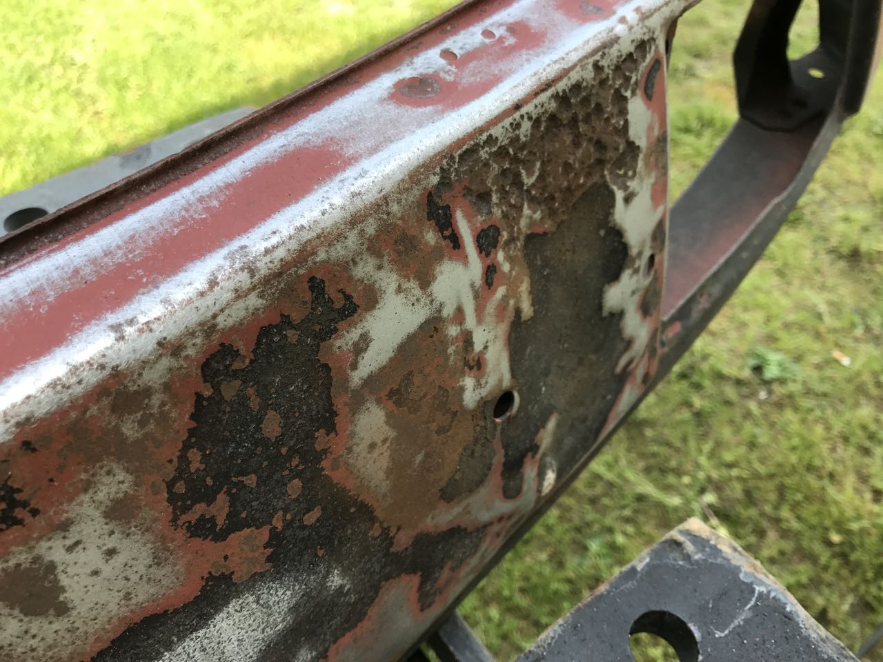

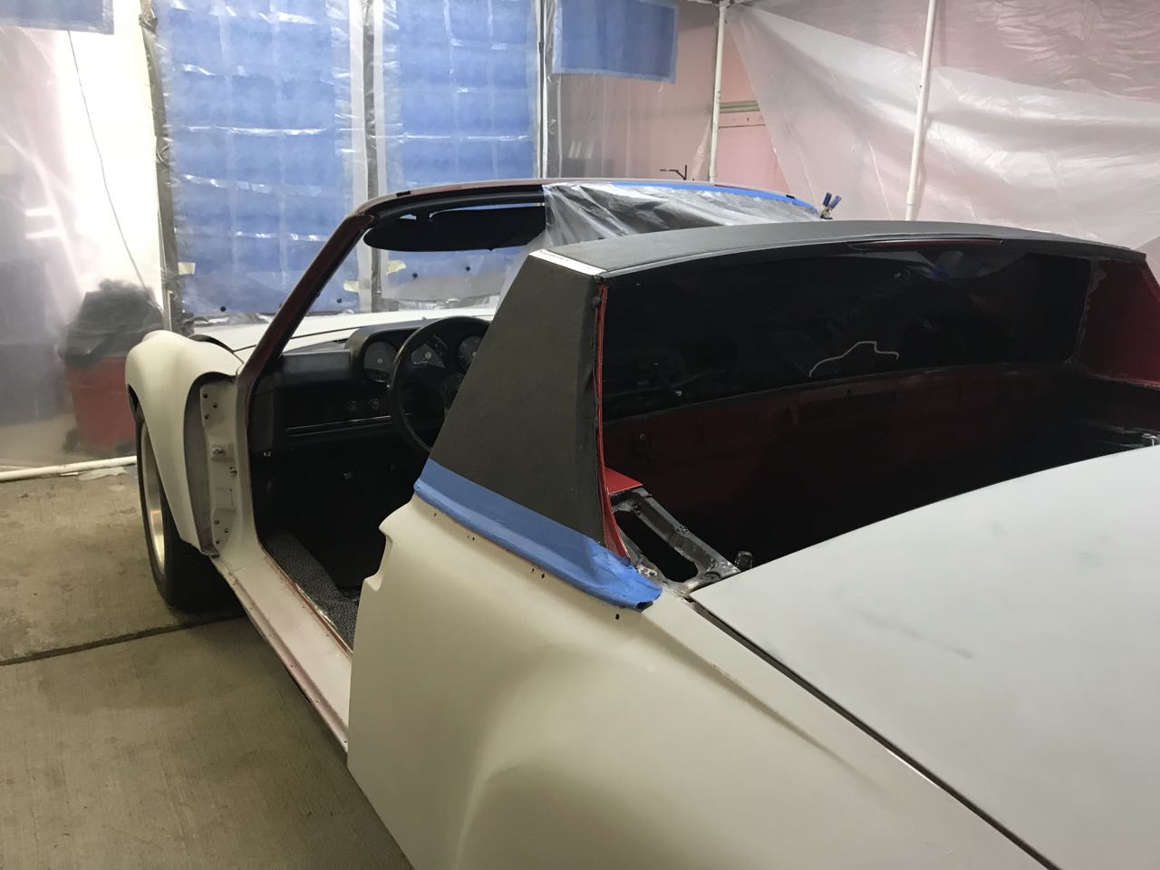

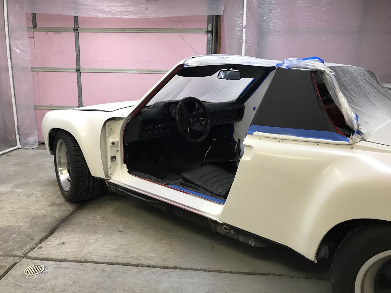

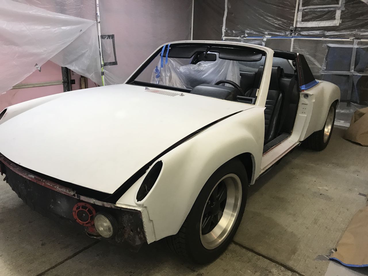

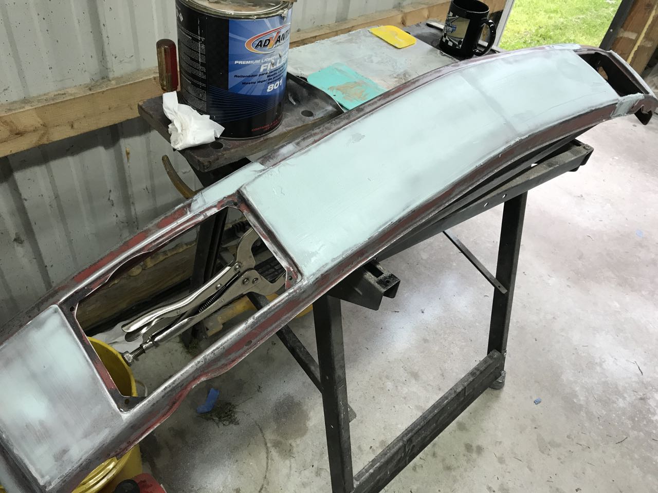

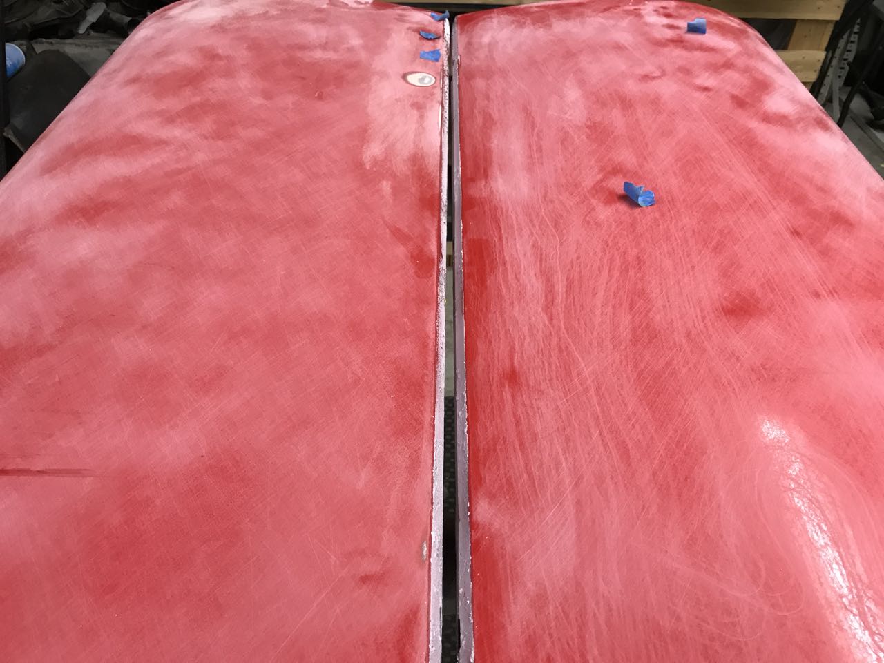

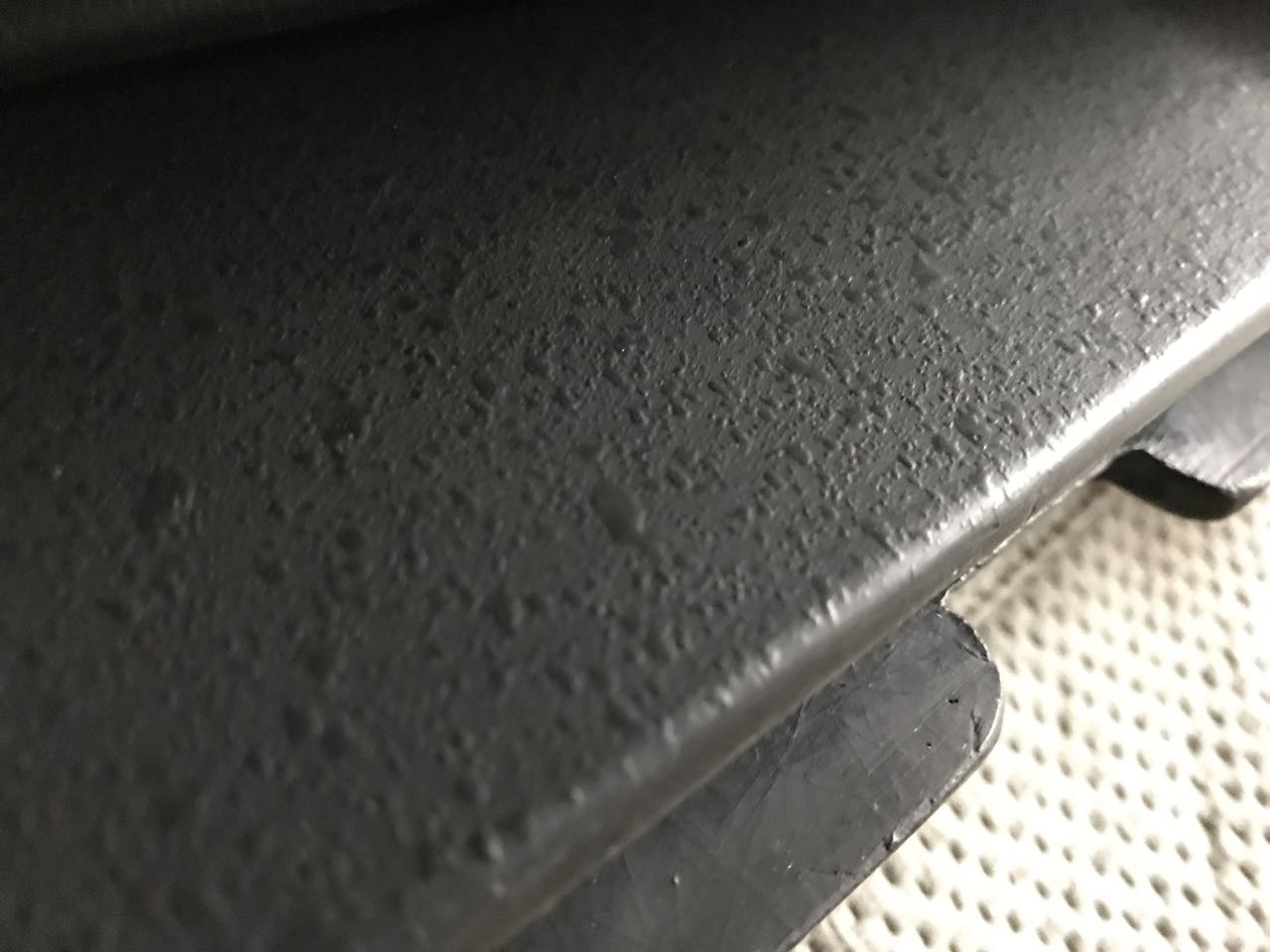

After the Plasti-Dip came off, I reworked the body work, from 40 footer, to 10 footer.

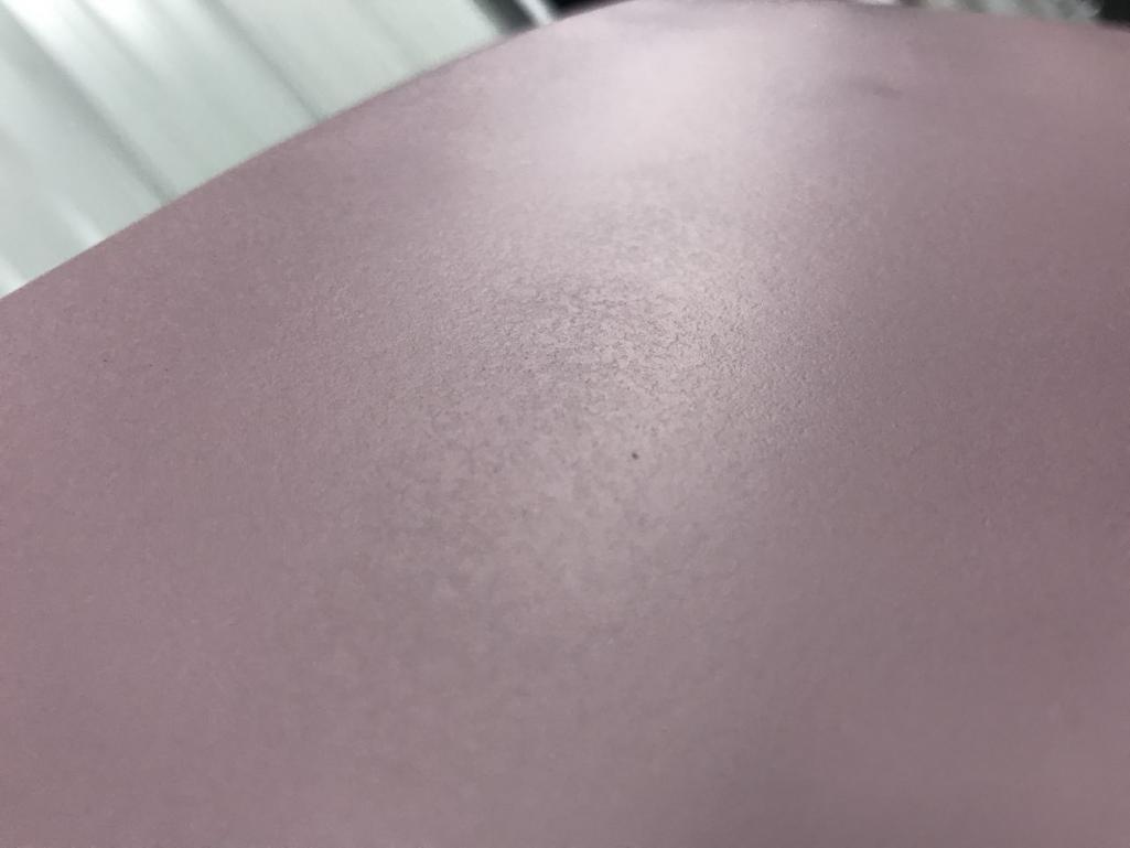

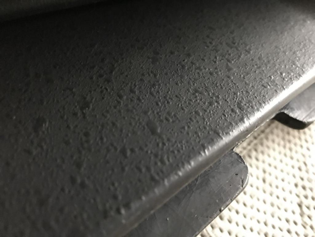

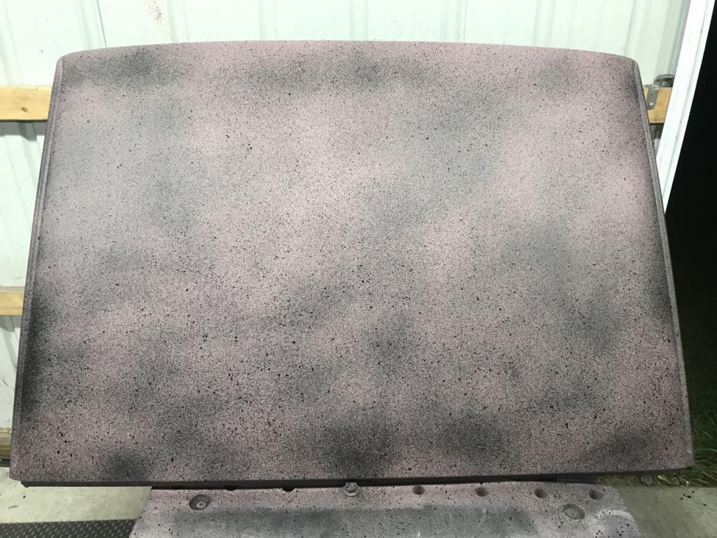

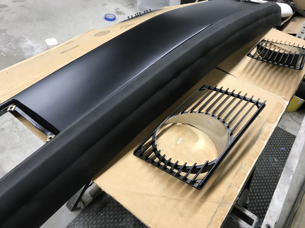

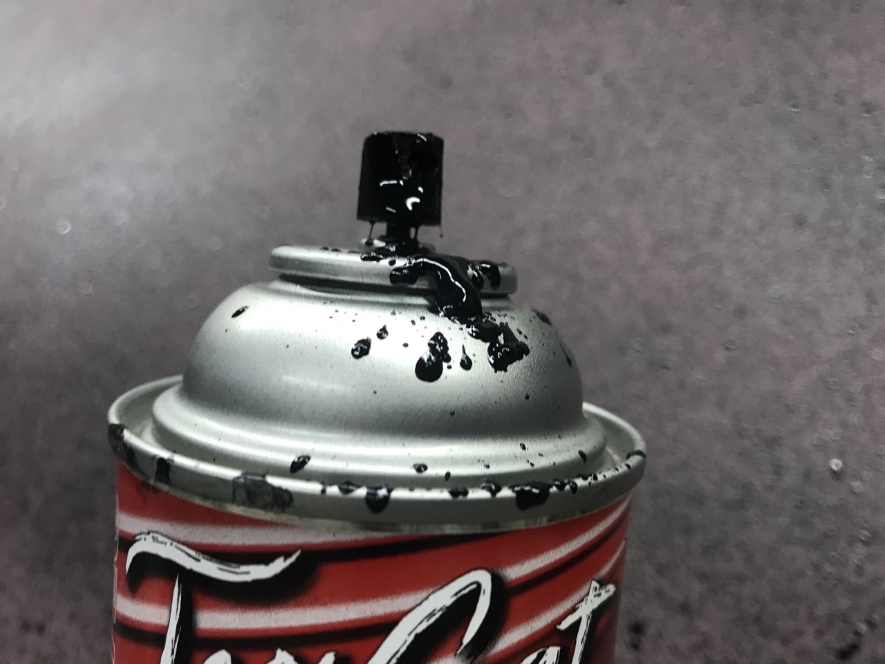

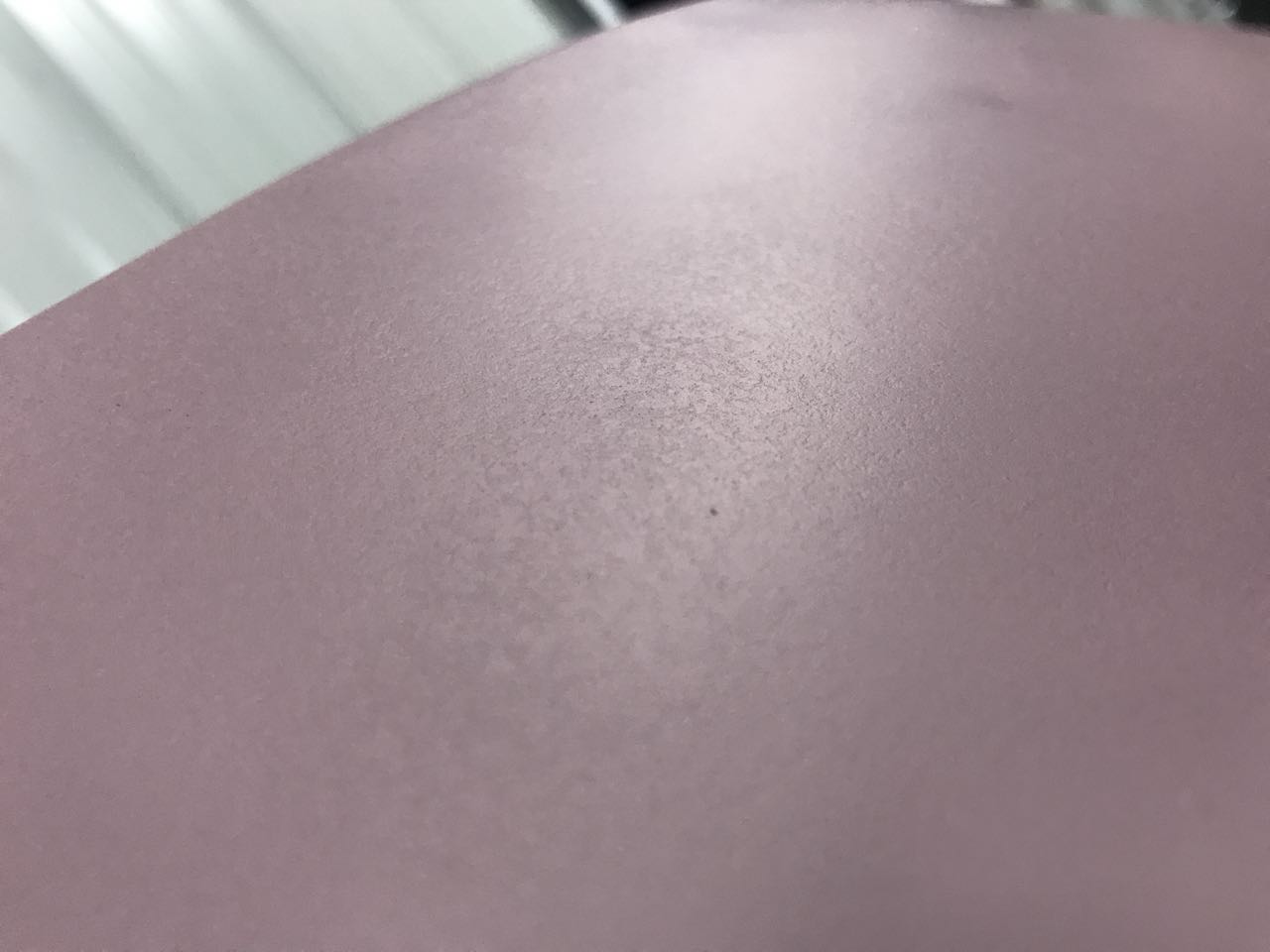

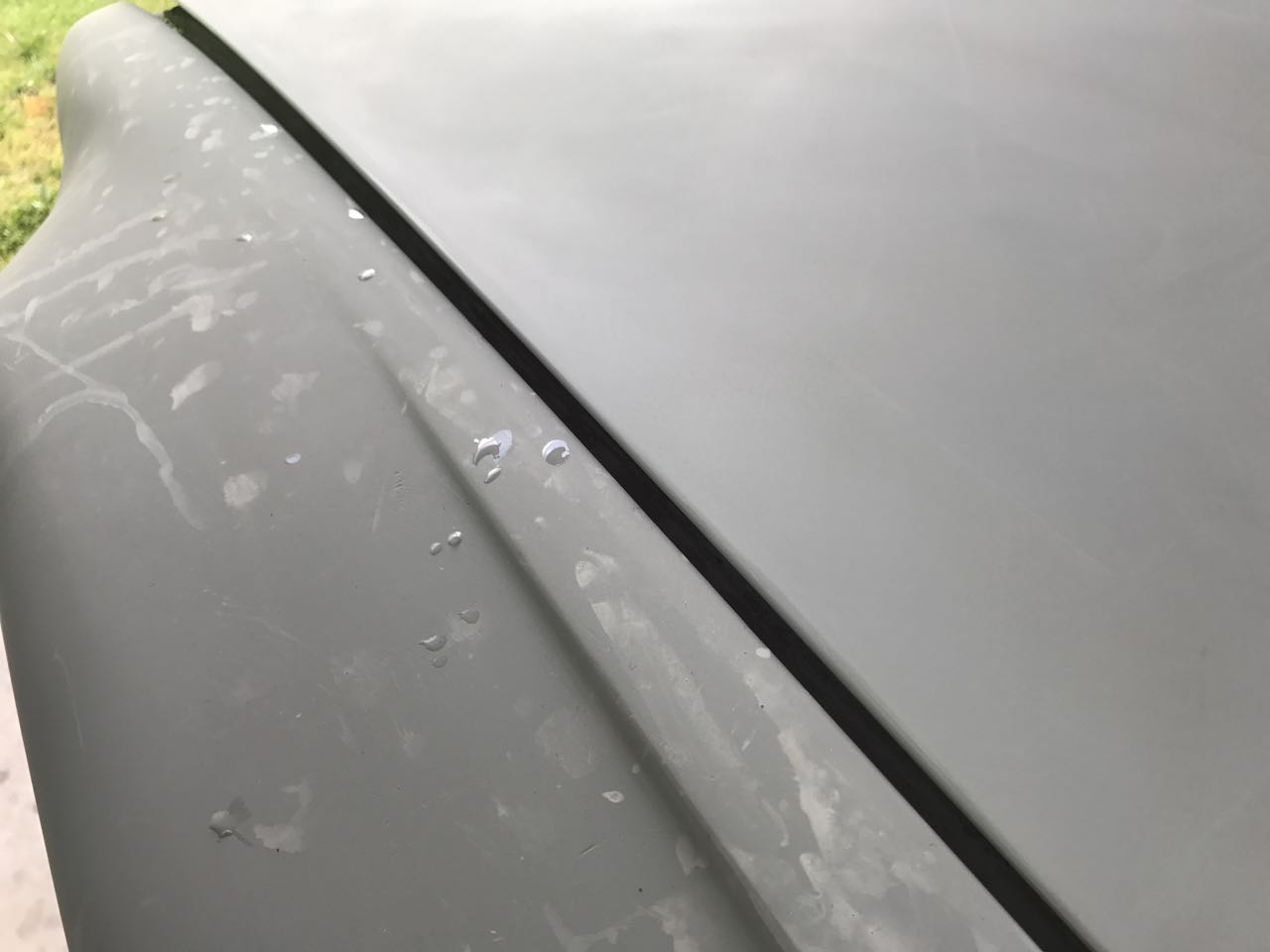

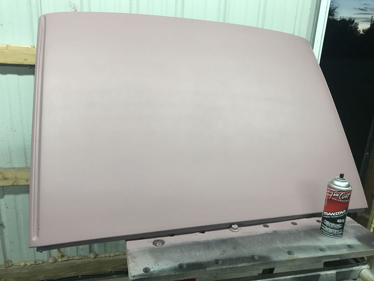

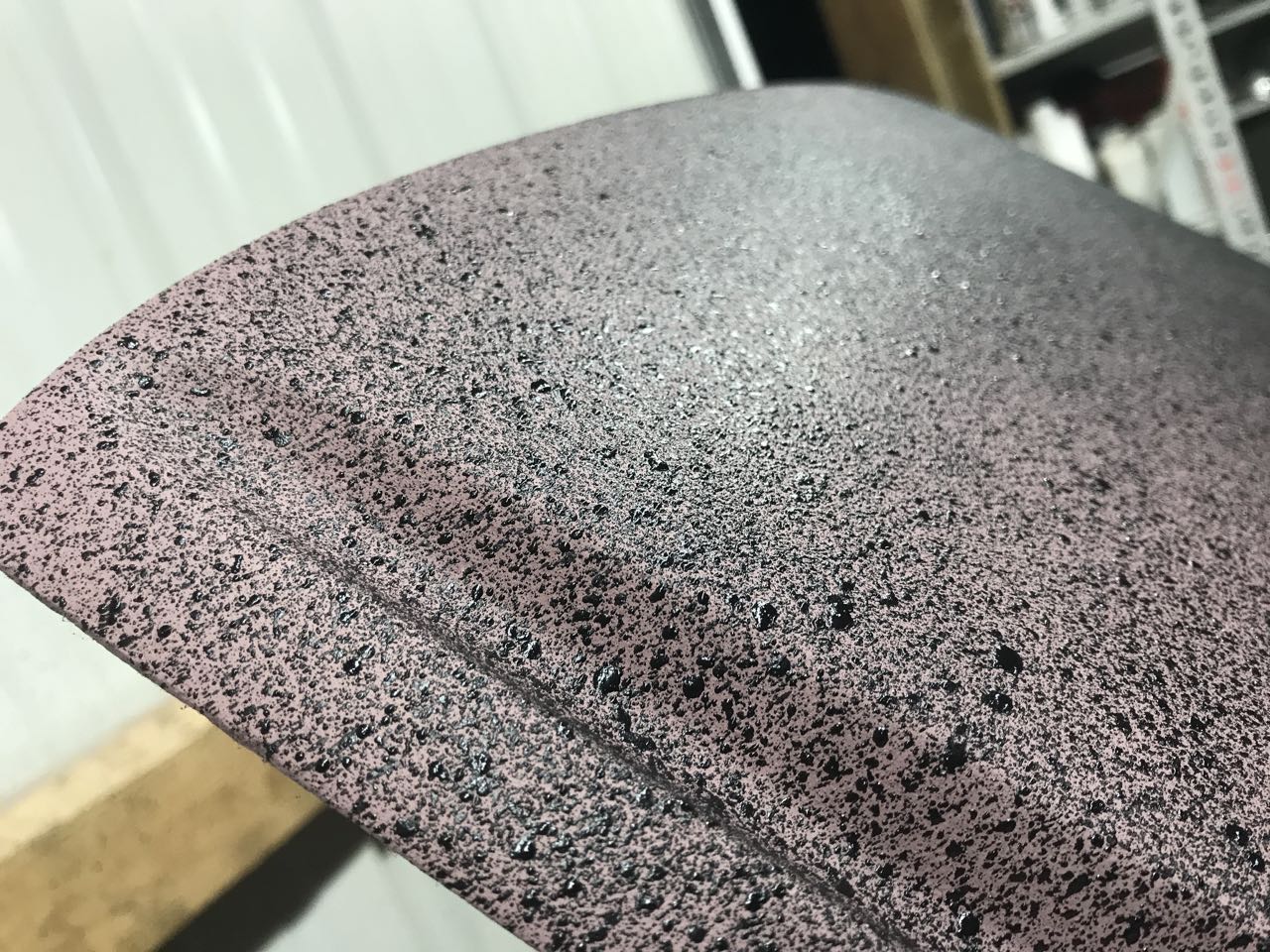

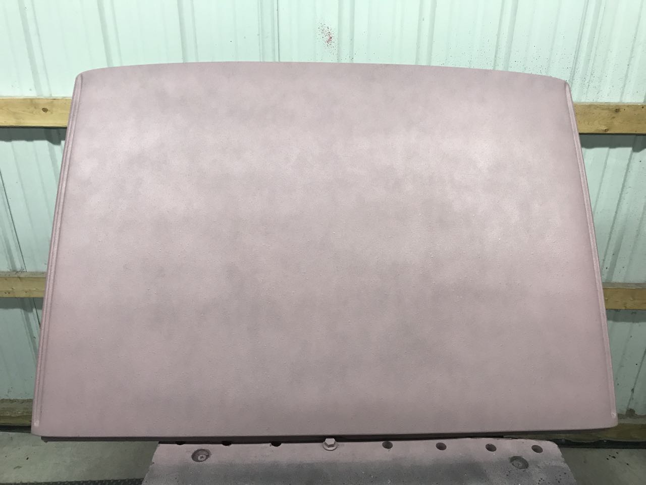

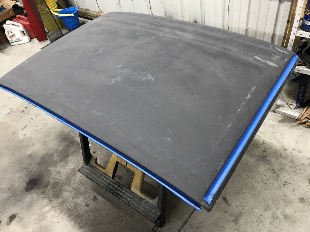

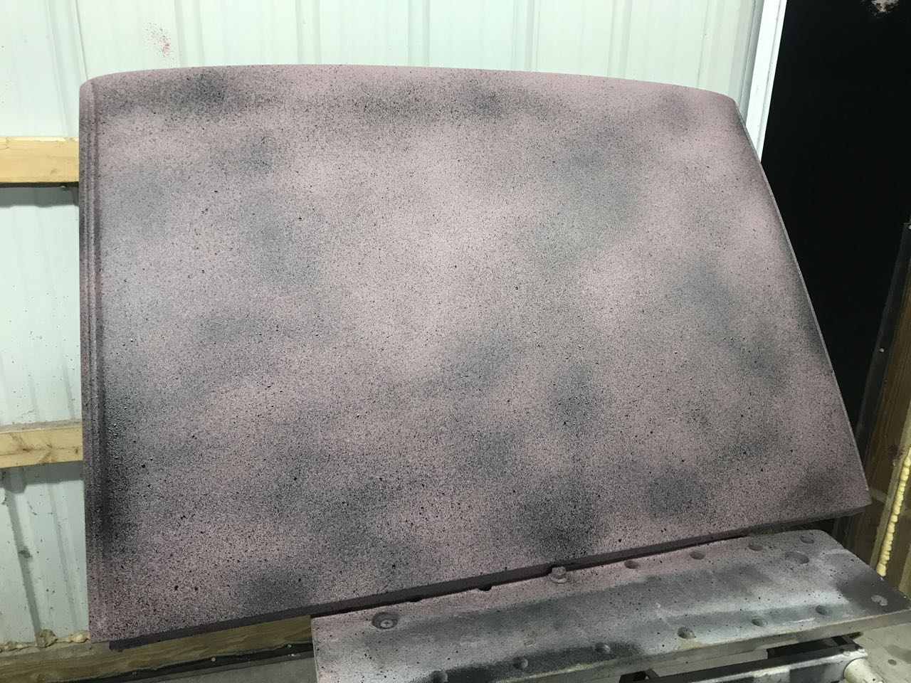

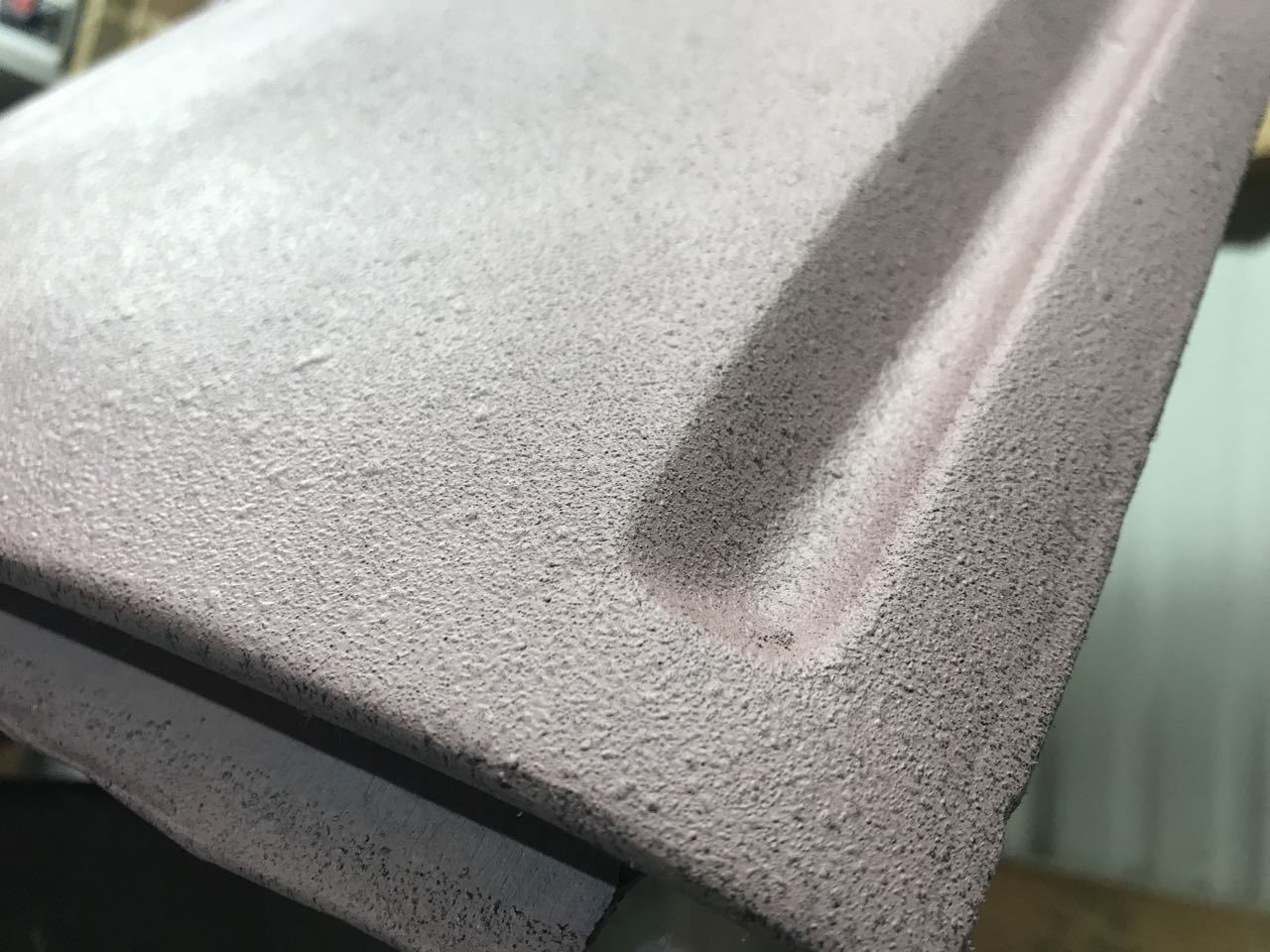

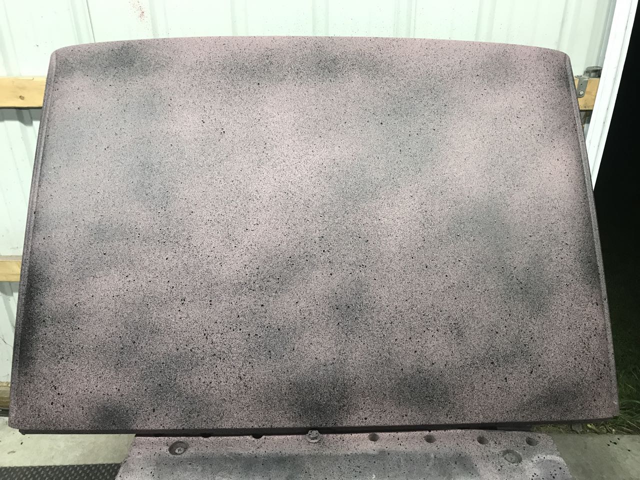

Wanted to try a sand and paint of the top. I sanded it smooth, then sprayed texture coat to get the look. I think it came out well.
Black picture at the end is a original roof finish.

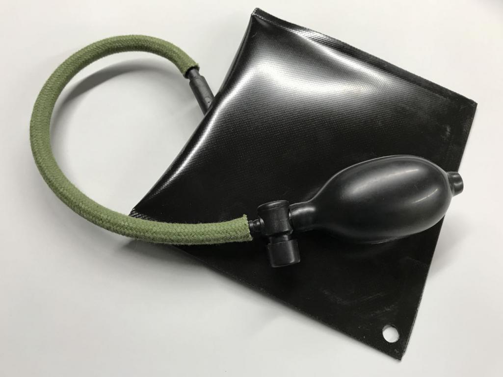

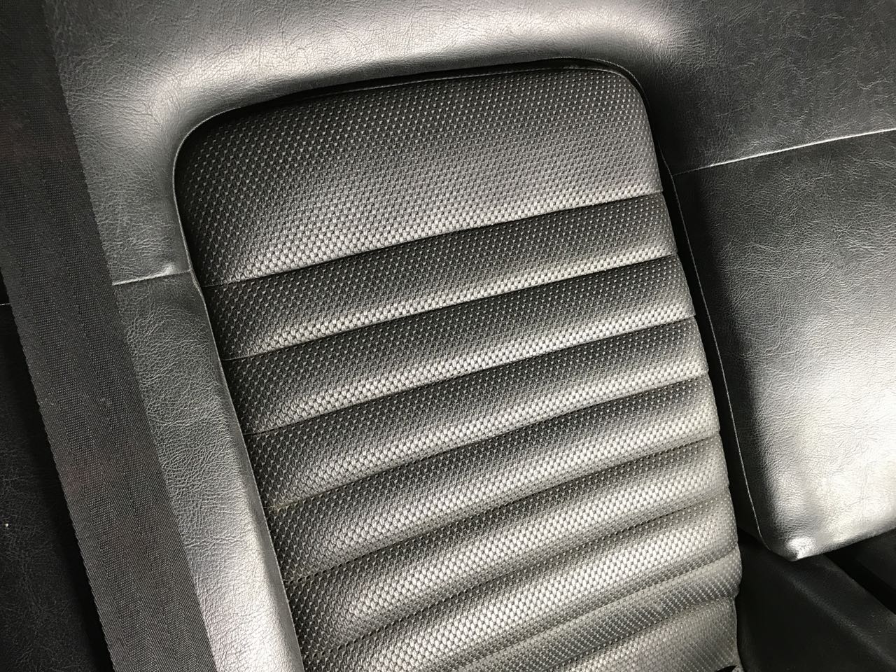

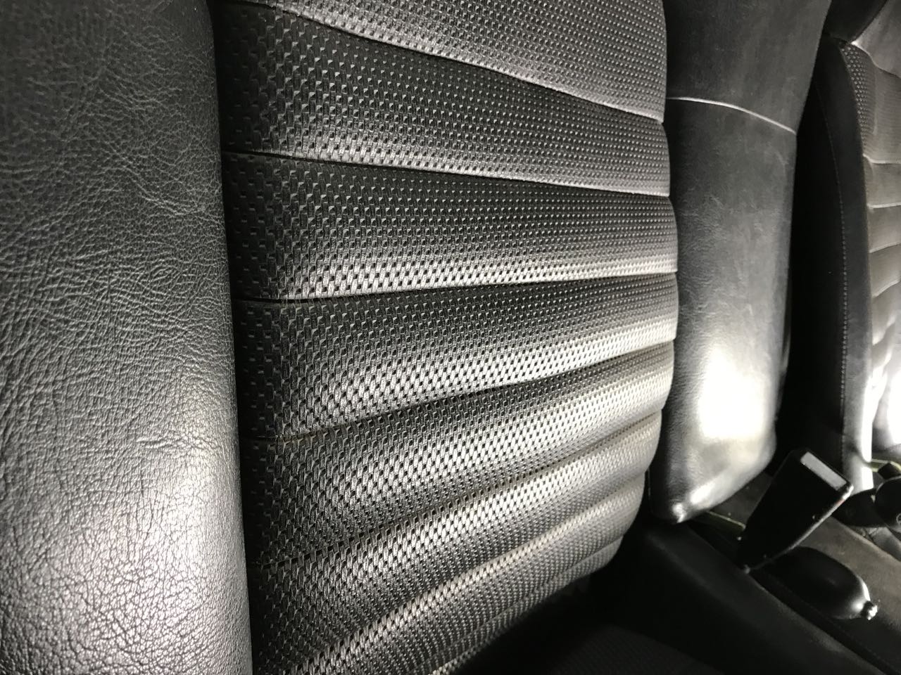

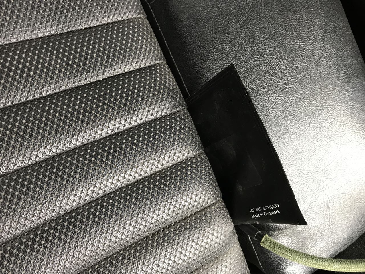

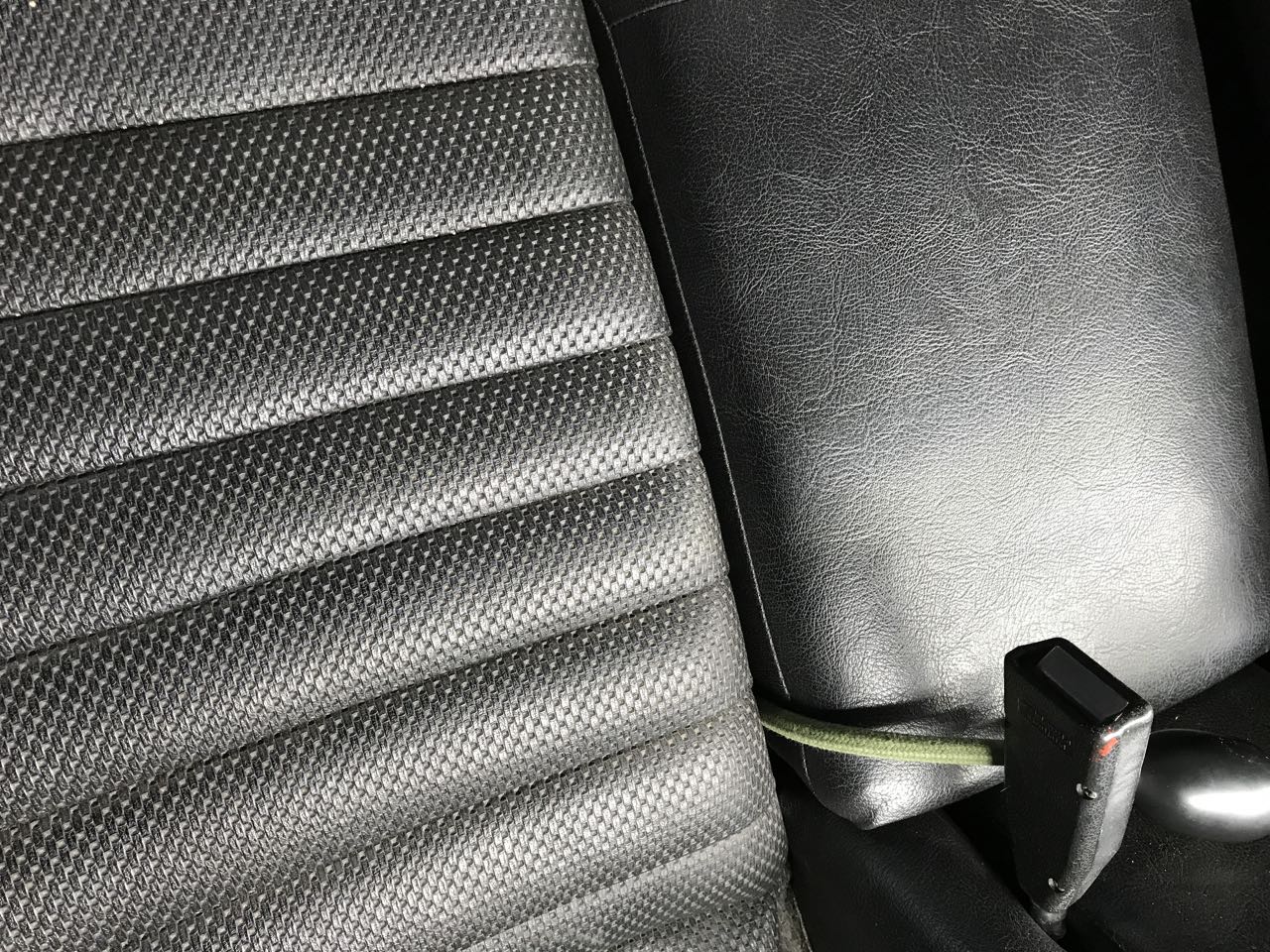

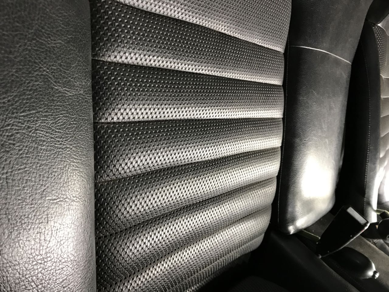

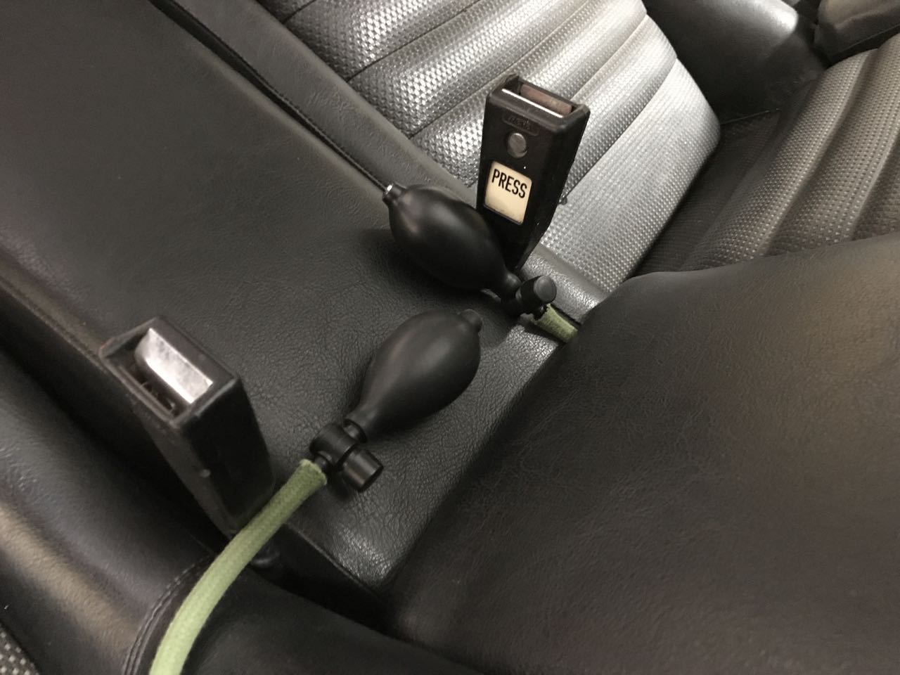

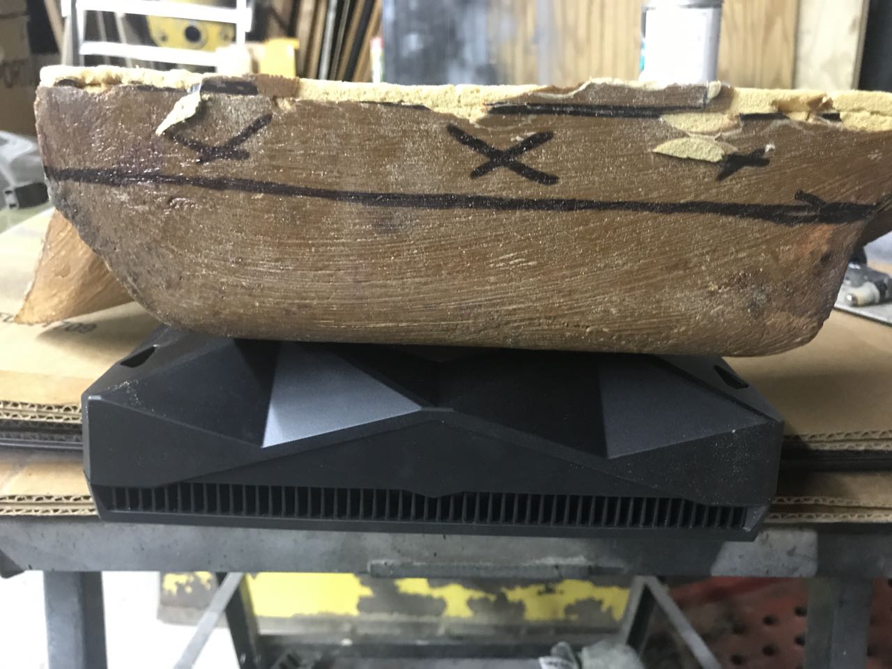

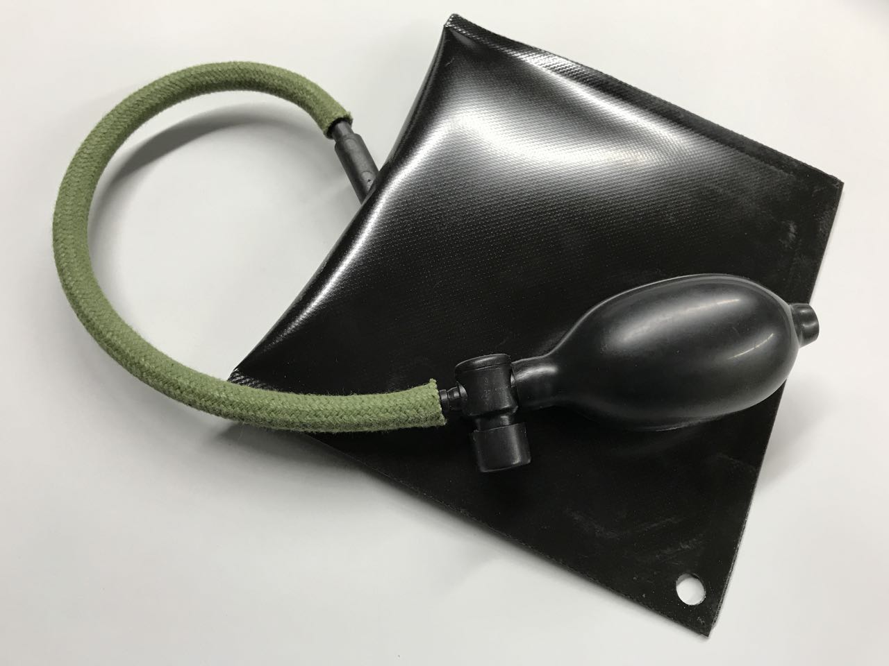

One more comfort item, added seat bolsters for the lower back. Simply install, and they feel great. I did modify the bag a bit with some stock vacuum line to extend the pump.
As you can see these did not start off as bolsters bags. Google for a price.

That's a clever idea...
Garland
post Jul 18 2017, 05:05 PM
Post #150
Restoration Fanatic
Posts: 1,438
Member No.: 1,535
QUOTE(mbseto @ Jul 10 2017, 09:07 AM) *
Thanks, I was thinking they may be to small, but after install, they feel wider and fit well into the small of "my" back

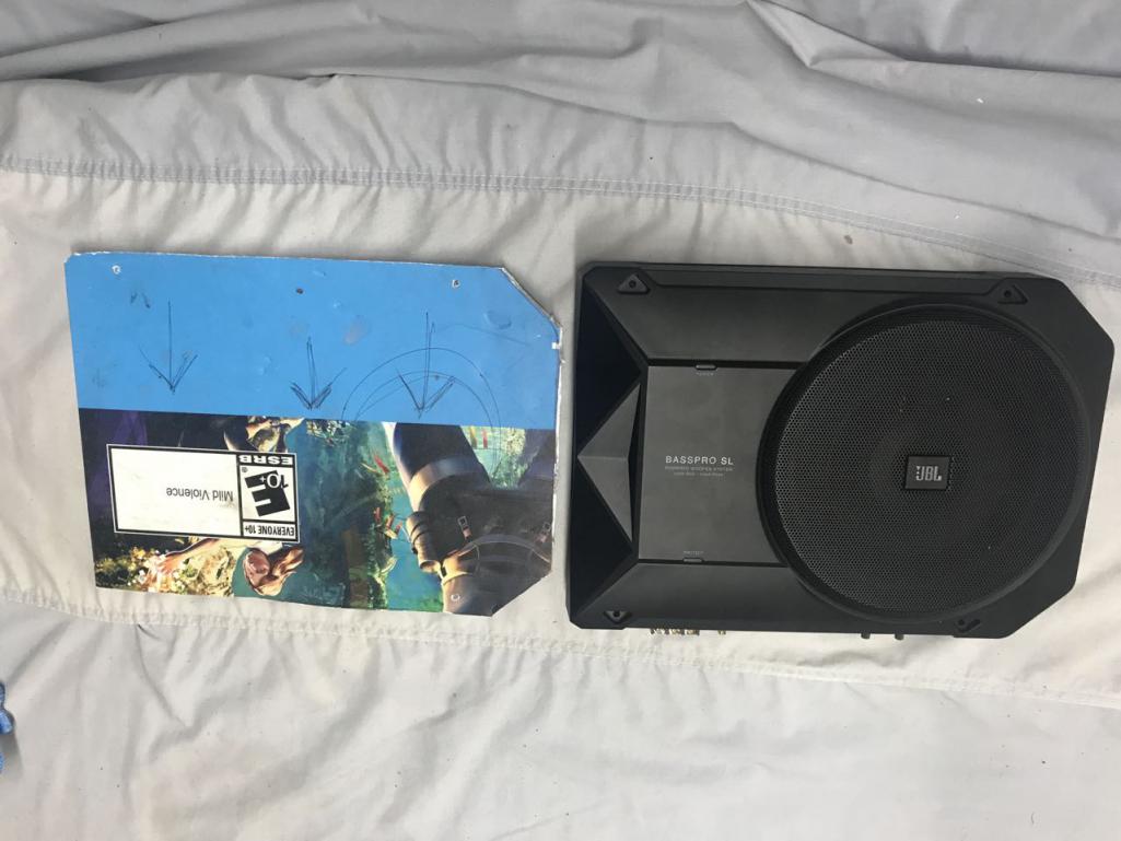

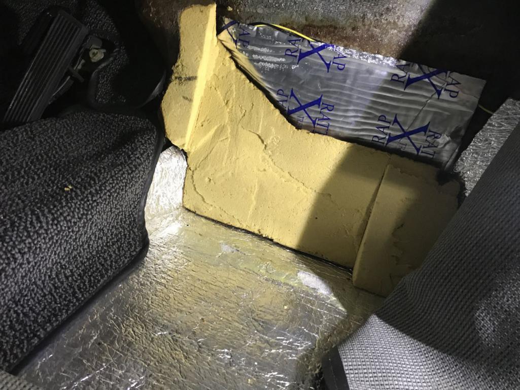

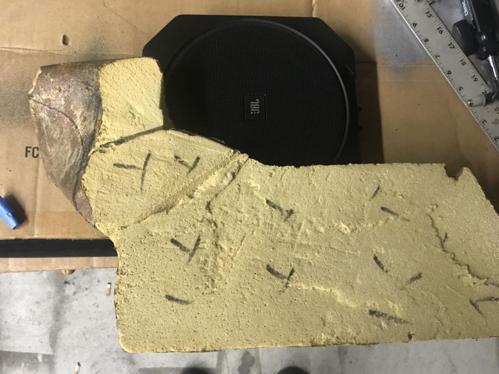

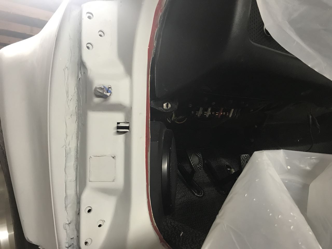

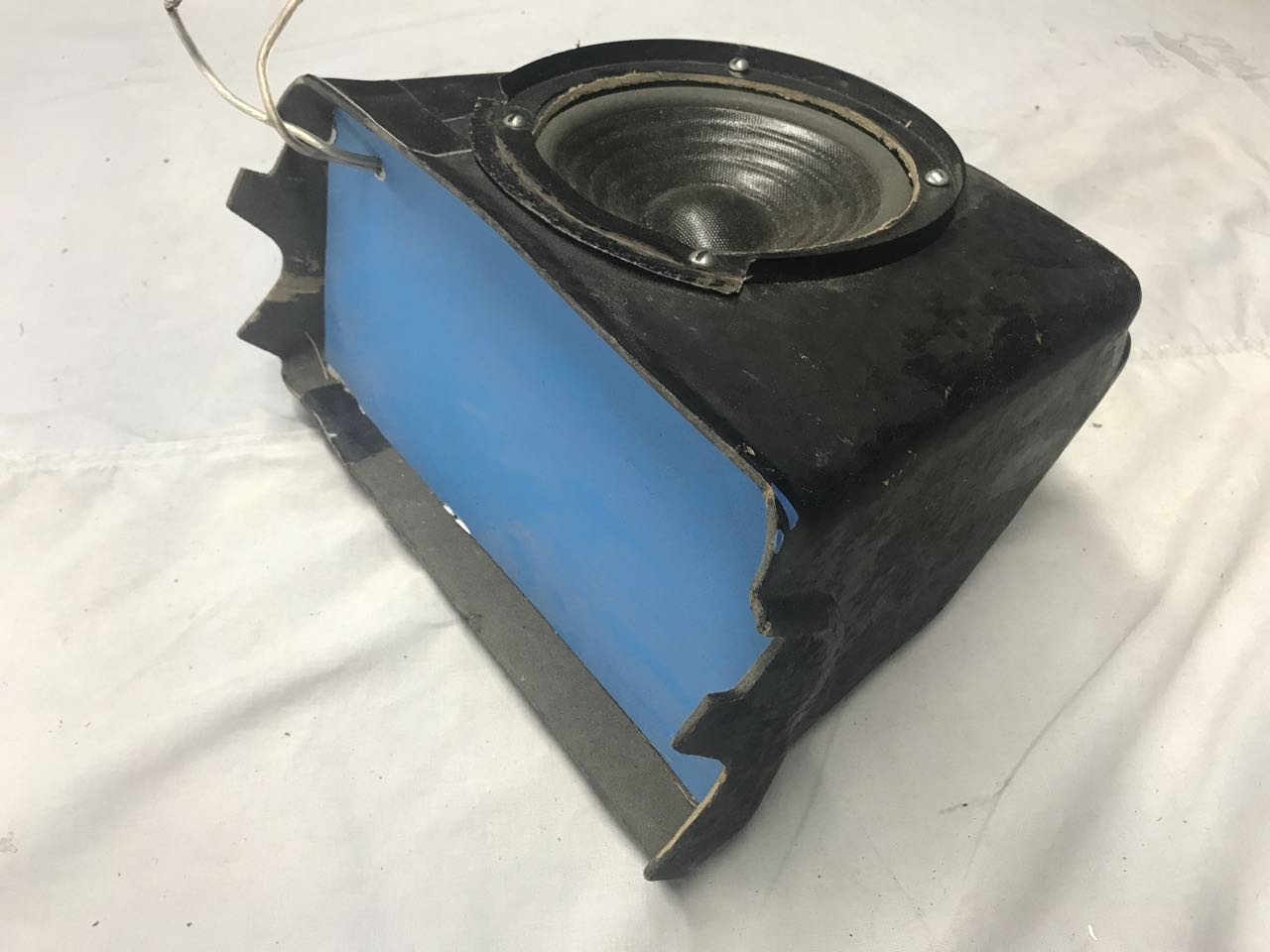

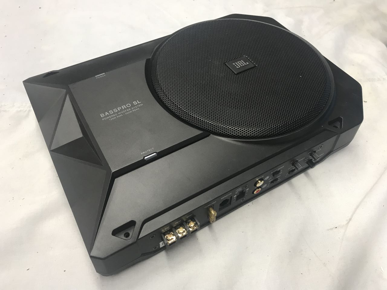

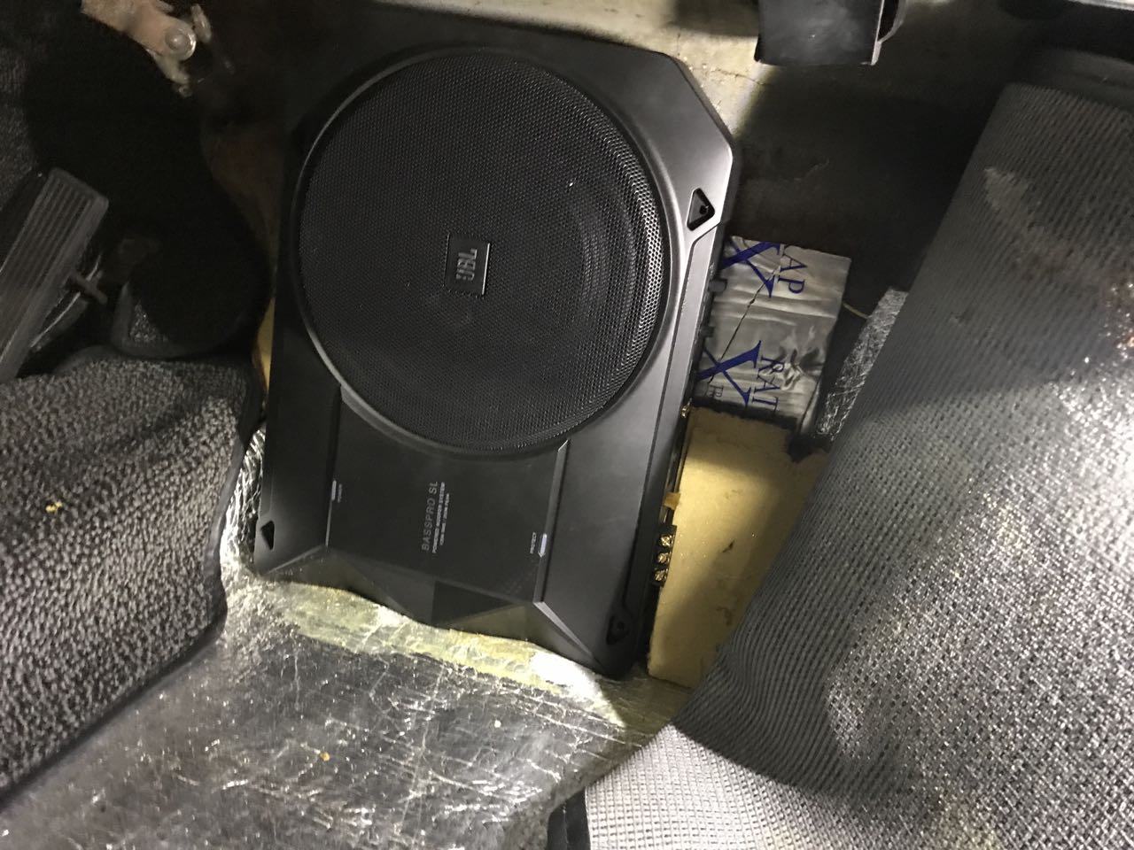

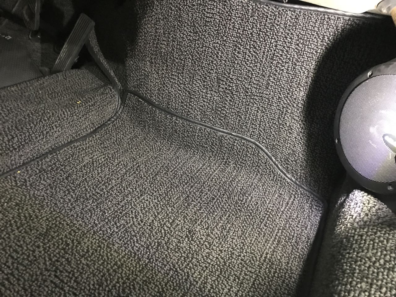

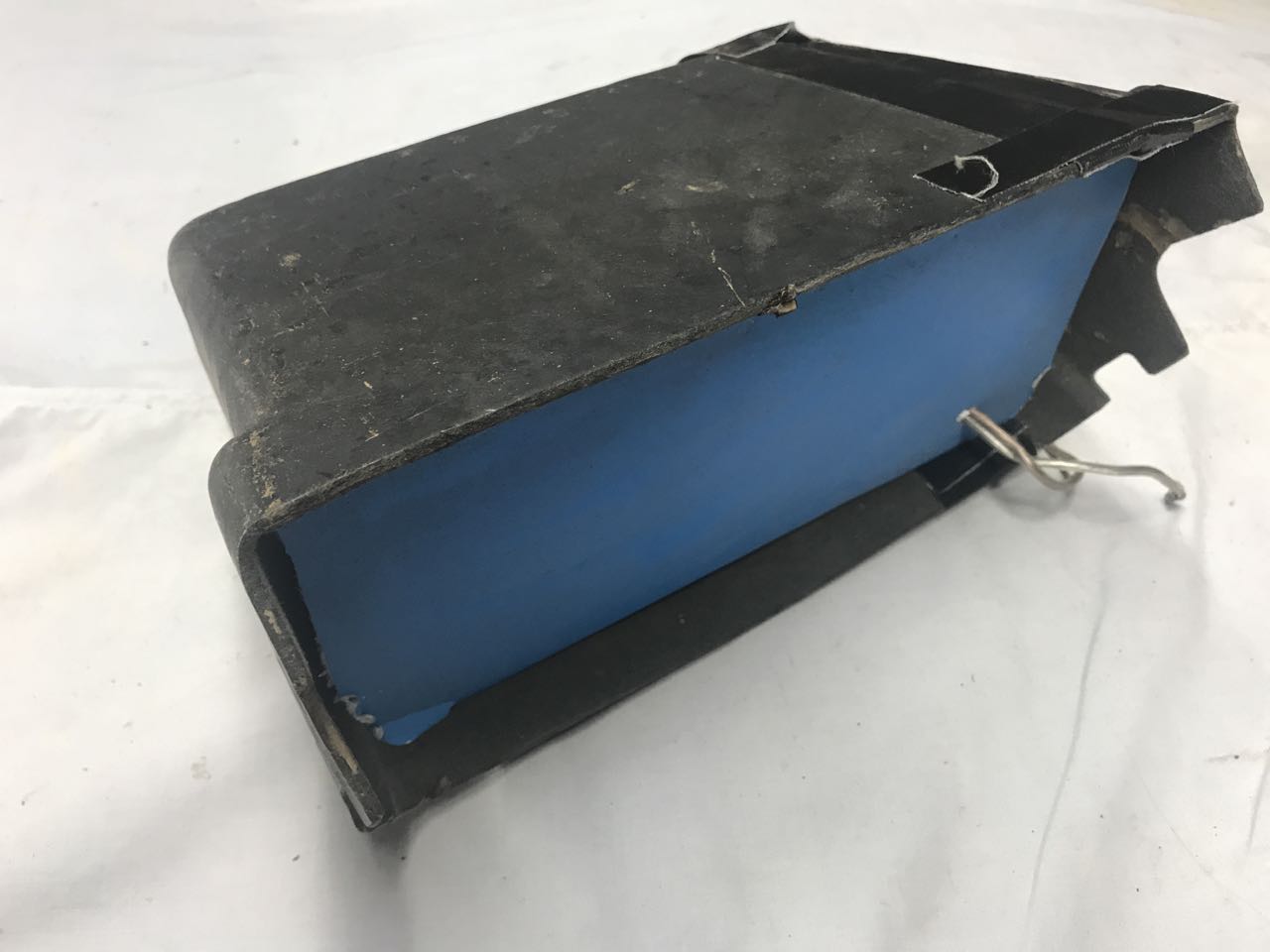

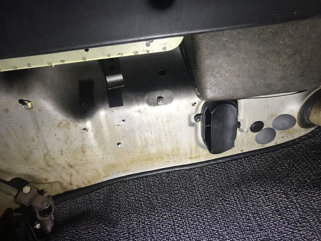

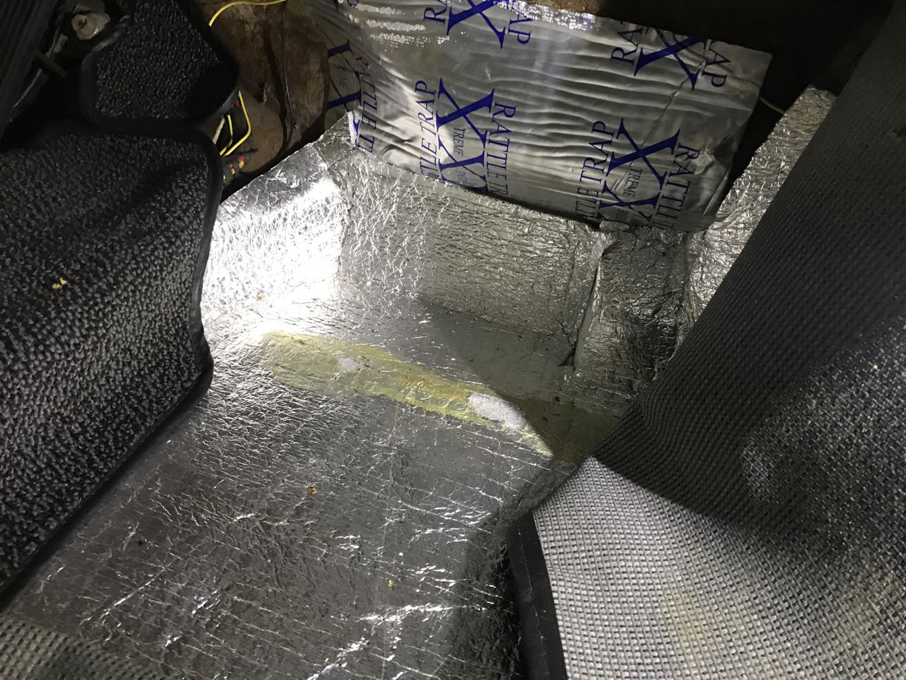

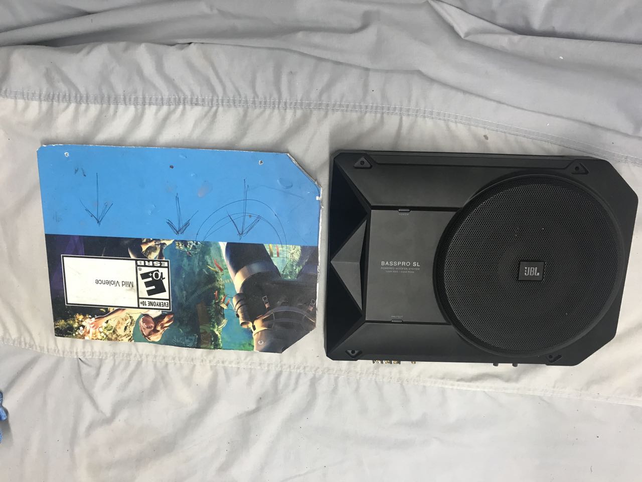

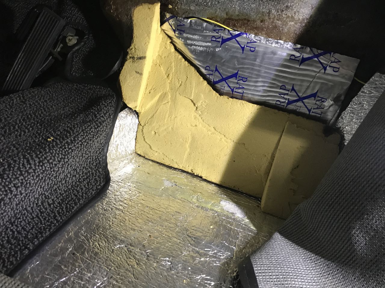

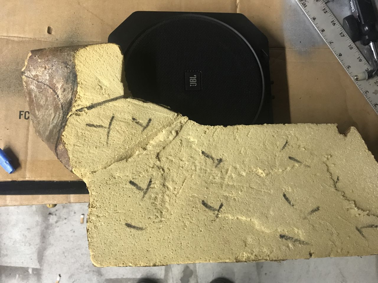

Keeping it going, I installed a sub woofer to help out the bass. I was going to install it up behind the dash, and delete the glove box. With no head unit also, that left a lot of room. Turned out size matters. SO , I took and reworked the right foot well foam pad, and strapped the box there. It is a powered woofer.

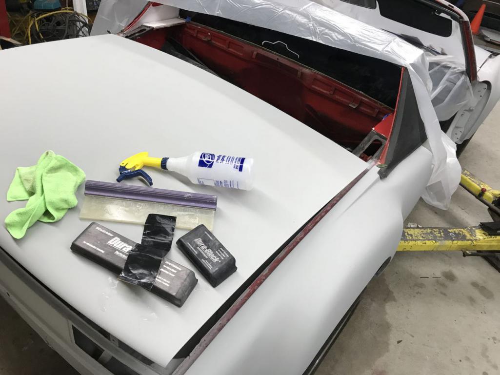

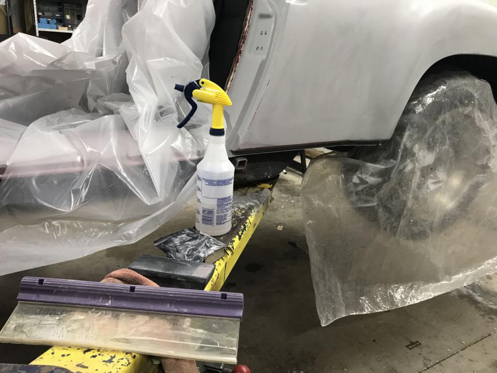

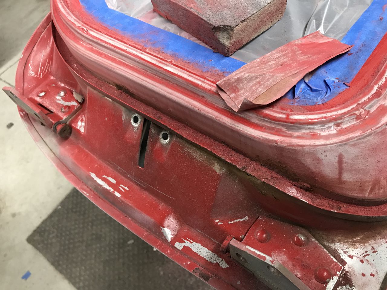

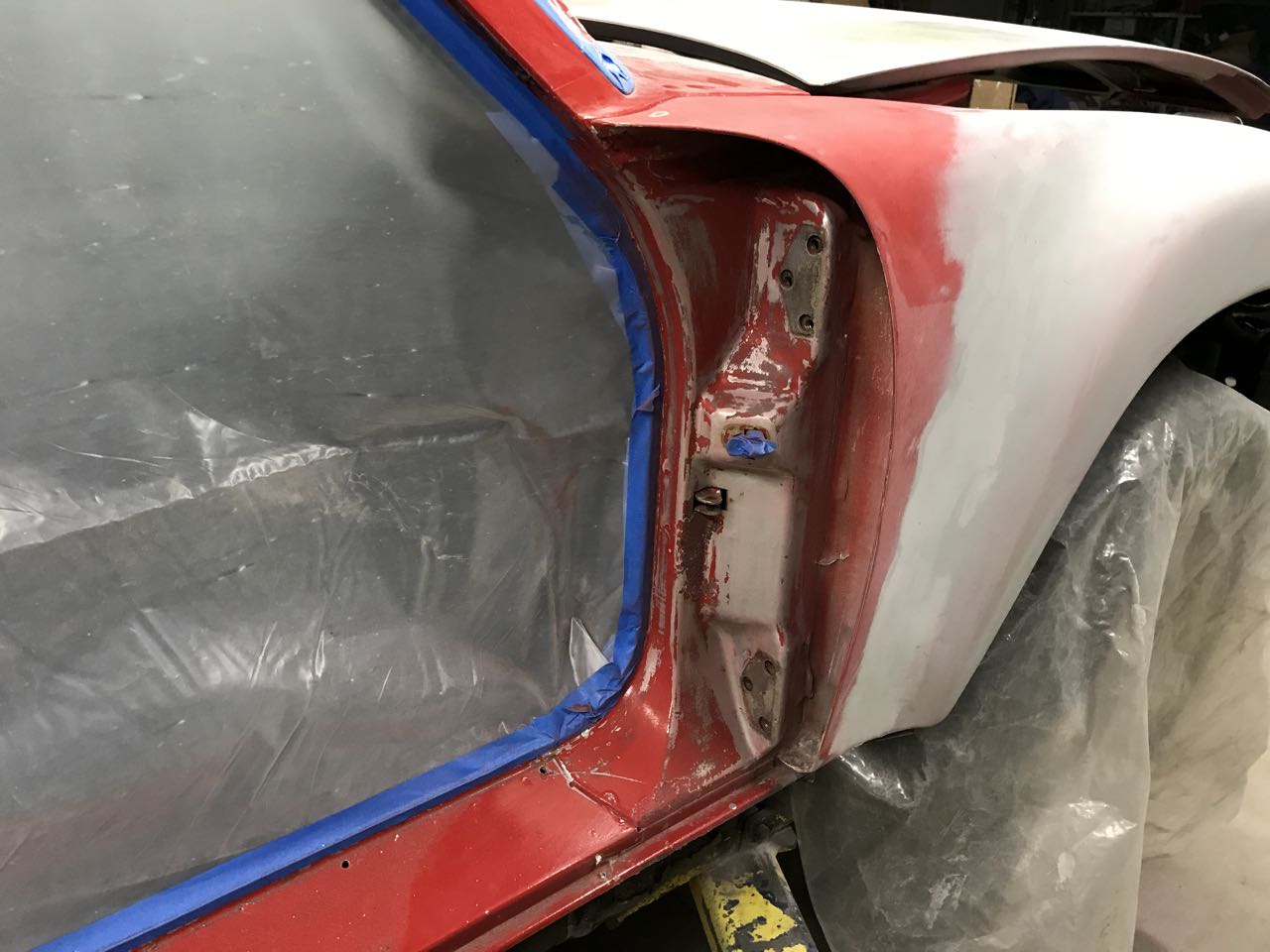

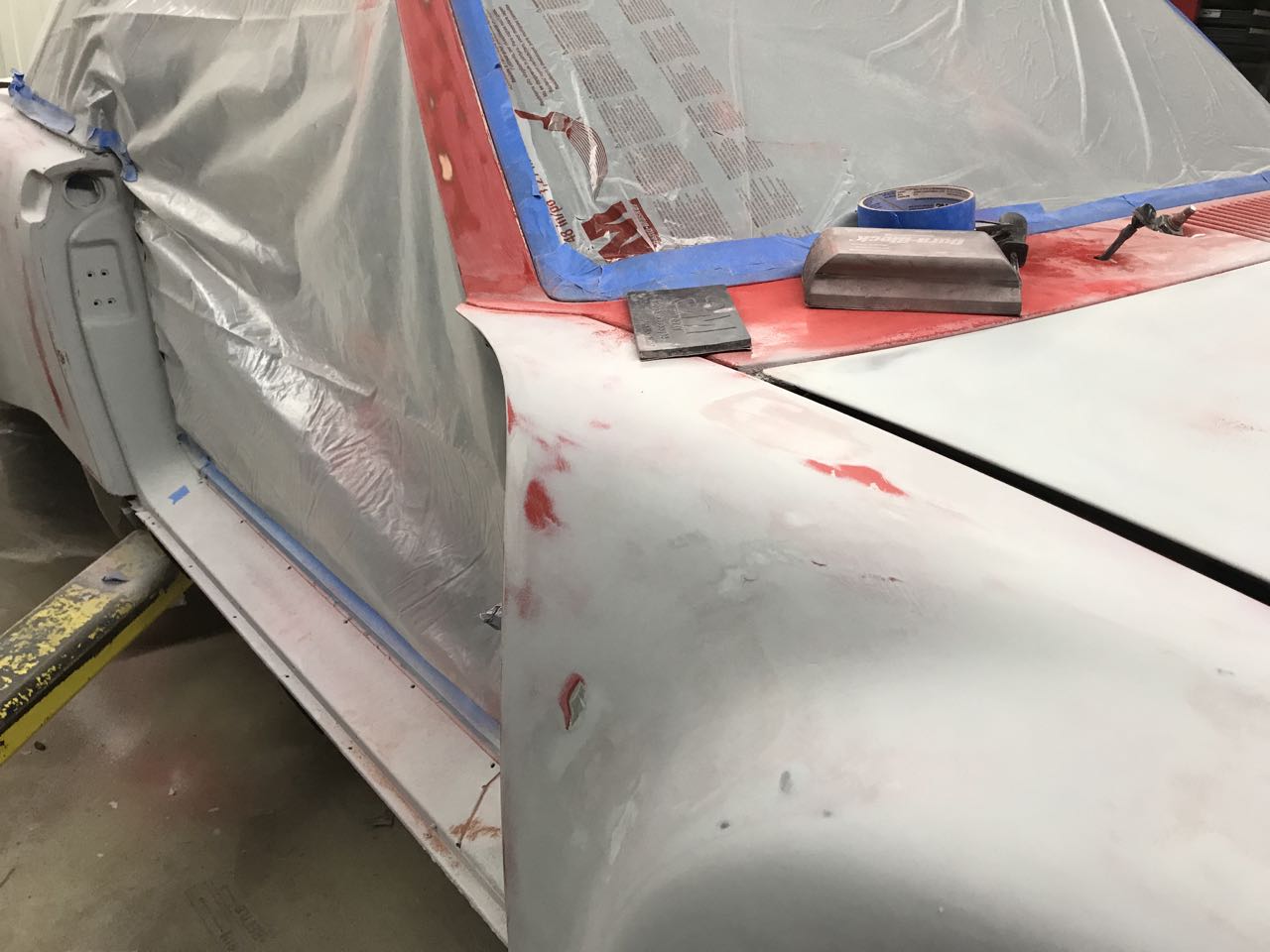

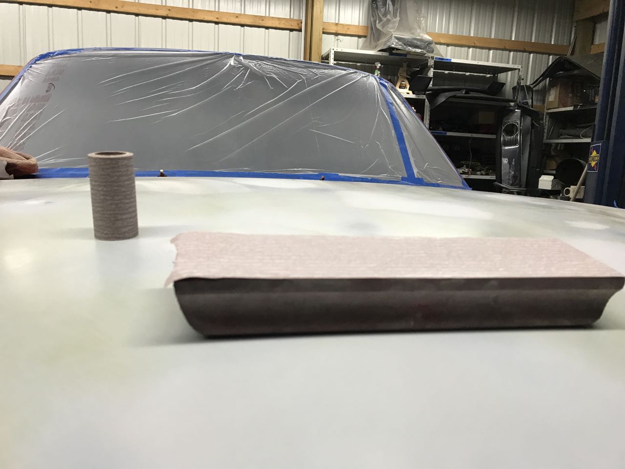

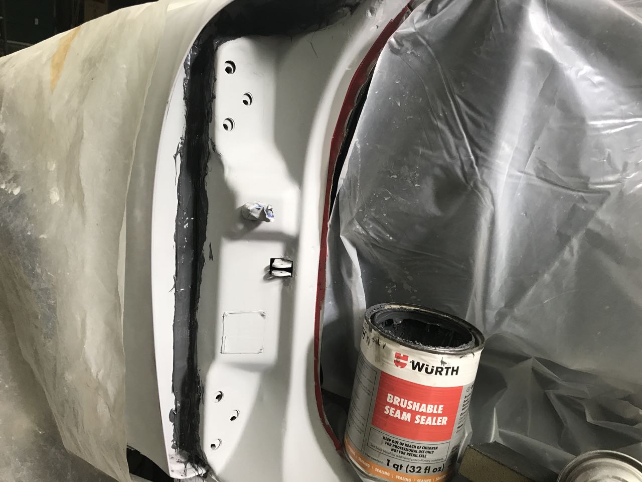

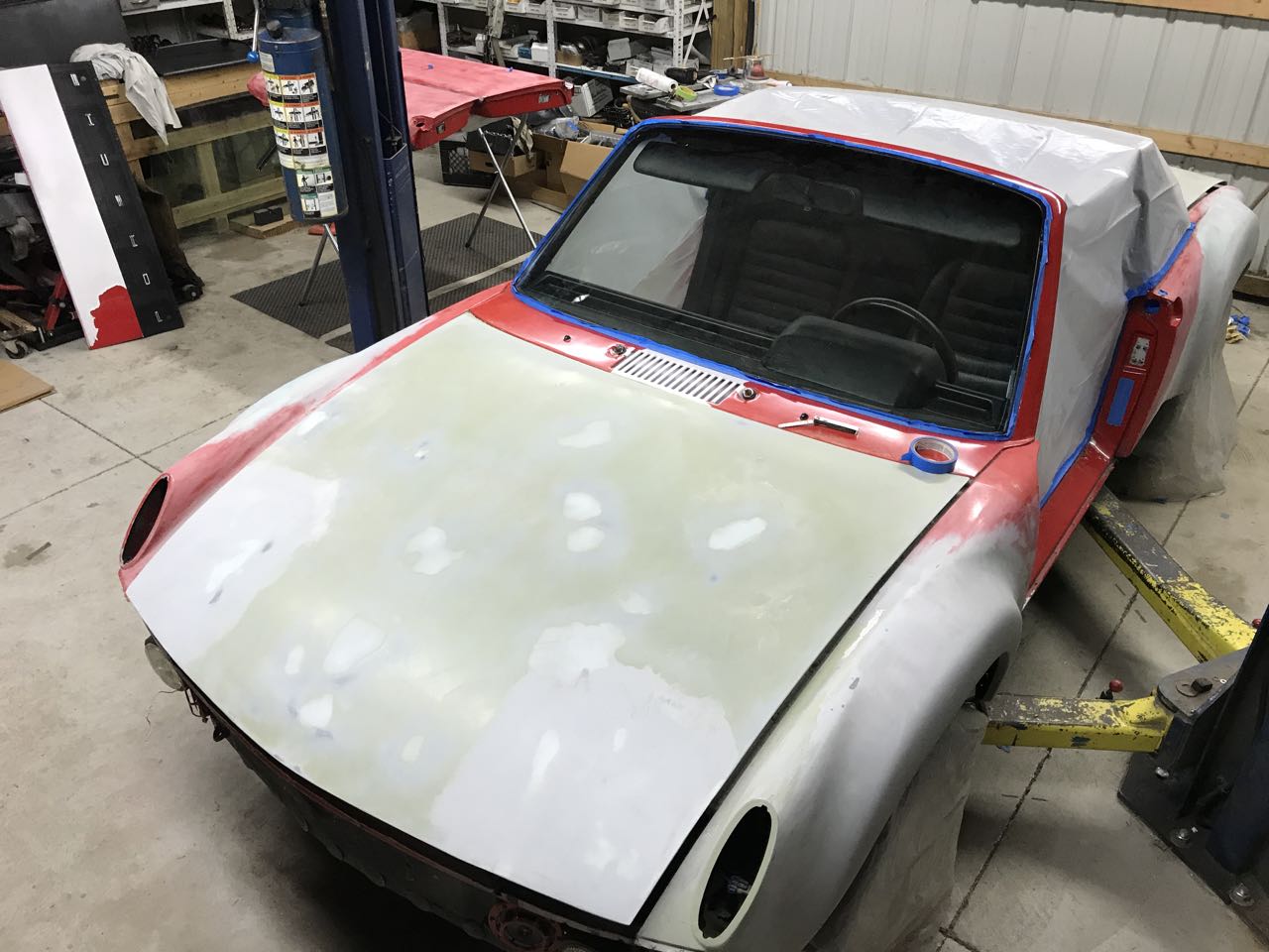

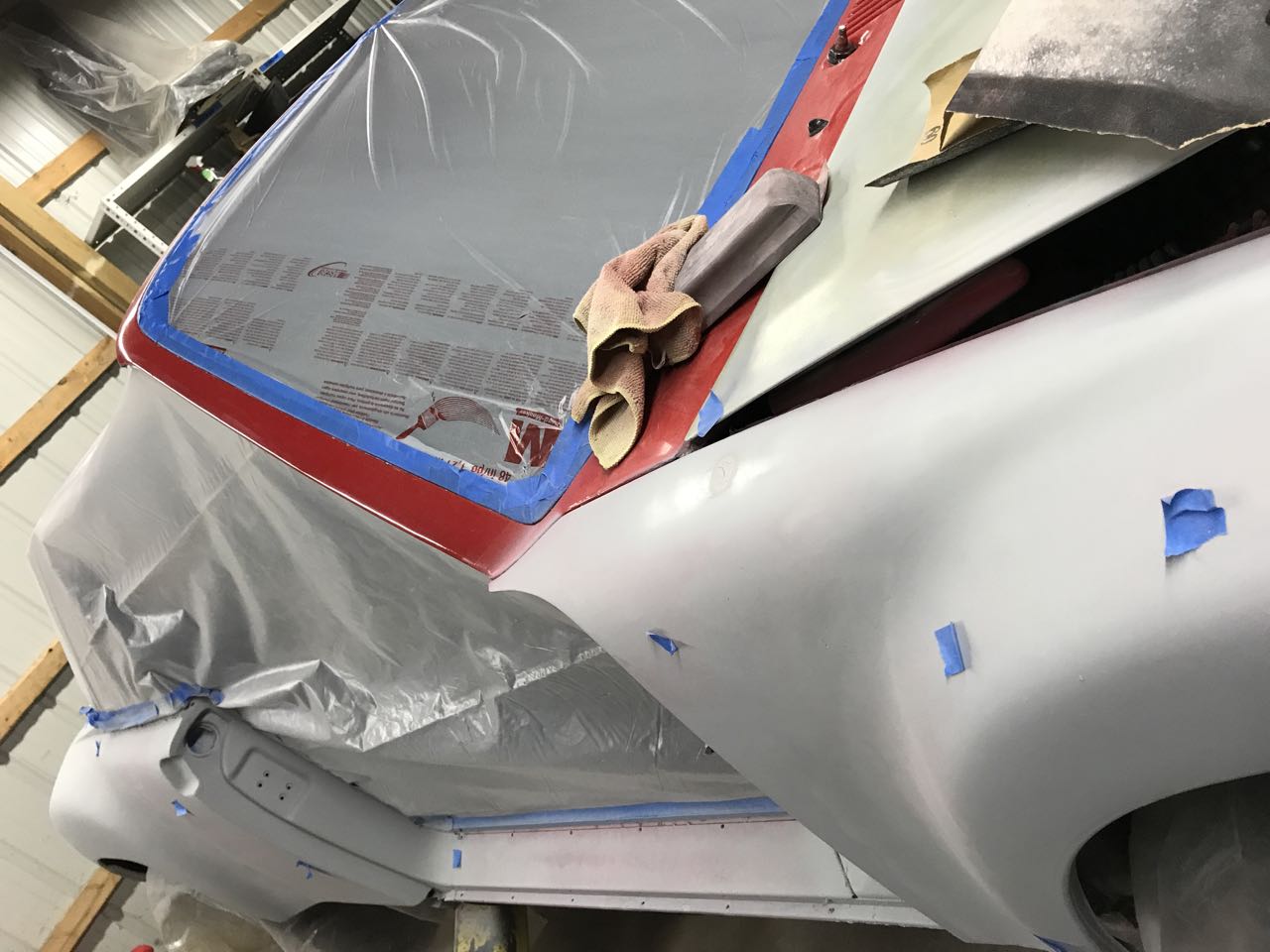

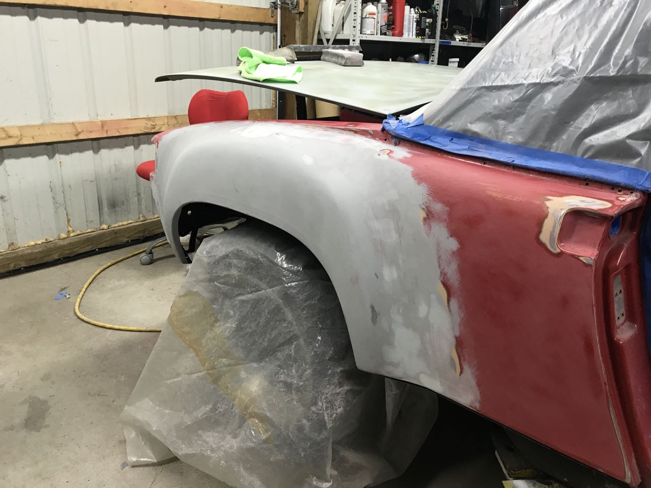

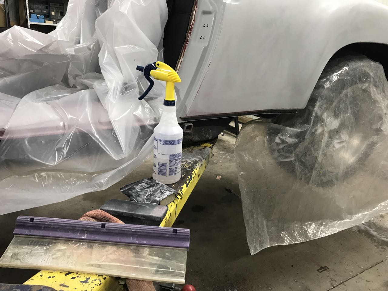

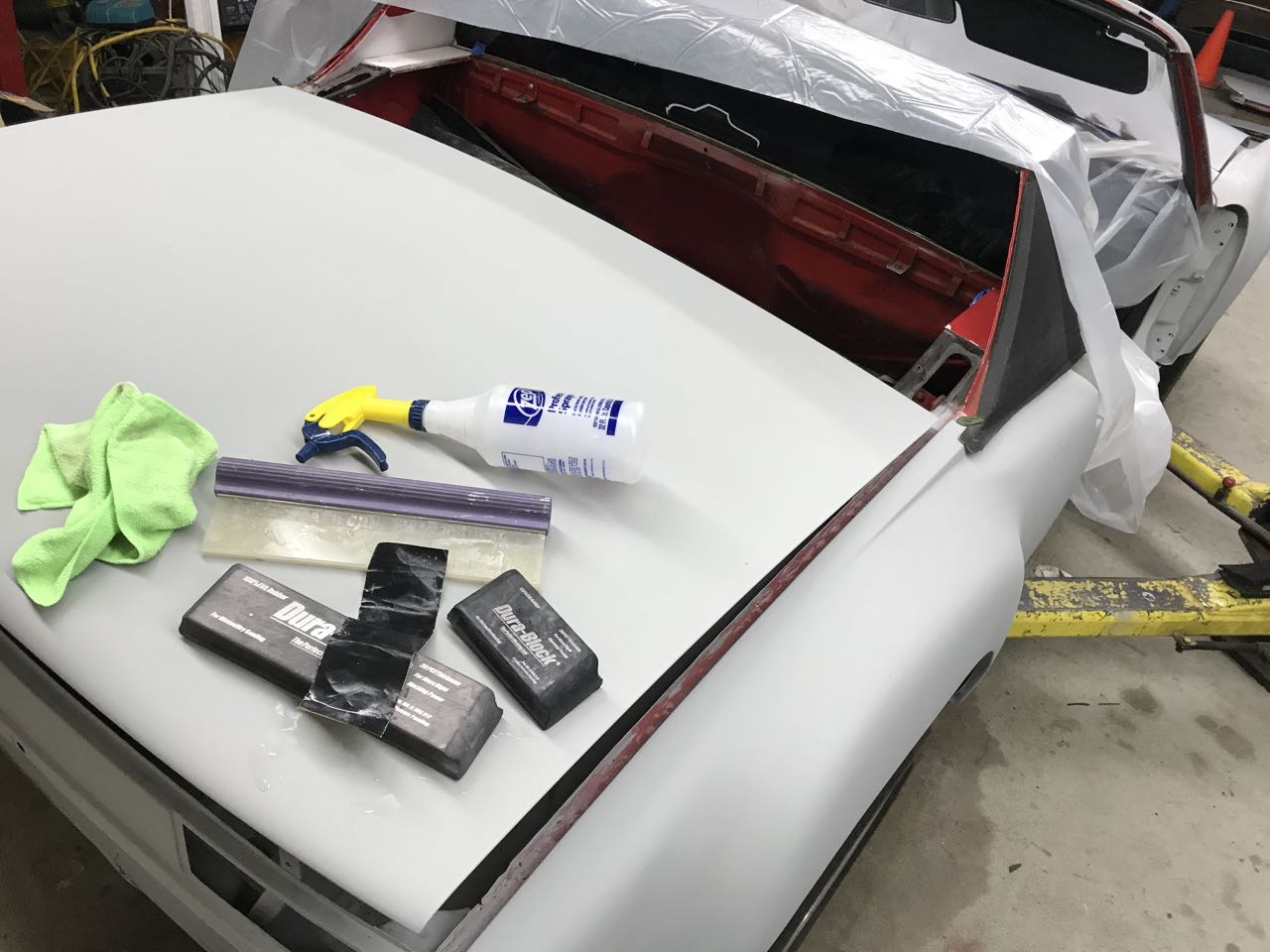

Finished up the body work and primer, wet sanded paint soon! A little bit of seam sealer need on a prior repair to finish it off.

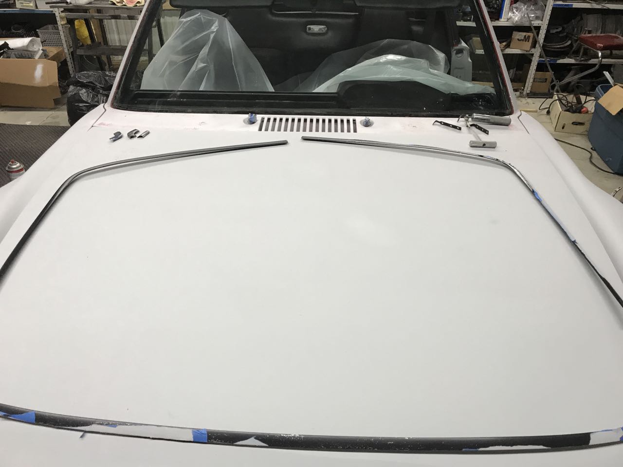

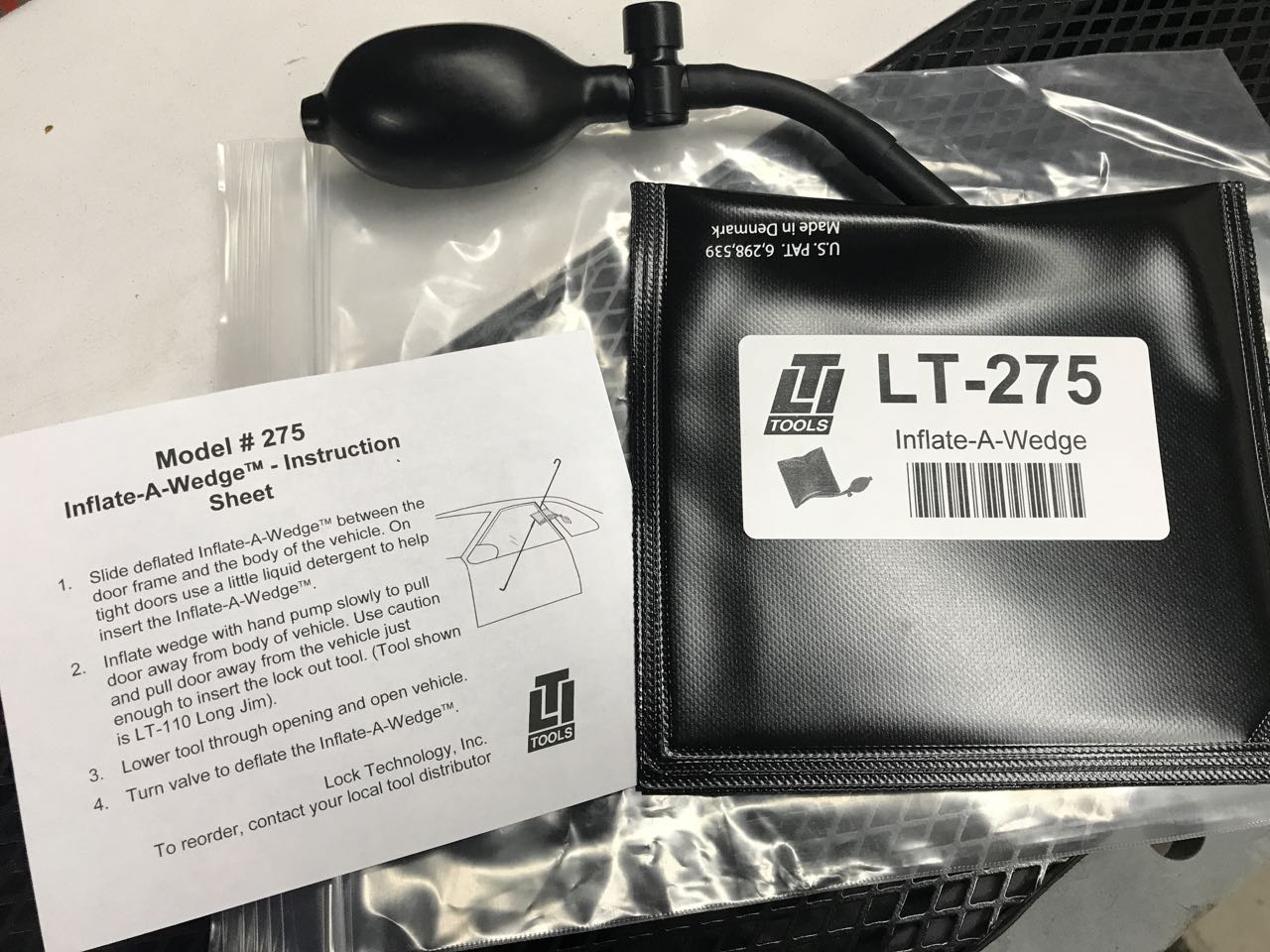

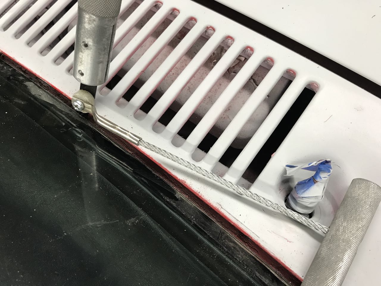

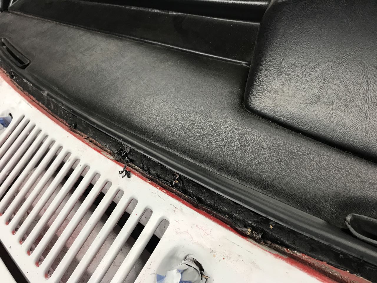

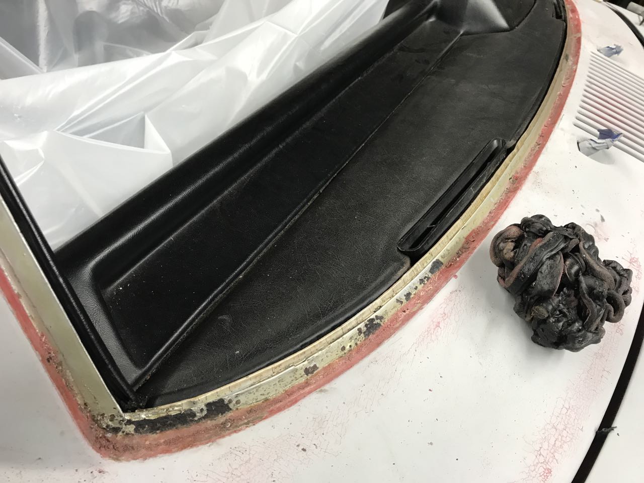

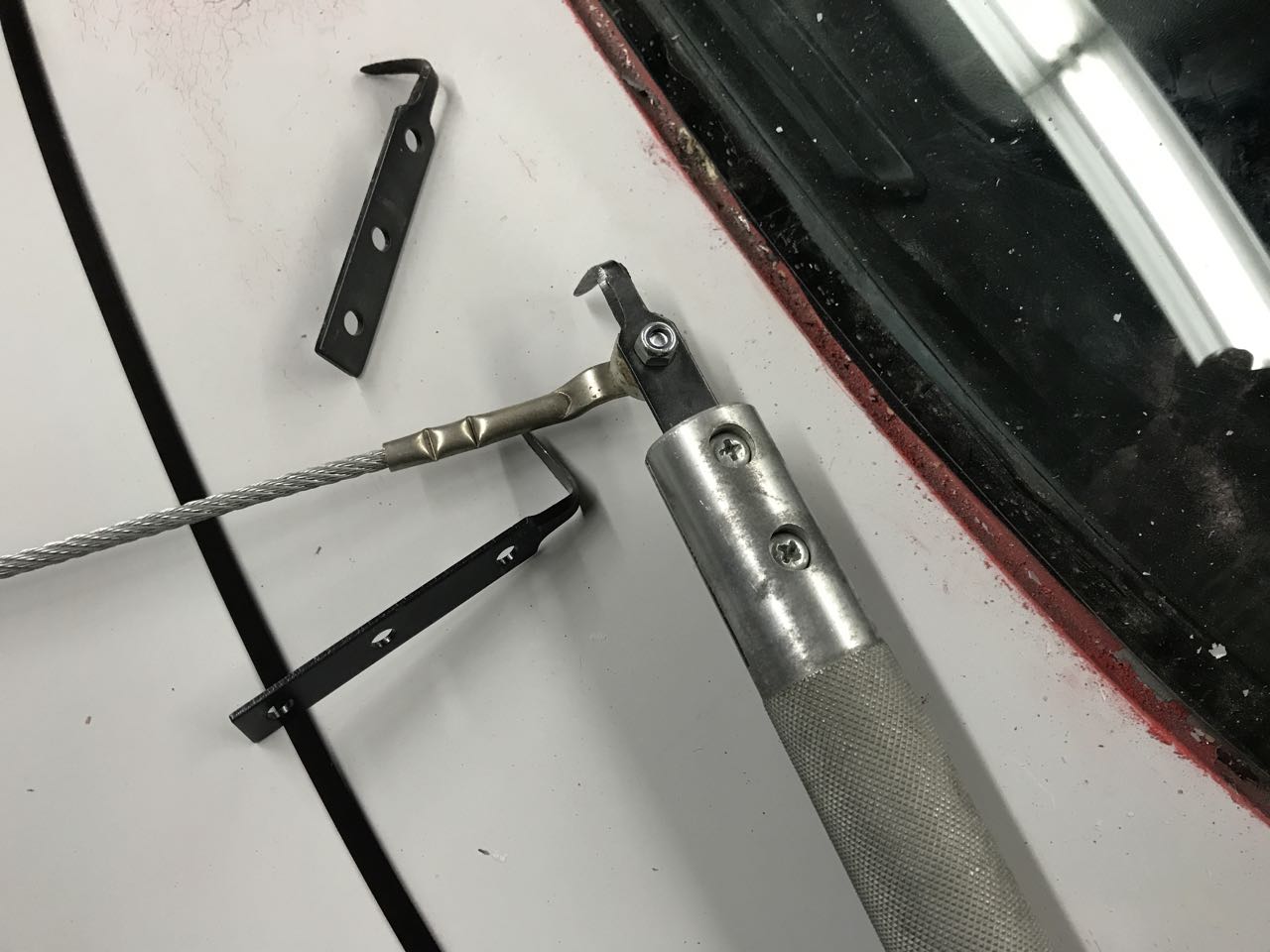

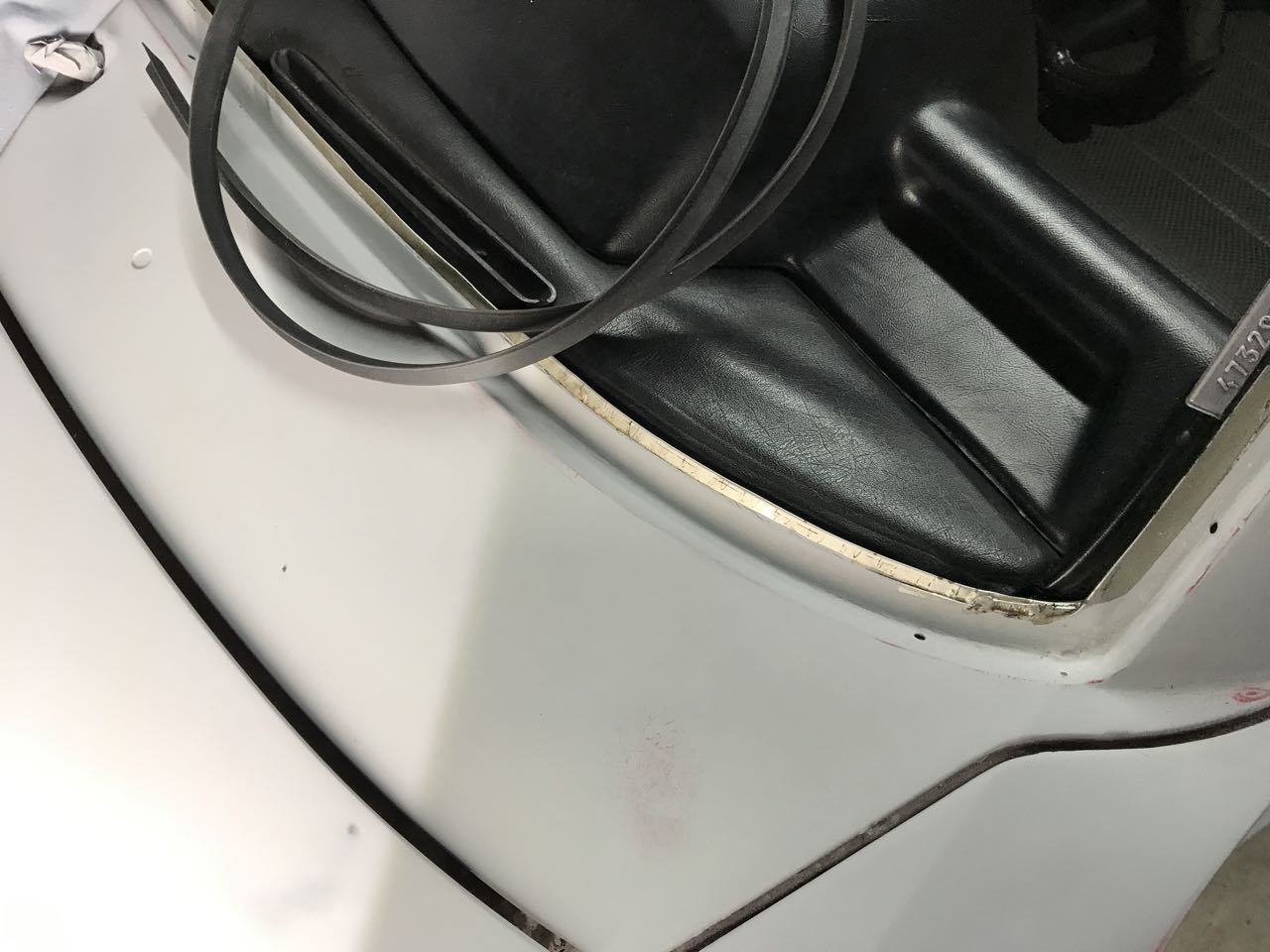

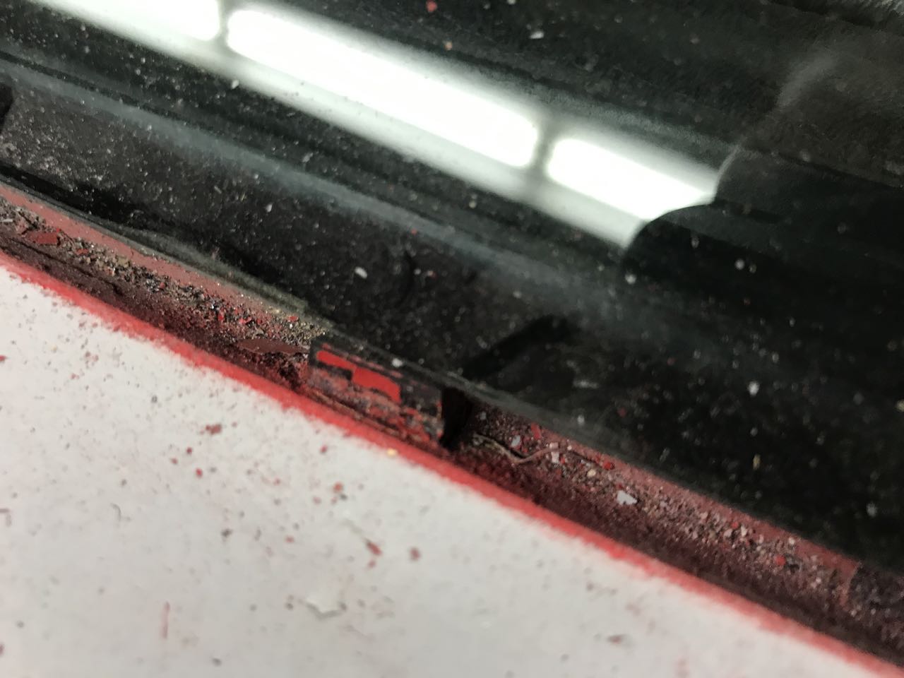

Pulled the windshield for the trim replacement, and cleaned up the corners a bit. Notice the setting block, this is factory since I put it in 10 years ago, a sourced it from a original install.
914 Rubber for the trim at the bottom of the glass to dash seal.

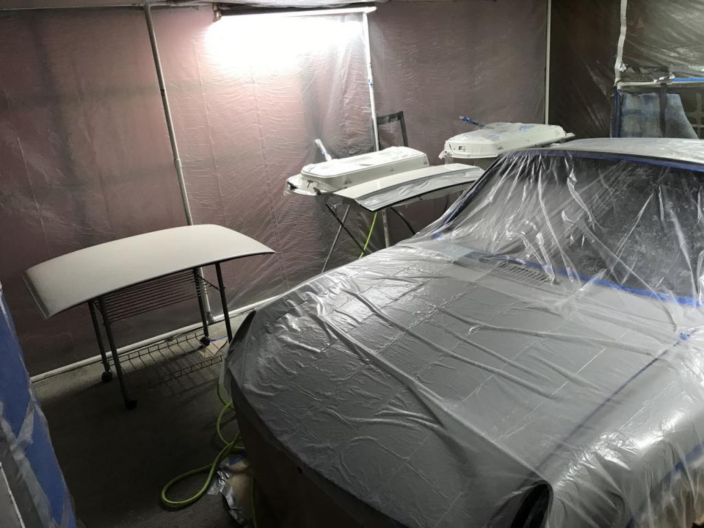

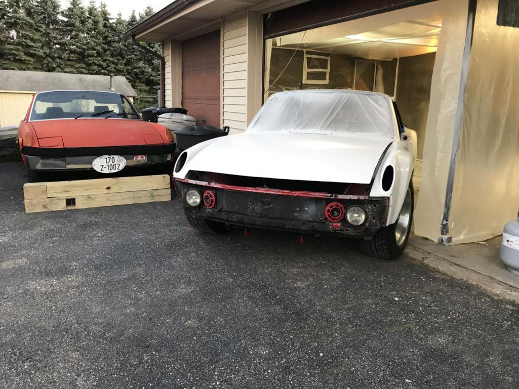

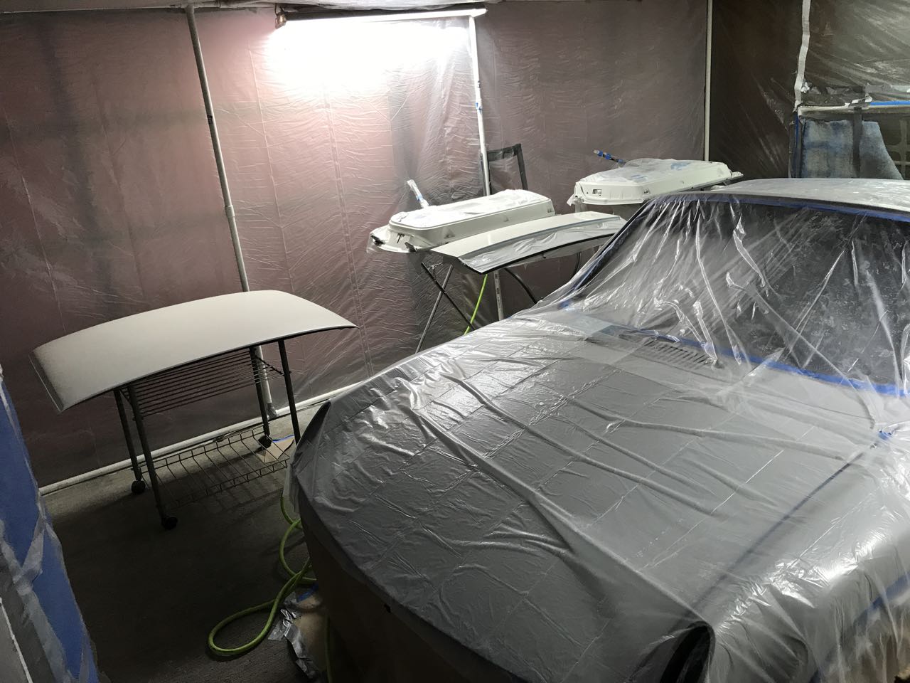

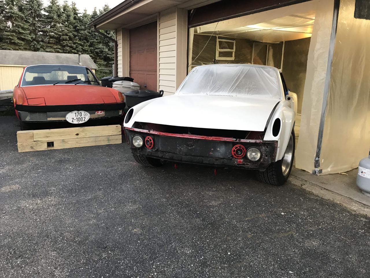

Re-building the paint booth I did 2 years ago for the other car. Garage booth.

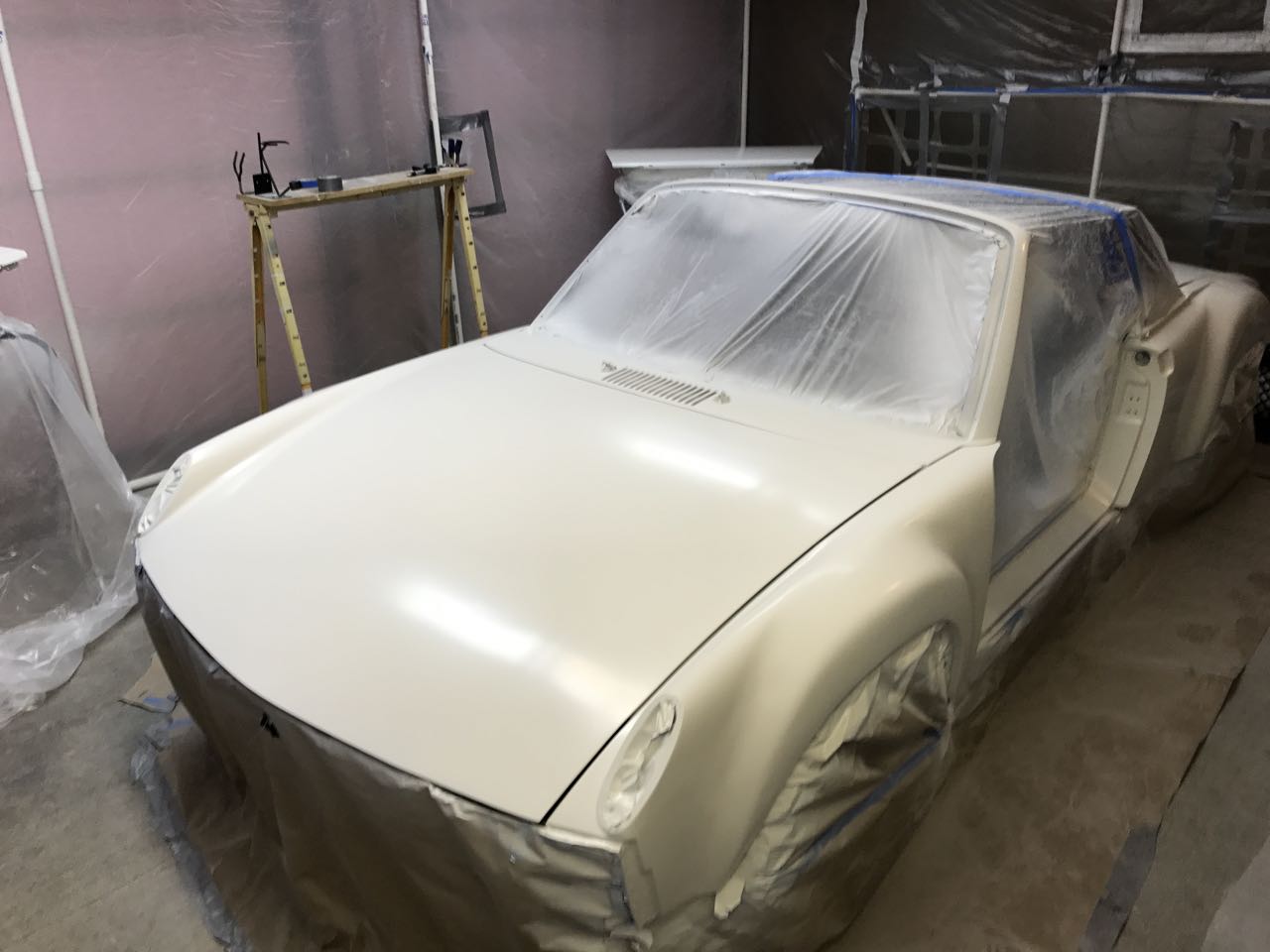

Garland
post Aug 11 2017, 10:01 PM
Post #158
Restoration Fanatic
Posts: 1,438
Member No.: 1,535

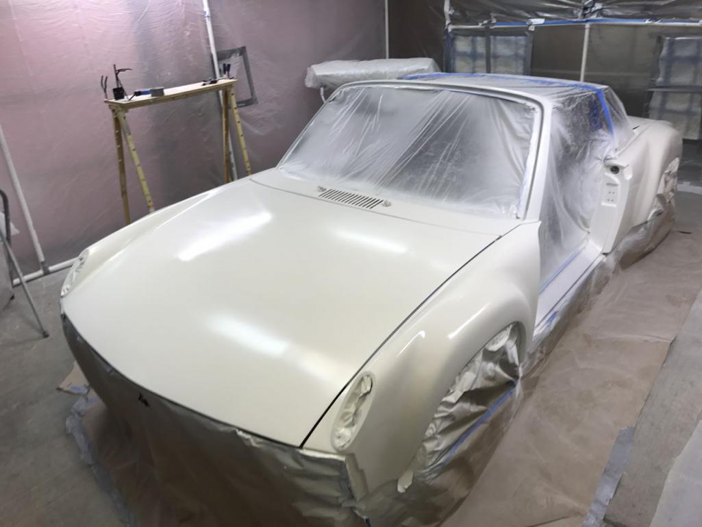

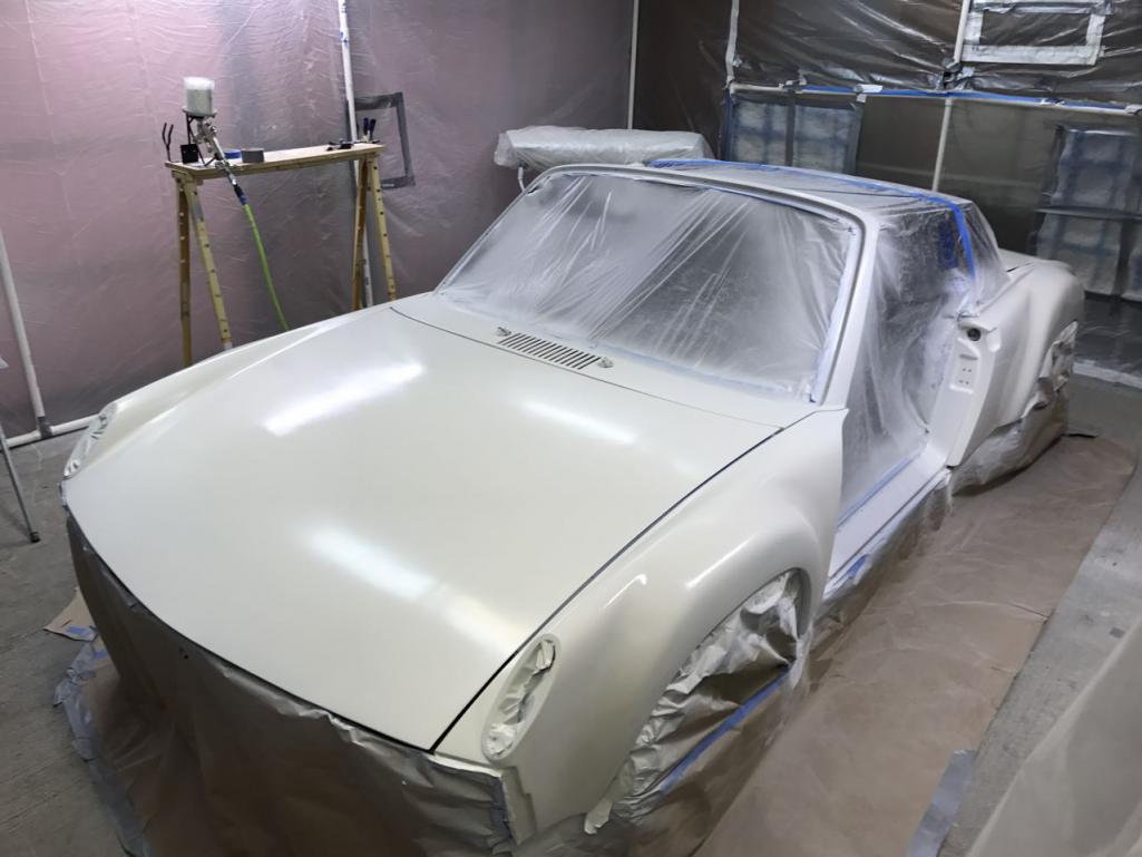

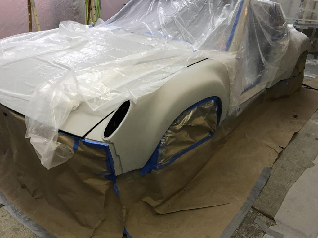

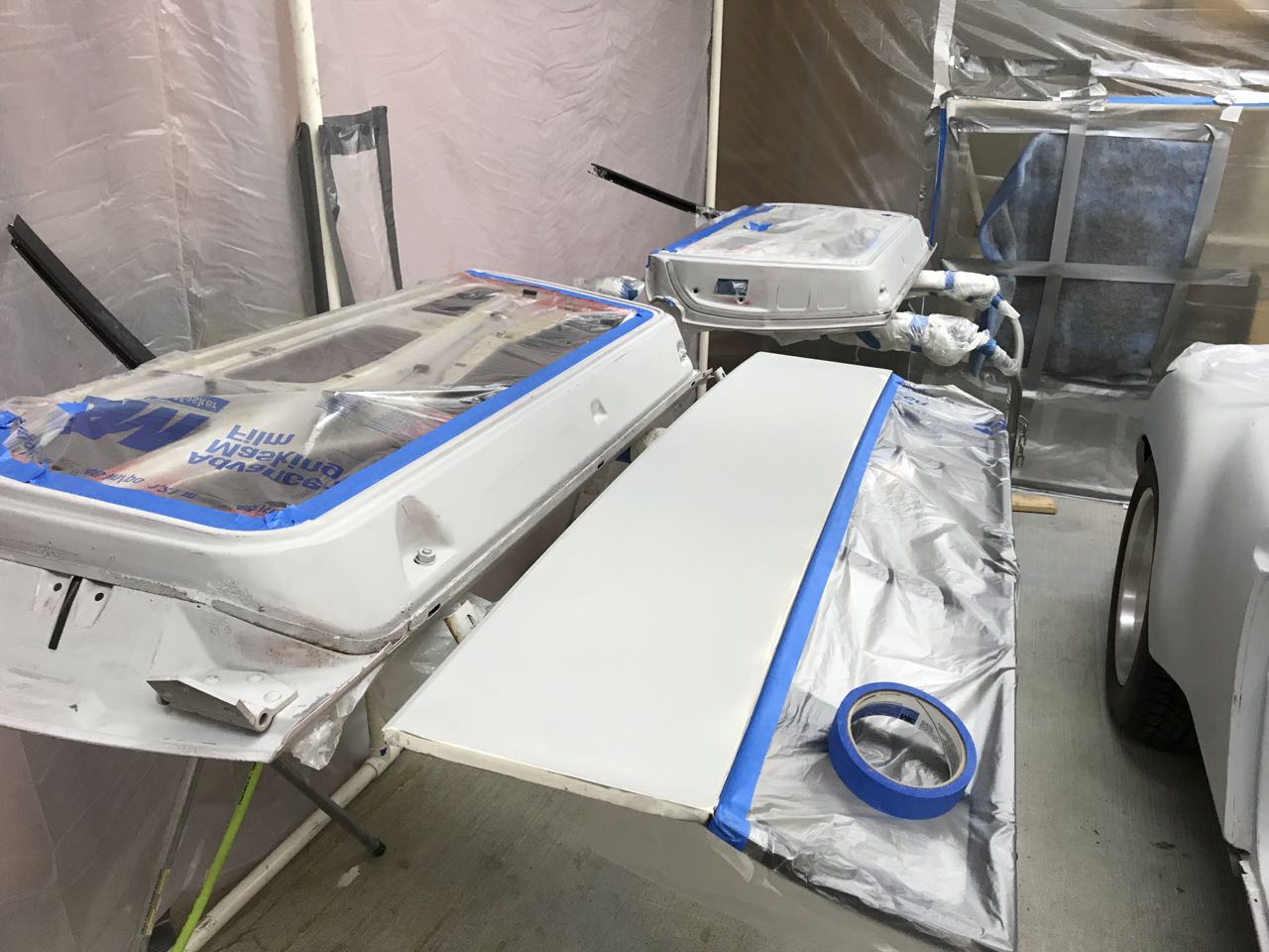

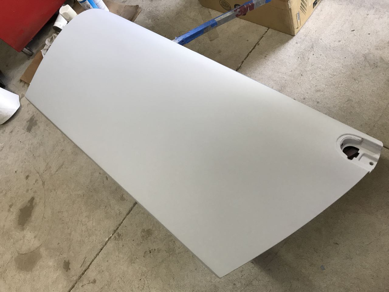

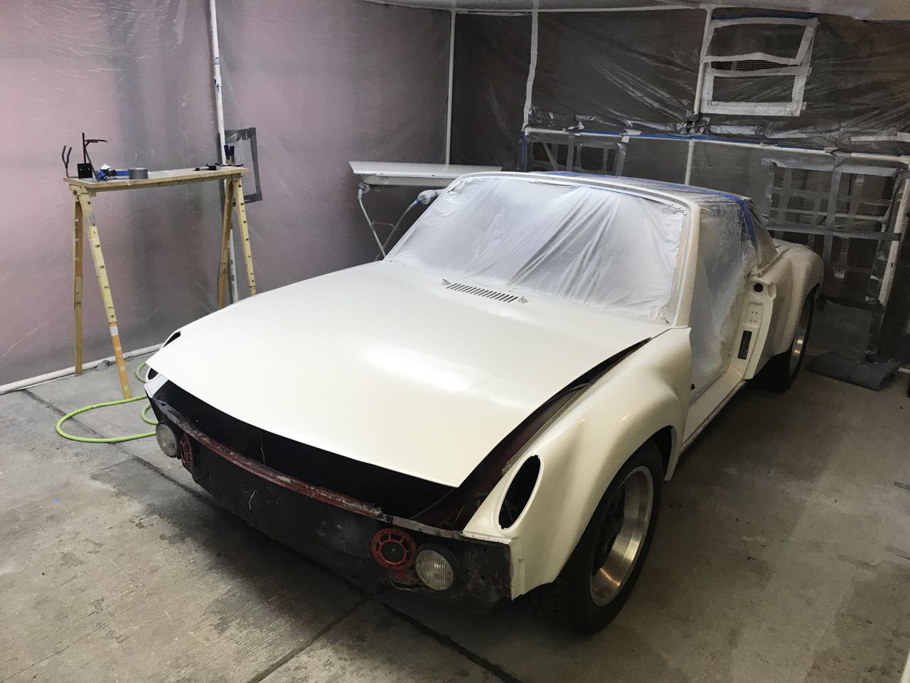

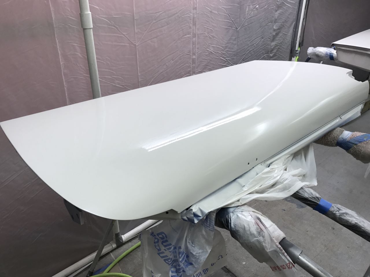

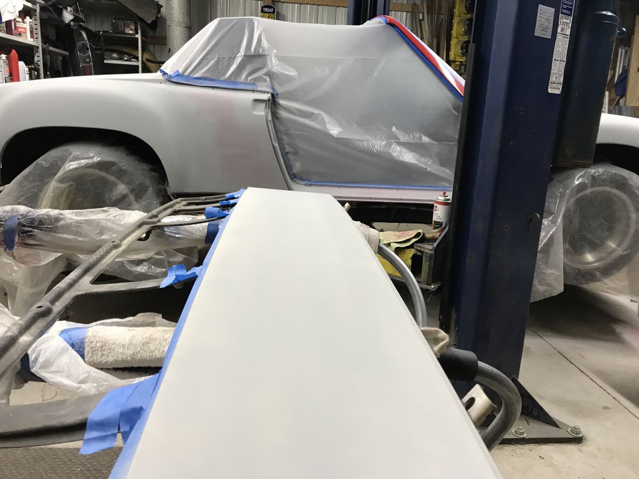

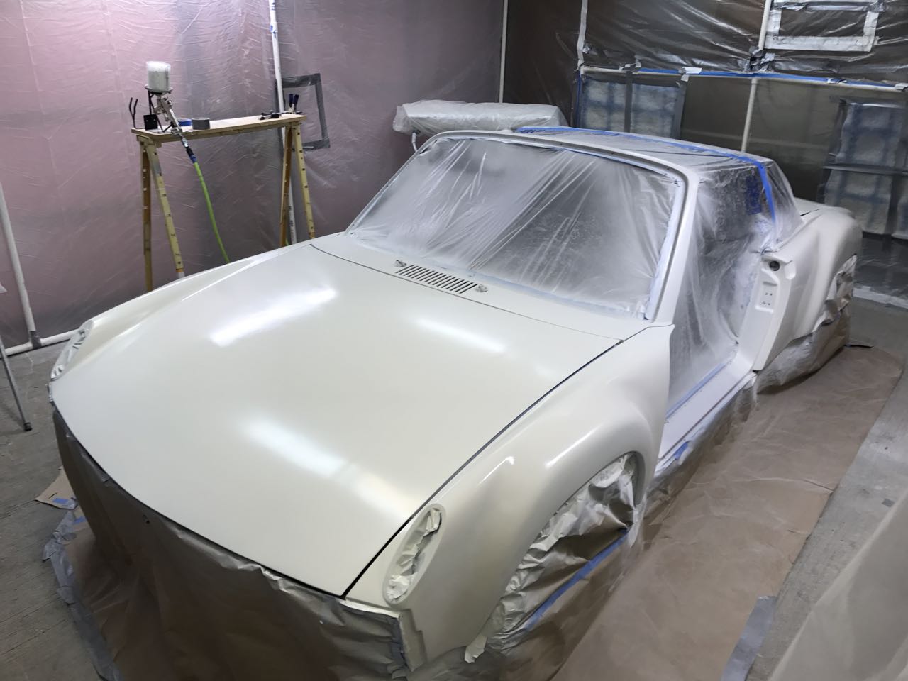

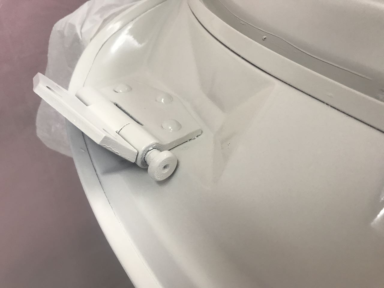

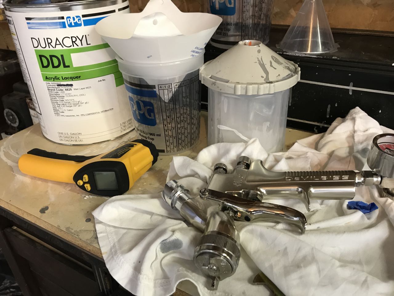

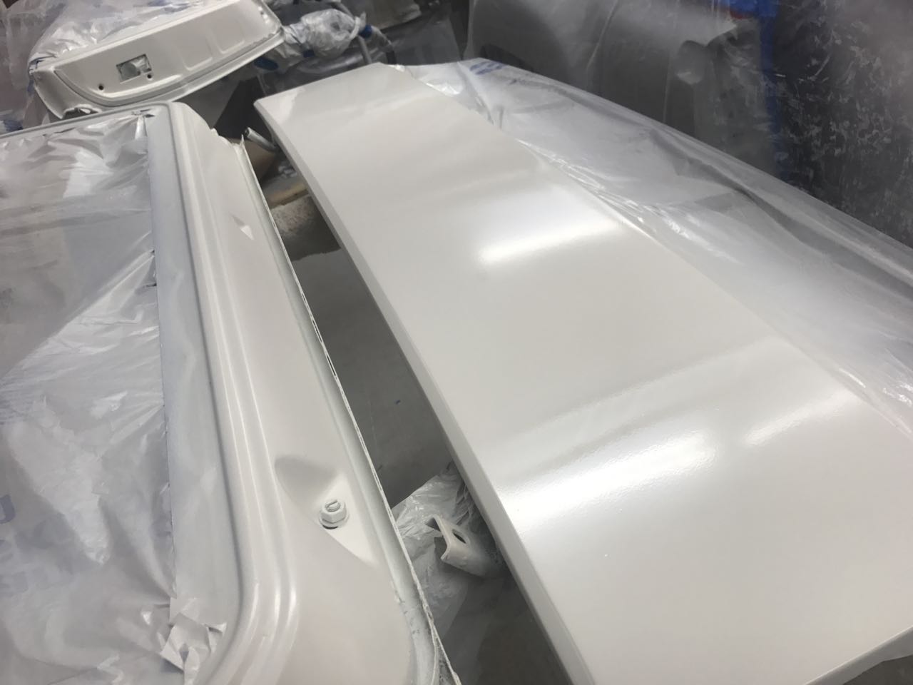

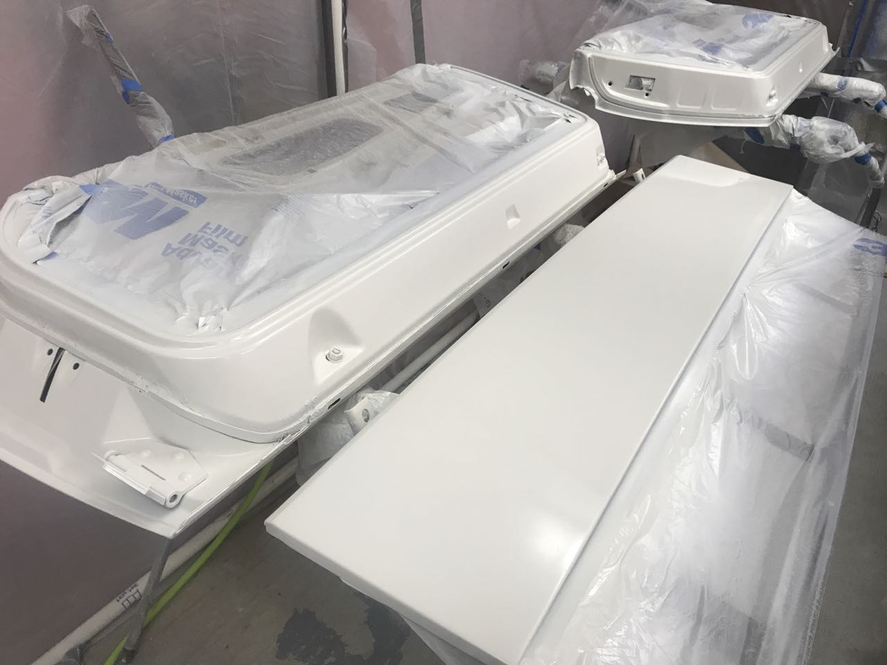

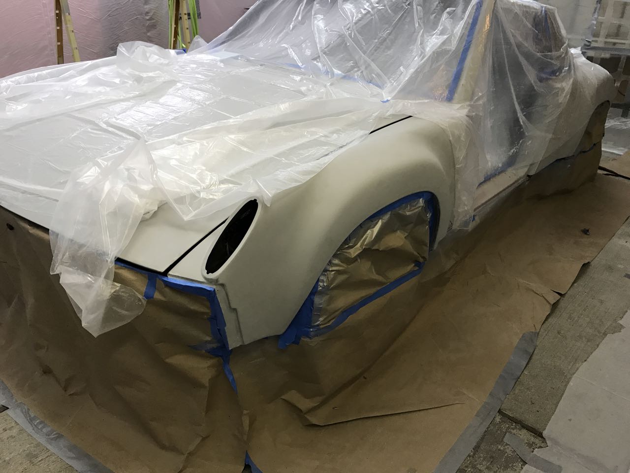

Finished the booth, and prep'ed and painted the doors, top, and engine lid. Went with Light Ivory in Lacquer.
Now I'll uncover, finish taping and paint the body.

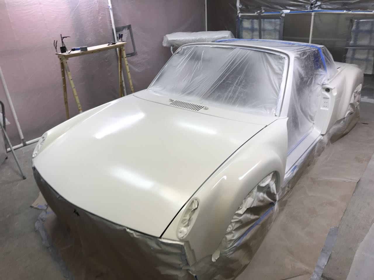

Garland
post Aug 12 2017, 06:42 PM
Post #160
Restoration Fanatic
Posts: 1,438
Member No.: 1,535

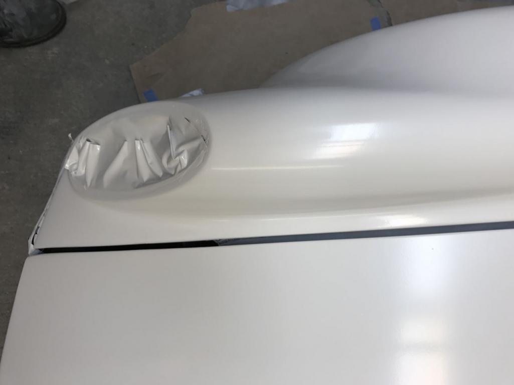

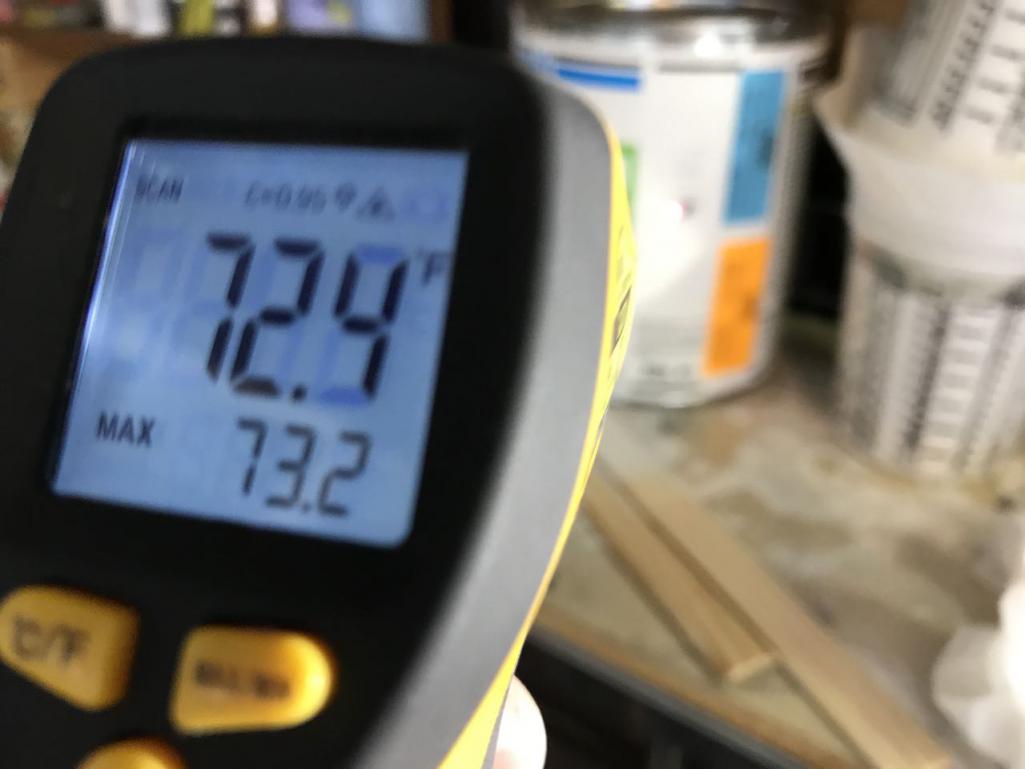

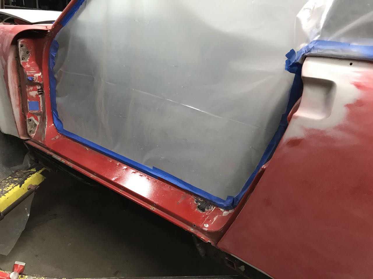

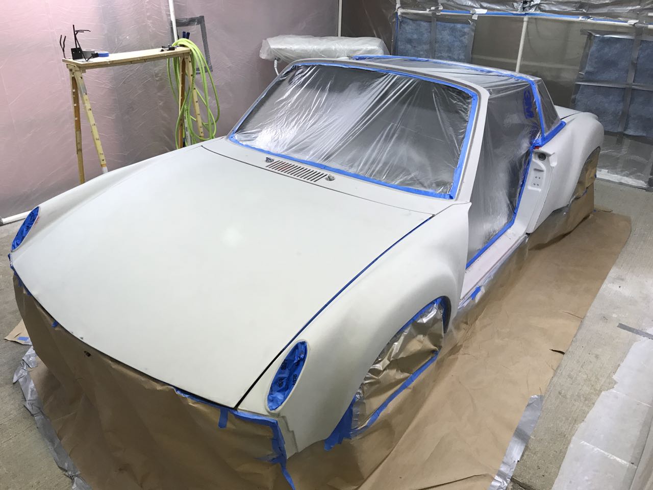

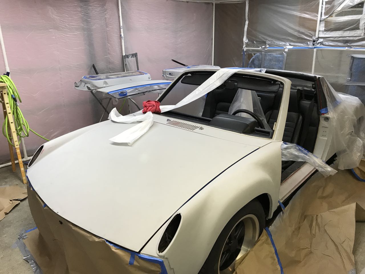

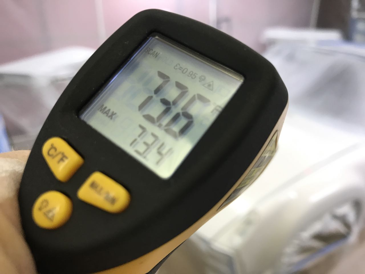

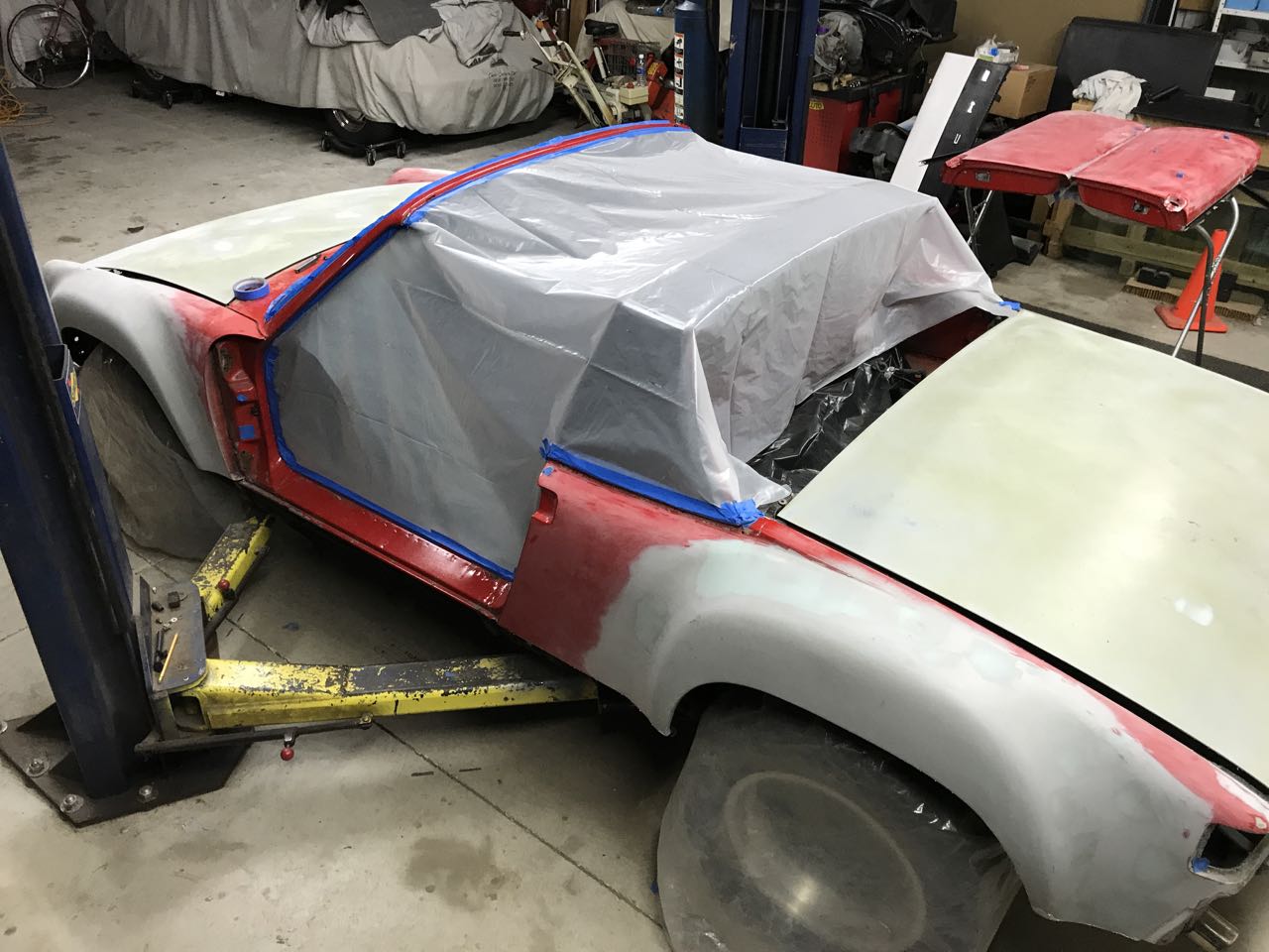

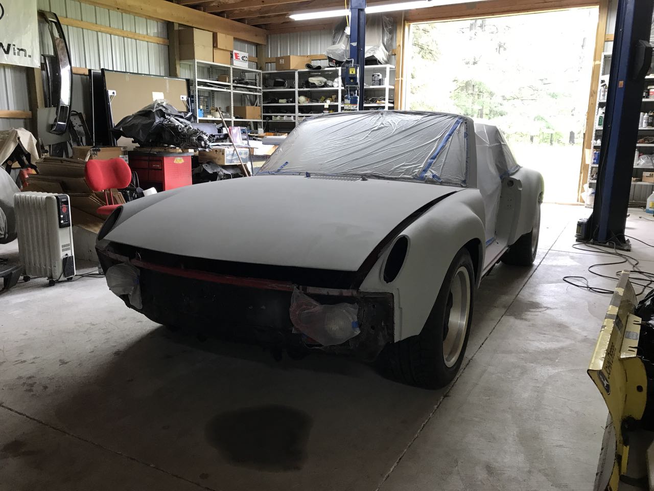

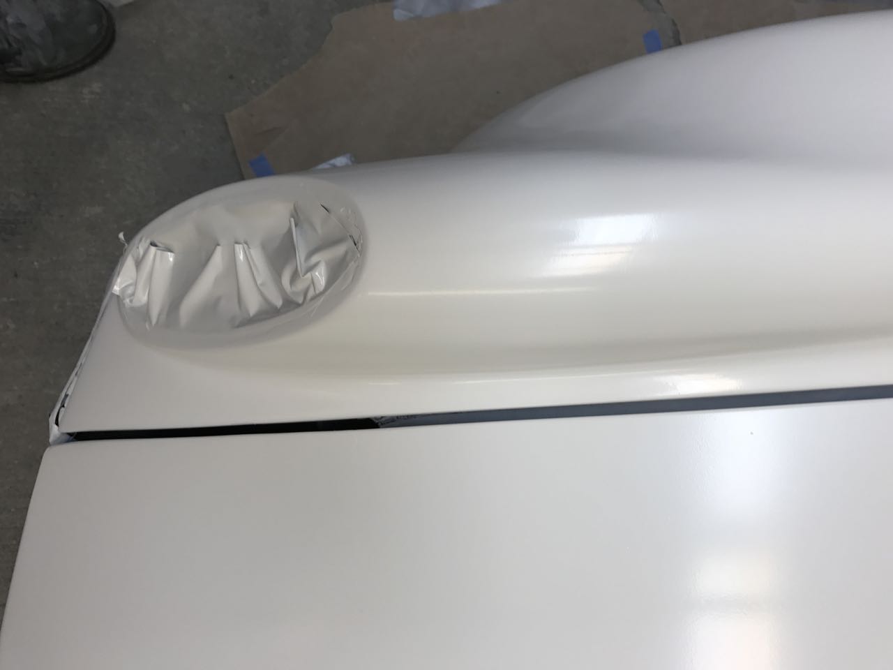

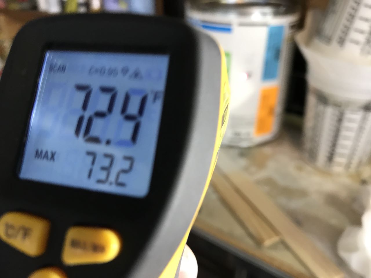

Taped, cleaned, and painted. I'm not sure how much it helps, but I have the car and the paint at the same temp. Came out nice, not sure Ill have time to wet sand and polish before Okteenerfest.
