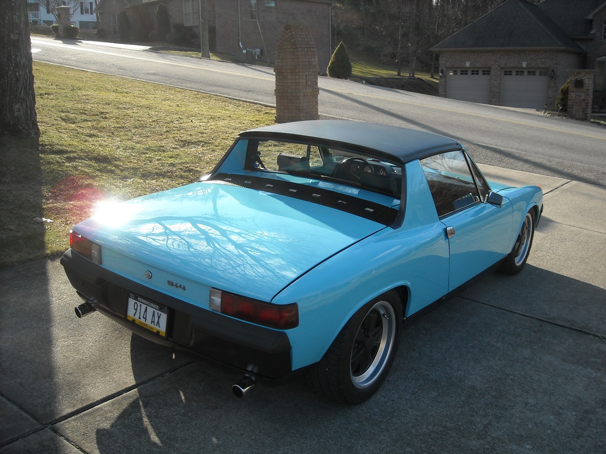

Wait, you started a 914 project and actually finished it and drove it?
Shame on you, that's that's not allowed.
You are supposed to work on it for the rest of your natural life and "almost" get it running or almost ready for paint.
BTW great looking car, I like.

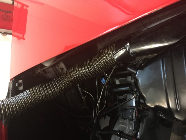

Was pretty happy with the results of the oil cooler installation (See post #119)
Driving it quite a bit and the oil temps rarely get over 220. even on the hottest days, and we have had a run of 90+ deg days lately.
But I remember a situation when I had a Thermostat flap issue, and pulled over in traffic to let it cool down. I had popped the engine lid to cool things off and pulled back out onto the highway forgetting to close it again. I was surprised at how much of a difference it made. I do have a rain tray fitted.

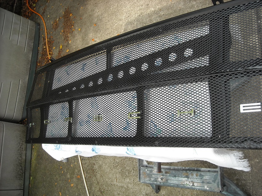

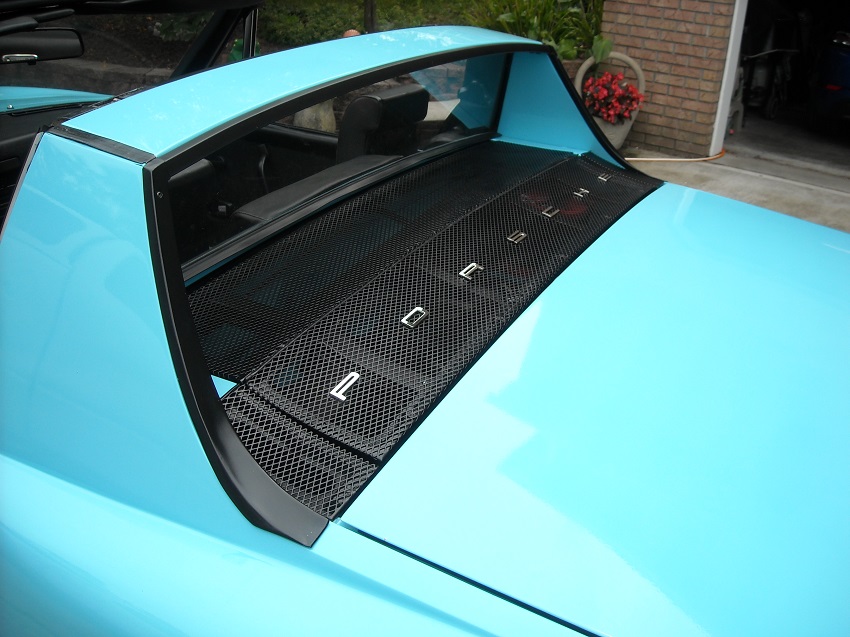

This got me thinking about the GT lids that Sergio makes. @PCA7GGR Since he has acquired a lot of lids to work with, I wouldn't have to give up my original lid as a core.
Definite plus.
So I finally ordered one and after getting a set of letters from Mark I installed it yesterday.
Took a few tweeks to get it fit my car right, but I like it.
And now in the late fall I can put the regular lid with rain tray back on. then switch it out when the weather gets hotter.
drove it around yesterday for about 30 miles, it was in the low 80s so not as hot as it has been.
CHT numbers were noticeably down. I expect that it will help reduce the oil temps also.
Maybe I will get a temp gauge like @Gregamy has and do a back to back comparison with GT lid vs stock lid +raintray.
Under Trunk Temp thread. > http://www.914world.com/bbs2/index.php?showtopic=347282
It would be interesting to see how much the GT lid affects the other temps, like oil and CHT. It may even drop the under trunk temps.
The real test will be the drive to Teenerpaluza, I wanted to have this installed before the ride down.

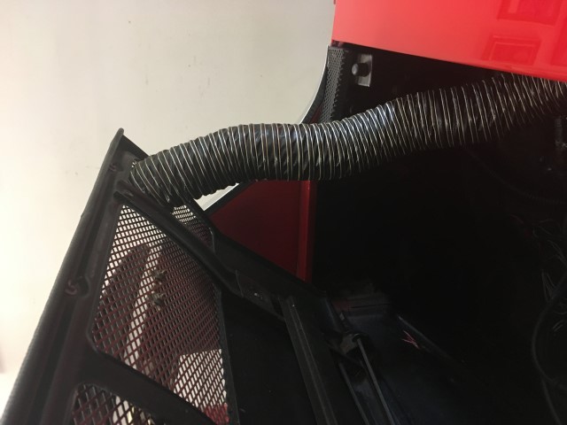

QUOTE(Olympic 914 @ Jul 31 2020, 08:58 AM) *
I like that idea! It would certainly address my concerns about water intrusion in the Spring and Fall...are these things a PITA to remove/replace?
I dropped my IATs by 25-30F with this chintzy test setup (IAT probe screwed into the bottom of the airbox.)
Haven't decided how I'm going to incorporate it permanently, as I need a way for water to collect and drain out before the airbox. Honda uses a plastic resonator in the fenderwell with a drain hole at its bottom, I may do something like that. I suppose I could drill a small drain hole at the lowest part of the metal airbox and that would do the same thing...after all, the air is pulling UP through the filter there so water ingestion is highly unlikely...and I think I'll modify one of the side grills to pull air from permanently.
Edit: as an aside, this car really really really should have been designed with side air intakes, similar to what the first-gen Toyota MR2 had. It was a good thing for that mid-engine car, and they weren't even cooling the engine with that air! If we had side scoops on both sides then the engine compartment would get flooded with cooler ambient air instead of trying to pull both induction, oil, and engine cooling air around a plastic/covered grill located in a low-pressure area.

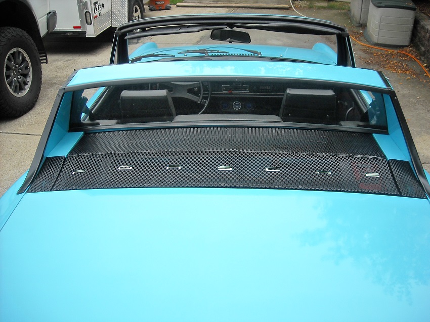

I like that hose setup. I had an idea bouncing around in my head of pulling air from the little side screen and directing it down to the oil cooler.
Maybe using a marine bilge blower. they are small enough and already set up for hose attachments.
I don't know if they would hold up to continual use though.
More food for thought.....

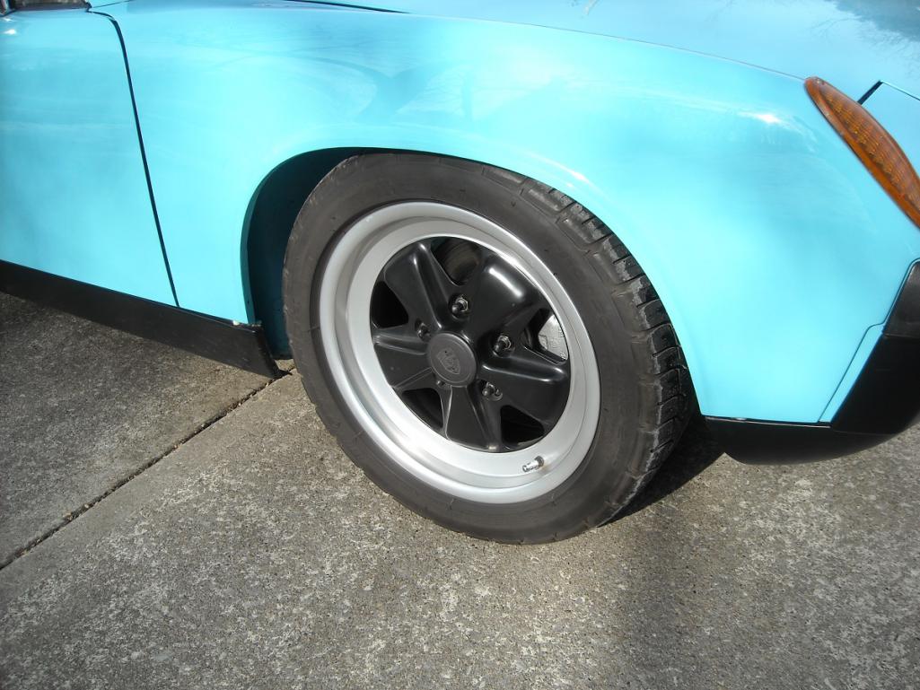

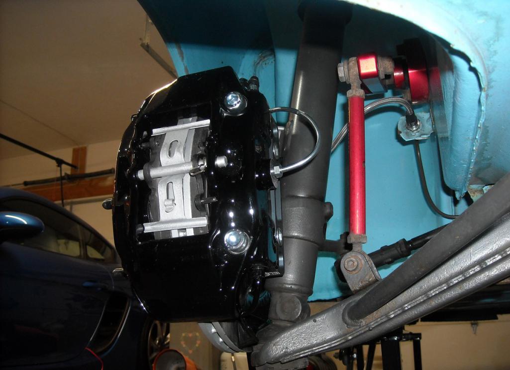

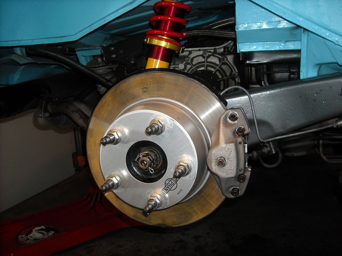

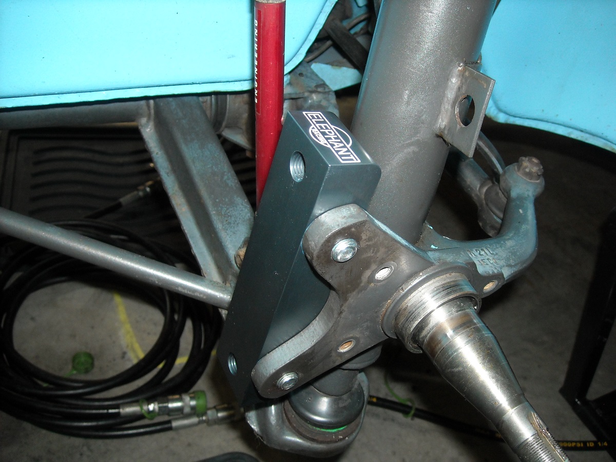

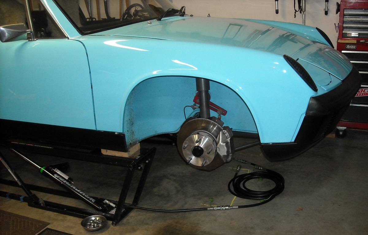

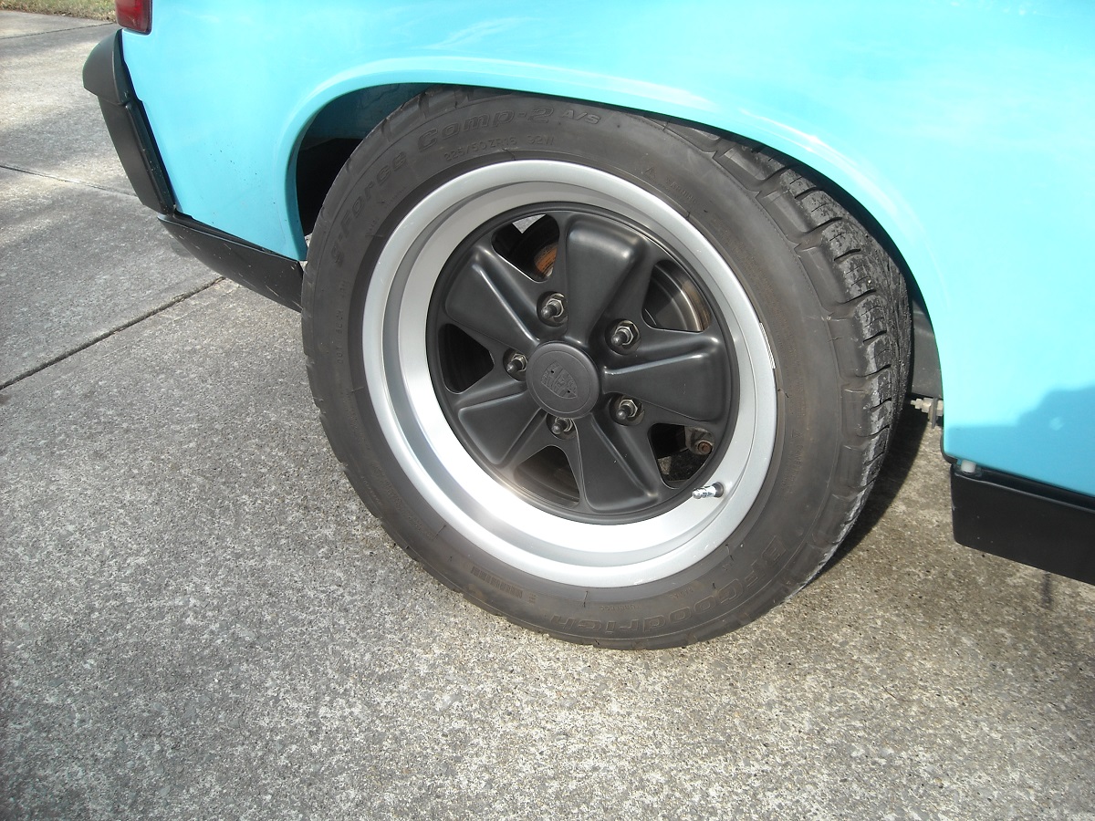

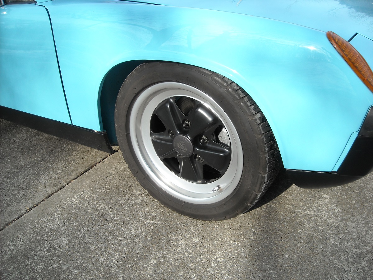

Put the bullet nosed studs on the rear last February.
I saw these on a buddy's drag car, thought they really looked good.
and will let me add some spacers.
Got around to doing the fronts this week.
Was getting some rubbing with the 225-50 x16s on the inside fender of the Pass side so I put 2mm spacers on to try and reduce that some.
Not much space there, I tried 3mm spacers and it rubbed on the outer lip.
I'll be running 7mm spacers on the front, to bring them out a little, lots of room on the front.
Painted the A calipers with VHT caliper paint, They were getting a little cruddy looking.
And with the Fuchs mounted
Olympic 914

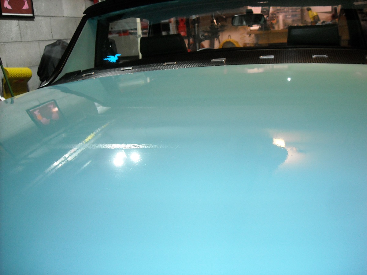

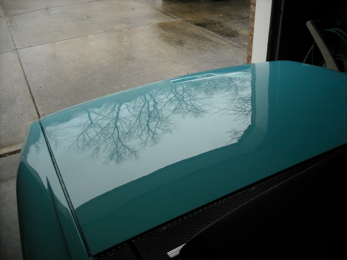

Was FINALLY doing a cut and buff on the paint, PPG Single stage that was put on 4 years ago and really got hard.
It looked pretty good but I had put 6 coats on and had some marks on the trunk lid I didn't like. So the time was right.
Started out blocking with 1200g on a Durablock, went to 1500, and 2000. Then got the DA and did 3000 gr and 5000gr.
Pictures of this process are hard to see the difference.
Then using 3M system of 3 different buffing compunds.
Took a LONG time but the results are worth it.

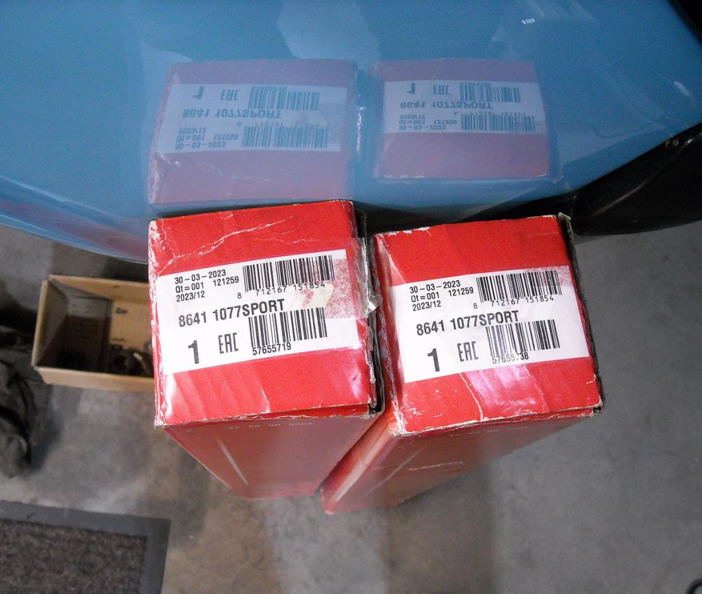

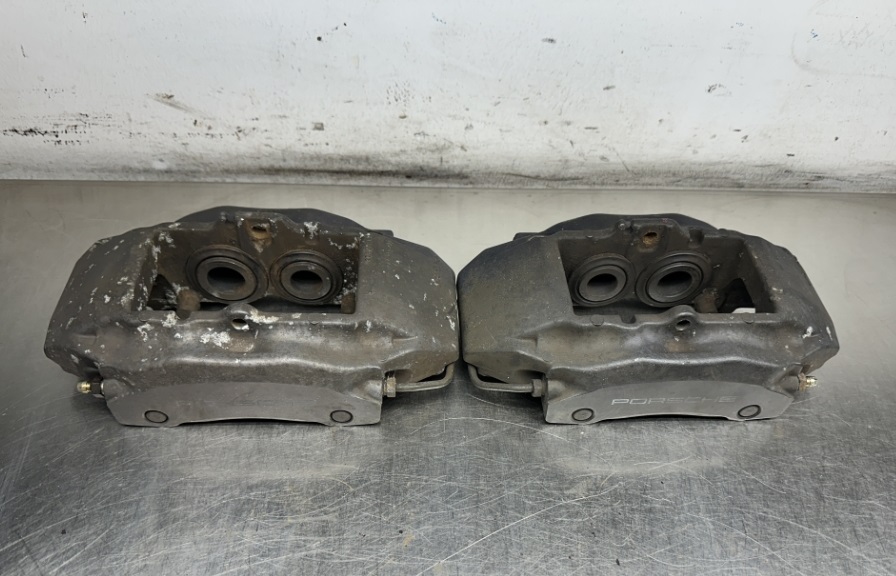

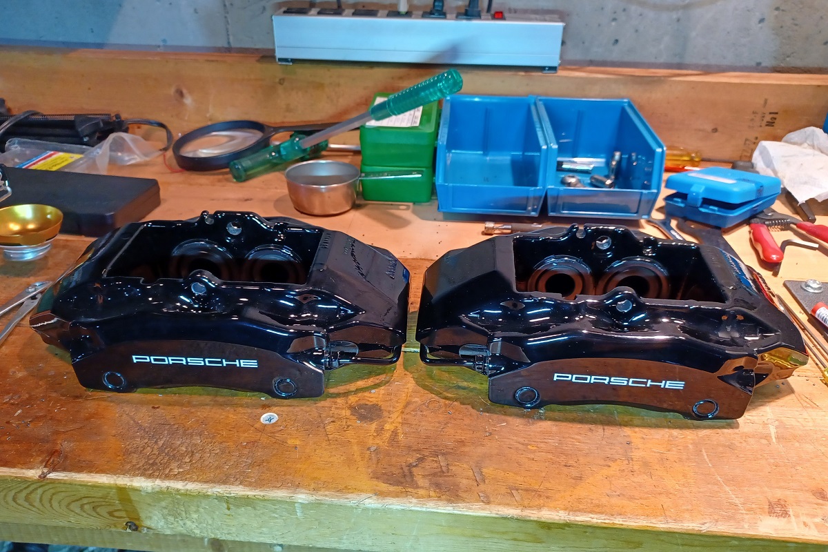

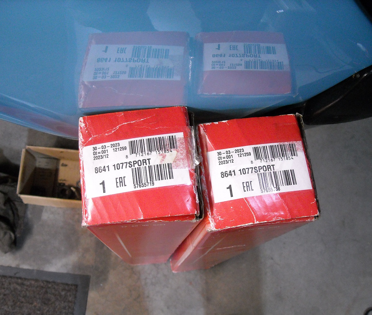

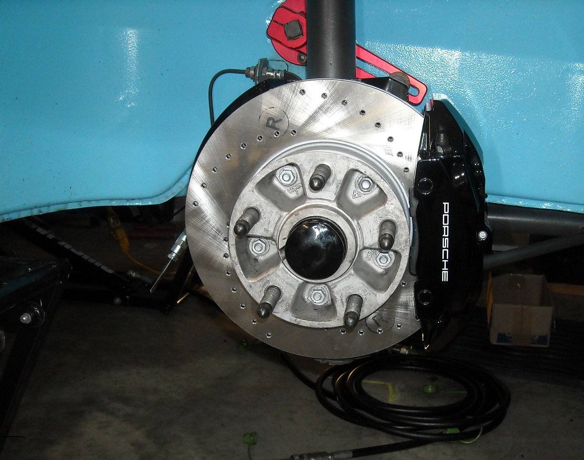

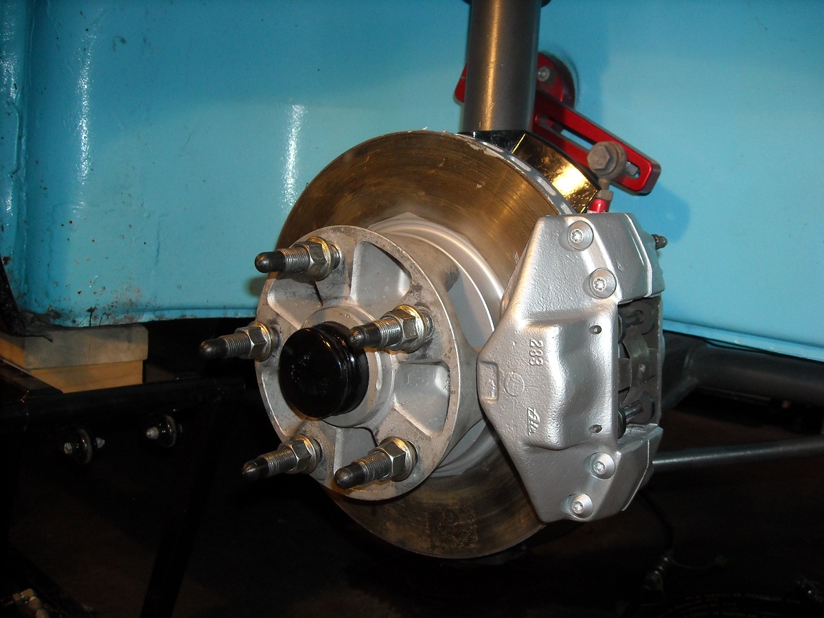

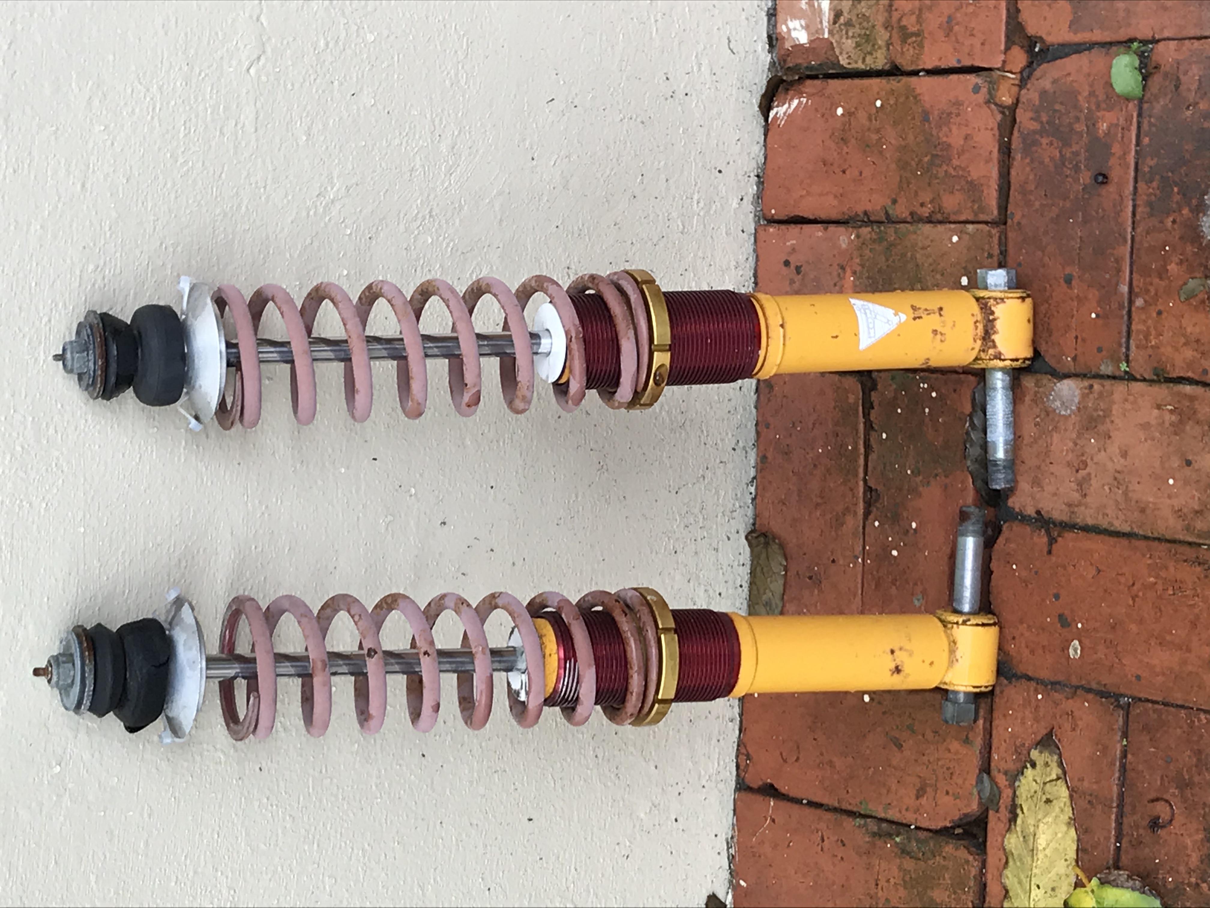

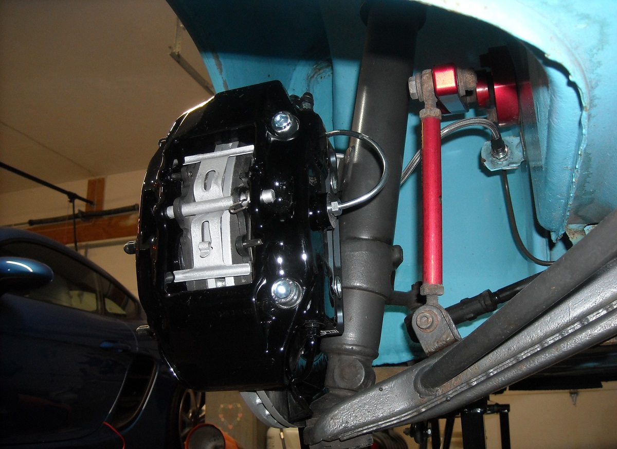

Couple years back I had installed Koni adj shocks in the rear with the Ground control sleeves and Eibach 125# springs. I was running Bilstiens in the front and sometimes they seemed a little too harsh. They came with the 911 struts I had initially installed so I just left them. until now. picked up a set of Koni adj for the front, cant wait to see how these play out. No pictures of the installation but it was pretty straight forward. Now i have the Konis front and rear.
I had been considering an upgrade to Boxster front calipers for a while now, and I finally came across a set locally for a good price. So here we go.
Not that I really needed this brake upgrade, The A calipers worked fine but I had a really hard pedal with the 19mm master cyl.
Before picture
And since when did NEED ever come into the equation.
Picked these up and they didn't seem bad for the price. And no Shipping
Sent them off to PMB for a rebuild and as usual they did an Excellent job.
Next were the adapters from Elephant Racing, the kit came with bolts needed, new flex lines and hard lines. I cut a couple pieces of coat hanger to mock up the bends for the hard lines before attempting to form them. that worked out pretty good.
Although my old 20mm rotors would have worked, Decided to go with Sebro drilled vented rotors, Also from PMB, along with the Porterfield R4-S pads same as in the rear.
Got everything bled with the Motive pressure bleeder, the pedal seems a little softer but still locks up, just further down. But that is what I wanted. I haven't road tested it yet, so I really don't know how well it all will work. I will bleed it again after I get some miles on it.
And of course, While I was in there., I touched up a spot that had the paint chipped off, probably from stone chips.
At the old house I had a detached garage to do my painting in, keeping the smell out of the living area. Well I heard complaints about the paint smell in this house for TWO DAYS!!
(IMG:style_emoticons/default/happy11.gif)
Oh well.... (IMG:style_emoticons/default/confused24.gif)
Till next February .... (IMG:style_emoticons/default/aktion035.gif)
