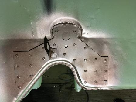

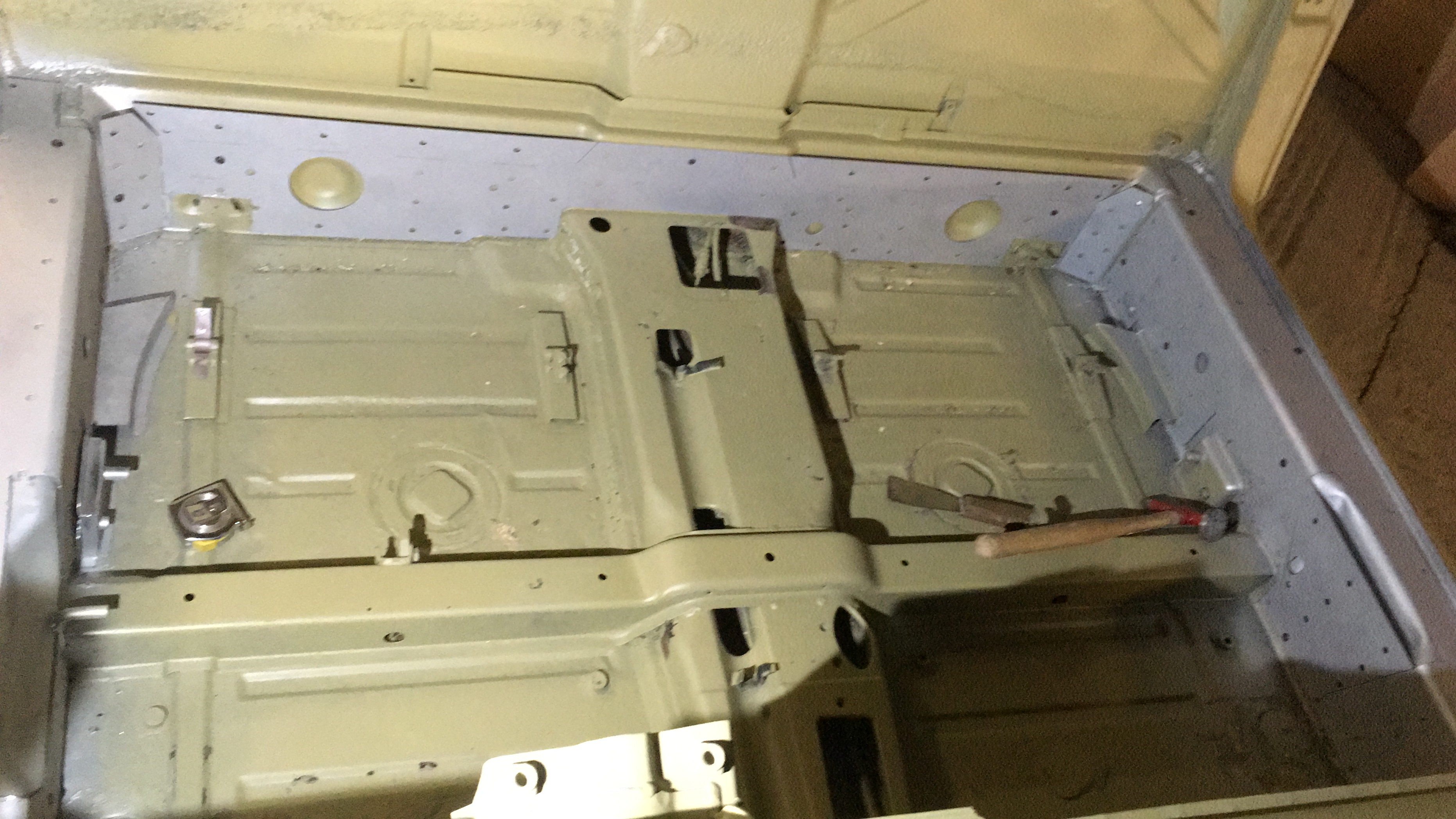

Made a little more headway this weekend, trial fitted my Mad Dog strengther kit and then welded one side in fully ! Committed now !

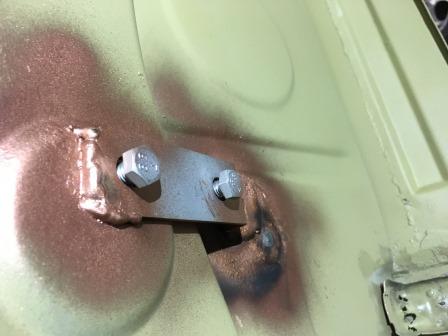

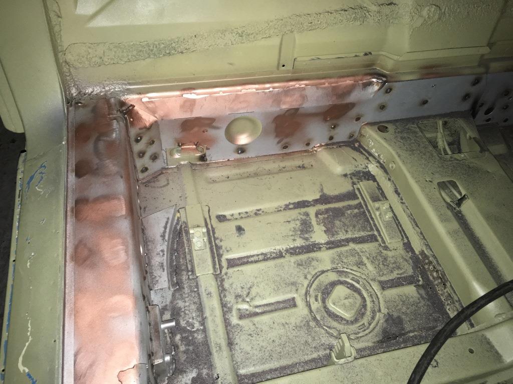

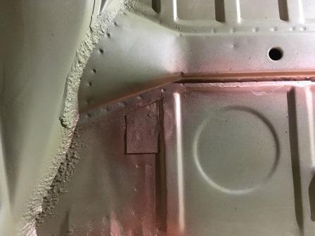

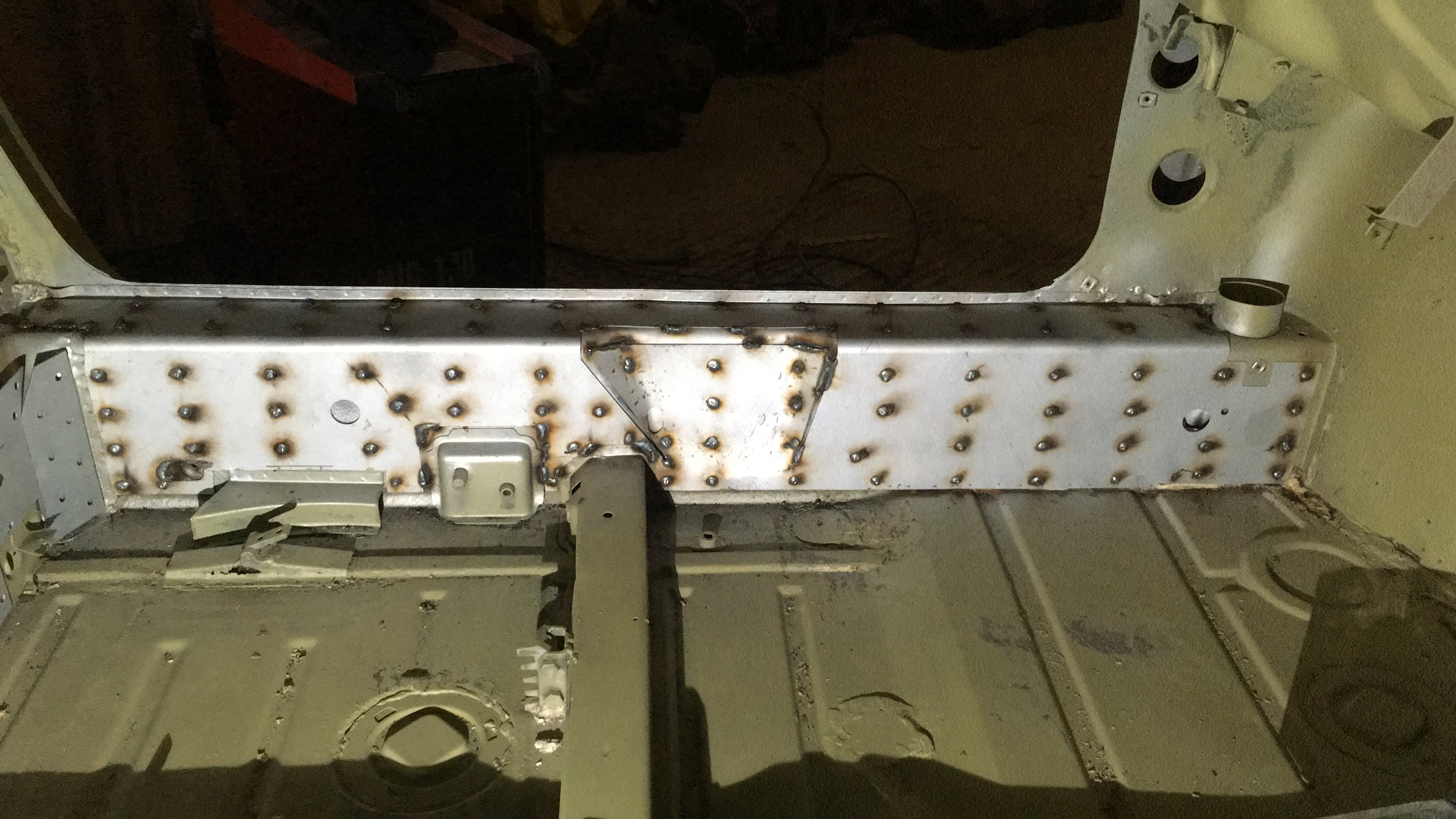

Well, i've been busy welding away at the maddog kits ! i've the long kit modified and installed, rear sway bar mounts in, front sway bar kit fitted just the engine mount and rear long kit to fit, the etch primer the media blaster sprayed is wicked stuff, its a grinder job to remove to weld back on to clean metal !

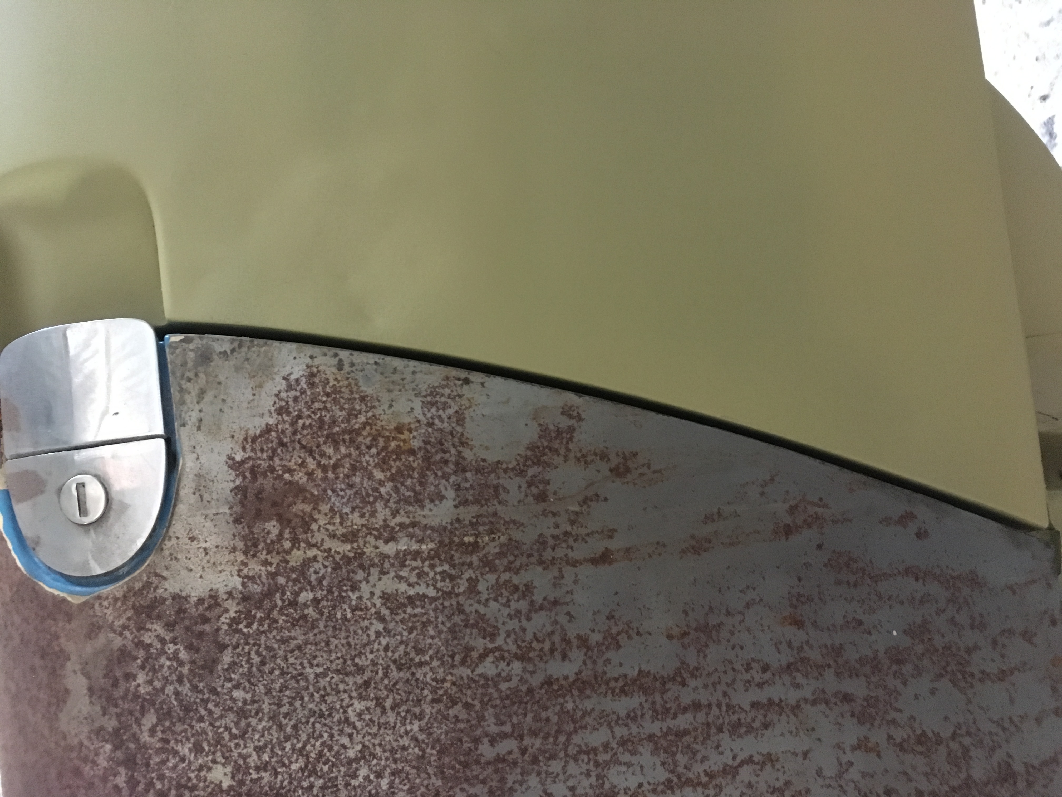

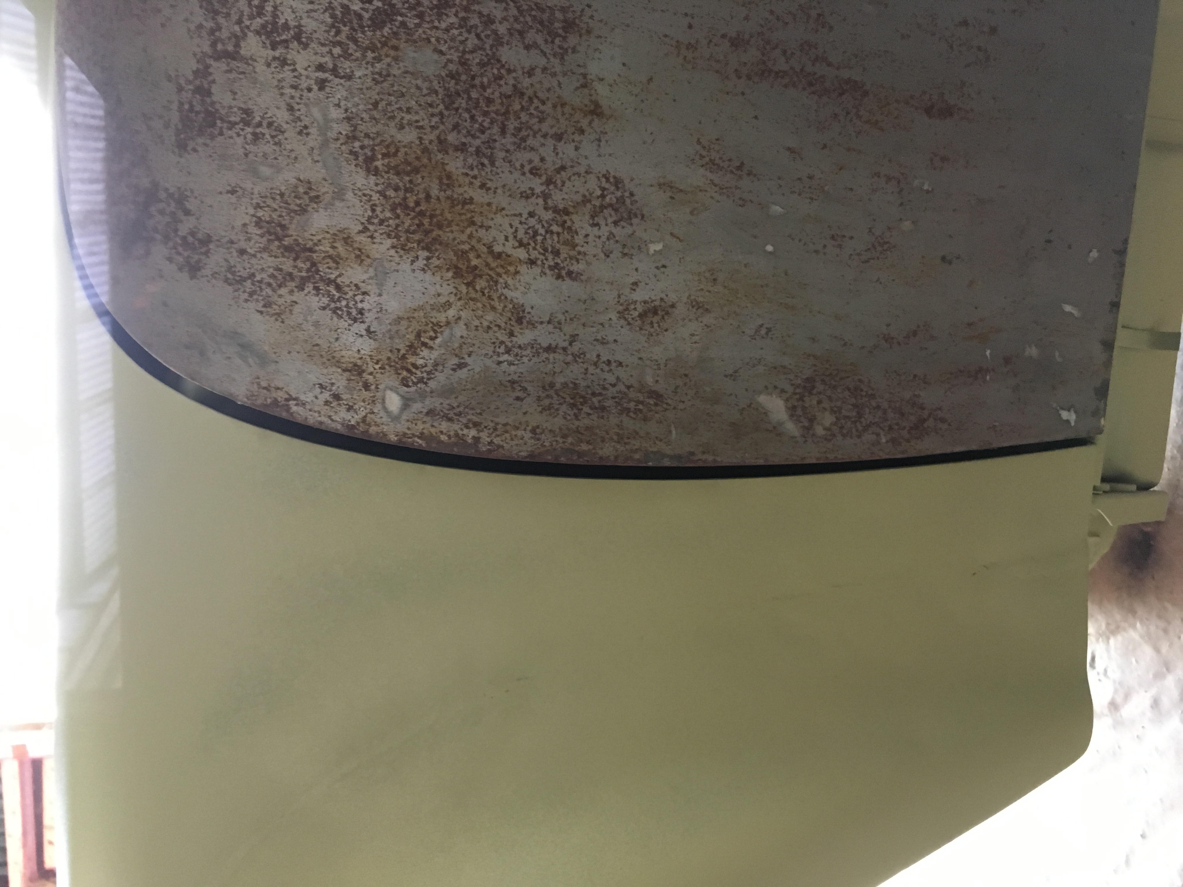

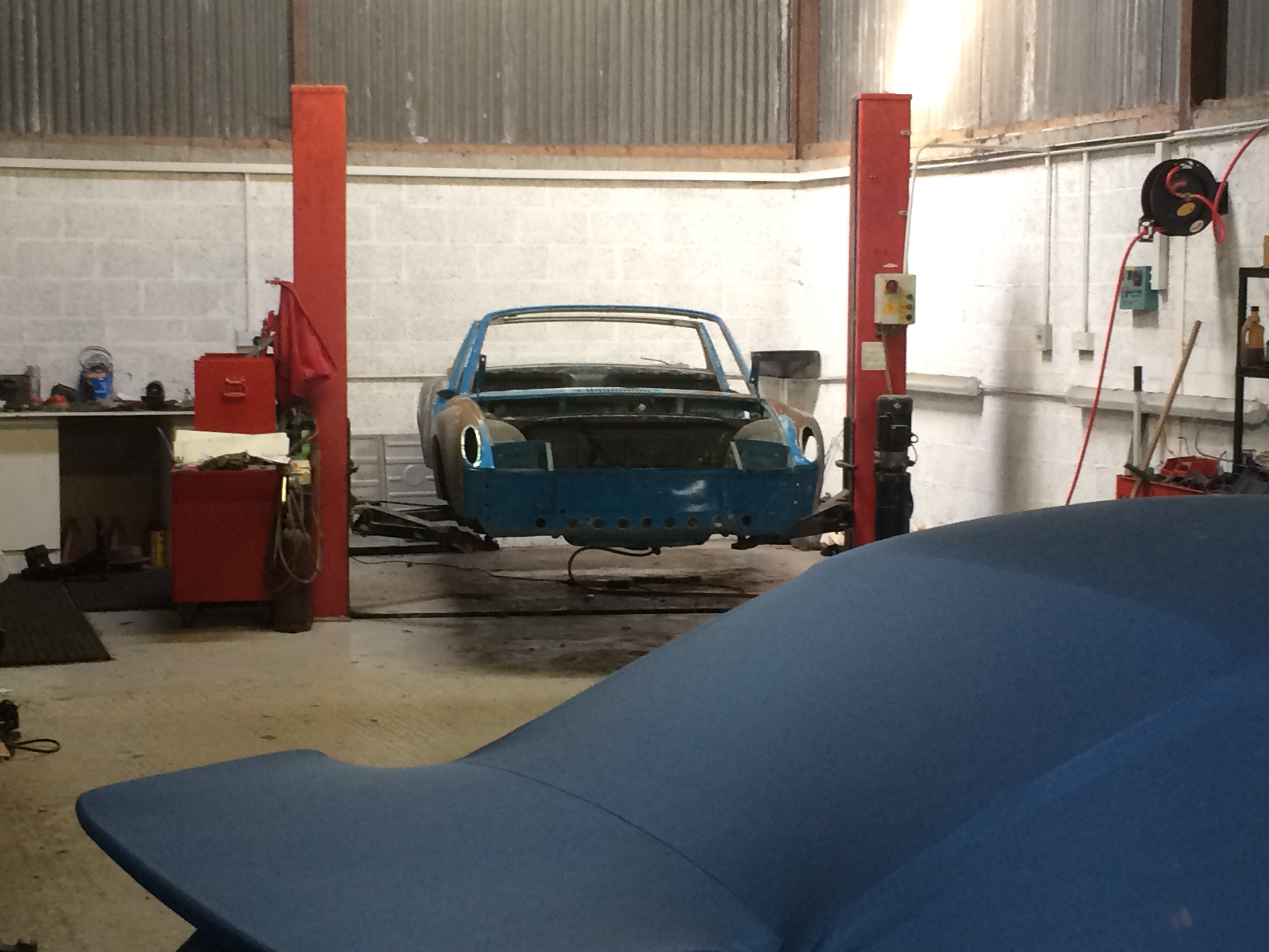

Have you tried to fit the doors back in after you welded in the Mad Dog Kits to make sure your gaps have not tightened up?
Best to find out now.

Nutter965
post May 4 2018, 03:36 PM
Post #107
Posts: 139
Joined: 17-August 14
From: Uk Northern Ireland
Member No.: 17,784
QUOTE(burton73 @ May 4 2018, 08:32 PM) *
Bob B
(IMG:style_emoticons/default/welder.gif)
Mmm next on the list.. we'll soon find out !

Doors on and sexy door gaps all round !! Phew (IMG:style_emoticons/default/piratenanner.gif)
