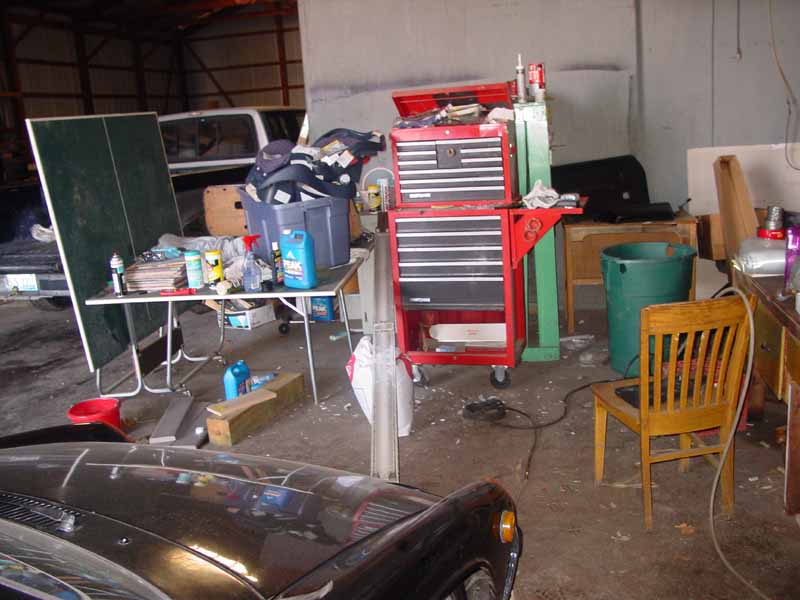

The Arctic winter broke briefly today here, with temps near 60 for the first time since late October. (IMG:http://www.914world.com/bbs2/html/emoticons/boldblue.gif) So, Stef came over and we put the new clutch and trans in. First I went to turn the lights on in the shop. . . nothin? So I open the giant double doors to the Great Midwest NARP Assembly Building, and I see something odd (IMG:http://www.914world.com/bbs2/html/emoticons/idea.gif) Boy, I don't remember that bank of floresent lights leaning up against my tool box. . . .

TimT   I hate when that happens!!   Mar 6 2005, 08:22 PM
xsboost90   OUCH! i had a cabinet fall off the wall once, ...   Mar 6 2005, 08:24 PM
aircooledboy   Oh well. http://www.914world.c...   Mar 6 2005, 08:26 PM
jwalters   Sorry to hear about the scuffle---but the rest loo...   Mar 6 2005, 08:39 PM
