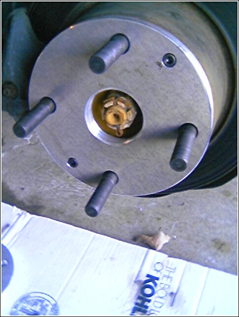

In order to get my car ready for it's brake and light inspection (salvage title), I finally got all of my lights to work perfectly, the aftermarket flasher relay didn't work too well so I had to dish out the $35 for a new correct unit.
I put my lathe to good use today, I needed 1/2" spacers for the rear of my car for my rims due to the heavy offset (47mm, should have been 35mm)
As you can see, I'll have to get new studs, the threads don't go down far enough for the lug nuts to tighten up against the wheel....instead of cutting new threads, I'd rather get the correct studs which have the threads formed by rolling, these make for a stronger thead....sorta like being forged.....

McMark   Nice work! I've never understood what rol...   Mar 6 2005, 09:08 PM
scotty b   I believe rolled threads are when the stud is form...   Mar 6 2005, 09:14 PM

root   Mueller, Have you got a good source for rolled t...   Mar 6 2005, 09:33 PM
TimT   MIke that spacer doesnt need to be hub-centric?   Mar 6 2005, 09:34 PM

root   I don't know but I think as long as the tires/...   Mar 6 2005, 09:39 PM
root   Lug Centric or Hub Centric? Which is it?   Mar 7 2005, 11:19 AM
