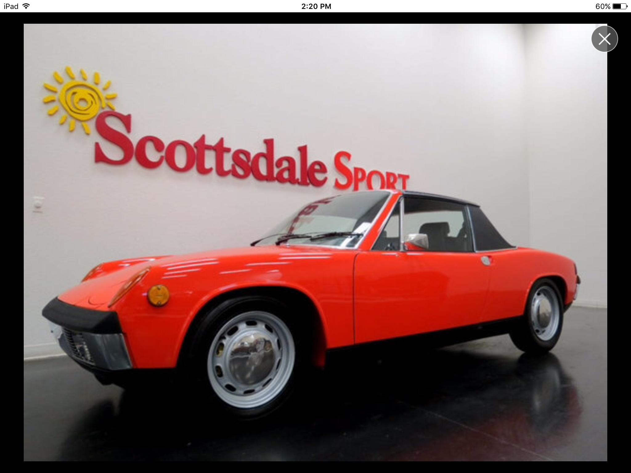

$150K......what a crazy market.

Nice car, would be nice to see pics of restoration....
Are those KYB rear shocks? (IMG:style_emoticons/default/WTF.gif)

Wonder what happened to the original rear bumper? I will be watching this one closely, same color as mine.

taped off emission sticker front bumper pad is puckering. Hope he gets it but it's in the details.

The big bucks are in the details,
very nice looking in pictures but for that price I'd want to see what they started with and the extent of the work under that shiny paint. . The only one in similar condition I've seen was asking higher, listed in Germany 2 years ago for $184K. . It would be very interesting to find out what ultimately happens with this one. .
Then again, we all know what these parts cost these days if you can find them. .
was nice this one had the white headlight surrounds. .
1st glance items-
Black late style retainers holding on the rear 914-6 logo.
Black front struts - should be gray
Does look like KYB shocks on the rear.
Missing shots of the motor and trans.
Black tar missing around front strut caps.
Rear brake hard line painted over black on drivers rear
Both rear caliper pad gap adjustment covers painted over with caliper color

Painted wheels and hub caps. Looks good...... 914 6 in disguise.
Not the typical choice but the right call according to the COA.
No engine pics but looks like aftermarket air filters.
Love to look it over. Wrinkles in right sail panel vinyl,

I see some things that look like they cut some corners. For that ask, I would think stuff like the underside of the engine lid would be painted nicely. I wish we could see some underside and engine compartment pics.
I would expect the owner would be able to produce the restoration pics of the car stripped, media blasted, etc. Plus, WTF with the KYB rear shocks - bad choice for a shock.
Regardless of those little things, that is a nice car. GLWTS

I'm in Scottsdale- have to stop by and have a look at it for the heck of it...agree that is not an early rear bumper which that car should have.

Well, for 150k, they could at least get PMB to do the calipers. Looks like they sprayed everything with gold paint...

(IMG:style_emoticons/default/timeout.gif) ...gasp...are the fog lights LED???????? The color temperature looks way too high on the lumen scale. I'm out.
