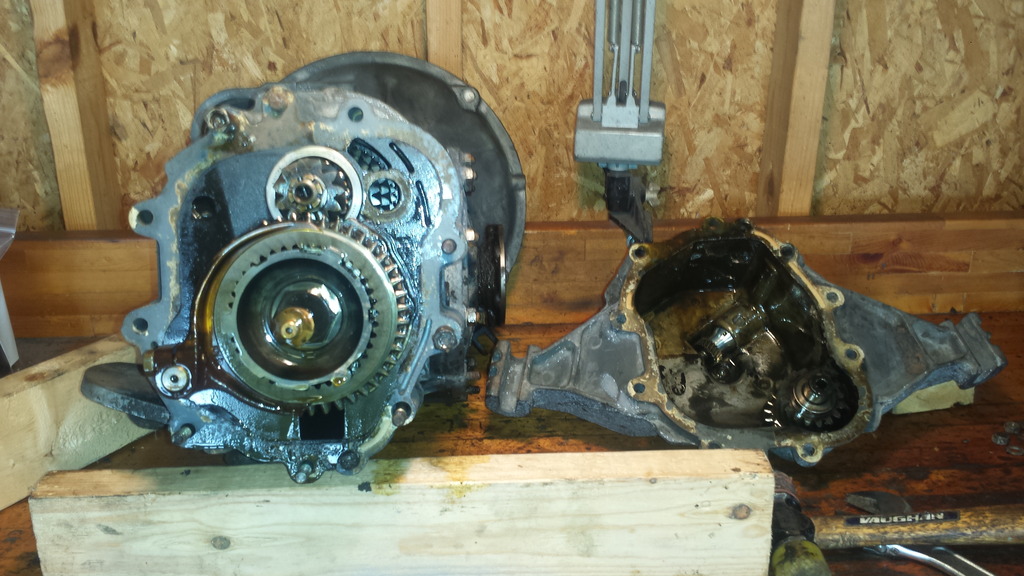

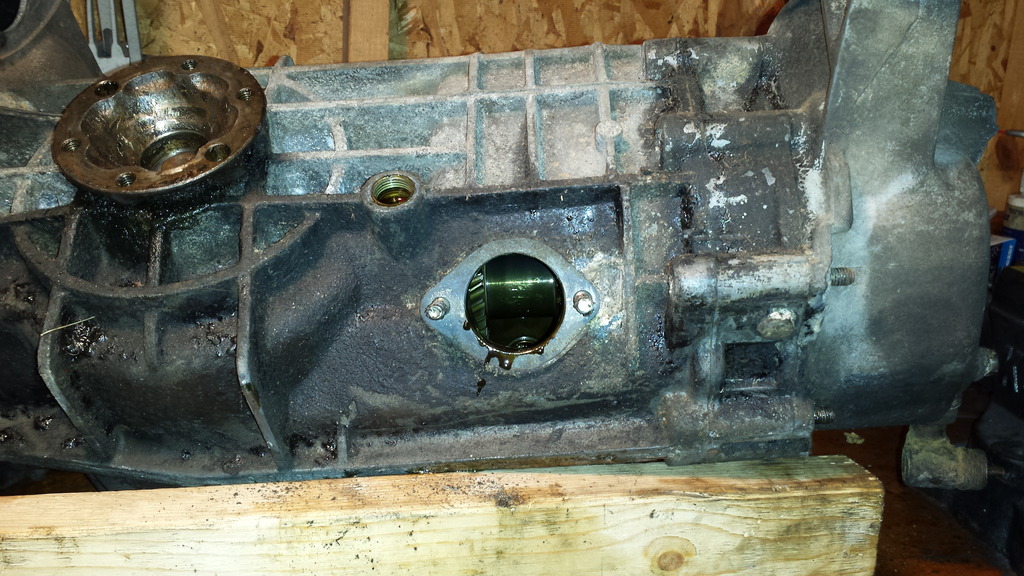

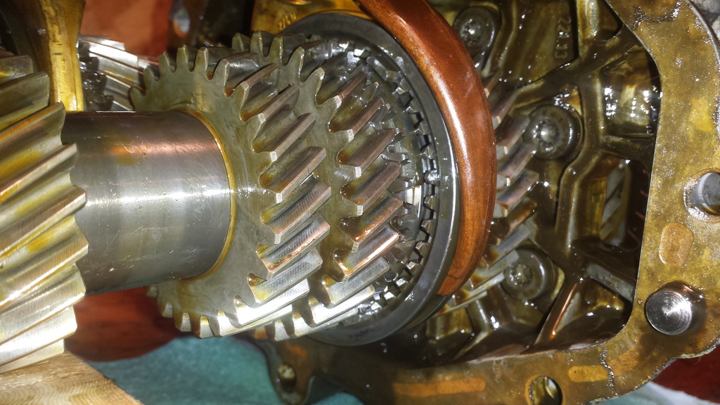

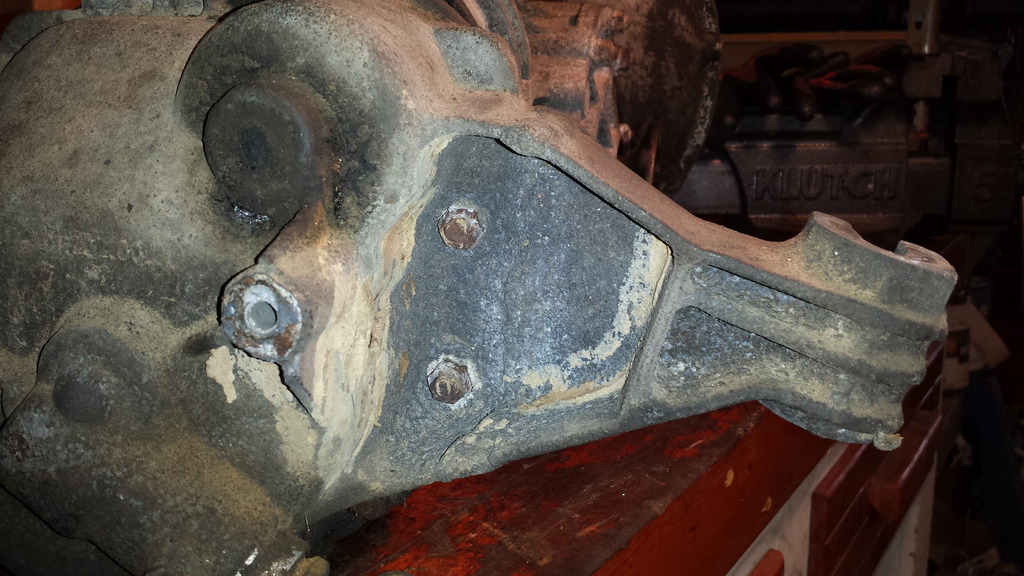

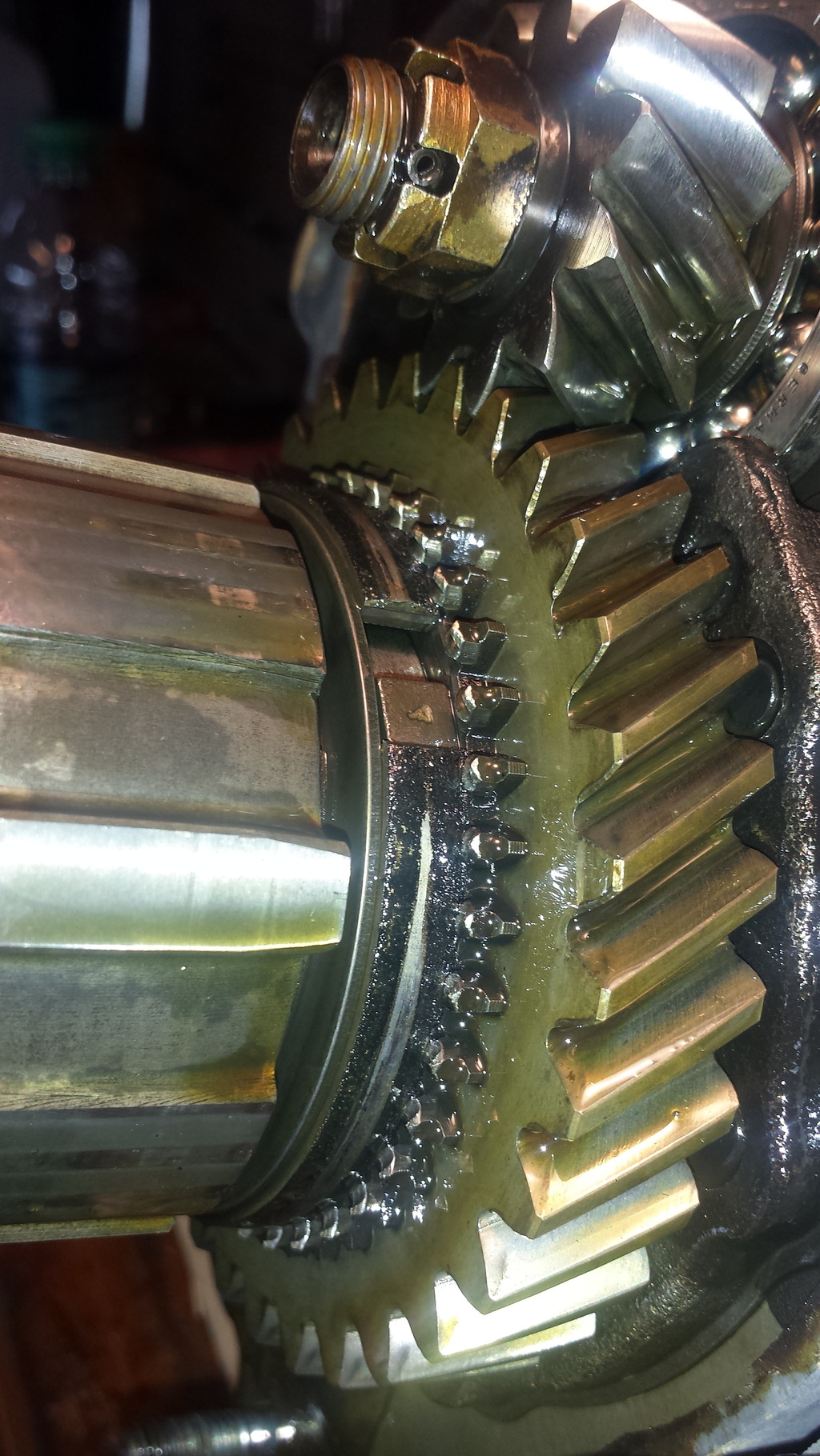

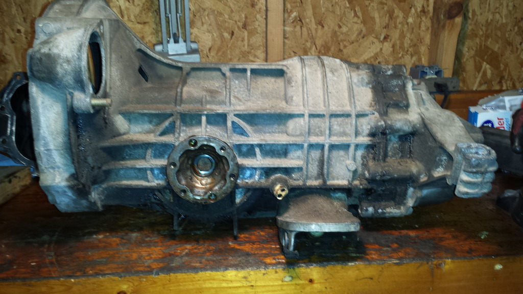

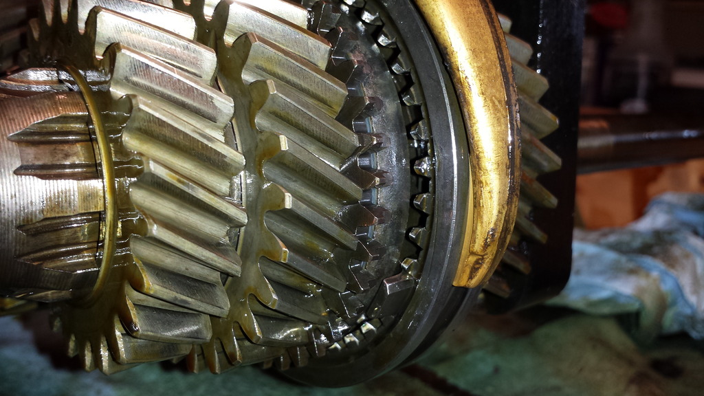

I've got a spare 901 trans purchased about 2 years ago. No idea how many miles are on it or what year car it came off of. What I do know is I need a different gear set for my Prepared '73 914 autocross car. I've read through the gear set charts and I believe the flipped 3rd and 5th will get me where I need to go.
So today I got that trans on the bench, drained the fluid and removed the rear cover. Those of you who know what they're looking at, please let me know how 1st gear slider and dog teeth look in the photos.
My initial observations are that those look pretty good. I noted that someone had installed a magnetic drain plug. That had done it's job and there was about 1/2" of metallic goo stuck around the inside of the plug. The gear oil came out pretty clean with only very slight traces of micro particles.
I just read Bondo's thread on trans disassembly and it's pretty intense. There's also no mention of the 3rd and 5th gear flip so I've got no clue exactly what that procedure is.
914 transmission disassembly
(IMG:http://www.914world.com/bbs2/uploads_offsite/i1336.photobucket.com-16456-1451245548.1.jpg)
(IMG:http://www.914world.com/bbs2/uploads_offsite/i1336.photobucket.com-16456-1451245548.2.jpg)
(IMG:http://www.914world.com/bbs2/uploads_offsite/i1336.photobucket.com-16456-1451245548.3.jpg)
(IMG:http://www.914world.com/bbs2/uploads_offsite/i1336.photobucket.com-16456-1451245548.4.jpg)
(IMG:http://www.914world.com/bbs2/uploads_offsite/i1336.photobucket.com-16456-1451245549.5.jpg)
(IMG:http://www.914world.com/bbs2/uploads_offsite/i1336.photobucket.com-16456-1451245549.6.jpg)
(IMG:http://www.914world.com/bbs2/uploads_offsite/i1336.photobucket.com-16456-1451245549.7.jpg)

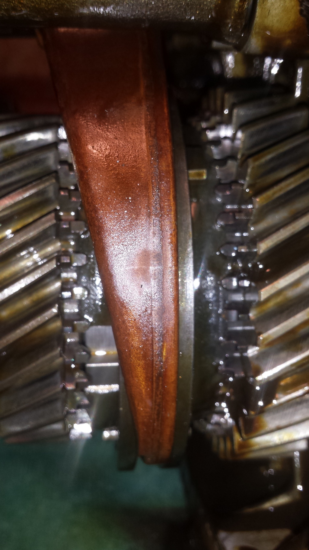

jimkelly
post Dec 27 2015, 02:09 PM
Delaware USA
Posts: 4,969
Joined: 5-August 04
From: Delaware, USA
Member No.: 2,460

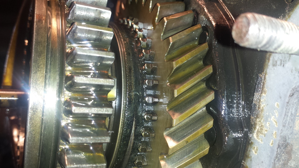

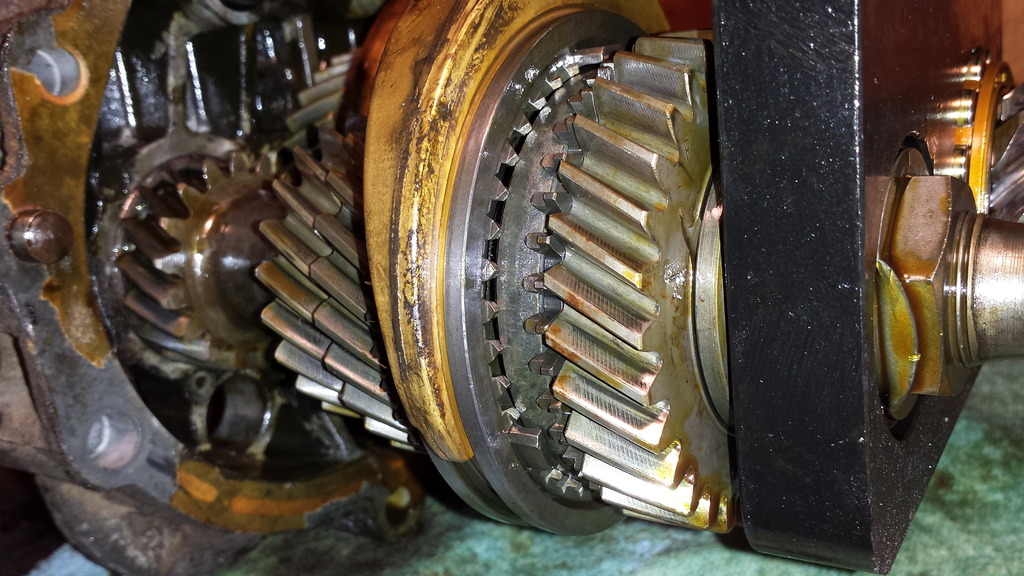

I think slider (the side shown, anyway) is usable
but dog teeth need to be replaced for sure.
others will chime in.

Too hard to see for a decent opinion.
For the flipping of the gears, pull the gear stack.
When you lay them next to each other you will see they can only fit a certain way.
When you take the fifth gears off, and exchange them to the different shafts, it still fits together...
You have two shafts.
The long one is the drive shaft, connected to the engine.
The short one is the driven shaft, it gets its power from the drive shaft.
So, take the fifth gears off.
Take the 4th and 3rd gears off too.
Keep the orientation correct, front and back.
Now, take the fifth driven gear and put it on the drive shaft in position 3
Take the 5th drive gear and put it on the driven shaft in position three.
Do that swap for both 5th and third, put fourth back the way you found it.
Fifth is the farthest away from the clutch.
Make sense?
0396
post Dec 27 2015, 06:21 PM
Posts: 2,046
Joined: 13-October 03
From: L.A. Calif
Member No.: 1,245
Dog teeth and syncro band looks like it past its life.

Han Solo
post Dec 27 2015, 09:04 PM
Posts: 291
Joined: 30-September 13
From: Middle Tennessee
Member No.: 16,456
QUOTE(396 @ Dec 27 2015, 06:21 PM) *

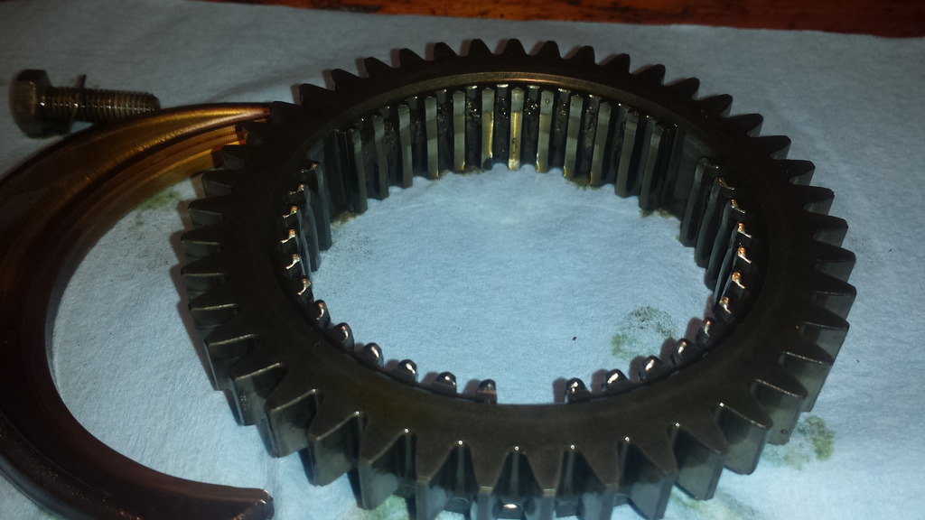

Yeah, as I looked more closely today at the dog teeth, I'm inclined to agree. Most threads I've read recommend replacing all the syncros while you're in there.
So the the most important tool to do this is the Shift Fork Jig, correct?
914 Shift Fork Jig
Having the Syncro Hub Removal Tool would be handy but there's other ways to extract those.

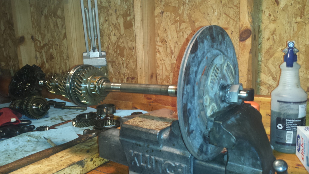

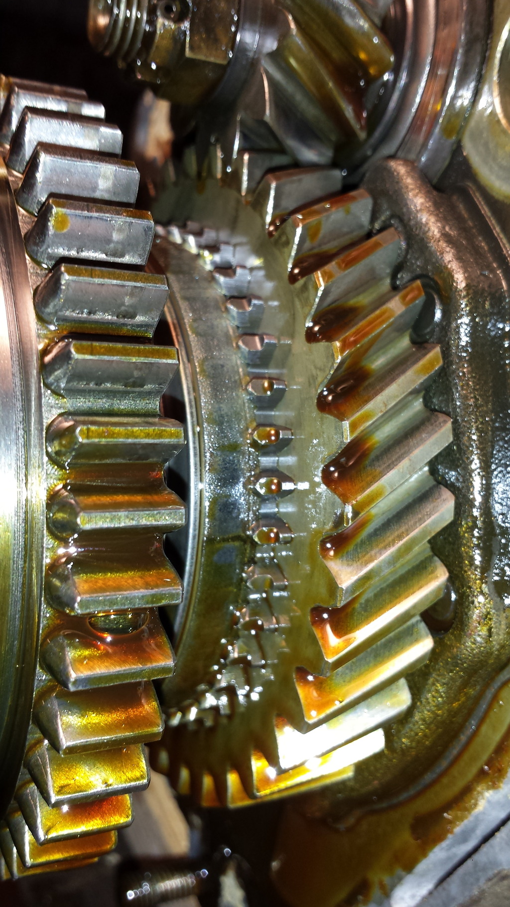

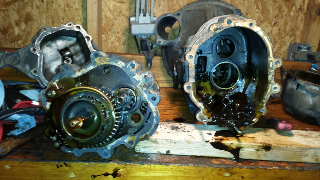

Okay. I went in deep today and here's what I found...
Instead of digging deeper into the spare trans that I pulled the cover and 1st gear, I went into another off a '76 parts car, figuring if I monkeyed that up, it wouldn't rally matter. Well surprise, surprise. The dirty trans with a welded rear cover (suspension mount cracked) has what appears to be really fresh syncros, nice sliders and really good dog teeth! I guess when the mount broke, the PO had the trans re-built. Finding that, I'm thinking this is the stack I want to use in the race car. So I pulled the shift rod, wiggled out the intermediate plate and pulled the shift forks with rods. I found out why Red Beard recommends loosening the 30mm nut and castle nut before pulling the intermediate plate (harder to do with the plate out) but I purchased some handy tools a couple days ago from a Porsche shop going out of business - an alignment jig and a spanner with a 1st gear slider welded on it. Once I locked down the stacks, those tools enabled me to get the drive shaft out but the pinion shaft was more difficult. My gear puller wouldn't fit so I had a buddy drive the shaft end out with a large brass punch. Amazingly the bearings remained in good shape. Then to get the other end of the pinion shaft dis-assembled, I used a friction plate with a nut welded to it to hold the input shaft end while I used a large open end wrench on the retaining nut.
So I've got everything loose and lined up in order on the bench and I'm taking a real close look at swopping 3rd and 5th gears when I realize that to do that, yes, you do have to flip the gears (to get the correct orientation) also AND that means reversing the dog teeth. Someone let me know if there's something I'm missing here. So, with the dog teeth, sliders and syncros looking so good on these gears, there's no way I'm going to trash the dog teeth and buy another set.
At this point, I'm just going to re-assemble this stack (OEM gearing) and probably stick it in the spare case and use the spare end cap. OR... I could use this stack in the case that's in the race car right now and not even have to pull the trans out.

oldie914
post Jan 2 2016, 05:16 AM
Posts: 116
Joined: 2-May 10
From: Germany
Member No.: 11,680

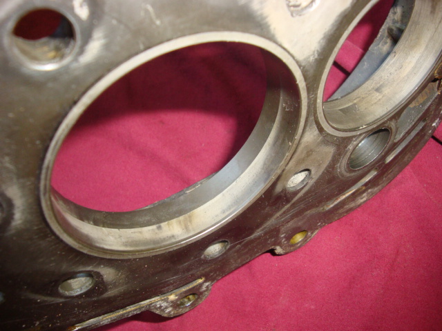

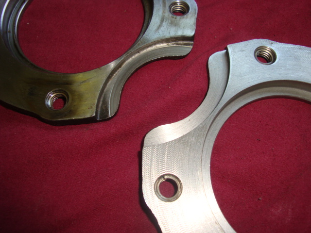

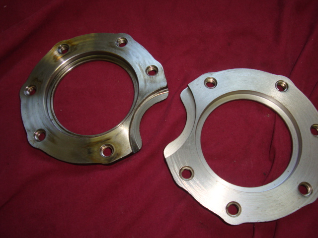

You should not put the gear stack from the 2nd transmission into the case in your car without adjusting the pinion depth. Depth is measured and adjusted with the gaskets between the case and the intermediate. Measure the thickness of the old gaskets with a micrometer and use the same thickness gaskets when you put the gear cluster back into the case.
Also, in one of the pictures it looks like the mainshaft ball bearing has been turning underneath the retaining plate. The bearing then cuts into the plate and you have no clamping force. Plate should hold the bearing with about 0.08mm interference. Pictures show a damaged retaining plate and one that has been reworked.Attached Image Attached Image Attached Image
Han Solo
post Jan 2 2016, 06:40 AM
Posts: 291
Member No.: 16,456
QUOTE(oldie914 @ Jan 2 2016, 05:16 AM) *
Thanks for those notes. So measure the gasket thickness either side of intermediate plate on the active transmission before using the re-built stack and match that. I'm thinking the only fix for the spinning bearing is to replace that and use a good plate, correct? Perhaps use the intermediate plate from the first spare trans if it's in better condition.
oldie914
post Jan 2 2016, 07:47 AM
Posts: 116
Joined: 2-May 10
From: Germany
Member No.: 11,680
The gear cluster on the intermediate plate, ring/pinion and case are a set with clearances adjusted during assembly. If you take a transmission apart and don't see any R&P or bearing problems, you can reassemble it and preserve the original adjustments. If you exchange major components, you need to reset R&P adjustment.
Pinion depth is the 1st thing checked when rebuilding a transmission and requires special tools (expensive). Rough pinion depth is established with shims in the gear stack next to the roller bearing. Fine adjustment is made with various thickness gaskets between the case and the intermediate plate. This means that you can reassemble a transmission with the same major components and with the same thickness gaskets and pinion depth setting will be OK. The gasket between the intermediate plate and the nose has no adjustment function; it is always about 0.20mm thick.
The second thing checked is the preload on the differential roller bearings. It is adjusted through various thickness spacer rings on the differential carrier spigots under the roller bearings. It is measured by checking the turning resistence of the differential carrier. If you do not change differential carrier, case or bearings, this adjustment is preserved.
The last thing checked is the backlash between the ring and pinion gears. It is adjusted by changing the spacer rings under the differential bearings so as to move the ring gear toward or away from the center line of the pinion shaft.
Rings need to be changed in pairs in order to preserve the bearing preload. To measure backlash, you need to fix the pinion shaft and attach an arm with a dial indicator to the differential carrier and measure movement to a fixed point on the side cover. Backlash adjustment is preserved if you do not change components involved.
I hope I didn't tell you how to build a clock when you only wanted to know the time.

That trans is in pain.
The keys to a good shifting trans is are the condition of the dog teeth & the sliders that mate up to them. Do what you want. Use those parts and you have a POS trans like most 914ers.
For a change of pace, try a 2 speed using 2nd and 3rd only. That trick is relatively easy and is slick for AX only. A stock 2nd for 1st and a flipped 5th for 2nd. I ran that set up for a few years after I figured it out...the cost was maybe 20-30 bucks. and it got rid of about 20lbs of rotating weight.
