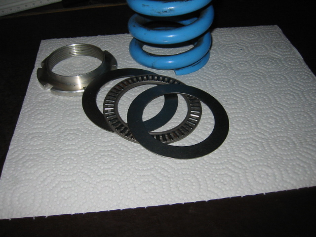

My 914-8 is at Custom Alignment in Mt View, CA for a final alignment prior to this weekends autocross @ Marina. I’m having Custom Alignment perform a four-corner alignment and four-corner balance. They just called with an issue—the front RS coil-over struts are not properly rotating on the monoball mounts. Seems the monoball is too sticky and is not allowing the front wheels to track properly. They suggested using a needle thrust bearing between the coil spring hat and the monoball. Is this a common component that I just left out?

yes...you want them.....not too many people run them, but they should....

Do you have a picture of your set-up? I have Ground Control camber plates on another vehicle and needle bearings are used for rotation.

Thanks Mike. I ordered roller thrust bearings from Mcmaster Carr- I should get them in the AM and maybe the car will still be ready by the end of the day Friday??? Are you attending the Marina event? (IMG:http://www.914world.com/bbs2/html/emoticons/driving.gif)

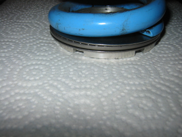

I installed them on the front and rear of both my cars, it makes it easy to adjust the cornerweights of the car, I can leave the car on the scales, and easily adjust the weights
I also modifed the spanner I have by cutting it short, and welding a 3/8 socket extension on it so I can reach the perch adjusters using long extensions

OK now I did not think of putting the bearing at that location but maybe that would work as well. Actually now that I think of it it wont. That thrust bearing set will only help with coil spring adjustments, not strut rotation loading against the underside of the monoball. Right?? Maybe it would, the rotation is just located at the spring-to-hat interface and not the hat-to-monoball interface. Anyone following me?
