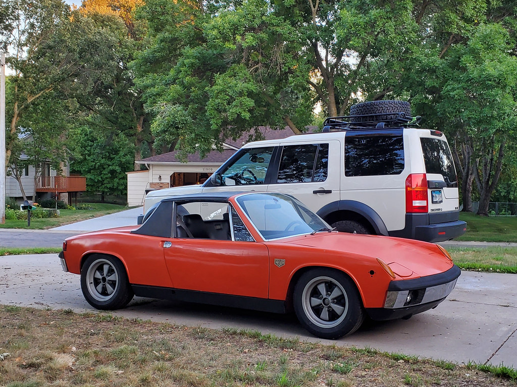

That's good to know @mb911 , thanks!
When I dropped the motor I found that there was MUCH more oil in the sump than what came out of the line/tank. Maybe a side effect of all the engine cranking I did? Does anyone care to speculate?
I surfaced the intermediate shaft cap and reinstalled the engine, then got it back up and in. The car is back in one piece and ready for tomorrow. Although now I'm really worried about oil pump seals. I was very careful when getting the case halves together, but you know how the mind works when nearing the end of an engine build and finding something you didn't expect...
I've had the appointment set for about a month. When I made it I wasn't sure if I would be ready, but it was a date that was available. Heck, I wasn't even sure if I would have them do it or if I would end up doing it all myself. Right now though, I'm pretty burned out on working on it and I'm glad I have it.
(IMG:http://www.914world.com/bbs2/uploads_offsite/live.staticflickr.com-19709-1629734899.1.jpg)
So, lets hope the next project update I post here is me driving the car.

Well it's running and I drove it home. A few things I need to address:
-brake light switch at pedal is stuck on
-oil pressure gauge worked when initially cranking this morning, currently not. Need to dig back into that
-need a real alignment, I got it pretty close but it needs some love
-fuel pump power is cut somewhere, probably right where I spliced the wire in all those years ago, which is basically where the snorkel is buried under the mount. We got it going with a wire routed outside of the car and a toggle to turn it off/on.
It sounds good, but will be better with Ben's muffler in place.
And I need to figure out why the tach isn't going.
